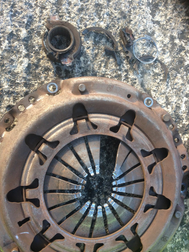

There we go clutch it out. And the thrust bearing is abliterated!
#69
Oops, think that's f*cked lol.
#70
Yeah that looks a bit broken Big Grin
Dave
#71
I think the people who changed the clutch last. Just did clutch and pressure plate. Cos they was luk and thrust bearing was Valeo.
So may it be a lesson to all the cheap skates out there. If your takin the box off do the lot together Smile.
#72
Ohh wait till you see what was left of my thrustbearing, when i did my clutch.
