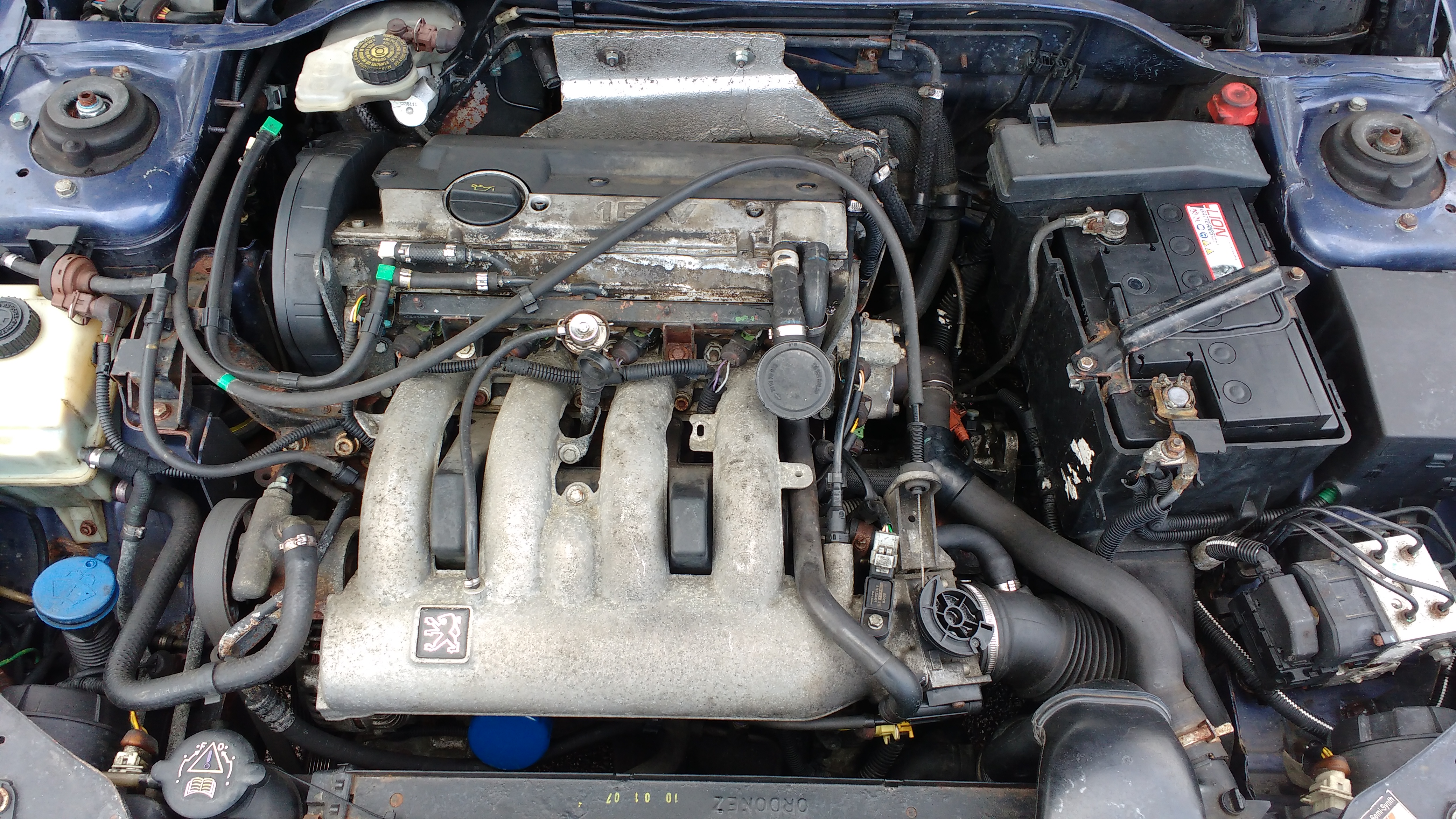

So, as soon as I started, drizzle set in, brilliant. Anyway, made decent progress for the first hour, got the whole 'topside' clear, removed the airbox - easier than I thought as there was a bolt missing (of course!) and got the NS BJ and shaft out.
Then spent an hour fighting the other BJ, cannot explain how much I hate these things! When I finally got it out I realised why it was so much hassle. The shit garage that ruined every other job also fitted a P bush...but they fitted it at such a ridiculous angle the wishbone is pointing up away from the floor at 'rest', not looking forward to getting that back in. Confused
In other news, the oil breather came off the intake hose, anyway I can bodge that back together? And does anyone know the part number of the gasket between the TB and manifold to save me going on SB?

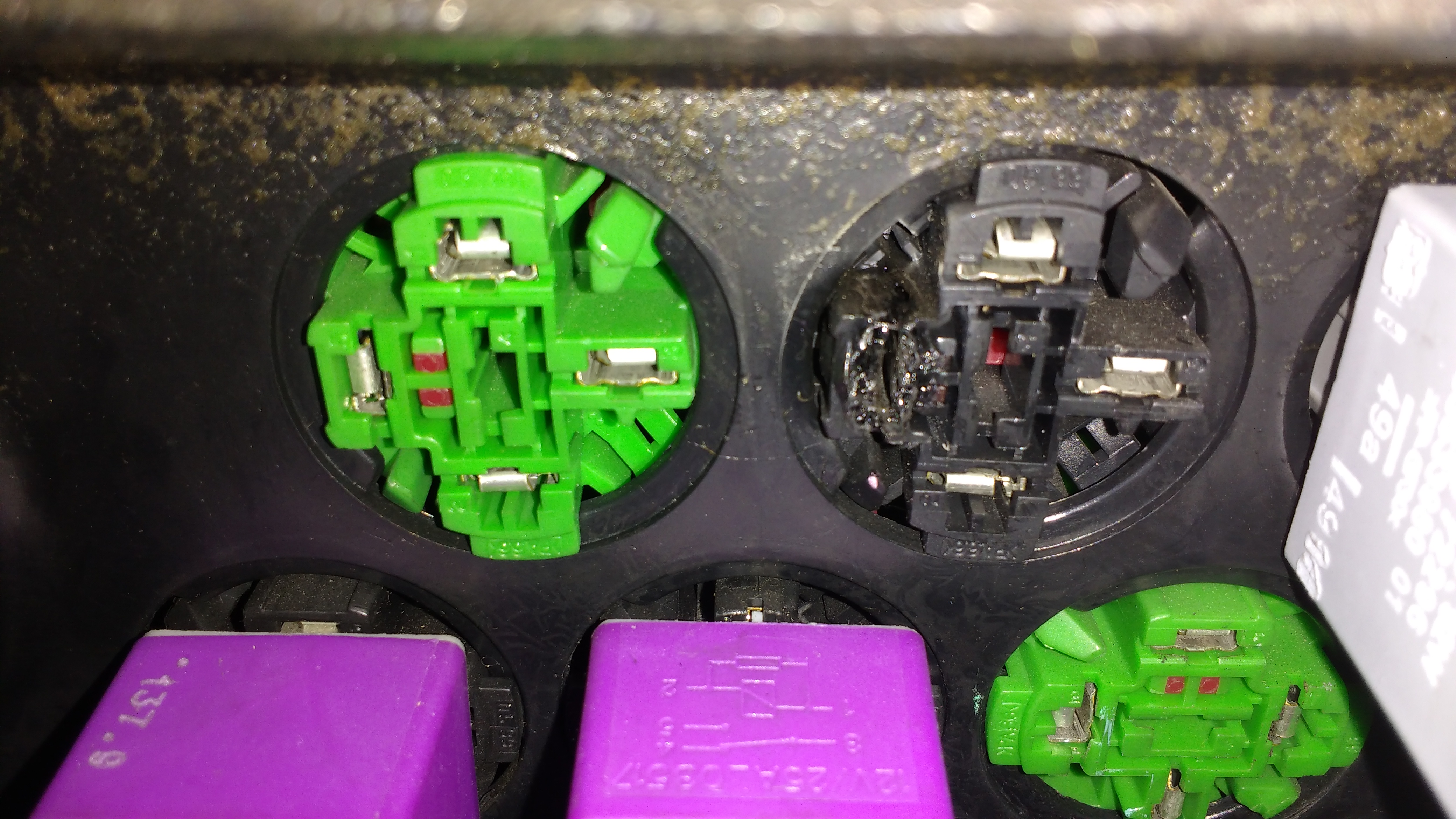

Tom, do you know if the motor that turns the flap is accessible? If it is check power to it or as a last resort would you be able to take the motor off and move the flap?

(14-05-2016, 06:34 PM)DeeTurbo Wrote: Tom, do you know if the motor that turns the flap is accessible? If it is check power to it or as a last resort would you be able to take the motor off and move the flap?
I don't know where the temp flap is now unfortunately, been a while since I've looked at a 306 heater box. I have a feeling it's buried behind the dash with no access though.
Yeah, I've got a feeling it's on top so buried behind the dash.

Will check relays now, Dee. (By now, I mean after a bathroom visit lol)
Relay is fine but plug looks melted? I guess the relay may have been replaced though.
Attached Files Thumbnail(s)
Is the spade in the melted one caked in plastic, so not making contact?
I've also read to check fuse f20 30a and f22 10a might be melted contacts or blown.

Tbh I couldn't get a decent look at the spade without moving the car (3 door doors are too long lol). But if it wasn't making contact, I guess the blower motor wouldn't run which it does? Thinking about it though, I can't understand why there would be a relay for temp control anyway, the flap motors can't take much electric?
None of the fuses are blown as I've already checked that. Will check the pins on those two later though!
