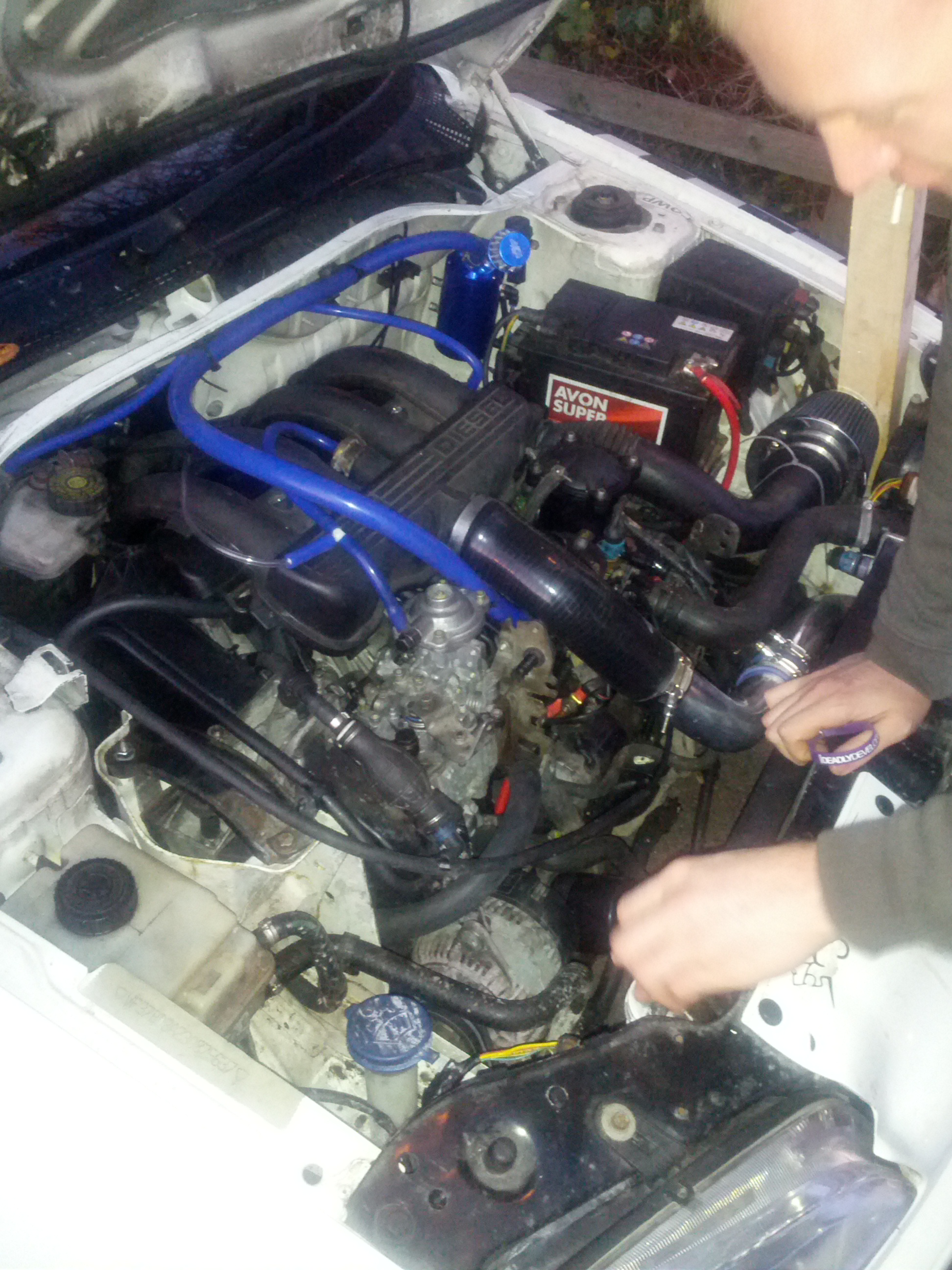

Pretty much the only car related pic of the weekend that I got lol
So DumDum - how does it feel to have reversing sensors now? Big Grin Big Grin
(03-12-2012, 04:41 PM)4WayDiablo Wrote: Pretty much the only car related pic of the weekend that I got lol
Cheers mate, that was the "OMG the coolant hasnt run away again, quick put the cap back on before it all jumps out" moment.

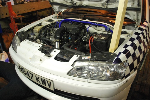

The finished article Big Grin
this looks awsome mate!!!!
It is awesome, spins the wheels when it comes on boost in 1st and 2nd and - aside from the "slight" rubbing issue lol - it's a pretty sorted install. Well impressed as ever matey, still think you should relocate the turbo. In fact, while you're there...
I can also vouch for the awesomeosity of it, needs moar tyre though...
