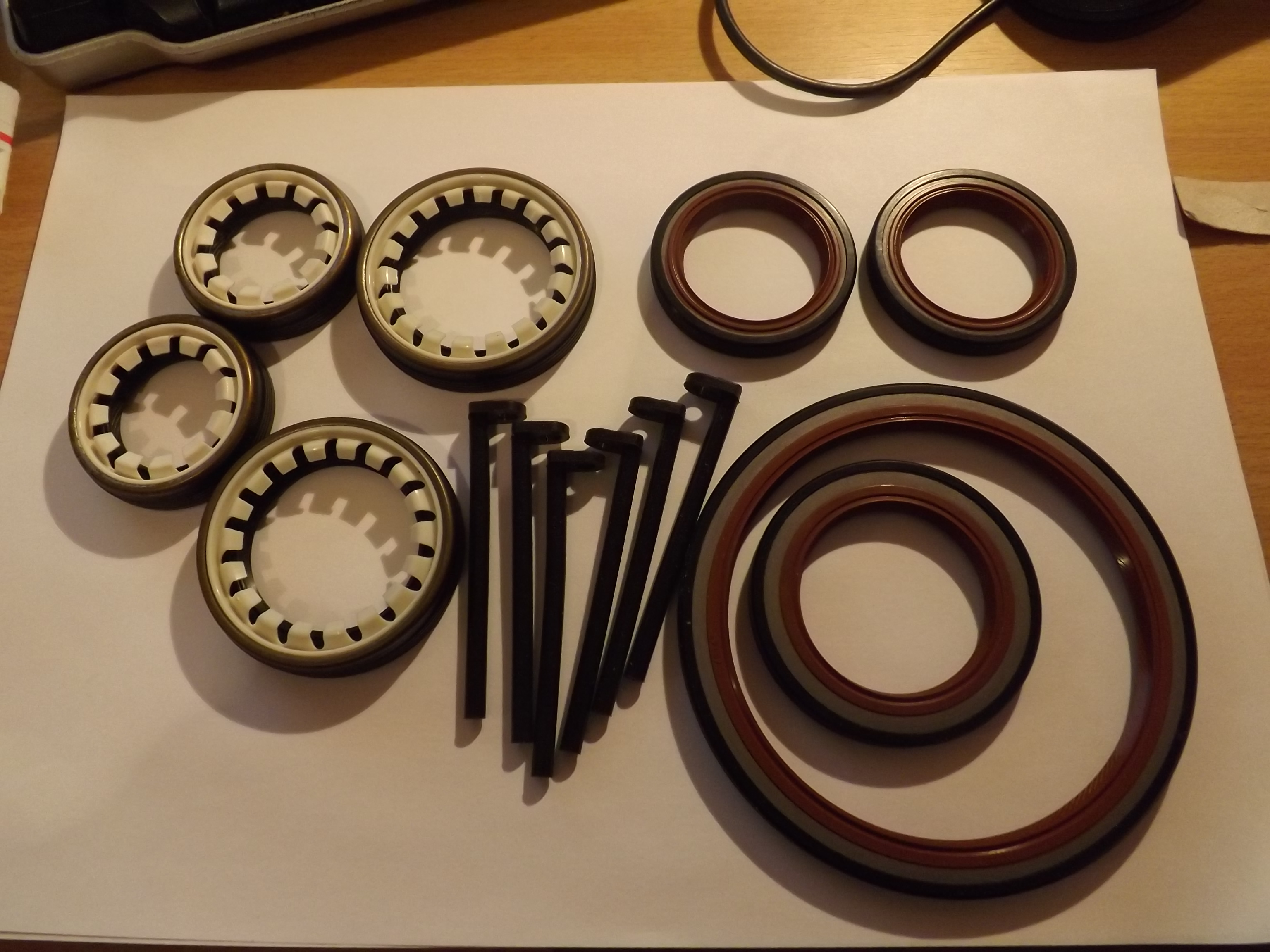

VICTOR REINZ part numbers
Full Gasket Set With valve stem seals/crankshaft seal
01-35050-01
0197.W2
+0209.Z2
Cylinder Head Gasket Set with valve stem seals
02-35050-01
Bottom End/Crankcase Conversion Gasket Set
08-25918-04
Headgasket
61-35050-00
0209.Z2
86,5 mm
MLS
Head Bolts
14-32148-01
0204.72 (10x)
Valve stem seals
12-31306-01
70-31306-00 16x
0956.38
Inlet Gasket
71-33666-00
0348.C8
Exhust Gasket
71-34443-00
0349.F4
Build Paste
70-31414-10
CRANKSHAFT BEARING SEAL Front
81-25926-10 K ,
0326.12
42x62x8
CRANKSHAFT BEARING SEAL Rear
81-34456-00 K .
0127.28
90x110x7
Camshaft Oil Seal
81-34403-00 N 2x
0236.44
36x50x7
head bolt torque settings with tightening sequence

Well rep for you Cully. Ive just spent a while on ebay using the info you have provided here and ordered my self all the gaskets and seals i need. Lightened my wallet a fair amount!
list of prices and where i have bought stuff
Carparts4less 1x 369545030 Elring Crankshaft Seal..............£5.99 free p&p
Carparts4less 1x 369545000 Elring Crankshaft Seal...............£9.72 free p&p
Carparts4less 2x 369545020 Elring Camshaft Seal ...............£9.58 free p&p
Ebay neatcarparts 1x pair GEAR BOX DIFF SEALS ..................£8.89 free p&p (listed as 405 G/box seal numbers cross refrence to 6-Box)
Ebay 306Breaker 1x GTI6 Cylinder Head Inlet Valve...............£13.50+£3.95p&p
Ebay Bagx6 CRANKSHAFT BEARING SEAL ............................£3.50 Free p&p
Ebay Bagx9 TB-Inlet Manafold Gasket...................................£4.00 +£2.30 Peugeot part 1635C3

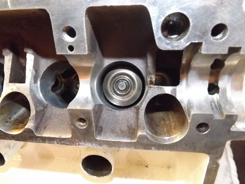

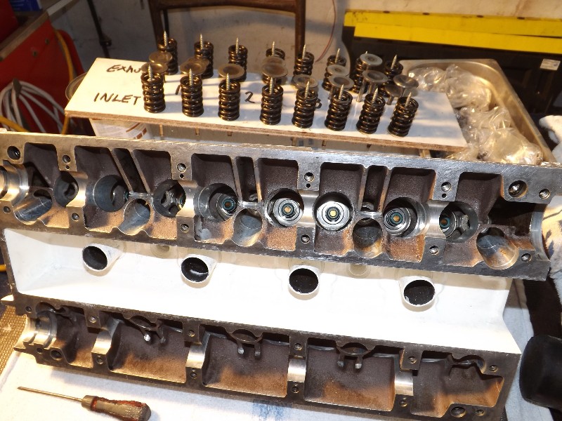

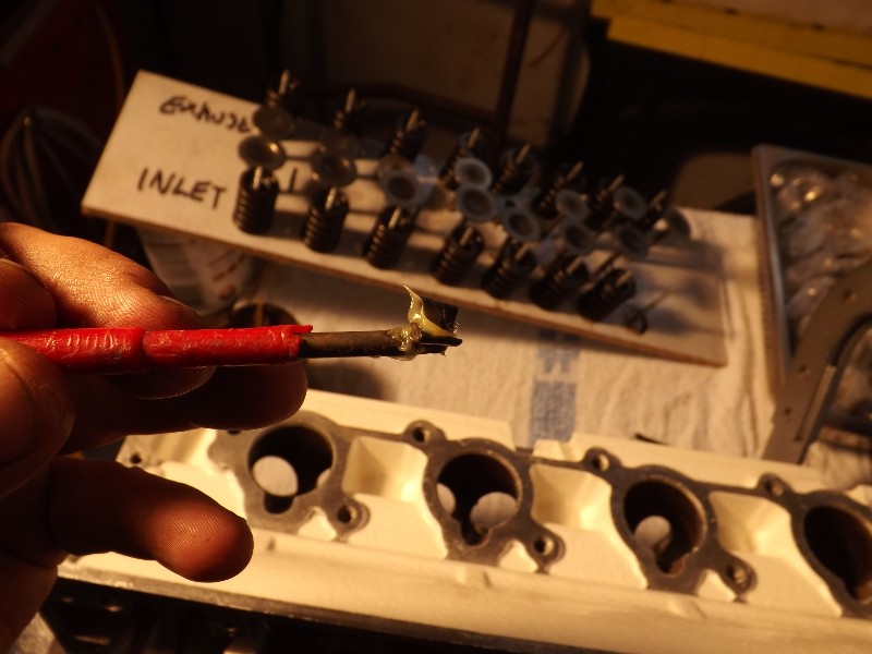

i have ground in the 16 valves so had to rewash the head to remove the grinding compounds then dried it and blew it through with air.

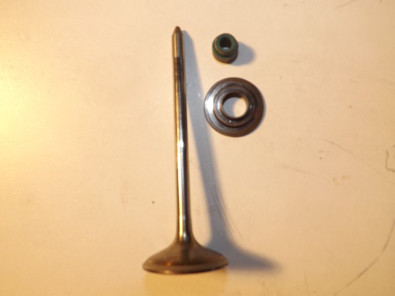

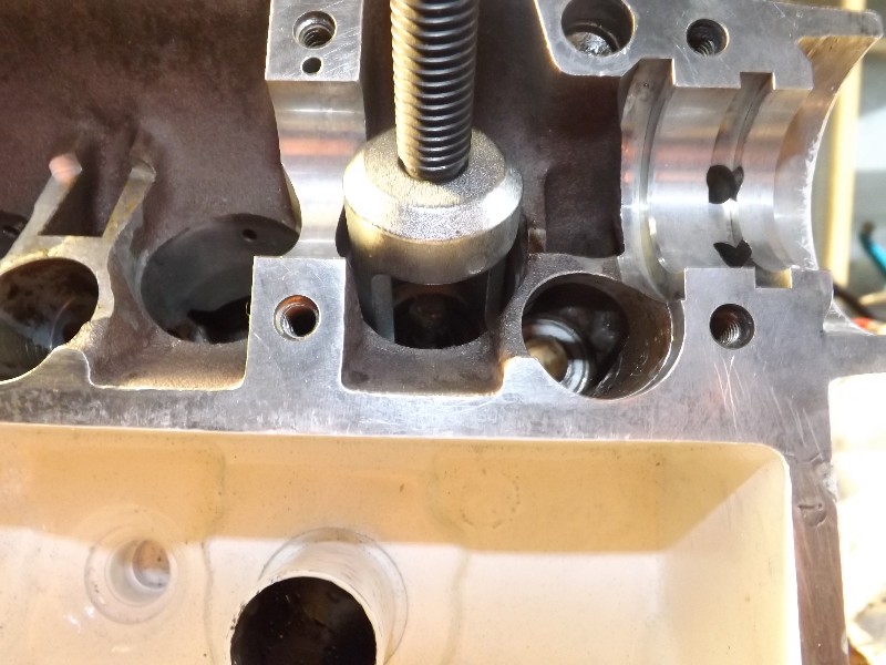

Now to fit the valve stem seals!
NOTE DON'T FORGET!!!!
the valve spring seat washers need to be fitted before the seals as the washers wont go over the seal!
with my scrap valve i ground the end to a point to enable me to use it as a guide for fitting things over the valve stem
insert valve into head,
slide spring seat over locate home with deep socket,
slide valve stem seal onto ground off valve end,
lightly tap seal home until the sound changes meaning it won't go on any farther
continue until you have done 16 Smile
now for the time consuming bit fitting the valves
insert correct ground clean valve
insert springs
place top washer over springs
compress with your valve spring compressor
making sure you have access to the valve top
Now for the fiddly bits fitting the Colet's to the valve head
TOP TIP
use a magnetic screw driver and some grease !
place the Colet's on the valve grove the grease will stick them
remove the spring compressor
valve cap should trap the Colet's nicely
to test they are seated place socket over the valve cap spring and hit it with a rubber hammer enough to force the valve open if the Colet's stay put on to the next one

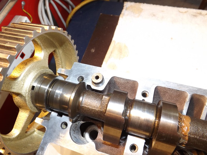

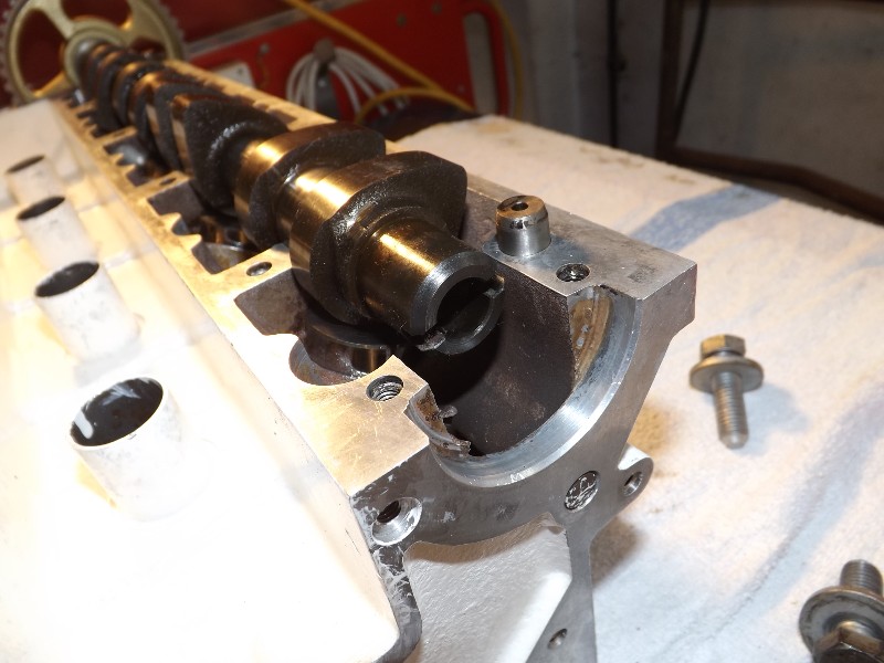

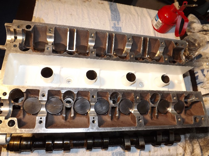

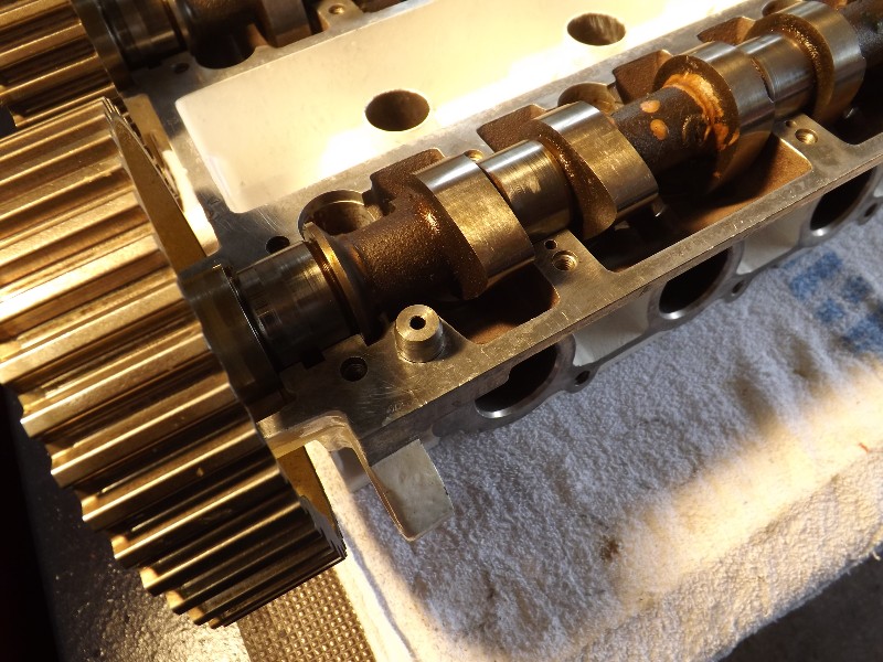

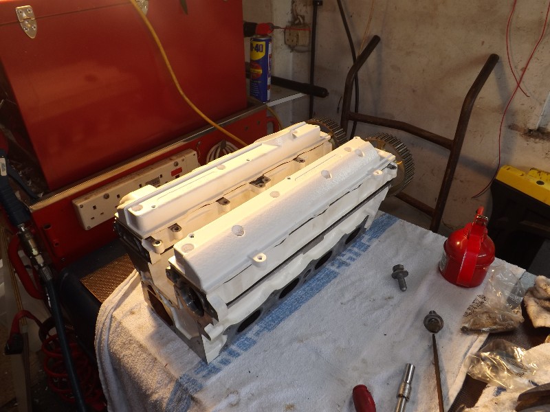

Followers installed
installed the cam carrier locating pegs 2 on each cam
to identify the exhust cam it has the drive slots and oil feed for the Vac pump
i have just loosely assembled this with no screws as i dont want to bend valves by moving it around the bench

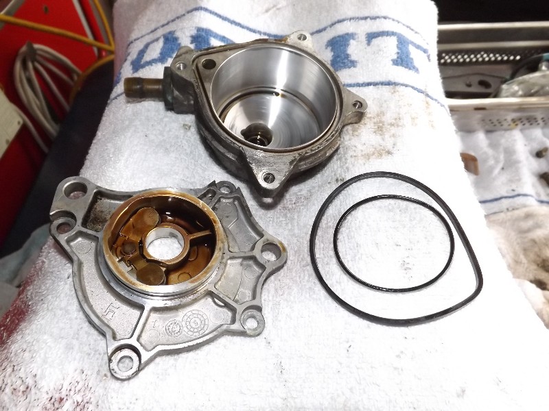

also found some more seals that might be worth changing in the Vac pump
but peugeot only list the one seal not both
4556 05 O-RING SEAL DIAM 44X48-2
Not using assembly lube on the bearings?
(01-11-2013, 12:13 PM)cully Wrote: i have just loosely assembled this with no screws as i dont want to bend valves by moving it around the bench
meaning i have not finished assemling it yet reason is my head bolt tool wont go deep into the head enough with the cams installed
(01-11-2013, 01:01 PM)Dum-Dum Wrote: Not using assembly lube on the bearings?
No not yet on the cam bearing faces but have lubed up the buckets before inserting them
Sorry mate, you posted pictures so i didn't read words

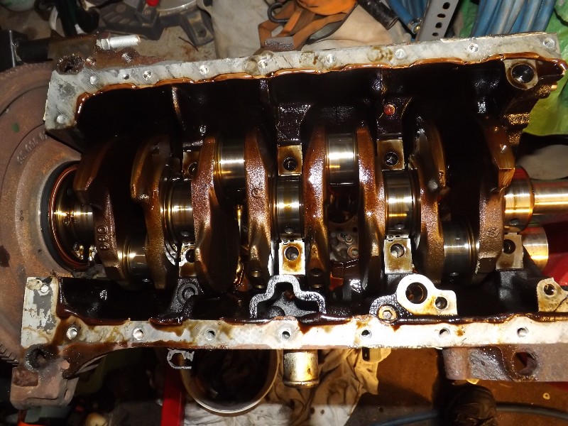

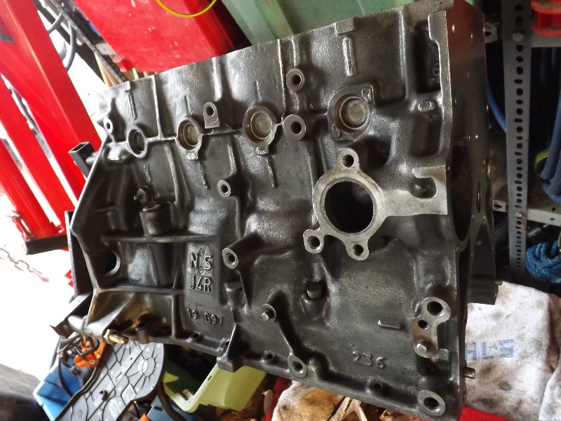

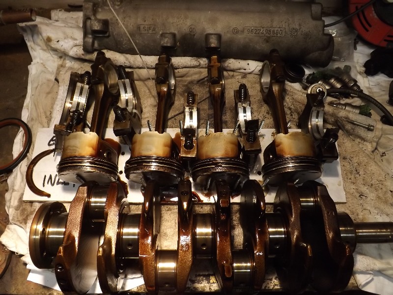

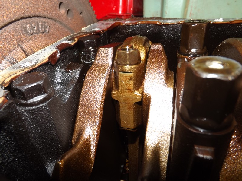

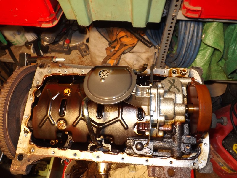

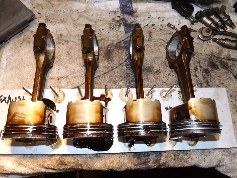

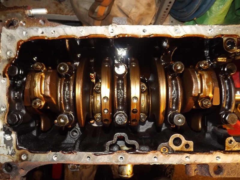

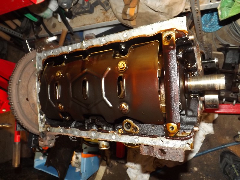

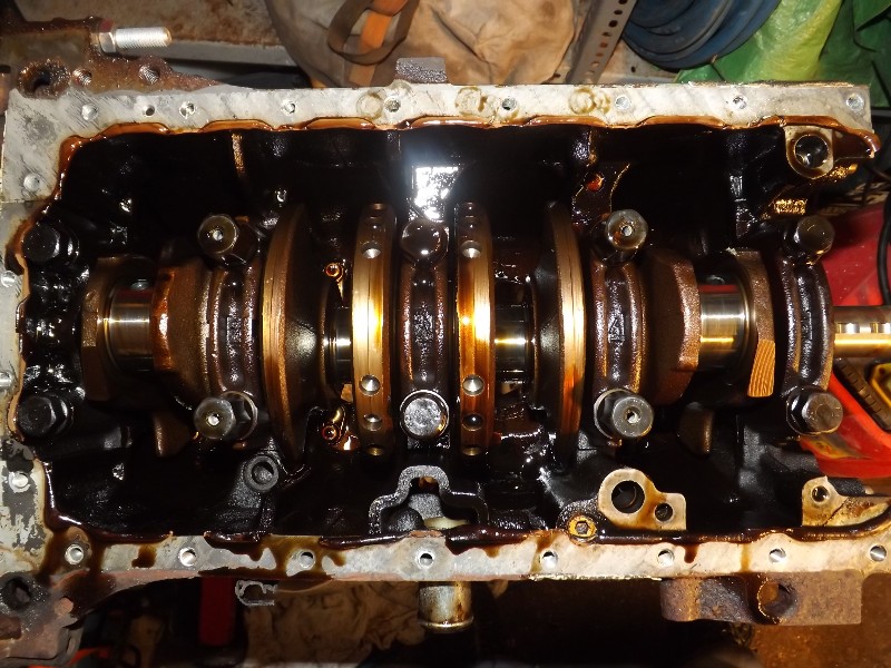

Block stripdown!
i do hope this helps someone
as i hope it helps me in putting it back together!

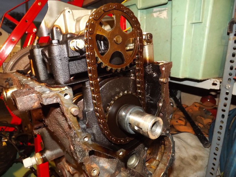

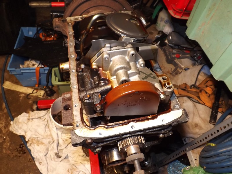

sump pan off
small crank enseal removal , oil sprocket is friction held not keyed
windage tray

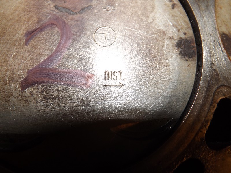

bigend orentation marks
marks to camshaft on pistons
main bearing 2 has the endfloat thrust bearings
oil spray bars are pointing at gudgion pin
Ive just been though all of that. Its all fun and games! Do you have a honing tool?
blocks cleaned ready for some paint
have also been doing some reserch into ACL Race bearings for the bottom end
Nice thread
Thats a seriously good job you've done of cleaning that block mate.

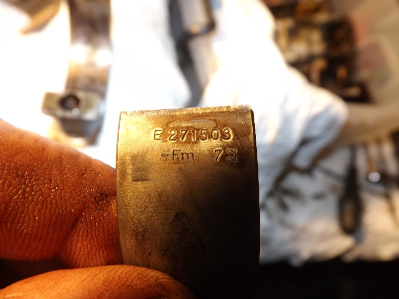

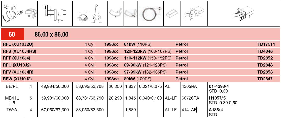

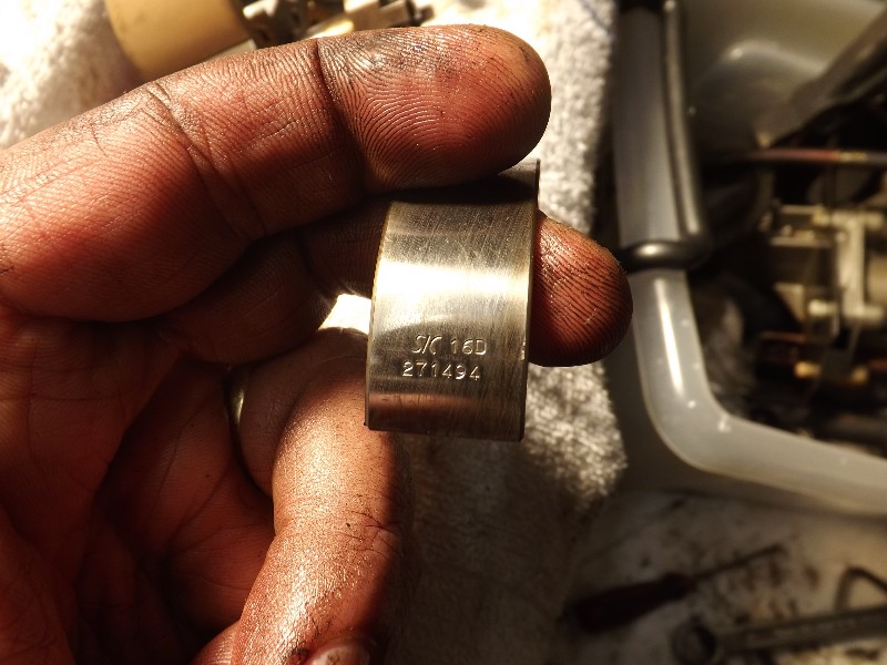

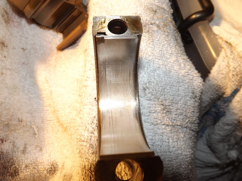

have measured my jernals on the main and big ends
main bearing 59.95mm
conrod bearing 49.95mm
checking against the ACL Info
looks as if my crank is standard and not ground
so it looks like i need
mains ACL 5M1677 /STD (Duraglide)
conrod ACL 4B7700H /STD (Race Series)
Glyco Bearing numbers
