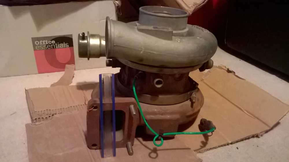

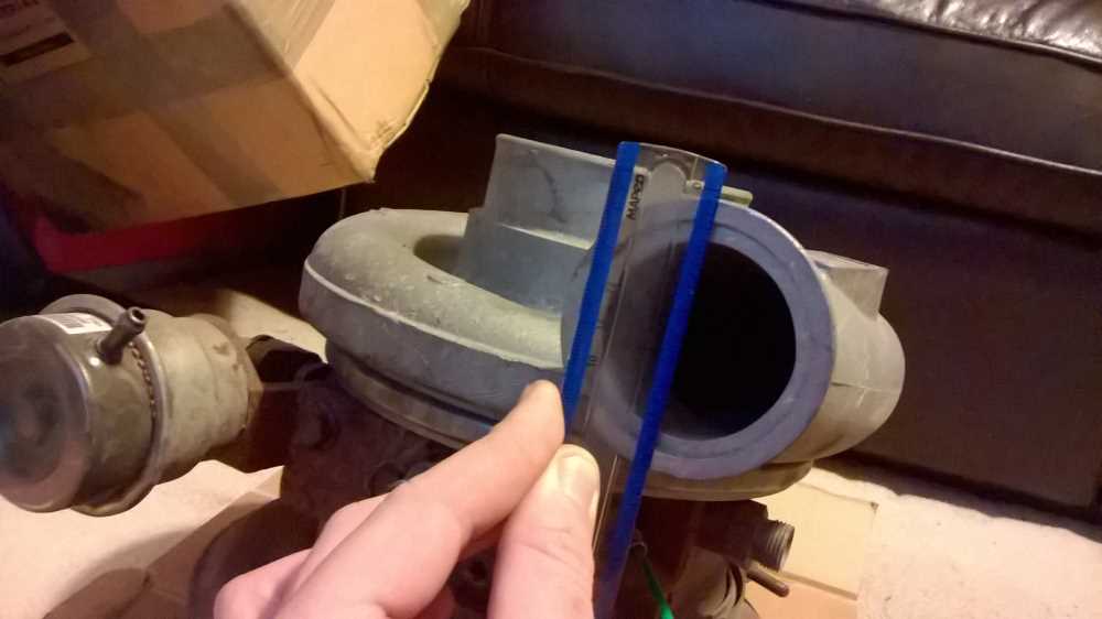

Pictures don't do justice to the size of that turbo, although here is a few more to try and prove a point.
I think I might have gone slightly overboard. The cold side had a 4" inlet and a 3" v-band outlet, the oil return is gonna need to be half inch and the exhaust fitting is a 4" v-band.
In case that doesn't talk to you lets compare it to a Ford 1.0 ecoboost block
Factor  -  HX55V  - Ecoboost
Weight  - 25.5kg  -  23.5kg
Height  -  26cm   -   26cm
Width   -  33cm   -   30cm
Length  - 22cm   -   20cm
Bigger in every factor, I'm struggling to get my head round it.

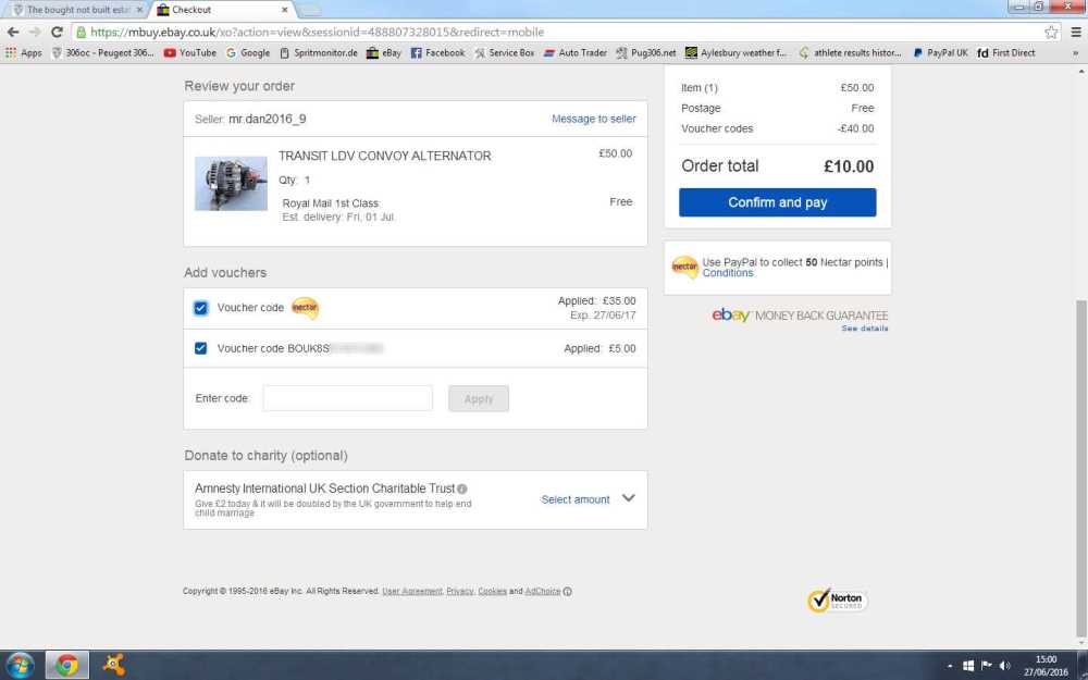

In more important news I now have the appropriate 12v alternator with built in vacuum pump for the brakes. Only issue is there is 3 outlets from the pump and I have no idea which is vac and what the other 2 are.
I went for it well before when I need it as it has the correct wiring plug for the W terminal and also the adjuster so I can use it to tension the aux belt. Also having had a 10% ebay voucher and some nectar vouchers it came out surprisingly cheap.

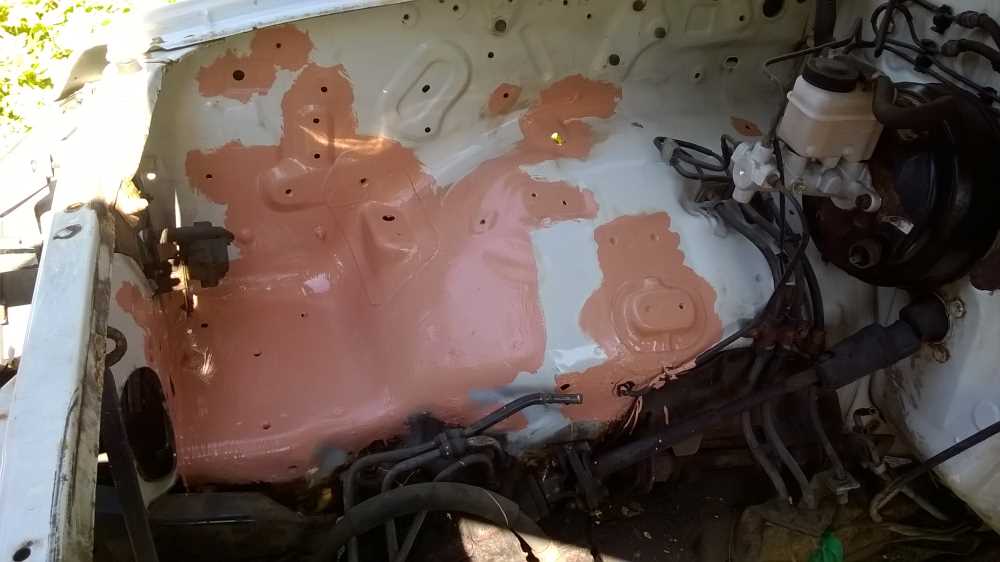

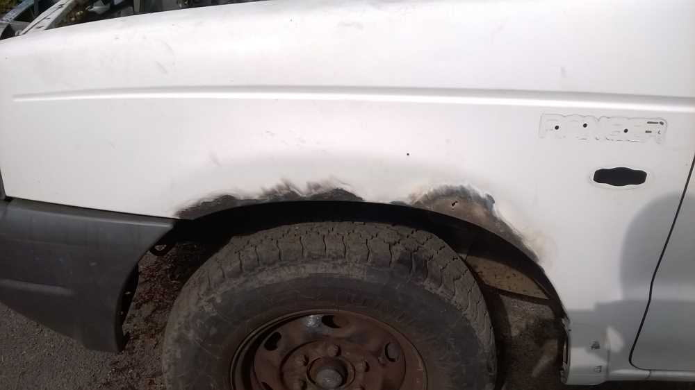

Got a little more done on the truck last week, got most of the fuses in the fuse box, need to find a handful of the big ones
I also got the wire brush out and cleaned up the rust on the front nearside of the body, still got the other 3 corners to do. Also got a patch to weld in.
Painted the bare metal with some rust treatment too. I need some dust masks before I deal with any more rust as I inhaled far too much doing this 1 corner.

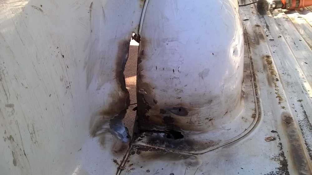

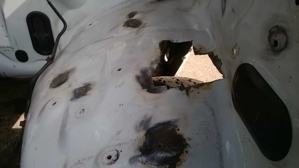

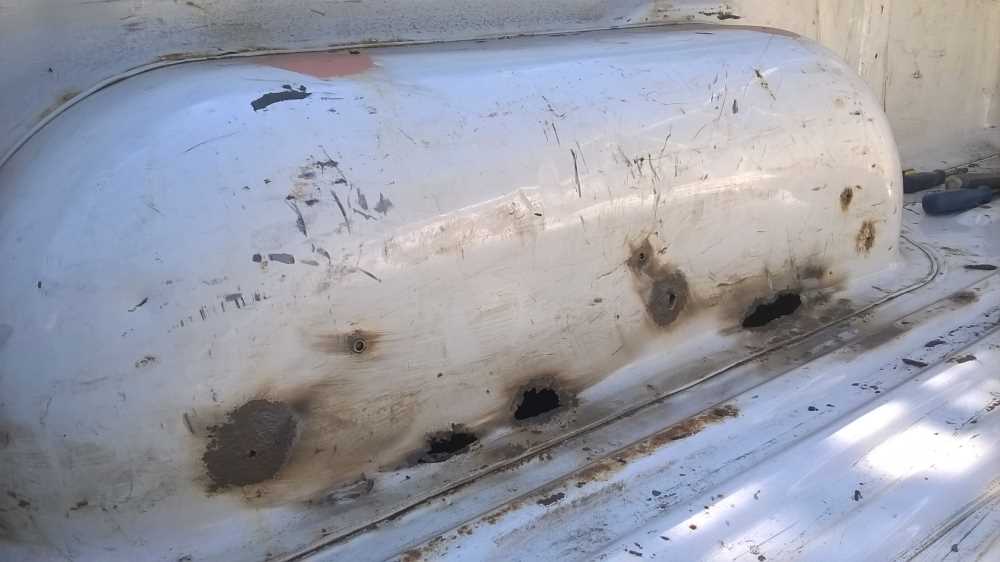

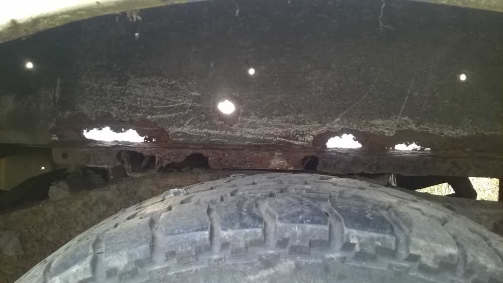

Started cleaning up some more rust with the intention of painting it. Went for the nearside of the bed only as it was closest to the extension lead and after removing the arch liner and mud flap started to find it to be horrifically rusty. There was a huge bit at the back of the inner arch that just crumbled to nothing as well as the bits in the pics being through 2 and three layers of metal. Essentially the bed is scrap but this is no problem really as I can make a nice old school looking wooden flat bed (in a new metal frame).
Edit; yes I could weld a load of patches in but it will be quicker and easier to knock up my own bed.

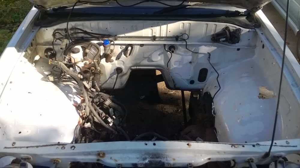

So after giving up on the bed I went back to finishing the bay, I cleaned up some more rust with the wire brush cup, gave it a couple of coats of rust killer then a coat of white metal paint. It needs another coat of white but it's looking pretty fresh.

(07-08-2016, 01:50 PM)tigerstyle Wrote: What brand rustkiller are you using? Do you rate it?
all the painting prep means closer to engine bits going in, yay!
It's hammerite rust killer, never had a problem with it but you really need to get any loose paint and loose rust off before you apply it.

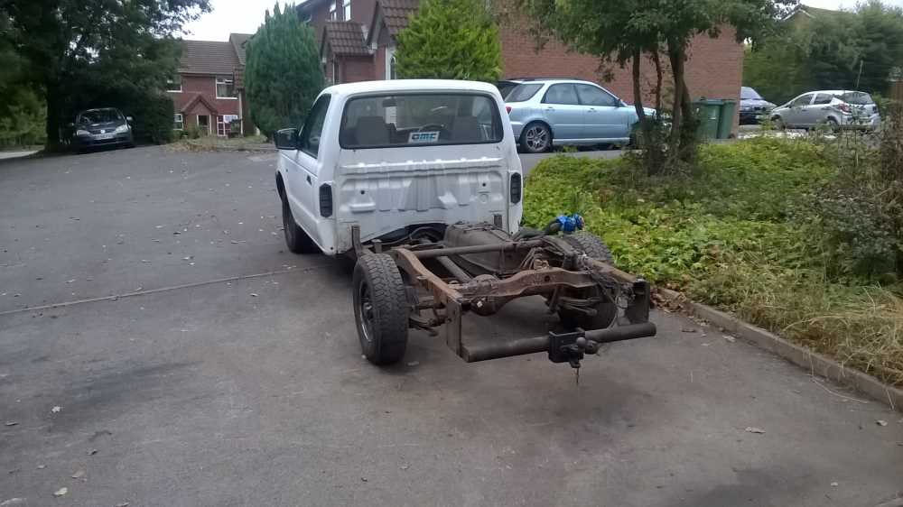

The rusty bed is off the truck!
I had to cut the back end of the bed off to get the rest off as I couldn't get to the final 2 bolts.
And I rolled the bed off using the high lift jack and some brute force Smile
And now she sits looking like this. The chassis is flakey but solid, mainly it looks like the paint is flaking off so I'll just do the chassis in red oxide, then a coat of white to keep it looking good and I'll waxoyl the inside of the chassis legs.

have you sorted out a replacement rear?
there it goes! how many bolts actually hold the bed to the chassis?
(22-08-2016, 11:30 PM)procta Wrote: have you sorted out a replacement rear?
Rear axle no, lack of money and they have started climbing in price and I'm not paying a grand for the axle I want.
Rear bed/tub also no. I'm not replacing it like for like, I'm gonna do something different, Possibly a plain wooden flat bed (with steel frame obvs).
(23-08-2016, 08:42 AM)mr_fish Wrote: there it goes! how many bolts actually hold the bed to the chassis?
8 bolts total plus rear light wiring and the fuel filler.
The front 6 bolts (3 each side) sit just outboard of the chassis legs and are really easy to find and come undone unexpectedly easily (half turn with the breaker then the rest on the ratchet) The rear pair are inside the chassis legs and access is obstructed by the tow bar which no doubt you won't be able to remove because the bolts will be rusted to f*ck.
That's why I cut the rear section out. Just cut around the bar that rests on the chassis and has the bolts in.
