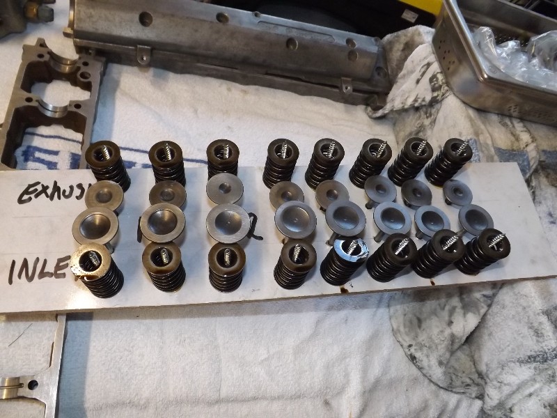

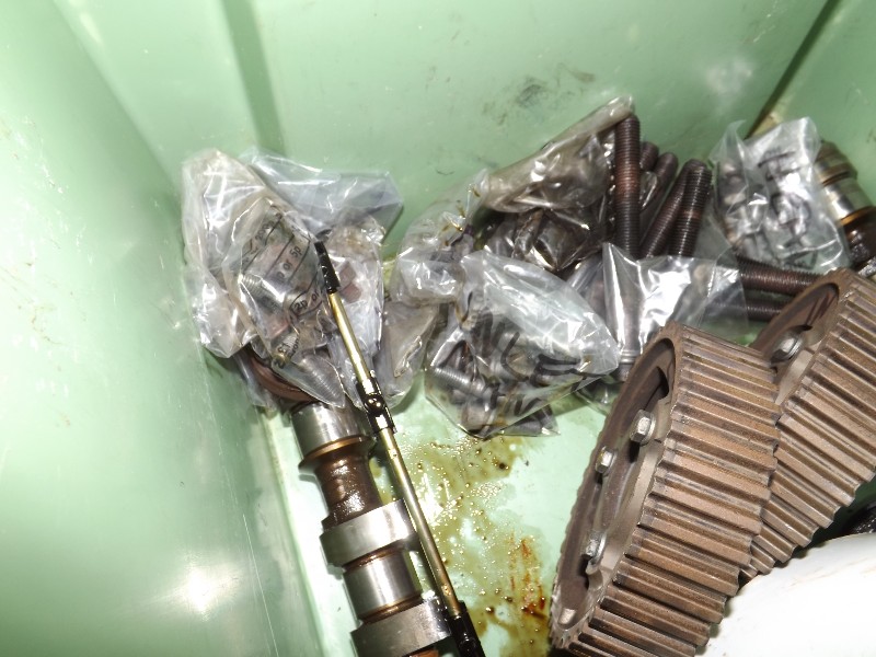

keep all your bolts in sets and seperate them from each other
ie:
inlet mani bolts
exhust mani bolts
rocker cover bolts
cam carrier bolts
cambelt cover bolts
ect ect
it makes it easyer to sort out which bolt go's where
i have used bank bags for this, there free go and ask for some at the bank Wink

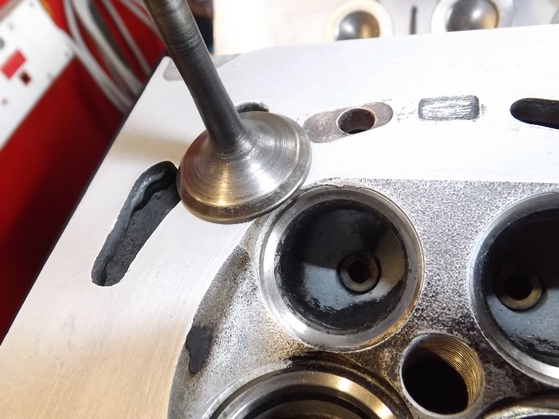

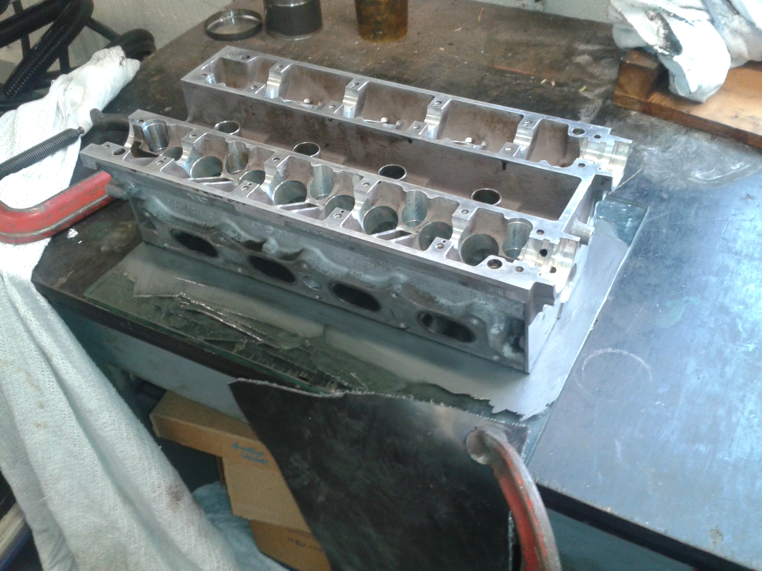

the head is saved!
ok
to check the head for true
sheet of glass on a flat surface, coat the glass in engineers blue which is a dyed grease,
now rub the head in a figure of eight motion on the glass and blue,
role head over and the high spots will pick up the blue on the head the unmarked areas are low points,
my head was almost all covered,
so i decided to "lap" the head instead of haveing it skimmed as the head was at its maximum cut
to lap the head is the same principle as the engineers blue method but with fine grinding paste,
coat glass with fine grinding/lapping compound
place head on glass and rub in the figure 8 motion
perodicly check buy turning head over you are now looking for a unifom grey finish
this then means you have taken enough meterial off to flaten the high spots
you can recheck this with the engineers blue but you can see the finish easy when you clean the face with WD40 it looks clean and grey
remember you need to clean the head well as you have used gringing compound
you dont want this in the engine
so now i have 16 Valves to clean and to lap in should take me a while Smile

ok finished head hight still at tollerance
and finished head face

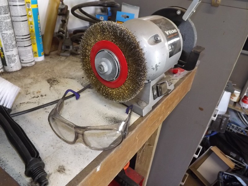

New Tool time!
i bought a 150mm wire brush for my bench grinder just for cleaning up the valves (£7 tool station)
it made light work of cleaning up the exhaust valves of the carbon deposits
on the stem side i only cleaned up to the valve guide so to minimise damage to the stem
valves are ready to be ground in once the heads pressure tested
Warning though!
always use goggles with these and any grinding wheels
your eyes are important to you

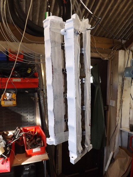

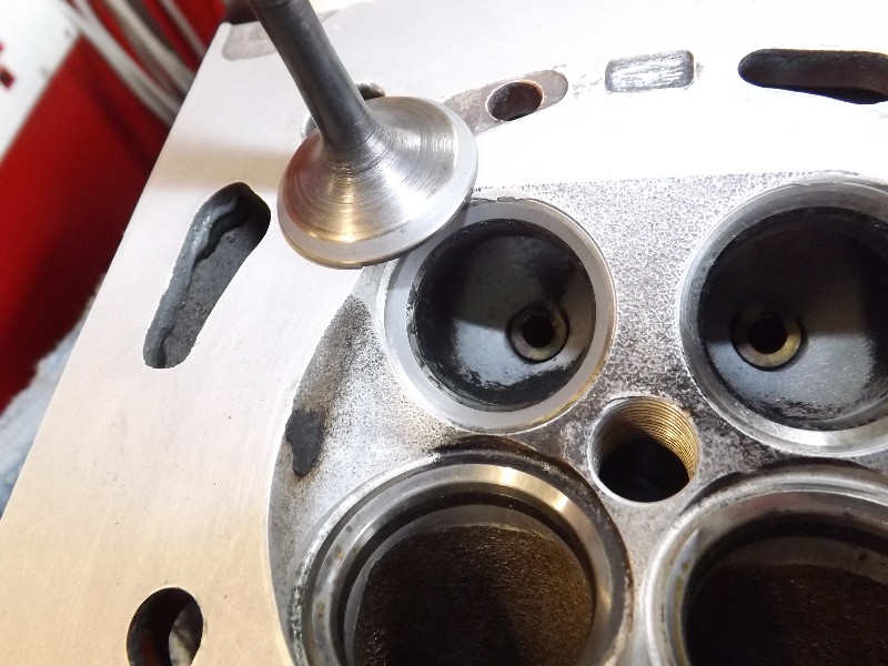

might of got a little carried away with the alloy primer Blush

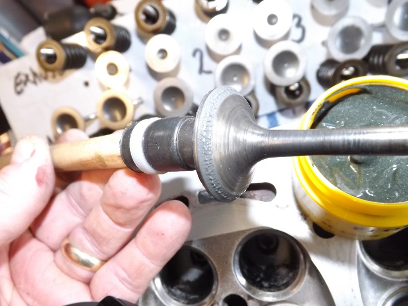

Valve grinding quick how to!
1. Take the correct valve for the valve port you have stored,
NOTE: the valve seat and the head seat how the mating surfaces are rough and discoloured this is poor seating
2. add small amount of fine valve grinding compound to valve seat area only
NOTE: dont get this on the valve stem as it will mess up the guides
3. slide valve carefully into valve guide using hand tool, using palms of both hands rub the stick as if your trying to light a fire
3. after a short period remove valve clean surfaces to check for seating
NOTE: you are looking for the grey colour ring, all around the valve seat and the head seat
things to watch for
bent valve!
if you have a bent valve the head seat will cut to the gray ring, but the valve will only show part the grey ring !
you have a scrap valve, no matter how much grinding you do you probably wont recover the valve before you grind the seat too deap
