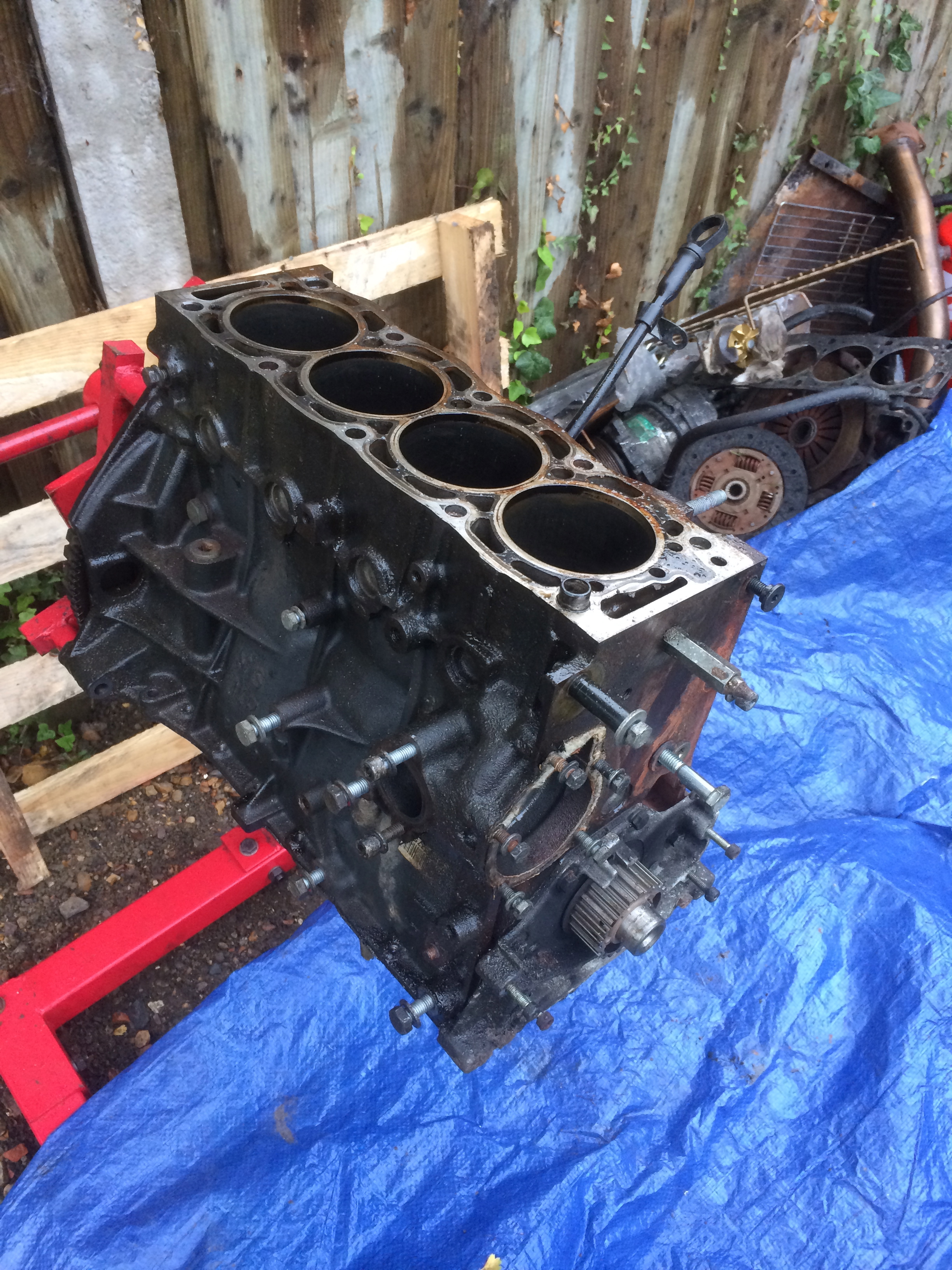

Right done some work on my spare engine today. Went to pick up my bargain engine stand from a really nice bloke on the 205 forum who also had a beautiful 205 with a gti6 lump in.
Bores are in a surprisingly good condition considering the engine has done 102k. The top end had recently had a rebuild i think but after taking it apart, the bottom end hasn't been touched. The engine was a snapper however it snapped at idle and the only damage to the bottom end is a mark on one piston in the carbon on top of the piston lol.
Tomorrows job is to clean up the pistons, remove the old rings and start giving the block a good clean ready for tarting up.

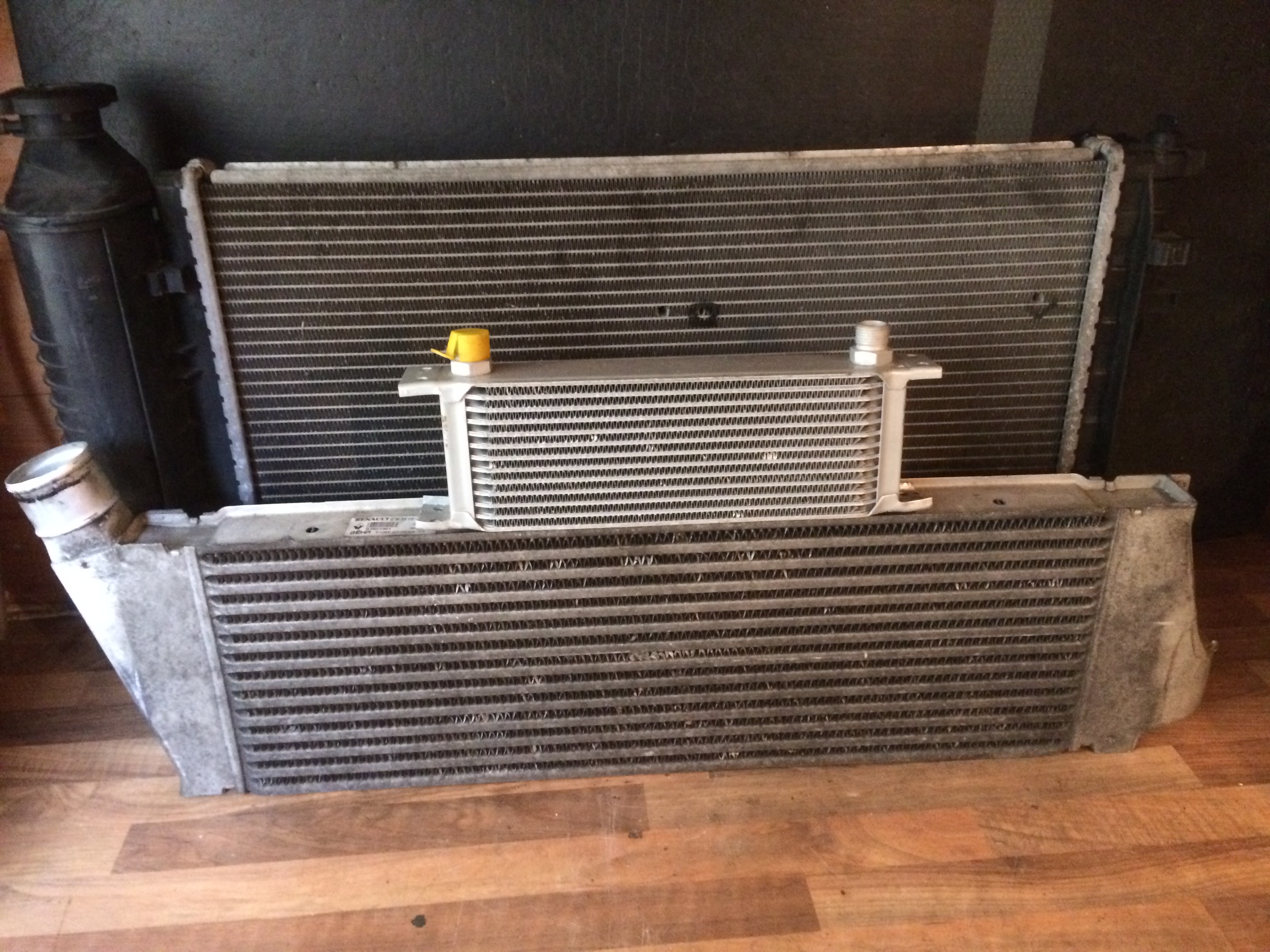

New rad, R26 IC and Oil cooler

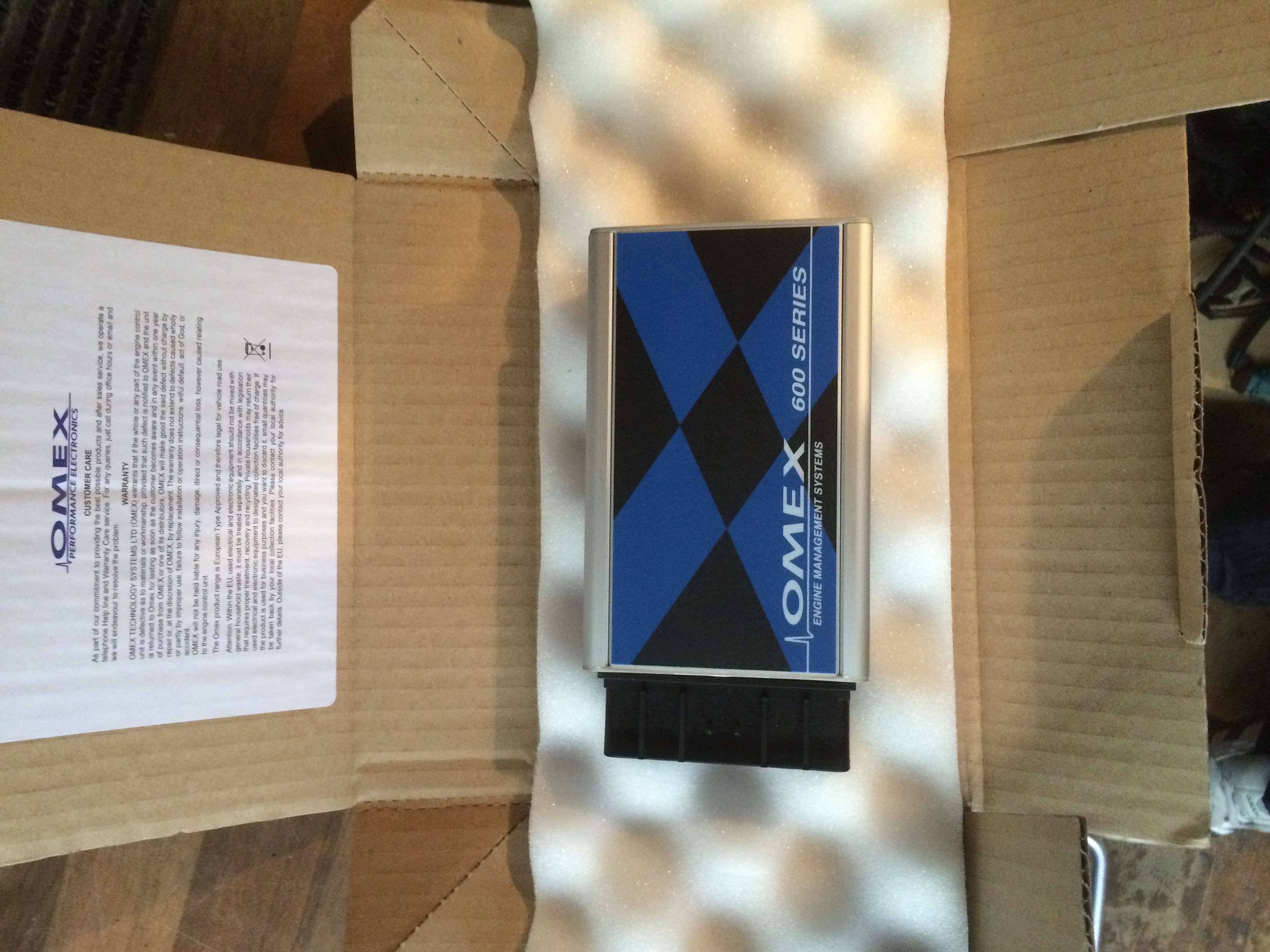

Nice new Omex 600

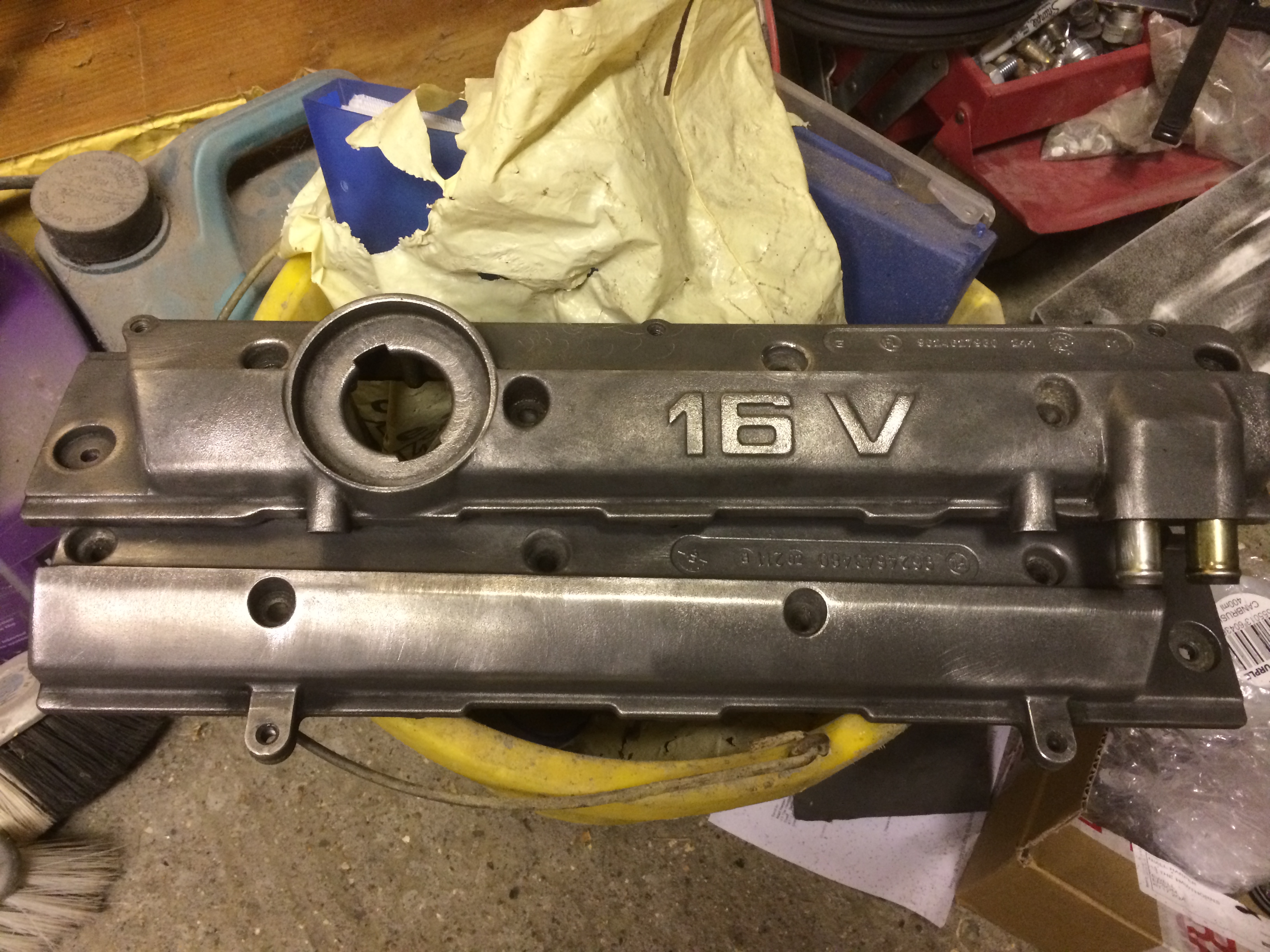

Refurbished head.

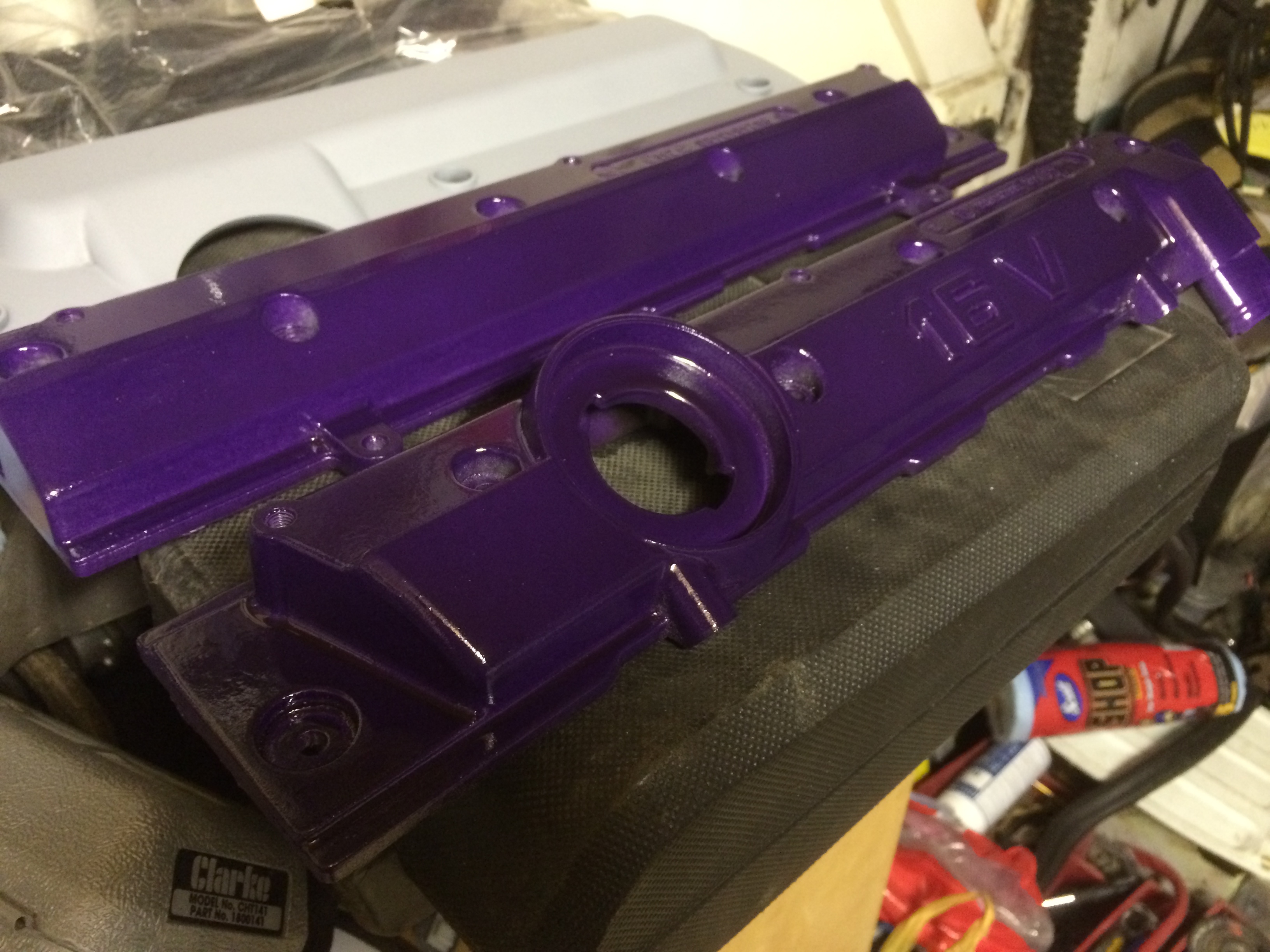

Still deciding on a colour scheme for the engine bay but i have a feeling it will include candy purple lol.

that R26 IC looks exactly what I was after when looking for one...
you hoping to go up and over with the pipework?
Not sure tbh. The right hand outlet goes straight back so should go past the rad nicely. Haven't decided what to do about the other side yet lol.
Yeah dan it was Smile
Yeah I was thinking that...gets rid of extra needed 90degree bends etc.
The only way to do the other side is over the top of the rad and under the slam panel, unless you're going to start mucking about with a different size rad or hacking up your light cluster.
Just a sign of things (or should i say colours) to come...
love candy purple will be keeping an eye on this Smile

Yesyesyesyesyesyes! Such epicness, looking forward to every update! Smile
Lol need to paint a few other bits that colour then just tidy everything up in general. Not going to OTT as it will just get dirty again lol
