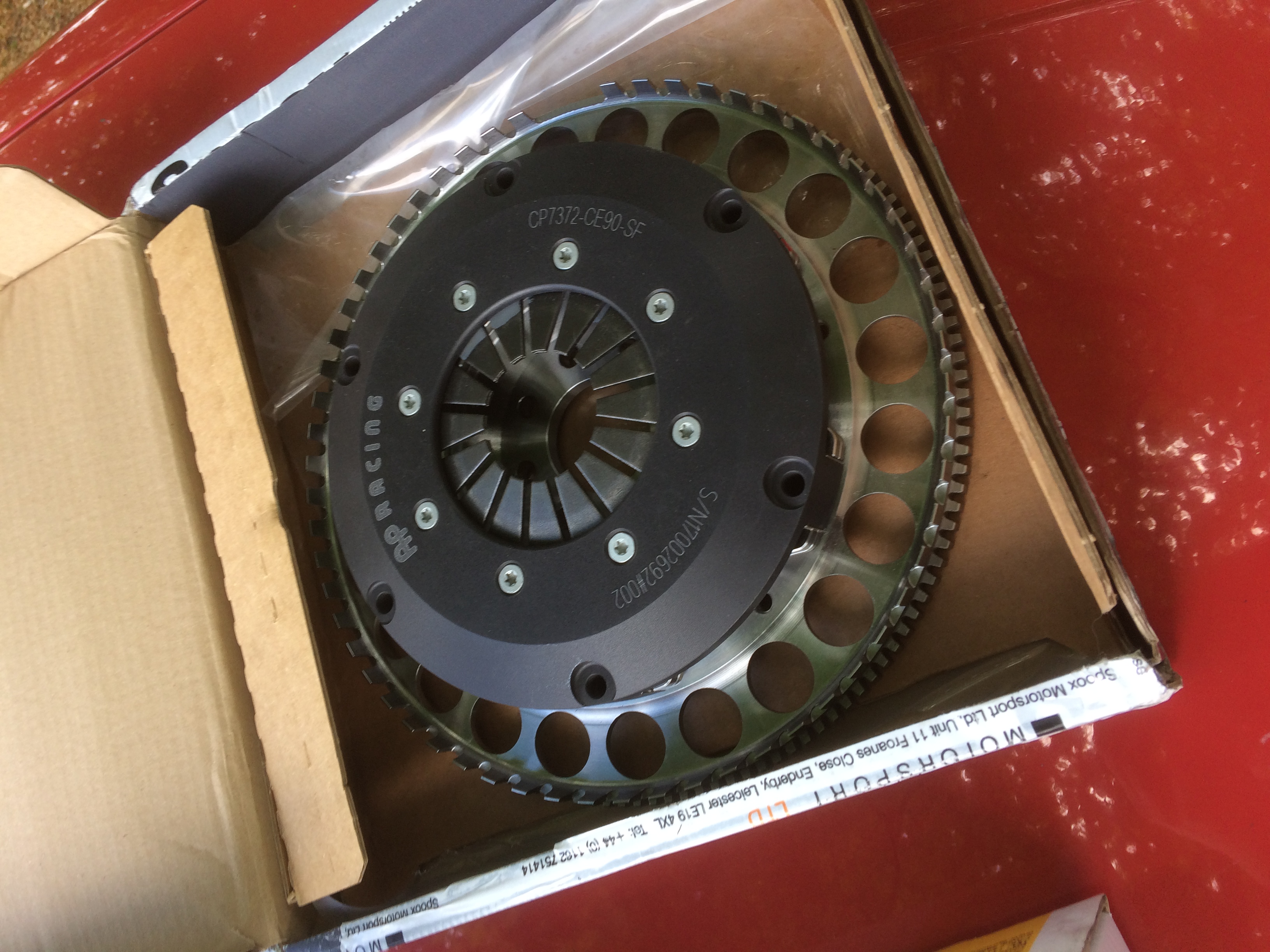

My AP twin plate clutch arrived last night! Off for balancing tomorrow.

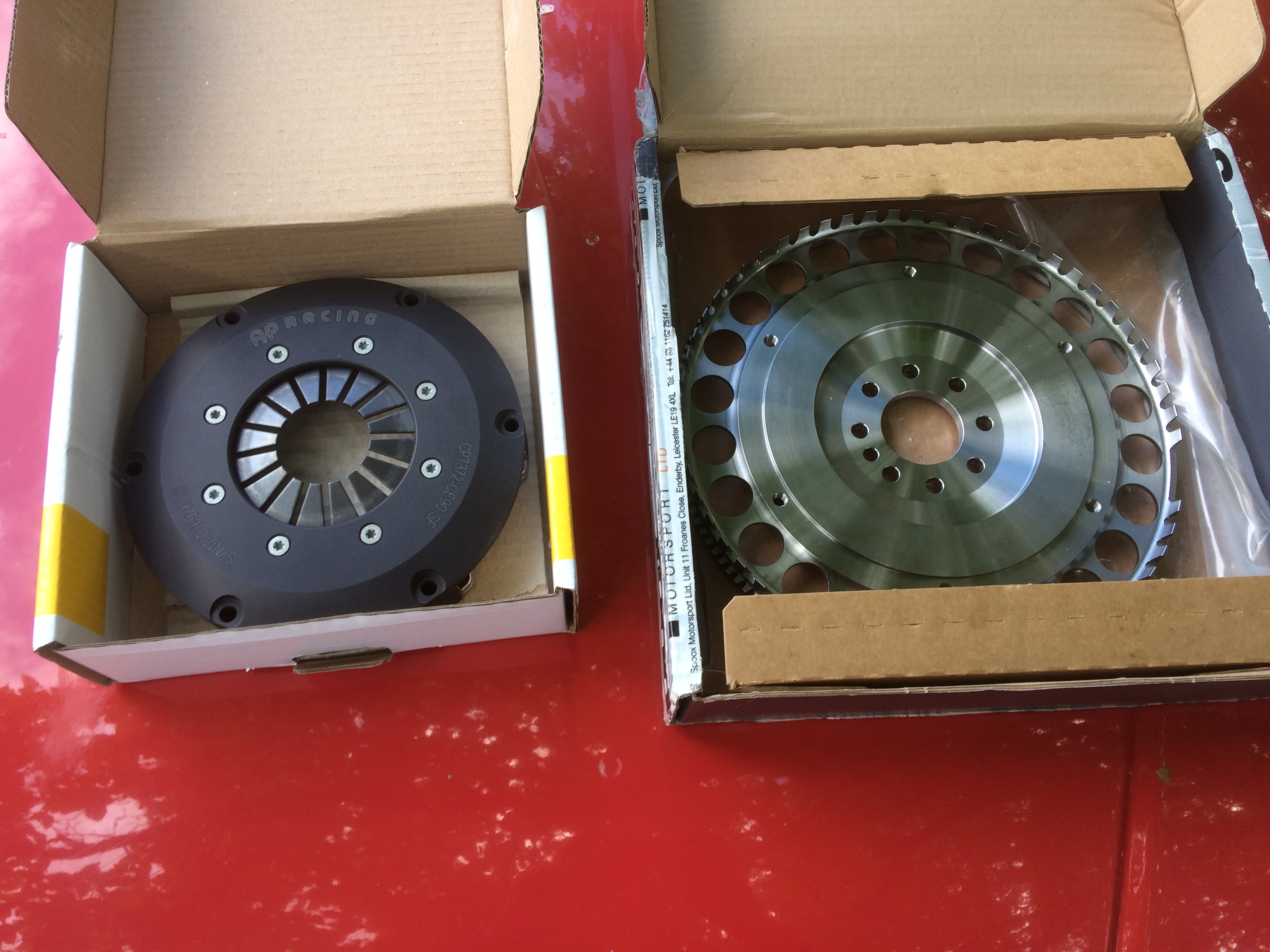

28-04-2017, 10:30 PM
Just a pic of my sexy clutch! I'll get some of the car next week as work progresses

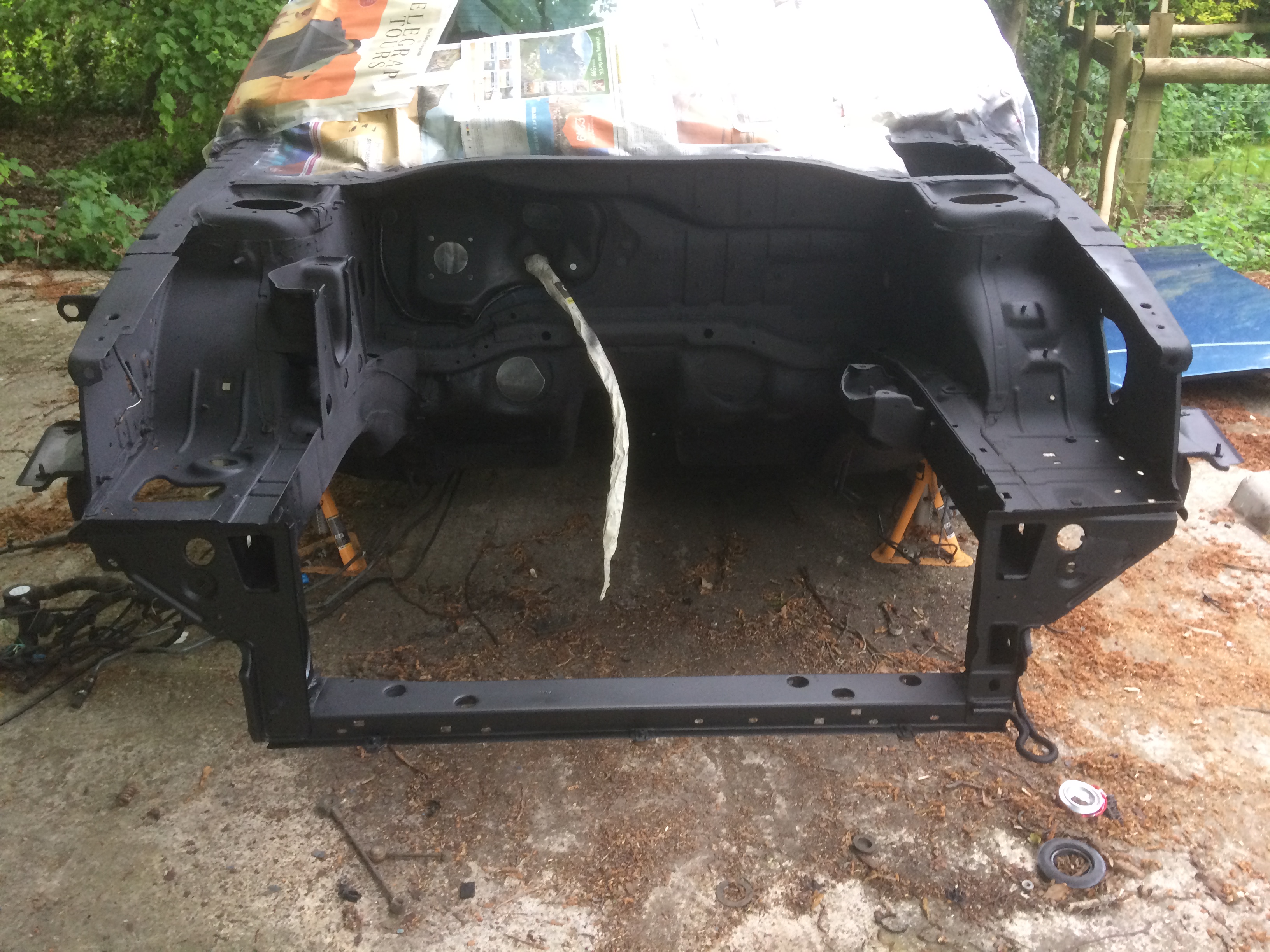

07-05-2017, 05:39 PM

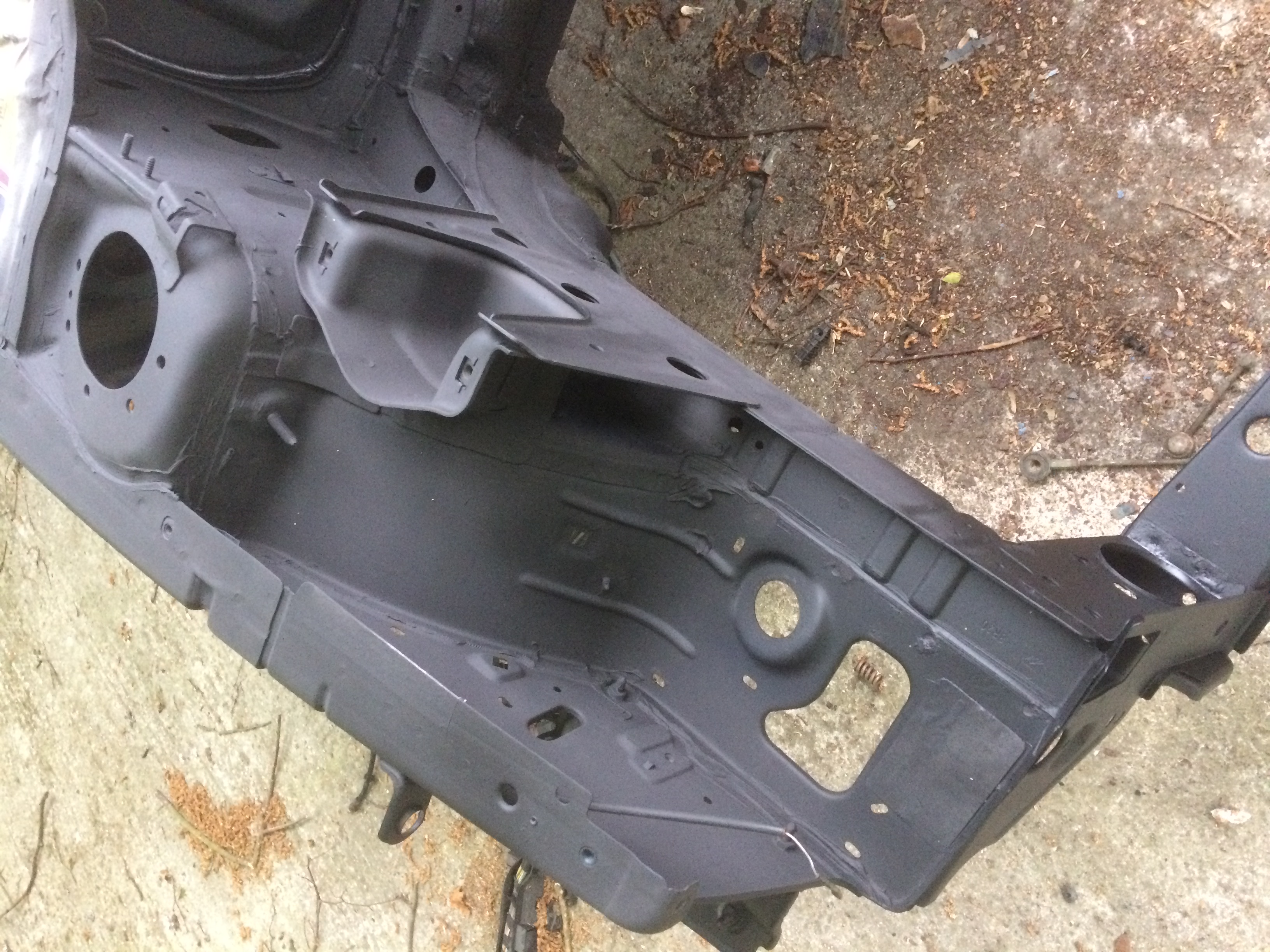

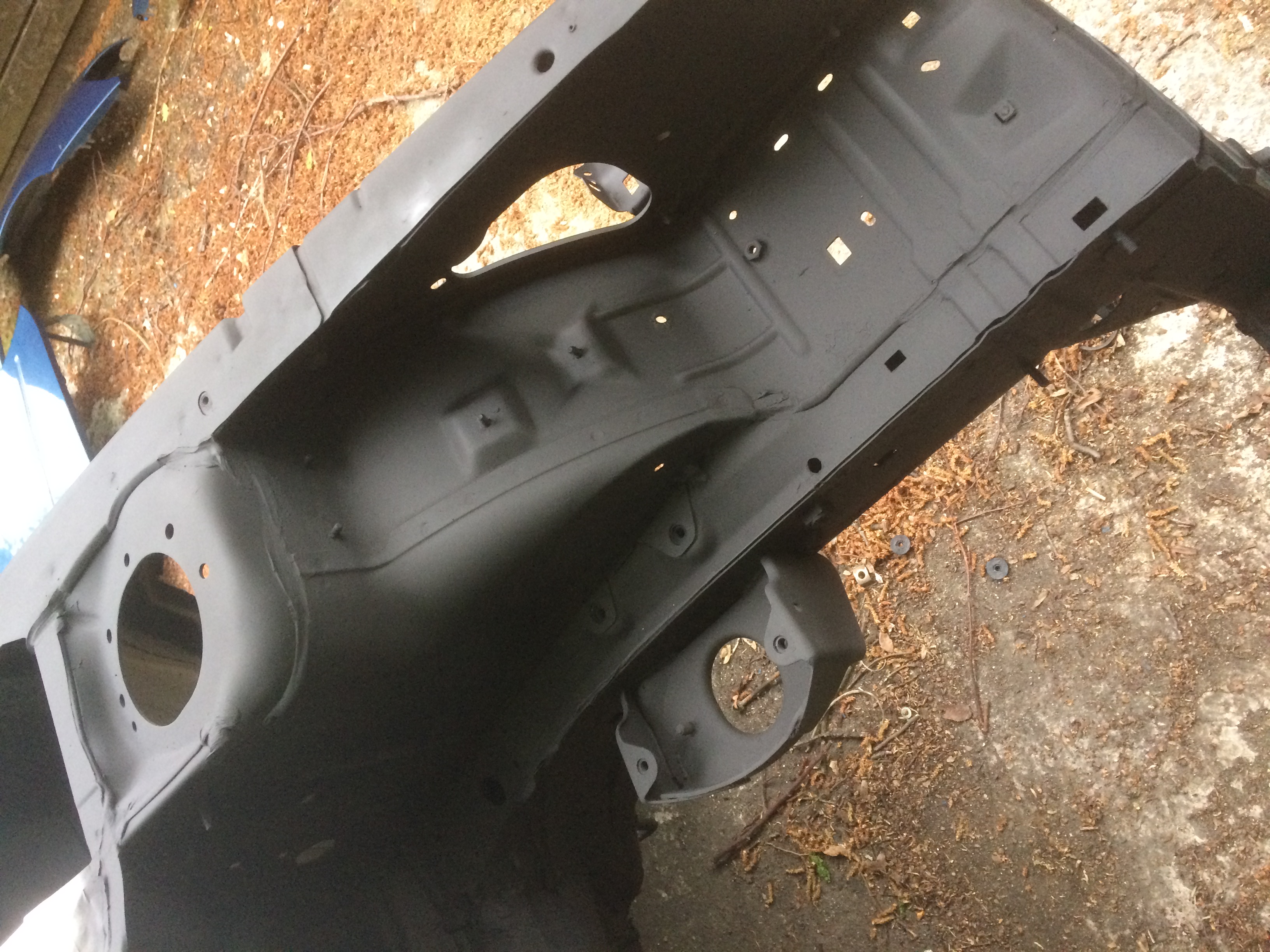

Good day on the car yesterday, finished stripping the engine bay out, got it cleaned up and paintedĀ
Came out ok I reckon, not perfect but it's not a show car so I'm happy. Next job is to get the subframe cleaned up and reinstalled with my vts rack

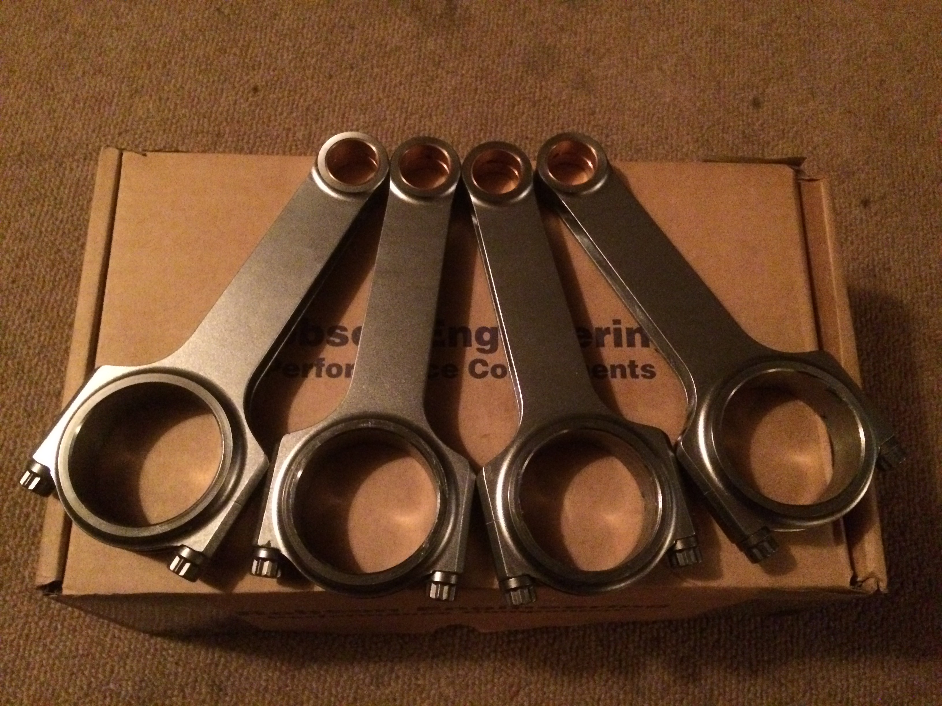

I have a set of rods from Robson Engineering, while I do agree usual chinese stuff isnt the best, has anyone actually blew a set of the chinky rods yet? I would definitely consider them.
