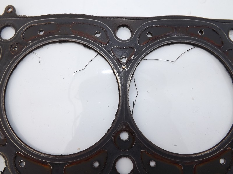

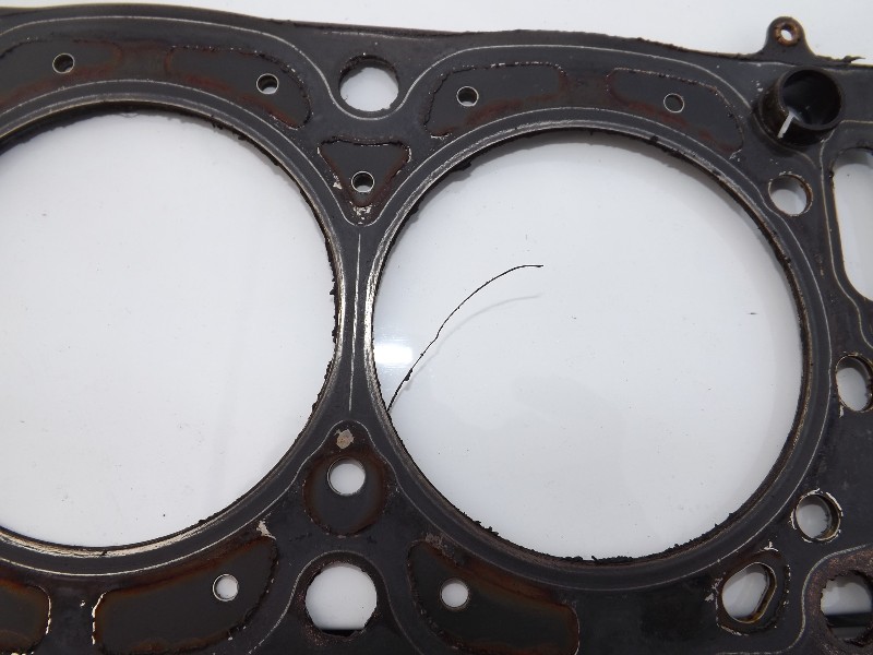

heres a picture or two of the wire burs comming from the headgasket
do you think they would mess the valve seating up??

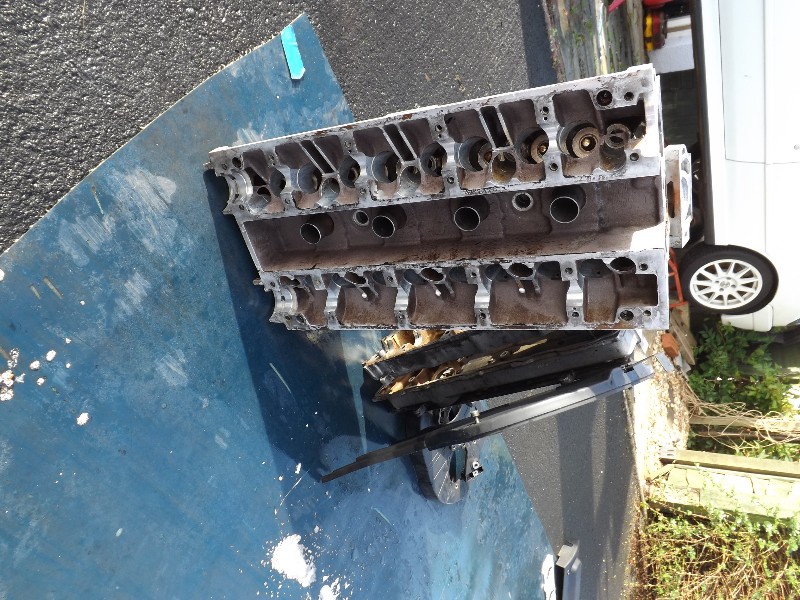

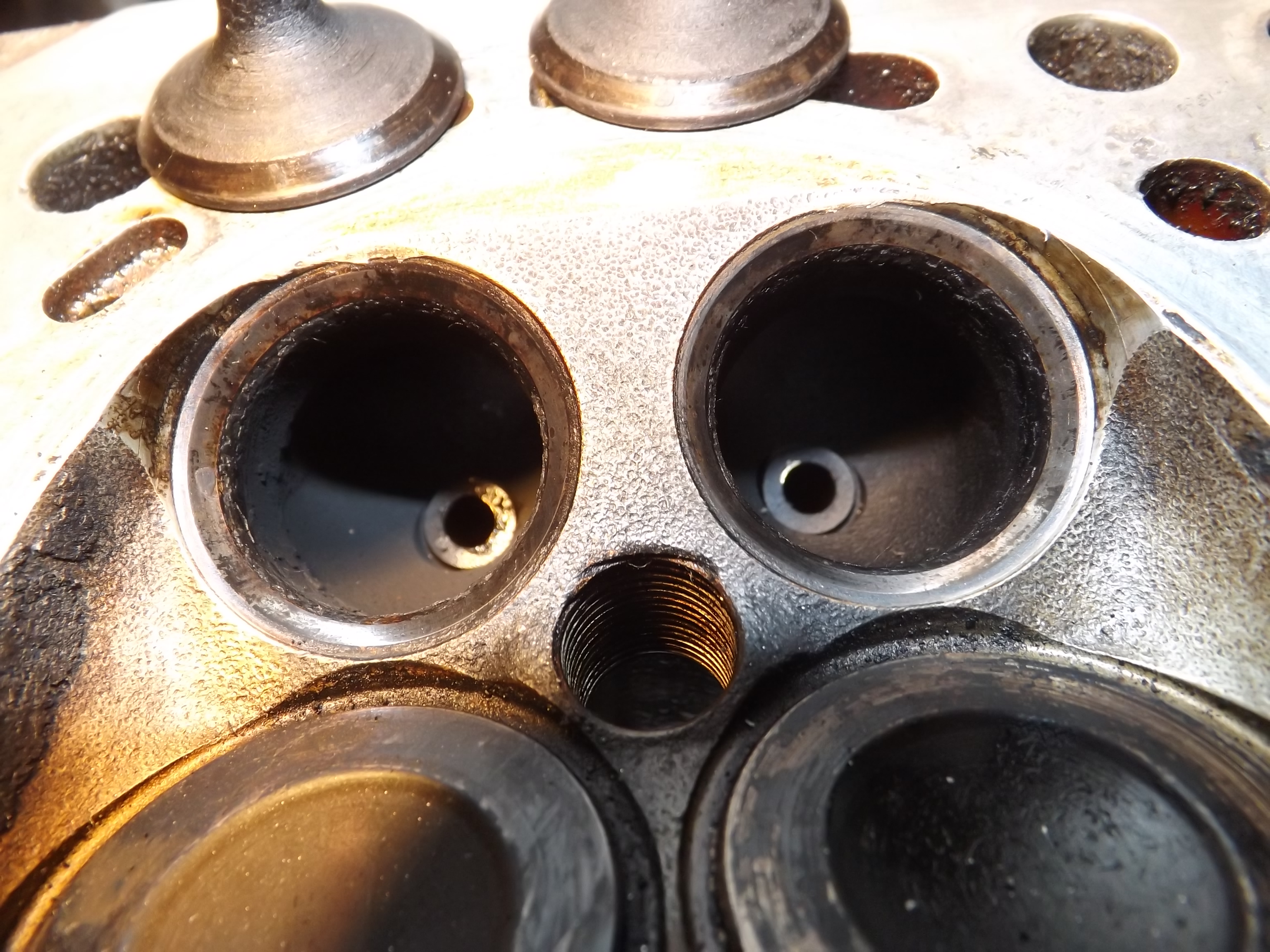

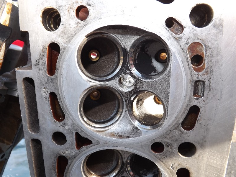

Are you sure that valve/piston damage is old as the valve cut outs are full of carbon and id expect that if there was going to be valve damage pre rebuild then the valves would hit the cut outs rather than missing because (i'm assuming) someone has badly cut the valve guides so they aren't at the angle they should be.
#41

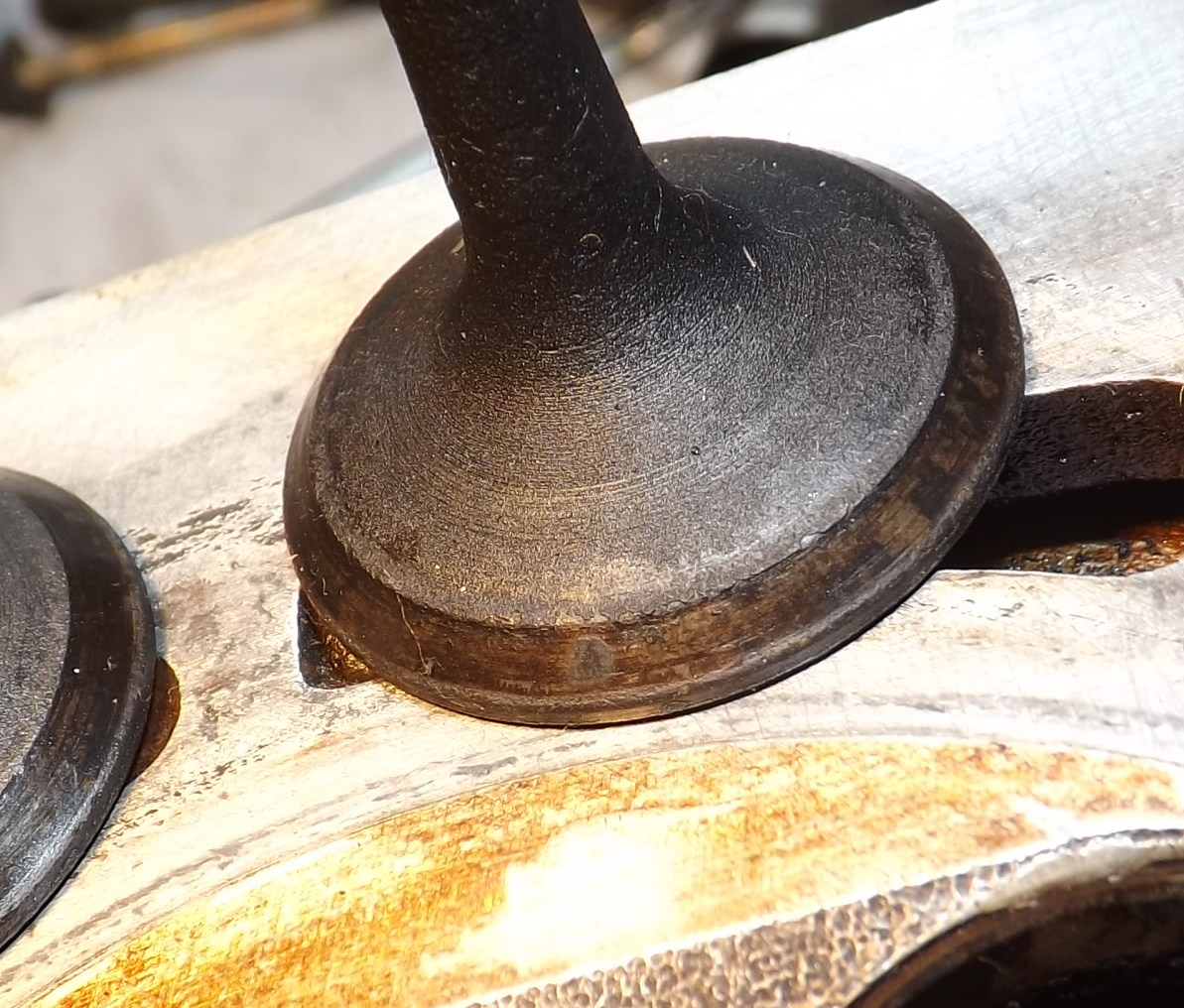

today ive cleand the workbench and the garage up a bit so ive got the head on the bench have taken out number 1 exhust valves and i have found carbon foulings on the seats the valves themselves look good!
i think this engine needs a damn good de carbon and a refresh
and it will be a good one Smile
Valve seats need lapping in but look good other than the carbon
Valves themselves look good other than the build up of carbon

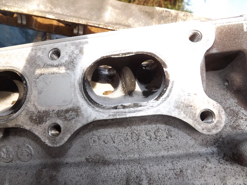

what i need to know now is how do i know if the head has any meat left for skimming
how do you measure the original head hight or whats left of the head ????
#42
There should be notches on the head that a machine shop will be able to tell if ιts got meat left on or ιs scrap bud

yes these pistons are flat with valve cutouts but if you look carefull you can also see previous valve contact

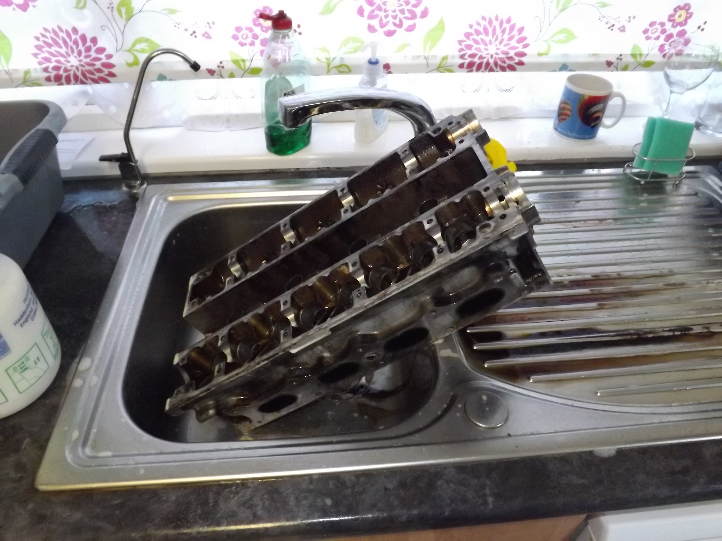

meanwhile in the kitchen!
#46
thats sooo win!!!! going to but my wheels in the sink and wash them see how well that goes down with the mrs lol

i do that quite often, and generally use up all the scouring pads and sponges getting to all the oily crap..lol
engine degreaser and an old dishwasher is an interesting idea though.. Smile

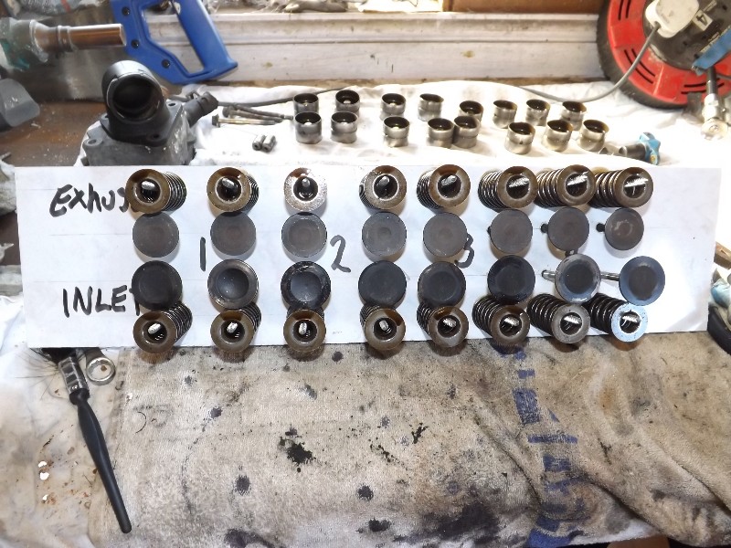

tip i forgot to add when taking the valves out the head!
make yourself a board to hold the springs washers and valves it will help keep things organised for when you reasemble or grind the valves
so back to the head cleaning Big Grin
TRF solution and a pressure washer
jobs a good one dryed off with an airline then sprayed the valve seats with WD40 to stop them rusting before i send to the machine shop for checking
