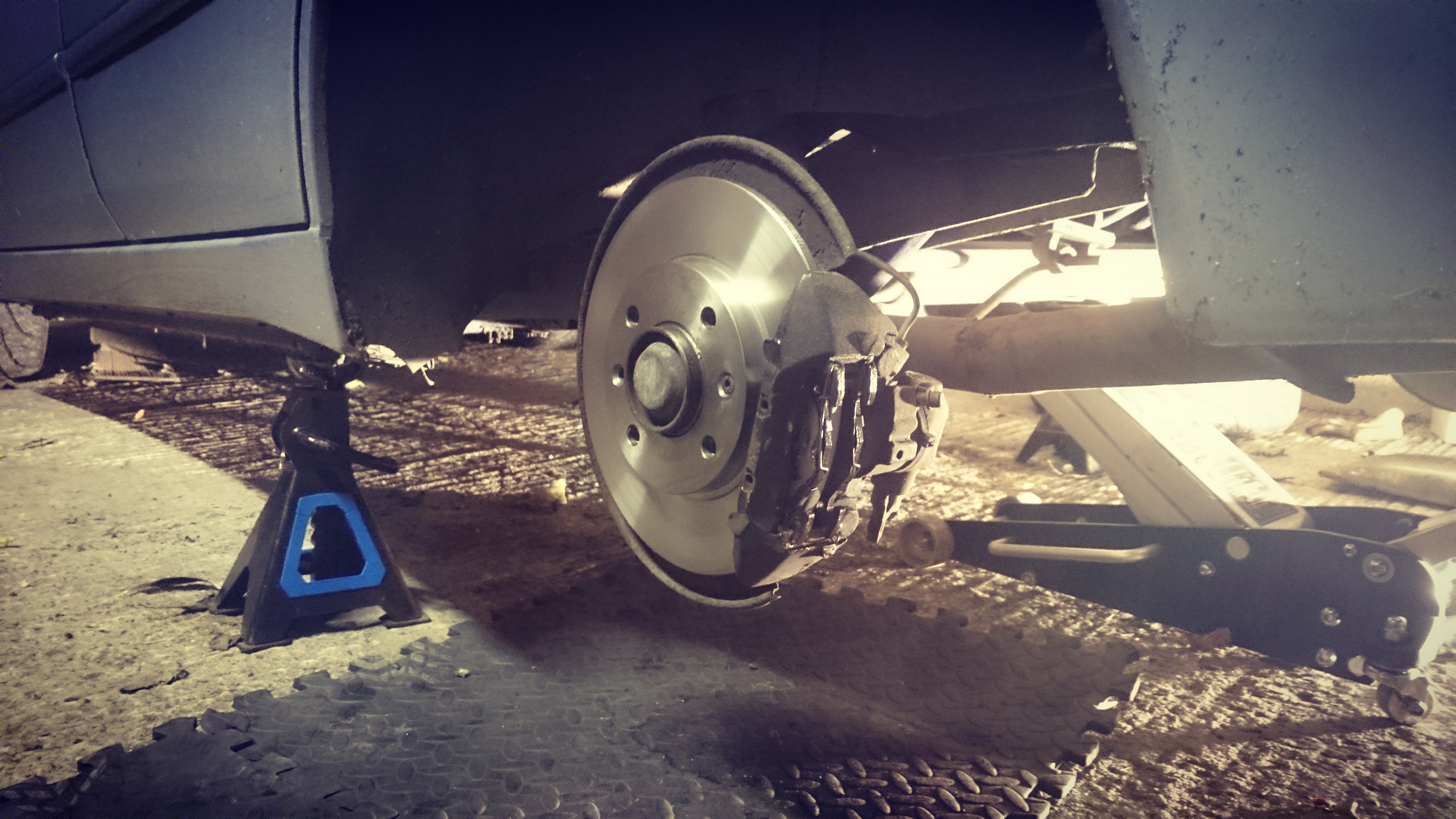

Stripped rear brakes, rebuilt/serviced a spare caliper, fitted new discs/pads. New cables on monday as were out of stock today. Old cables were "ok" but split and felt sticky.

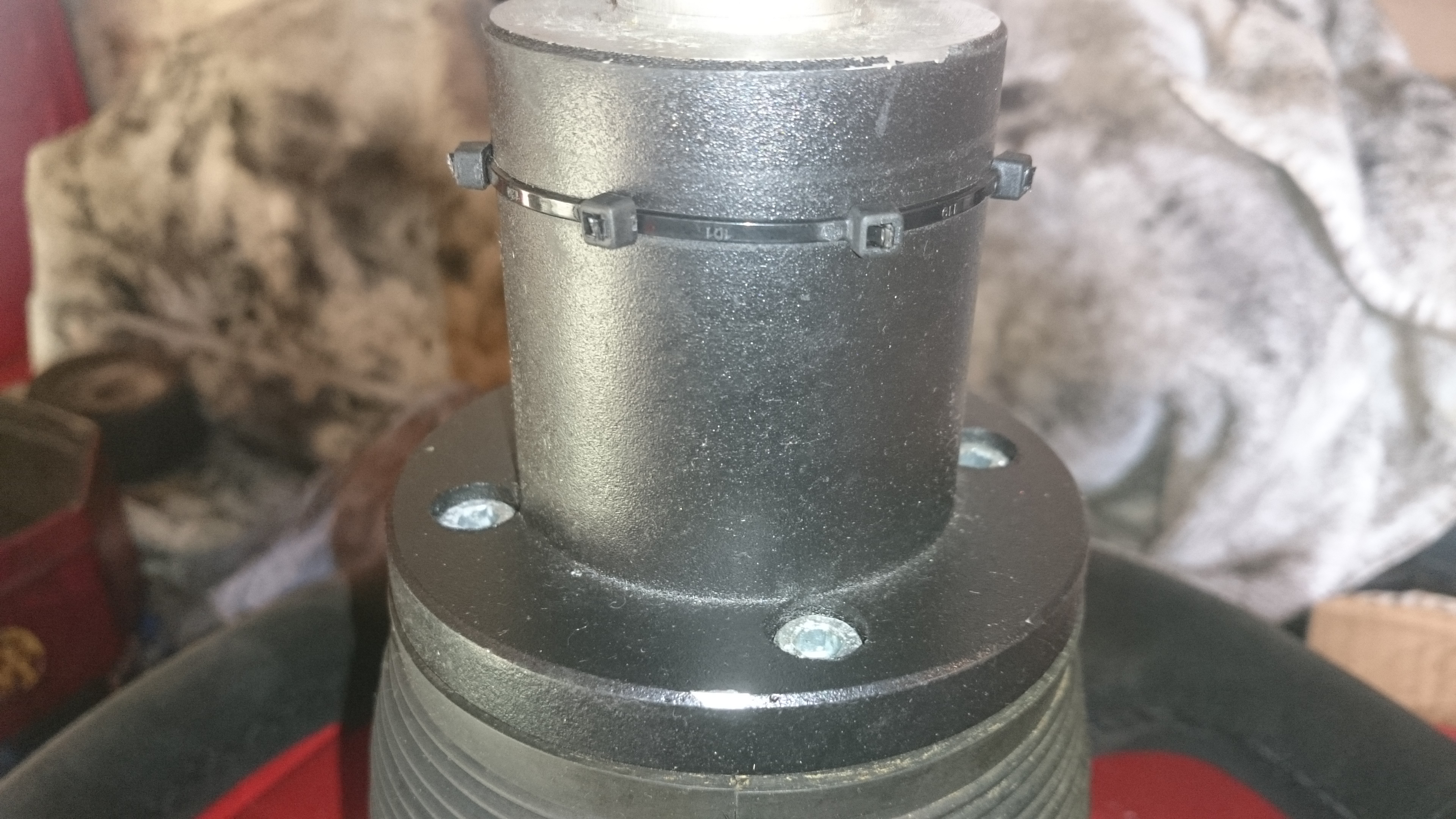

Wheel never self canceled which was always annoying and tech an MOT fault. Tried a few different things...result was this:
Works a treat despite its appearance! lol
