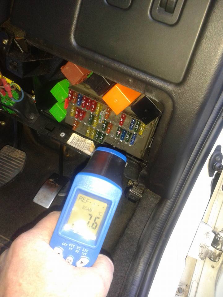

after a few hours of cutting testing soldering and sleeving all was done
i found the copper loom wires on the car quite corroded, black copper is hard to solder, you cant unless you clean it up,
I used a more aggressive flux ;Wink I used plumbers flux the same stuff they use for soldering copper pipes
i taped the loom up and fed it into the A pillar and refitted the grommet, refitted the door and tested
before i had no heated mirrors or rear screen as the fuse kept melting
but now i have it all working including electric window again Smile
quick check to see if the fuse was running hot but no .......
