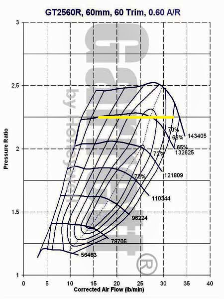

Ok I found the correct map for the T28! A lot of the Nissan S200 lads accept this as a suitable map, so its what im using.
Looks a lot better!!
32 lbs/min @7000rpm running 14psi
Will get my larger turbo mapped soon and put it up
