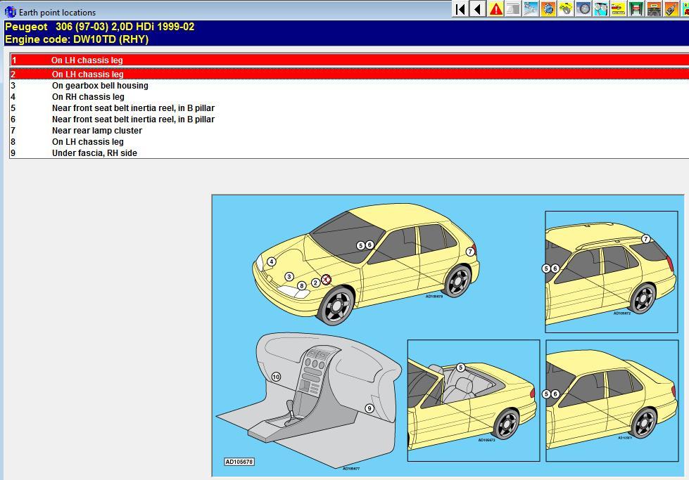

Does anyone know where i can see an image of the earth points online? I was planning to go over the electrics at the weekend and search for damage.

(06-06-2018, 08:38 AM)Warriorsquare Wrote: Does anyone know where i can see an image of the earth points online? I was planning to go over the electrics at the weekend and search for damage.
Here you go (for HDi, but similar/same for most 306's I suspect) ....
