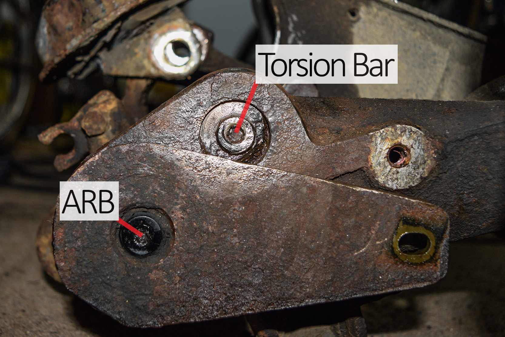

So after deciding to rebuild a beam myself I bought a xsara vts beam for £100 off ebay
It's done 77k miles no camber but i want to make it slightly more respectable before I put it on the car
Because I haven't got the beam on the car I'm struggling to remove the bolt here as it catches on the arm
And I don't know how to remove the ARB plates to get the beam apart.
My questions are, after reading through welshpug and gretsch-drummer's guides I still cant figure this out, do they just pull apart or are they held in with a screw or something???
Also If I take the torsion bars out with it off the car is it a pig to get back to a sensible ride height?

to remove the arb you need to wind out the plastic plug on the right hand side, wind in an m12x1.5 bolt which will push the end plate off the arb, grab hold of the other end and pull the arb out, leave the left side lever on the roll bar.
the plastic plugs are often very stubborn so you'll end up destroying them, cheap enough to get new though from a dealer.

(26-03-2017, 12:47 PM)welshpug Wrote: to remove the arb you need to wind out the plastic plug on the right hand side, wind in an m12x1.5 bolt which will push the end plate off the arb, grab hold of the other end and pull the arb out, leave the left side lever on the roll bar.

I looked at your guide again and it makes sense so I'm pulling the ARB through one plate and leaving the plate on the other end, that's okay I can get the plastic cap out it'll be a pig but its still possible ahah
M12 is the size/width?
1.5 is the thread size right?

As others have said it is certainly worth changing all the seals and washers etc when taking the beam apart if the bearing etc are all ok. Only issue you will find it that buying from peugeot you''ll have to buy them in bags and that can be 4s/5s or sometime 10s. I do have a few seals etc so if you do want any give me a shout.
I tend to use either an xud head bolt or front brake carrier bolt to get the anti roll bar plates off. That bolt you're struggling to get out can usually be bit of a pain especially when the beam has been lowered.

I've bought a bolt (M12x1.5 as said above) to wind it out I don't think the beams been lowered, although I couldn't tell you as it's the only beam I've seen so have no point of reference ahah

Didn't really plan on having to bump this but I'm still un-sure on how hard it is to set the height of a beam whilst it's off the car?
If I remove the torsion bars is it as simple as putting blindly putting them back or do they have to be put back in a specific way, I understand that the bars are left and right.

(30-03-2017, 04:33 PM)wainwrightj Wrote: Didn't really plan on having to bump this but I'm still un-sure on how hard it is to set the height of a beam whilst it's off the car?
Think some people have made up dummy shocks and do it that way. When I did one few months back we measured the beam that was on there from the hub to the arch and then fitted the new beam tube to the car and then built the beam up on the car with measuring the distance when fitting the trailing arms before sliding the torsion bars in after selecting the height we wanted.

I took one ARB plate off and it's not looking great the seal had turned to what felt like really old s***ty cork so I think I'll need the seal off you ahaha

Yeah the foam anti roll bars seals never see any good when the beams are taken apart. I would say there one of the most important seals as they can easily let moisture in.
Have you taken the anti roll bar out?
I generally tend to strip the beam off the car, Replace all the bearings etc, then re fit the tube to the car, and set the height on the car, generally because 9 times out of 10 I am lowering the vehicle at the same time, and its just much easier to set spot on first time round when its on the car as I have a list of arch measurements which result in x drop on certain '6 bars.

The beam is sorta stuck on the left hand side, the ARB plate/ Beam seem to have rusted themselves together but I got it rotated a bit so it'll come out with brute force and a good whack. On the side of the beam with the plate I've pulled off the ARB splines are clean and the inside of the trailing arm seems in pretty good condition so the seal did it's job although suicidally ahha.
(31-03-2017, 07:36 AM)darrenjlobb Wrote: I generally tend to strip the beam off the car, Replace all the bearings etc, then re fit the tube to the car, and set the height on the car, generally because 9 times out of 10 I am lowering the vehicle at the same time, and its just much easier to set spot on first time round when its on the car as I have a list of arch measurements which result in x drop on certain '6 bars.
Yeah I'm not fussed about lowering it at all given it's on the original shocks and the front setup is also original. I'm going to put the tube up on the car and then set the height to match whats there.
