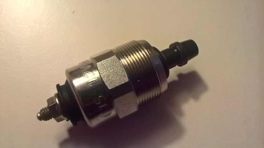

Been taking things off the engine that I don't need/want or to lighten it to move it. Everything on it is hugely big, like bolts holding brackets are M10. Everything needs a fucktonne of plus gas and I've snapped a few M10 bolts in the process. Odly the alternator is held on with 2 M8 bolts, one is stuck in the bottom and I can't get to the back of it to smash an M6 bolt through the back of it.
It's just taking ages to do anything, really need to charge the buzz gun.
In other news I purchased something shiny and new, a 12v stop solenoid. Trying to get bits sold on ebay and need to weigh in a load of scrap from this to fund other bits.
