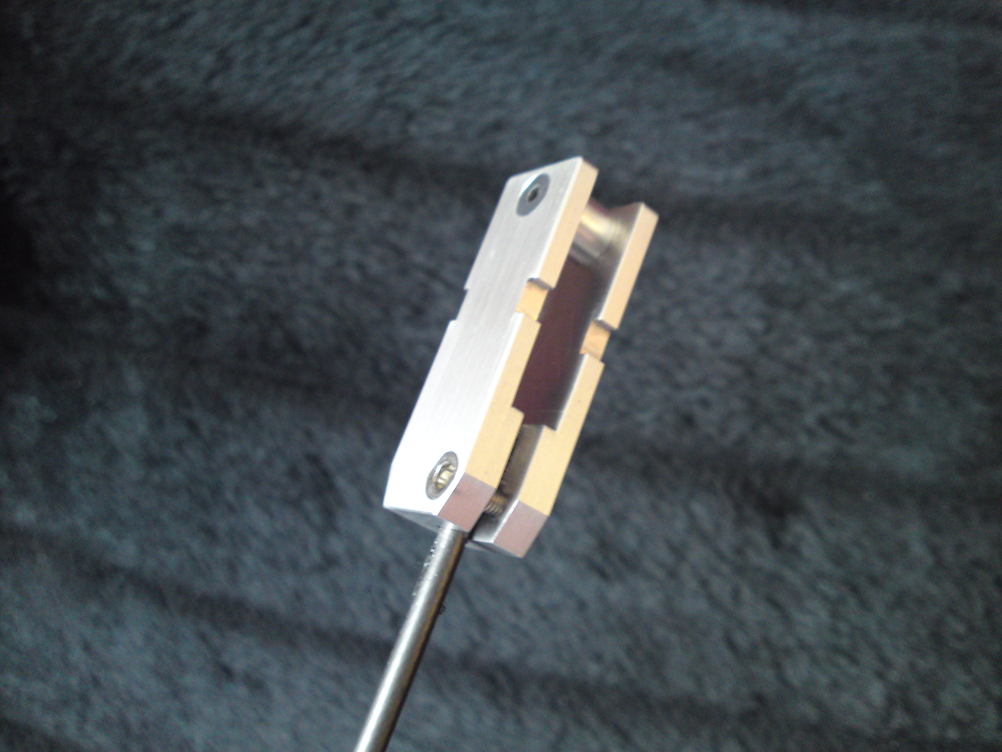

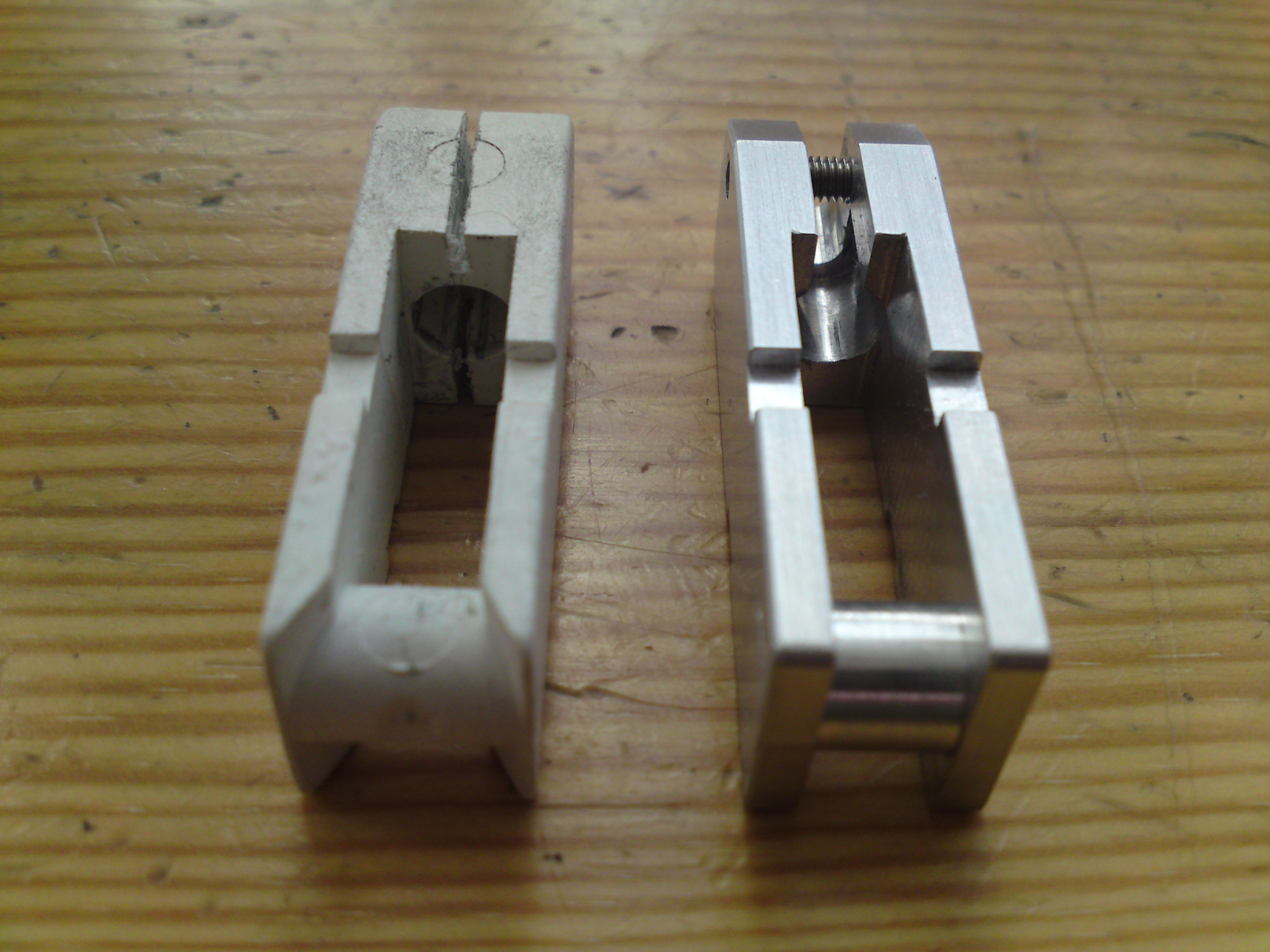

I would be wary of a clutch with heavier clamping force, the ends on the clutch cable are only plastic and I don't think they can cope with too much more clamping force, certainly I snapped a few with an old helix (pre their redesign)
Oh and when I broke my first CG clutch about 8 years ago they said the springs in the drive plate are only rated to 280lb/ft I assume that hasn't changed.

When you say the plastic end do you mean the two fingers that hold it ontop of the gearbox as may have snapped one....

(14-07-2016, 03:03 PM)dr_jekyll Wrote:
(14-07-2016, 03:01 PM)Dum-Dum Wrote: I would be wary of a clutch with heavier clamping force, the ends on the clutch cable are only plastic and I don't think they can cope with too much more clamping force, certainly I snapped a few with an old helix (pre their redesign)
Nope, the pedal end, the clip is like 3mm thick self lubricating plastic.
I'm surprised we don't see more broken if I'm honest

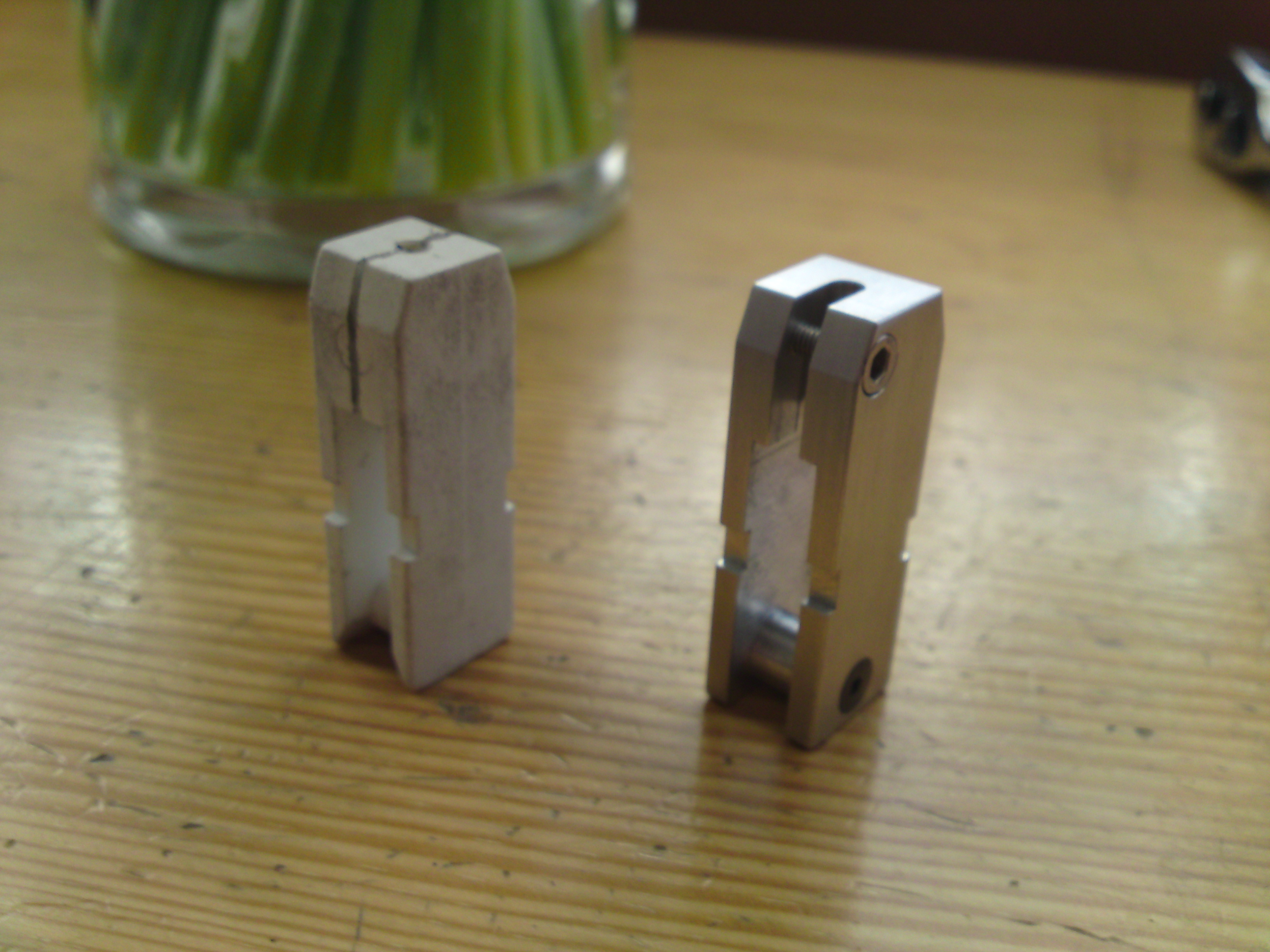

I ended up having metal ends made
(14-07-2016, 03:54 PM)Dum-Dum Wrote: I ended up having metal ends made
Wouldnt be impossible for me. Engineer at a food factory and get run of the workshop on night shifts when its not busy.
Did you manufacture a whole new end and weld it to the cable? Really should get it off to take a look while ive got the time

You have to cut the plastic off very carefully then I think we cut a slit in the new one with a hole drilled through that was larger at the hook end then a small screw secured the cable from popping out the slot.
(14-07-2016, 10:08 PM)Dum-Dum Wrote: You have to cut the plastic off very carefully then I think we cut a slit in the new one with a hole drilled through that was larger at the hook end then a small screw secured the cable from popping out the slot.
Thats a nice little job.. not sure mine will look as clean as that [FACE WITH TEARS OF JOY] guessing cnc?
What about the auto adjuster as that would leave that as the last weakness?

Yeah CNC and yeah the auto isn't ideal at high clamping loads but you can use the manual cable off (IIRC) a 205.
Beautiful little things aren't they.
Really are a nice little bit of kit. Prob pork mine together with scrap stainless from work
