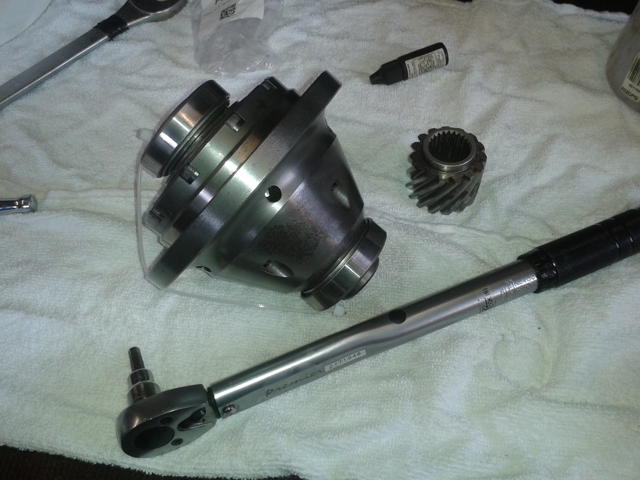

post man delivered a package from Quaife Engineering Ltd
I now have my replacement sun gear!
have checked the shaft splines and yes they fit the spare drive shaft i have
so went on and built up the diff
I have also booked the garage ramps for next thursday for me to refit the diff
gives me a little time to get some gearbox oil and an exhaust joint kit

The ATB diff is officially fixed, fitted, and test driven
the car is now stable and don't pull to either side with the ATB fitted
stripped the std diff out in about an hour this-morning
refitted the ATB, on its wheels and test driving it in about 3 1/2 hours total

the car pissed me off as it was still pulling to one side this time the opposite way
ive got a week off this week and not done anything for myself other than turned into mr grouch
been really considering selling up and f*cking it all off for something newer!
so yesterday i removed the long drive shaft removed the speedo drive nose and replaced it with the early box type with the shim
the reason for this was....
peugeot fitted two different speedo housings
1 with 10mm protrusion preload on the diff bearing
1 with 8.6mm protrusion preload on the diff bearing
the 8.6 casting is used with a 1.5mm bearing shim this adds an extra .1mm of preload to the diff bearing
my thought was maybe because warn diff bearings the diff is shifting in the casting causing the pull to one side
when i removed the speedo nose and measured it, it was 9.6mm with no shim HMMMMMMM!
the 8.6 casting is different as it uses different length bolts
so refitted the 8.6 with the 1.5mm shim
torqued it up and refitted everything
went for a drive yesterday and the car was a different animal,
anyway wife gone out tonight sat here bored.....

Did you change the speedo housing when you fitted the atb in the first place? How come all the trouble with different parts of housings?
Never knew that!
Is that true of all the be boxes?!?
Least all is well....glad you didnt give up...Ive been there and felt the same at times...hope I can ride shotgun for a hillrun?
(07-07-2016, 10:41 PM)ozonehostile Wrote: Did you change the speedo housing when you fitted the atb in the first place? How come all the trouble with different parts of housings?
when i fitted the ATB i fitted it back as i took it off
the gearbox came from a low mileage car and was fitted when i fitted the rebuilt engine, Ive never had it apart
but who knows previous history
the strange thing was, when i fitted the rebuilt diff the second time the car drove spot on no pull or anything
the following day the pull was back but in the opposite direction
i put that down to bearing movement so went investigating
went to peugeot who printed me of a load of info
but even they said put back like for like
what i found was the N/S shaft puts a lot of load into the diff this would force the O/S diff bearing outer race outward tight against the speedo Nose
i also found the nose to be 9.6mm not 10mm this would add 0.4mm extra bearing play/diff movement
i need to look at that 9.6 nose again to see the finish as i suspect the bearing may have spun and eroded the speedo case giving the issue in the first place
(08-07-2016, 05:45 AM)Piggy Wrote: Never knew that!
I'm only going on what I've found by looking through service box for partnumbers and changes parts
