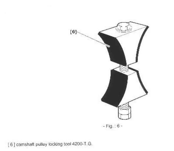

what's? the plywood for?

(25-04-2016, 08:53 AM)Magenta Sunset Wrote: what's? the plywood for?
its a copy of the Peugeot tool for locking the camshaft pulleys to enable the centre bolt to be torqued up correctly
GTI6 Info
clever stuff! ThumbsUp
Hate Housework!
Ah nice one cully, I was trying to think of who I'd seen that had made something for the job
pin the flywheel and the cam pulleys job done
