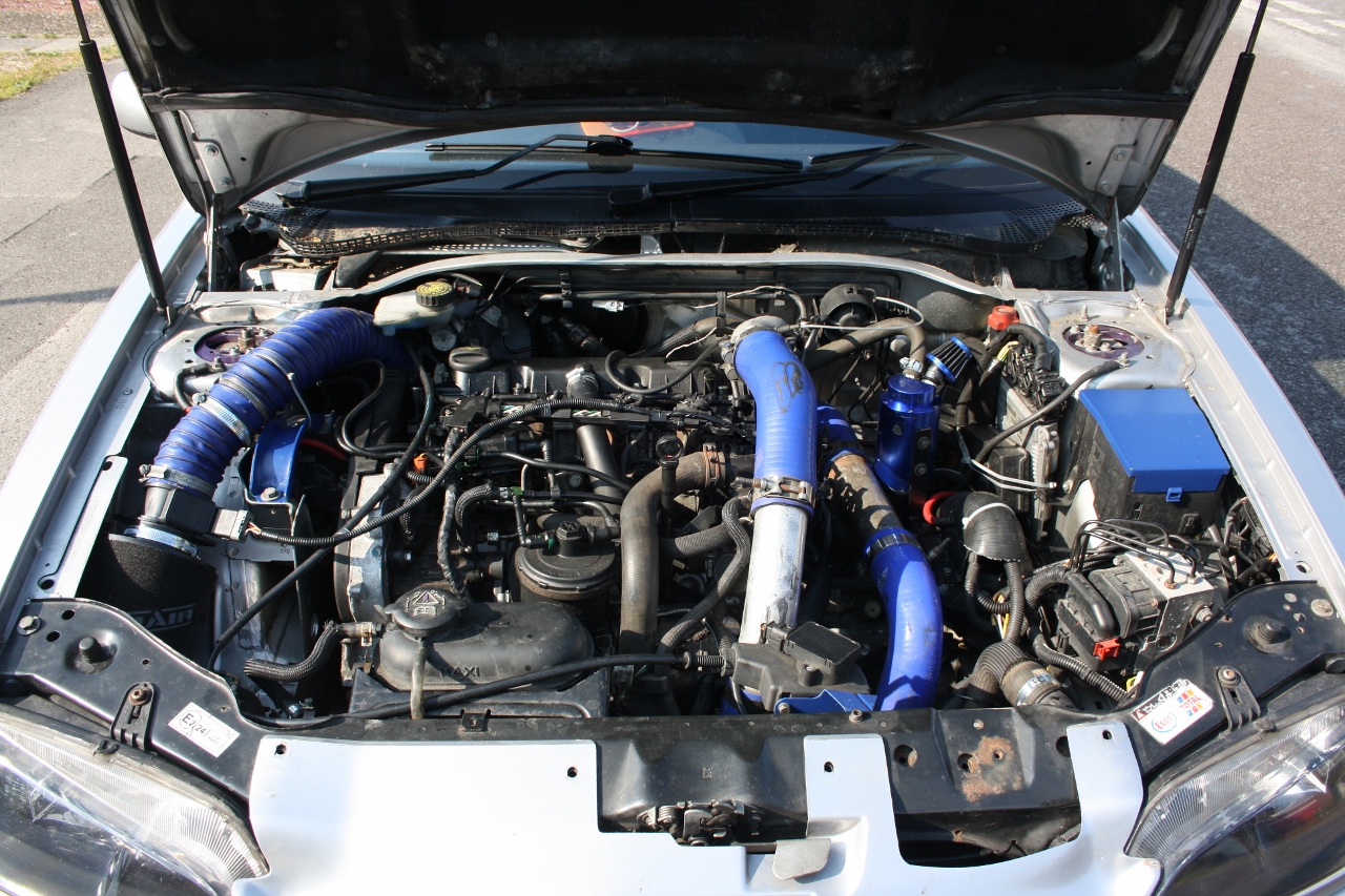

Began having little mock ups off the car to see what i was missing appears a few deliverys havnt arrived so got onto ebay about that.
This is what ive got for the intake so far, trying to keep it nice and simple
[Image: afa73a698bc55069c456ee7b38031891.jpg]
So from the turbo were going to a 90° 60mm stainless, upto a 3" reducer and then a 3" stainless. The 3" stainless is yet to have a 25mm barb welded on for the breather and as you can see ive left it all long ready to cut
[Image: ebe1f3c02ab34ac0c7c7a16dc74980a4.jpg]
This pipe should come out were the stock is so make for a nice intake route. The reason ive not choosen to come ou of the turbo straight onto a 90° silicone is that the pipe would then directly conflict with the egr above.

(12-02-2016, 08:05 AM)dr_jekyll Wrote: This pipe should come out were the stock is so make for a nice intake route. The reason ive not choosen to come ou of the turbo straight onto a 90° silicone is that the pipe would then directly conflict with the egr above.
isn't the reason mostly as that would flow like complete crap?
long straight in/out of turbo is what is required (within reason) no bends, no reductions, no restrictions...

Not 100% may flow like crap but then so does that flexi pipe people use. Anything has to be better than stock at this point. Just cant see the stock pipe shifting more air as is required by the larger turbo.
This may end up completley failing as im relying on hopes and wishes for it to fit properly down the back

No hope in hell of that fitting unfortunately. It's tighter than you think down the back of the block.
(12-02-2016, 07:52 PM)Jonny81191 Wrote: No hope in hell of that fitting unfortunately. It's tighter than you think down the back of the block.
Yeah? Bollocks Sad still will attempt it but guess i might just have to go plan b and mod the original. Gonna suck arse tho. Will be like sucking a golfball through a straw

That is about the best you'll get unfortunately, that was 2.75" flexi pipe with a reducer down past the manifold and a 90* onto the turbo. I extended the MAF sensor wiring across the bay.
(12-02-2016, 08:14 PM)Jonny81191 Wrote: That is about the best you'll get unfortunately, that was 2.75" flexi pipe with a reducer down past the manifold and a 90* onto the turbo. I extended the MAF sensor wiring across the bay.
Ahh sugar, cant run that flexi shiz as got a strutbrace directly in the way :/ what causes the pipes to hit then? Was so sure i could get this down there

You've got the manifolds, bulkhead crossmember, mater cylinder and servo. Oh, and fuel lines. And the cambelt covers. And those studs for the EGR gubbins (they'll need cutting off)
It's a bit of a ballache getting a decent intake on these.
(12-02-2016, 08:35 PM)Jonny81191 Wrote: You've got the manifolds, bulkhead crossmember, mater cylinder and servo. Oh, and fuel lines. And the cambelt covers. And those studs for the EGR gubbins (they'll need cutting off)
Ahh bugger im seeing exactly what you mean now. Was so hooked up on getting that 3" along the top i completley missed out the servo etc :/
[Image: aac07c72f047e88307960ad0d0d1c58c.jpg]
That was the simple route i was hoping for but as you say it will conflict with the servo. Had the 3" down the back to know it fits. Just piping upto it looks like a major problem now Sad[Image: 87b8fc5ecb19ebb8d8ed5e01fcb4665c.jpg]
3" sits and just sorter floats between the mani's

Ok so this is the 60mm down the back, hard to see [FACE WITH TEARS OF JOY]
[Image: a08b6a63272831b080ccfcbb1920f09c.jpg]
Its crammed there but stock intake is still in there and nothing moved. Slides upto the servo aswell. 3" however i just dont think is gonna go that far upto the servo Sad will try but dont think ive a hope in hell.
[Image: bd0923fdcab3eea640c06e76ab26c57a.jpg]
Just ordered another stock pipe. Just gonna lop the bend off and fit a reducer for the back up plan. Know adam fields has got a stock pipe on his but not sure im liking the thought Sad will certianly make some aggressive induction noise but will be the setups greatest restriction

Just been thinking about the whole pipe issue. If i know i can just fit the 60mm past the servo it could be worth rolling with. Untill i can get more 60mm tho will hae to botch the 3" in with what ive got.
[Image: 29b3bacc93d16aca44cddb932a8c9e48.jpg]
So the squared is the off cut that i dont need. This can be used between the 60mm 90° ive got spare and the 3" reducer. This should slim the setup down enough to pass the servo. Obv not ideall for flow but atm i feel its a cheap neccassary evil that will still be better than the stock idea

Best thing for flow would be a steady reduction in pipe size until it matches the intake diameter of the turbo, that might help you find a bit more room.
(13-02-2016, 06:32 AM)Poodle Wrote: Best thing for flow would be a steady reduction in pipe size until it matches the intake diameter of the turbo, that might help you find a bit more room.
Intake is slowly turning into a horror story [FACE WITH TEARS OF JOY] will a modified stock intake pose as a huge restriction?

It is a total pig to route, but stick with it man, i'm sure you'll work something out. The stock intake will be a restriction, but not half as much as people seem to think - it's actually very well designed.
(13-02-2016, 07:30 AM)Poodle Wrote: It is a total pig to route, but stick with it man, i'm sure you'll work something out. The stock intake will be a restriction, but not half as much as people seem to think - it's actually very well designed.
Stock will be my plan b.
Must be a better solution tho, might be a case of experiment once shes on. Theres only so much mocking and contemplating that can be done off the car

This is 1 of the biggest issues with the 306s and the turbo down the back is sorting out the feed pipping
With all the EGR Gubbins out the way it must free up a fair bit of space for the intake pipework....
What are we refuring to as egr gubins as everythingis stripped from the back of my bay. Only evidence of the egr left is two plates

Oh reet, thought from the pics above it was all still fitted. The stock intake isn't too bad, there is a join where they have fitted the pipes inside each other the wrong way round in my opinion but besides that it might be worth using if space is really tight. I'd maybe wrap it in exhaust wrap.
