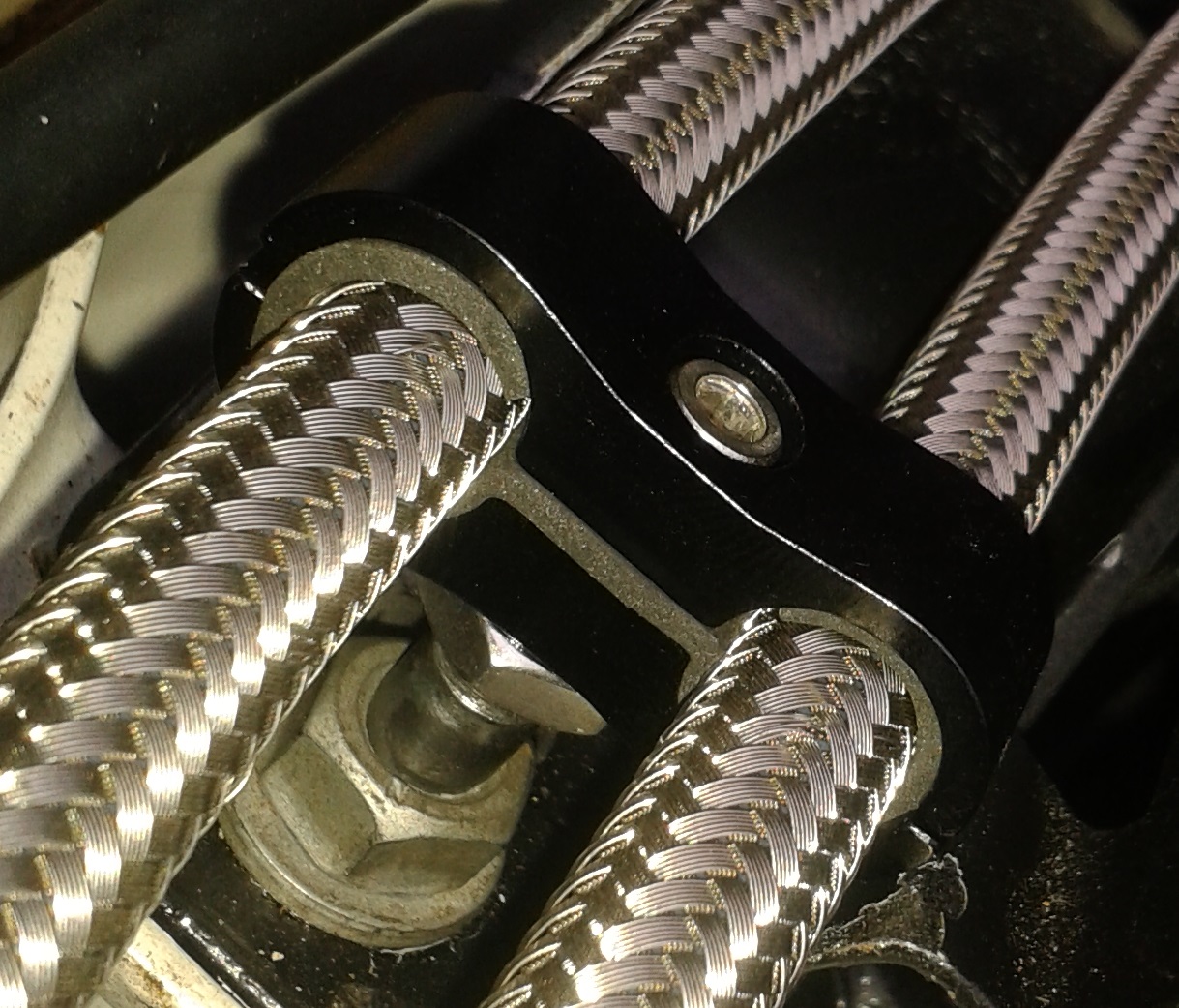

finished off my fuel pipes today by making two stand off clamps that replace the bolts on the top engine mount yoke,
these will do away with the cable ties and hold the pipes rigid car side
makes a neater job!
GTI6 Info

Tidy install.
Looks good that bud if it were me that supply line would be shortened slightly so that the gap between the two pipes matched all the way around Wink

so the shopping list for you goes like
2 X AN6 weld on steel fitting (£5.98 for 2)
4 X AN6 BLACK 45 Degree Swivel TEFLON PTFE Fuel Oil Braided Hose Fitting (£11.95 for 1)
2 mtr AN6 5/16" 8MM Stainless Steel Braided TEFLON PTFE Fuel Hose (£9.95 per Mtr)
2 X 6mm Pipe inserts (£4.77 for 10)
2 X 8mm compression hard line to AN6 adapter (£10.60 for 2)
2 X AN6 13.4MM Braided Hose Separator Clamp (£9.90 for 8)
things to watch though
the compression olives are tight to get over the plastic hard line,
the 6mm inserts will need the front leading edge filed so they enter the plastic pipe without digging in ,they are tight entering the olive once inside the pipe,
the hose clamp stand offs i made from the pipe clamp and a inlet manifold stud
i tapped the bottom part of the clamp to 8mm so the stud screwed into the lower of the hose clamp
this was locked with a 8mm nut
the top part of the clamp secures via a m4 socket bolt so i drilled and tapped into the top of the manifold stud 4mm tread
the whole thing just replaces the existing yoke bolt and locks with a M8 nut
i also cut a thin strip of rubber to grip the pipe in the clamp so it wont wear the steal braid
