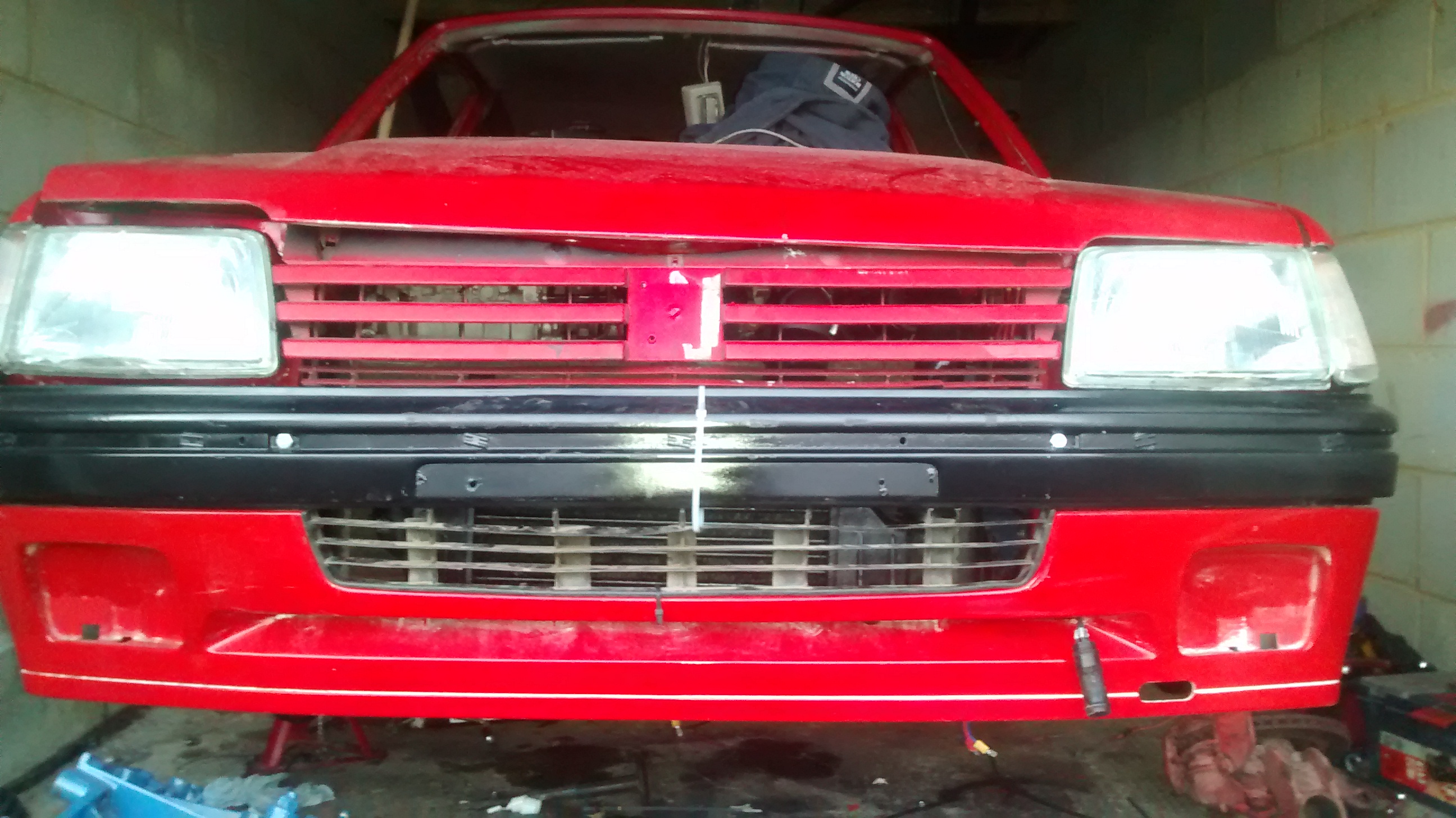

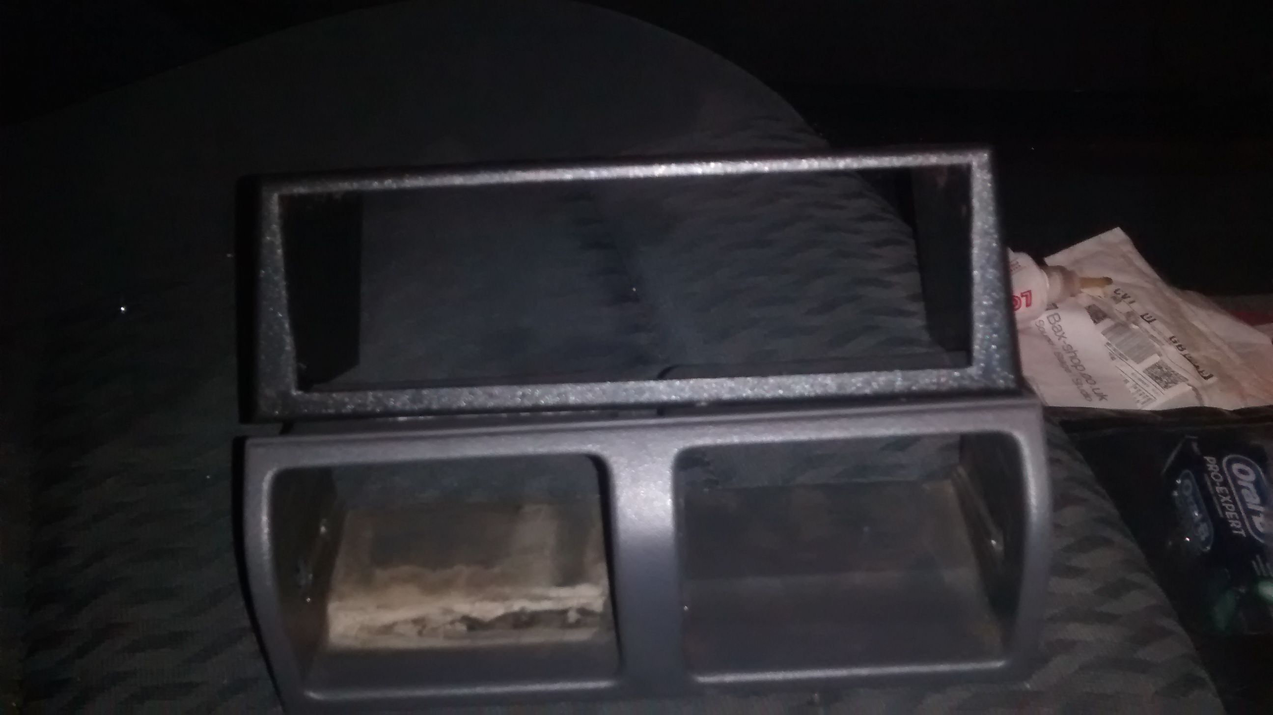

Not much to report other than I managed get hold of a grill , not off a 205 though or even a Peugeot. Width ways it fit perfectly but was about 10mm to tall so I shaved that off with a Stanley blade.
i think it looks okay , what your guys opion on it?

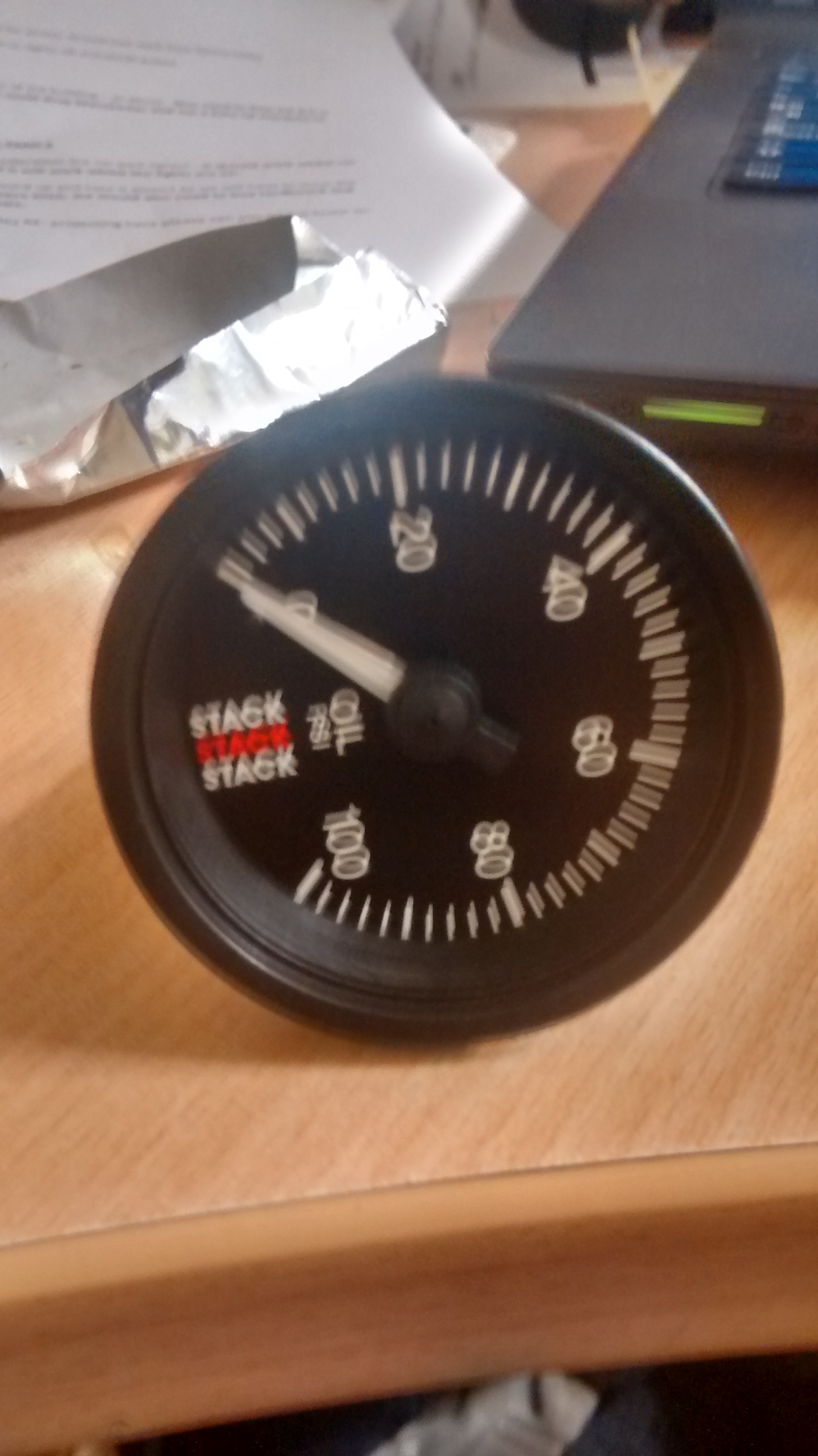

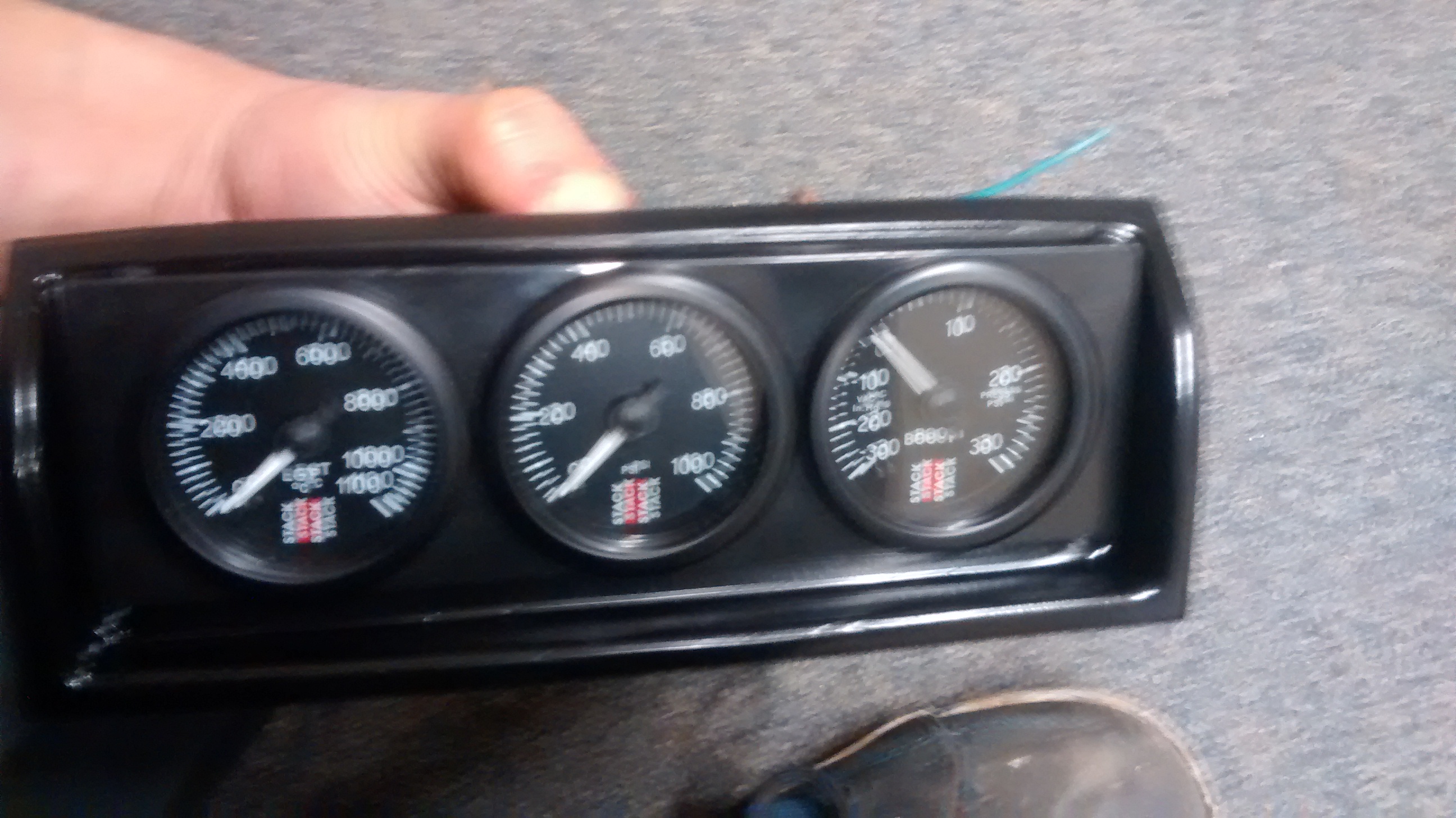

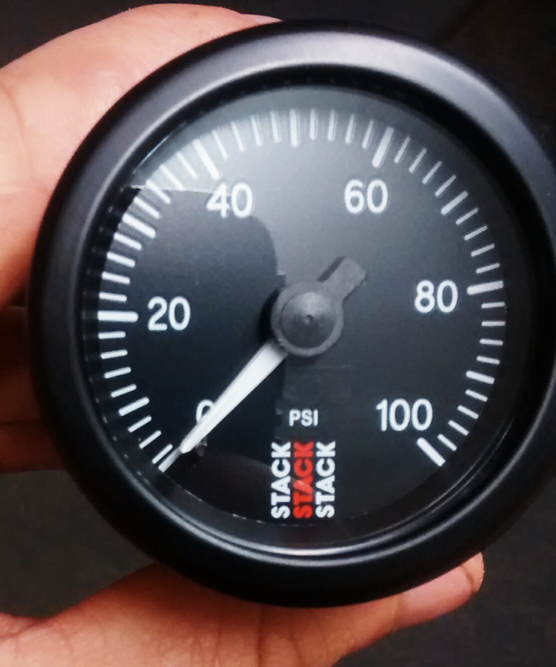

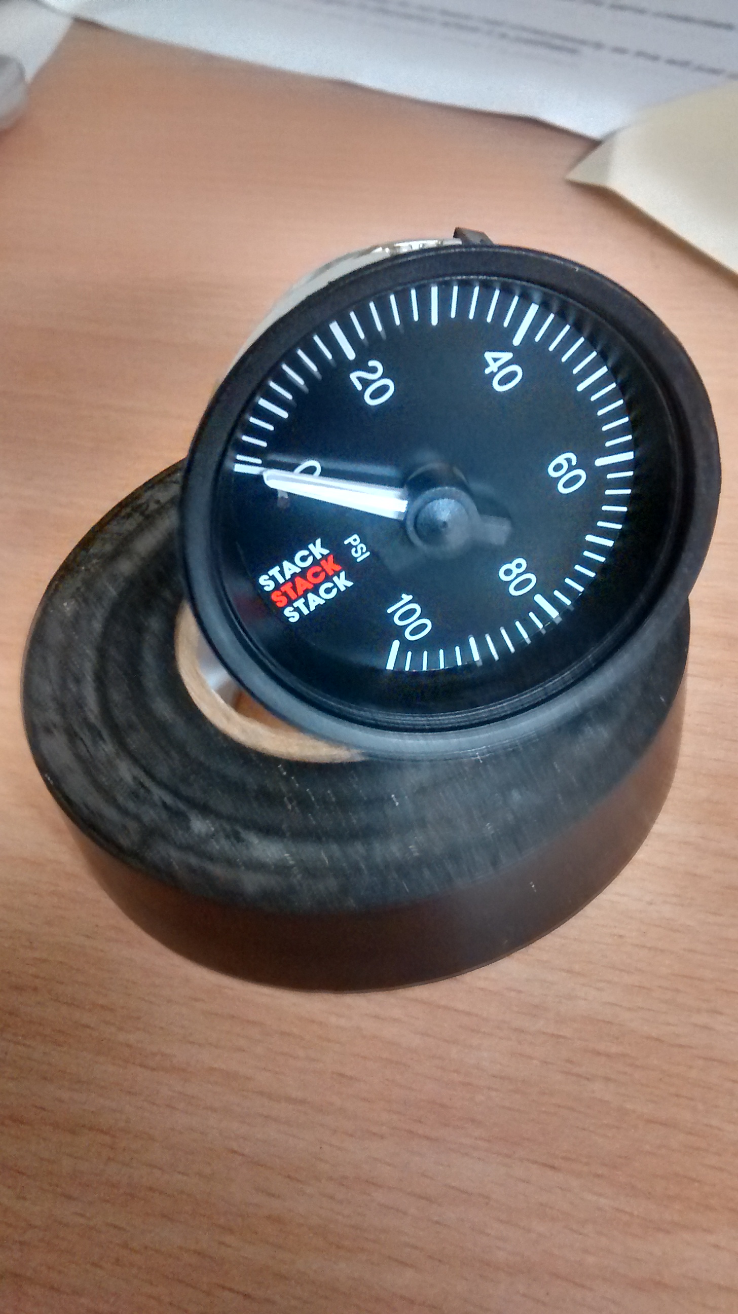

So this showed up.
Going to use it as a EMP gauge, so removed oil from it as it won't be oil pressure.
Only thing needed was a screw driver spanner and a couple mm of PVC tape.

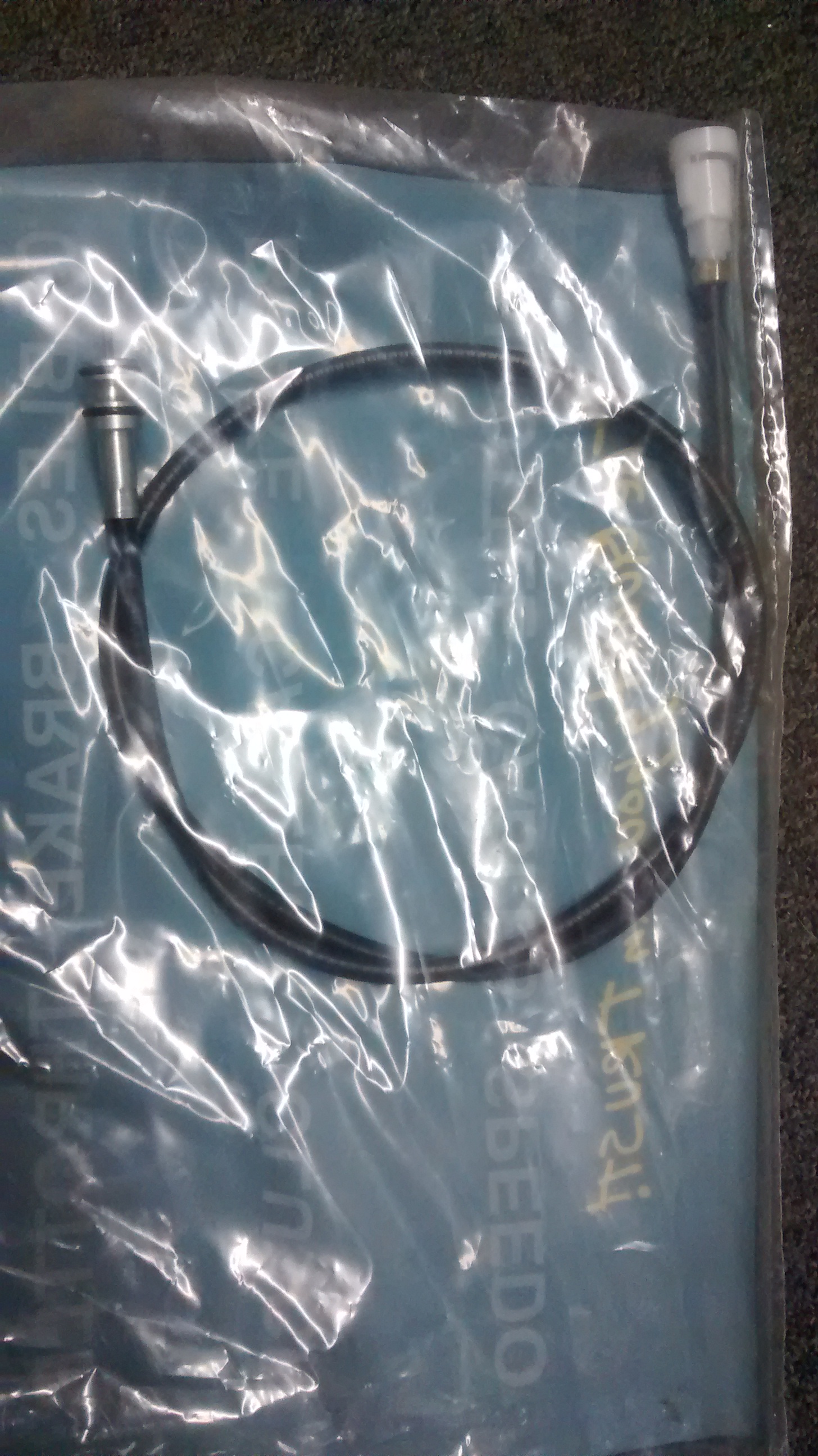

also my extra long 1200mm speedo cable showed up so should be able to atlast put my dash back together. For now anyway

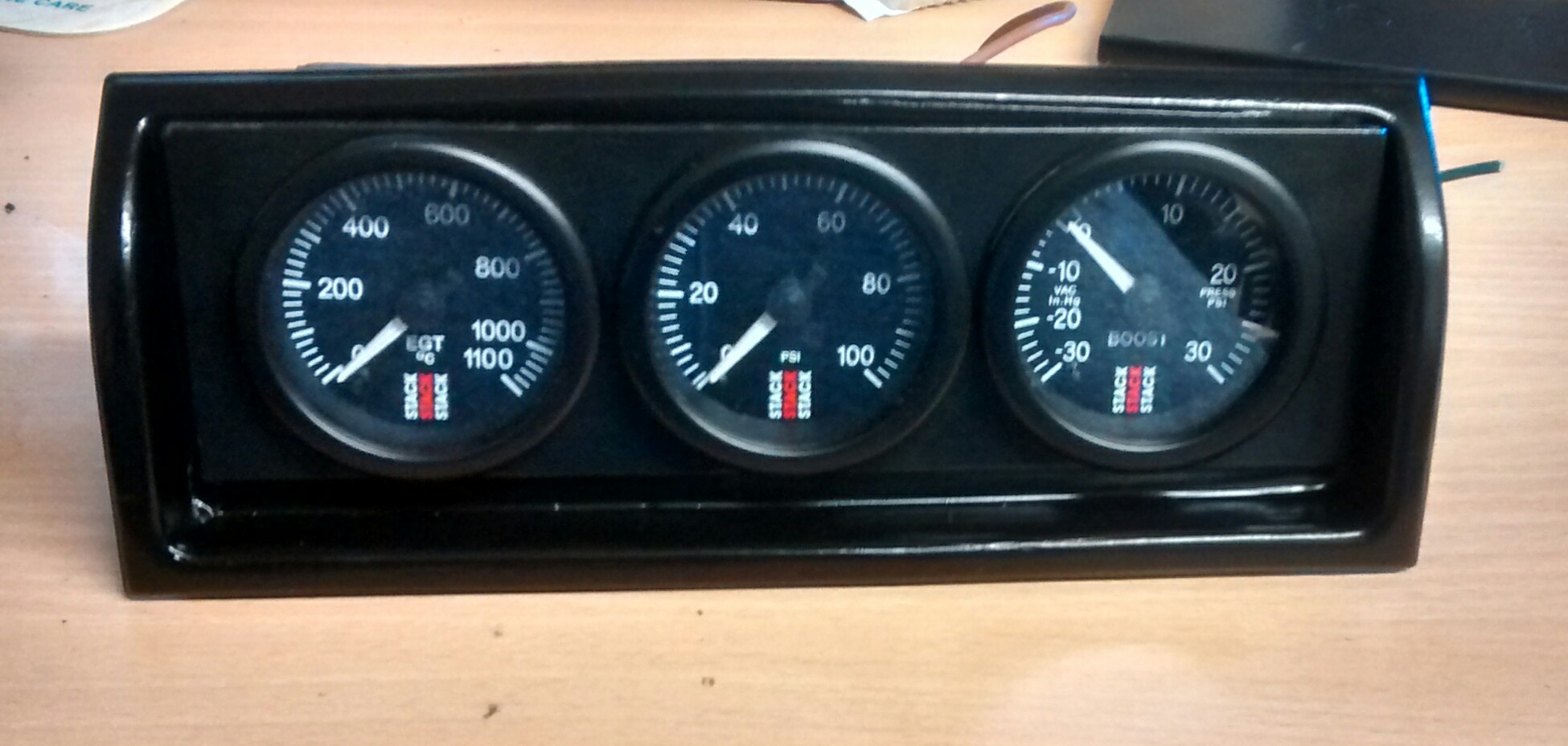

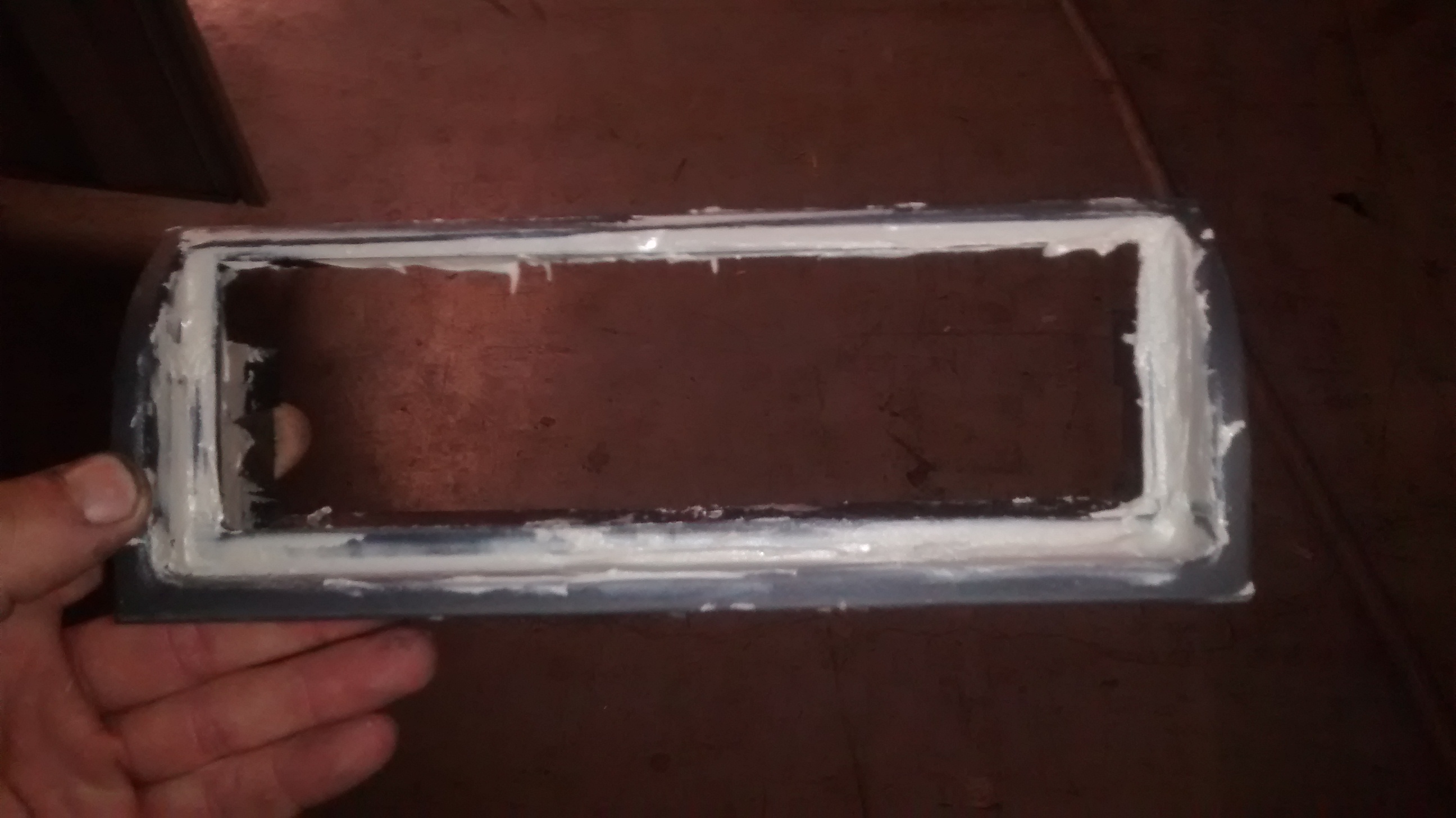

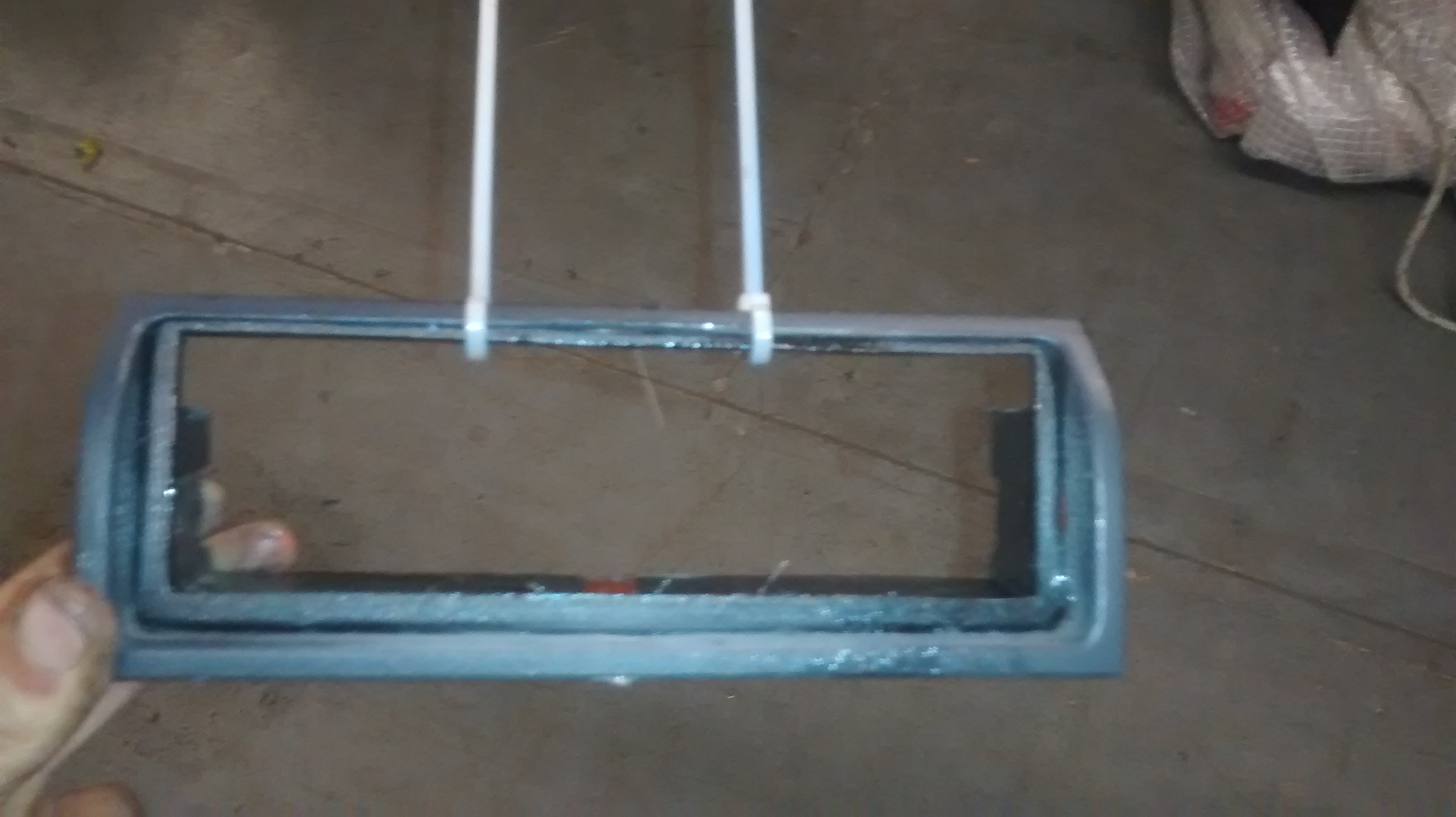

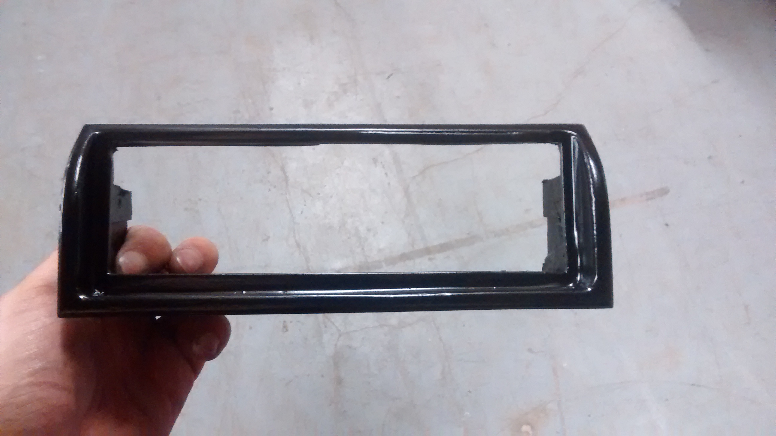

Got a little bit of spare time so made this for the new gauges.
Cherry red 205 XUD VNT - Project thread here http://306oc.co.uk/forum/showthread.php?tid=25522
looks tidy with all the stack gauges . . ..ThumbsUp

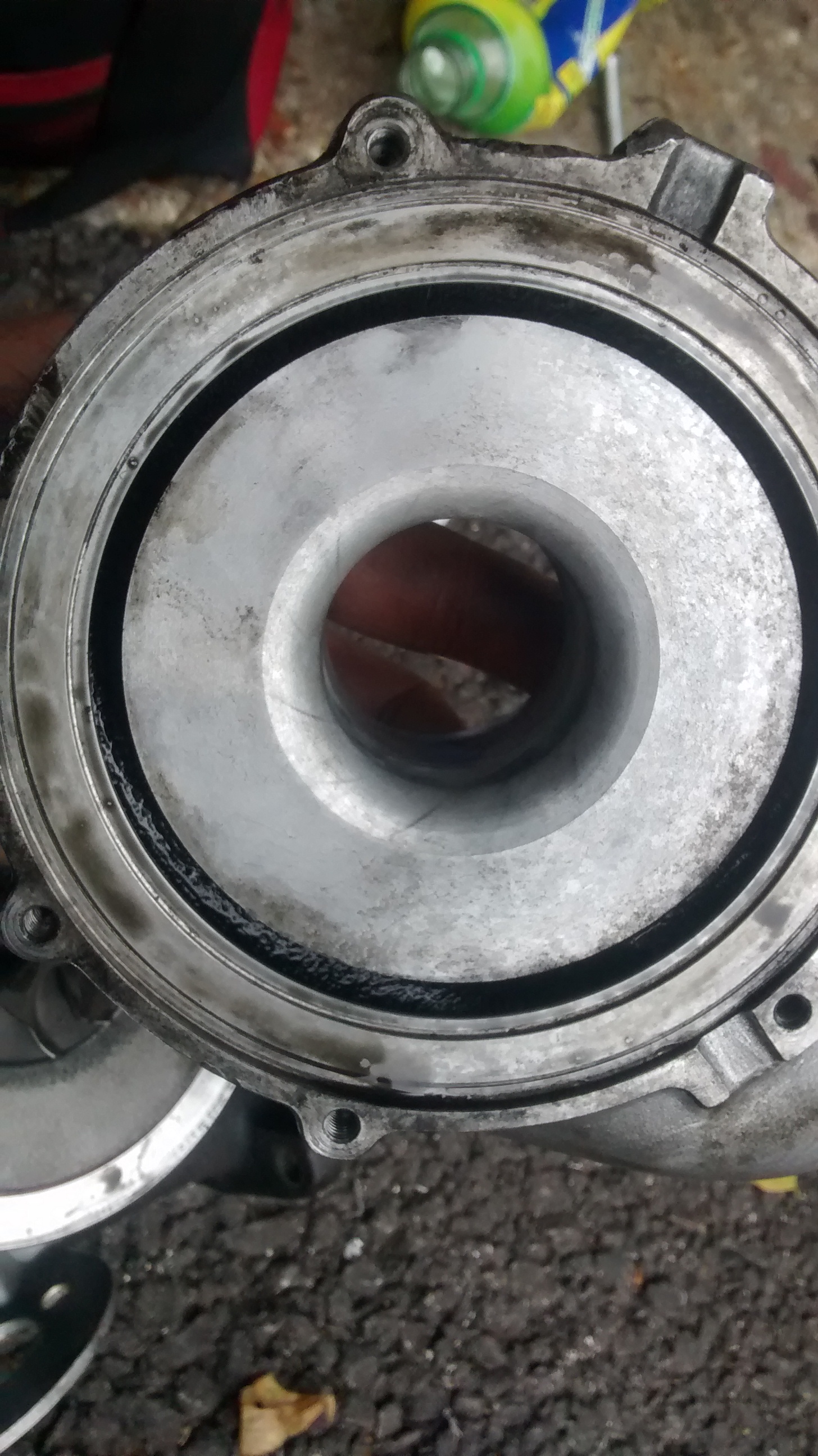

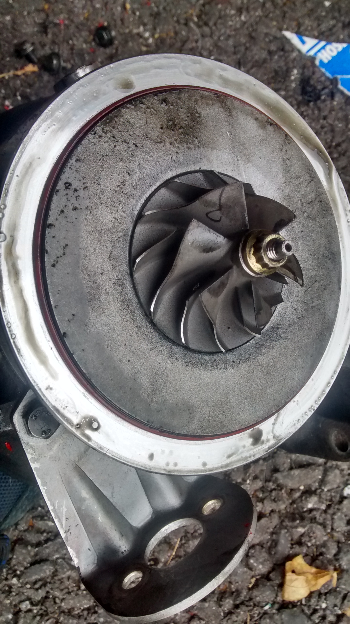

So bad news before I could even start playing with the turbo it started pissing out oil and it seized twice once when first started freed up then seized again (no idea why there's oil and its not overheating)  Dodgy  Think the CHRA I bough is a load of shite still no play in the bearings though. The car hasn't even moved yet and already wrecked a turbo Doh .  The oil line has been running unrestricted as I was under the impression this was fine for these turbo's maybe not will also add 1mm restrictor.

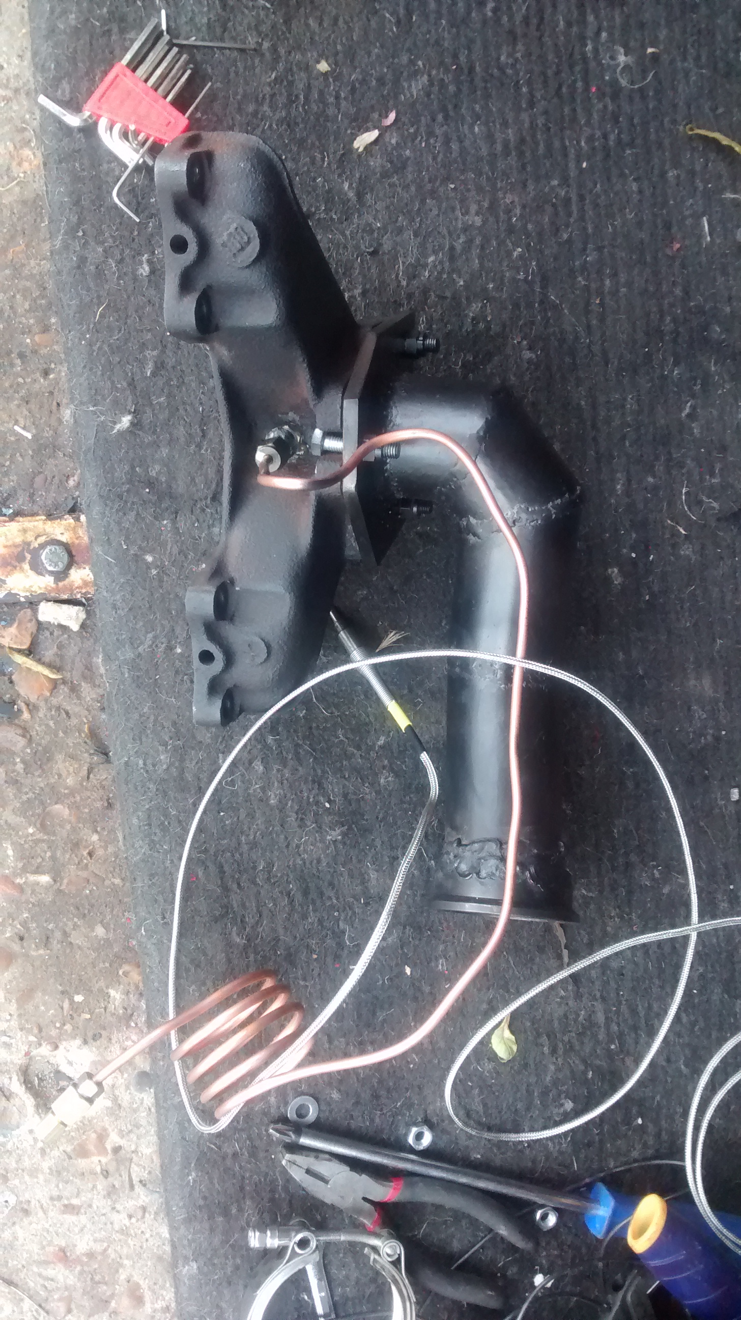

Also made this

Pulled the turbo off again tonight and dug out the old chra.
Tomorrow will pull the new chra apart and the old one and try and make a good one from the pair
When I get a whole weekend I'll trailer the car over to my workshop to make up the rest of the exhaust and redo the roof as I'm still not happy with it (strange reactions)

DON'T add the restrictor!
They need the oil flow/pressure for the oil filled bearing.
Its the ball bearing units which need the restrictor
Yes I was under the impression that was the case but have been recommended to add the restrictor.
I won't add the restrictor will just rebuild and retry, I suspect the chra was bad from the word go. Heard alot of bad things about these as garret dont sell the parts so most are chinese copies
Yeah, I had oil seal issues even on low mileage units. I think its a given they will let some oil through even as standard.
But I was going to add a restrictor, think I even have one here but got some proper info and realised it would be a bad idea!
How have you got round the issue ? Or is it just luck ?
Also marking the compressor wheel to the shaft with a fine sharpie pen should be enough to keep balance ?
Yeah, as said, don't add a restrictor to these - it's the ball bearing units that really need the restrictor - these engines are regulated to 5bar oil pressure anyway.
As you've found - Garrett don't supply brand new parts for these, so be very wary of replacements. If you're taking it apart, be ultra careful to not lose the location - it's by no means ideal taking it off at all, but as always, needs must - just be super careful, I know many people who have and it's been fine since.
Your turbo is mounted very low down, has your oil return enough of an angle to return properly/ is it large enough? they really don't like flowing sideways or the oil will pour out through the turbo seals. Straight down is idea but not possible in you case.
(21-10-2015, 10:48 PM)HDi--Power Wrote: Your turbo is mounted very low down, has your oil return enough of an angle to return properly/ is it large enough? they really don't like flowing sideways or the oil will pour out through the turbo seals. Straight down is idea but not possible in you case.
The oil return is definitely large enough, but as you say the angle is fairly poor as it comes 90 then goes down to the sump at about 45, will look at resolving this when I can get the car over to the workshop and fab up a better manifold. Thanks for pointing that out it was something I wouldn't of thought of.
(21-10-2015, 09:27 PM)Ruan Wrote: Yeah, as said, don't add a restrictor to these - it's the ball bearing units that really need the restrictor - these engines are regulated to 5bar oil pressure anyway.
Yeah I won't add a restrictor. I have a old chra that looks genuine i'm hoping to make a good one out of the current one and that.
Also another gt2052V has showed up in the post this morning , still waiting on the other turbo that was part of the deal on ebay but not so interested in that one as its a gt2052ls off a rover petrol.
So once the new Manifold is made up the 2052 that showed up in the post the morning will be going on as it already seems a much better turbo that the current one no play, all looks quite new and genuine.

I plan to take this over to my workshop at the end of next week for exhaust to be made up and a fair few new shinies to bolted on. Plans have changed slightly with the turbo the gt2052v is going to be sacked off in favor of a better turbo, if it turns up in  time.
