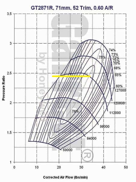

Nothing physically happening to the car at the moment, but i have been working on mapping the compressor charts.
So here is some mathematics for your enjoyment!
This is for the T28
Its all in american units because 124 cubic inches is easier to work with thatn 2045cc
Cubic Inch Displacement (CID) = 124.8
Volumetric Flow Rate (VFR) = (124.8*7000)/3456 = 252.8 Cubic Feet/Min (CFM)
Ive assumed a Volumetric Efficiency of 85% so...
VE = 252.8*0.85 = 214.9 CFM
Mass Flow Rate (MFR) = (2.703*14.7*214.9)/(70+460) = 16.11 lbs/min (2.703 and 460 are constants, 70 is ambient air temp in fahrenheit)
Pressure Ratio (Pr) = (16+14.7)/(14.7-2) = 2.42 (The -2 is to account for pressure drop, -1 each from air filter and intercooler)
Temperature of air coming out of turbo (COMPt) = (((70+460)*2.42^0.283)-460-70)/0.75 = 200.8+70 = 270.8 Fahrenheit (f) (0.283 is a constant, the 0.75 is an assumed turbo efficiency of 75%)
Temperature of air coming out of intercooler (INTt) = (270-70)*0.75 = 150 f (Again, the 0.75 is an assumed intercooler efficiency of 75%)
Density Ratio (Dr) = ((70+460)/(150+460)) = 0.87*2.42 = 2.1
Now if I take my Dr and multiply it by my MFR = 2.1*16.11 = 34 lbs/min
Doing it all again @3500RPM gives me 17 lbs/min
So now i can map it on the compressor chart, looks a little something like this...
Wtf does that men
It means the gt2871r is unsuitable for producing 1.2bar boost at 17lbs/min, as most suitably-sized petrol turbos will be. If you perform those calculations and produce a point left of the surge line (as per the yellow line in the image) you need a different turbo or a different target boost/airflow point. Tbf to the turbo 3500rpm is a very low number to be producing 1.2 bar on a petrol, especially if you want the turbo to be able to continue boosting to the redline rather than becoming a restriction higher up. Not sure if i've missed something, but that compressor map isn't for the T28 either, try this: http://www.mazdausa.com/MusaWeb/images/m...tent07.gif. Crap picture, but you can see the figures on the axes alright.
Yeah the T28 and GT2871R are rather different units
Yeah wrong map, couldn't find one for the T28, so I just found a turbo with same trim and A/R
3500 rpm was a bit of a shot in the dark tbh, just went with half of redline, although max redline is 8000 I dropped a 1000 to play it safe
Ok I found the correct map for the T28! A lot of the Nissan S200 lads accept this as a suitable map, so its what im using.
Looks a lot better!!
32 lbs/min @7000rpm running 14psi
Will get my larger turbo mapped soon and put it up
