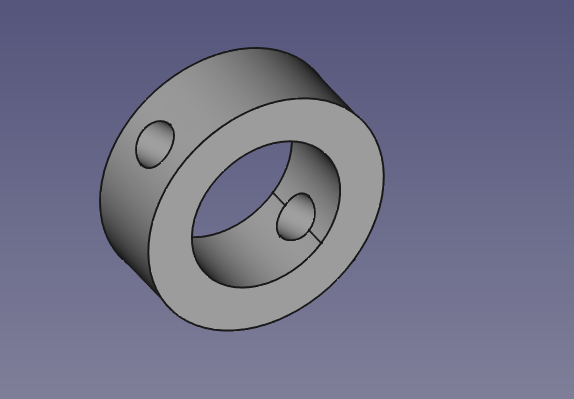

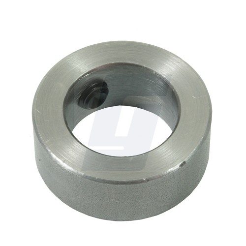

Injector mounting ring for 300tdi injectors:
diameter 27mm 10mm high and a 17mm hole, 5mm holes trough and trough with M6 in it.
Use the ring to drill 2 holes in the injector about 2mm deep (first dry fit to find out the correct placement and keep some extra room for tightening) and tighten the ring with 2 M6x12 grub screws, now you can use the Hdi's original clamps to mount the injectors. (with use of extended studs and taller bolts)
With the use of this ring you can turn the injectors around any way you want so you can correct the spray pattern angle to match the engine.

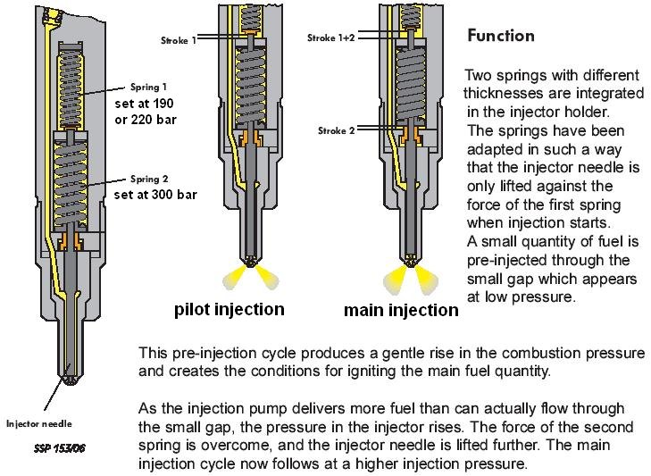

Stock 300tdi injectors can handle up to ~200cc and have a 2 stage injection cycle with a pre injection at 200bar and the main at 300.
If you want more you can fit DSLA144P144 nozzles which have about the same spray pattern and angle but come from a Scania truck so can deliver a whole lot more. One minor thing these are 9mm diameter and originals 7.2mm so you need to drill out the head.

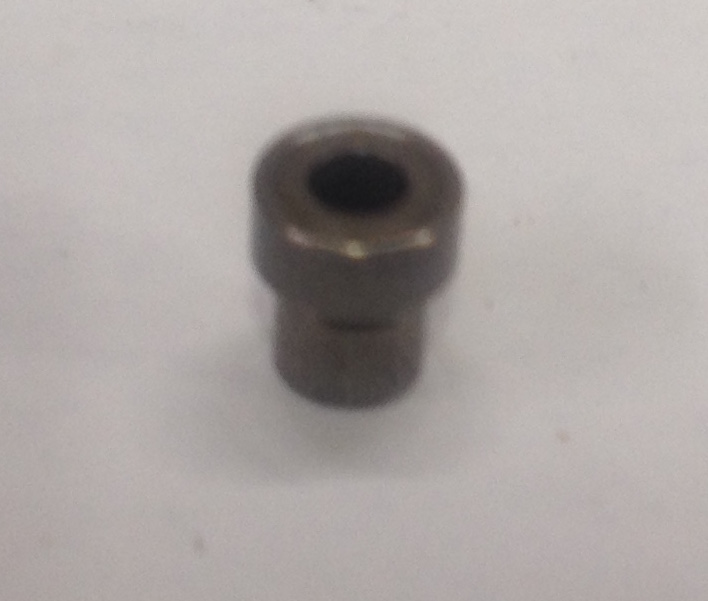

We use these as single shot at 320bar, grind the little pin on top of the nozzle needle, use a thrust piece from the Hdi's Bosch common rail injector (not from Siemens is different) mount it and start adjusting until you have them all 4 at the same pressure...

Could you use these if the center was machined out to 17mm?

Wouldn't try it, if it gets loose and the injector looses it's mounting pressure the flame will burn a hole in the head... (learned from experience)

Thats a good idea when i mounted mine i just bolted them in to start with and they almost immediately flew straight back out. Had to drill and tap the back to make a more solid surface to pull them down onto. Worked well. Your idea is far better though. However at the time mine was get in and go. As regards to the rotation of injector i managed to get mine to rotate what i though was "enough" may have will lathe me a set of these up for the new project at some point though. Some really good info on here. Wish you had started this earlier so i didnt have any research to do lol
Found an ready to go alternative: adjusting ring DIN 705/916
28mm diameter, 17mm hole and 12mm high, should work... (should save me some work if I found them sooner)

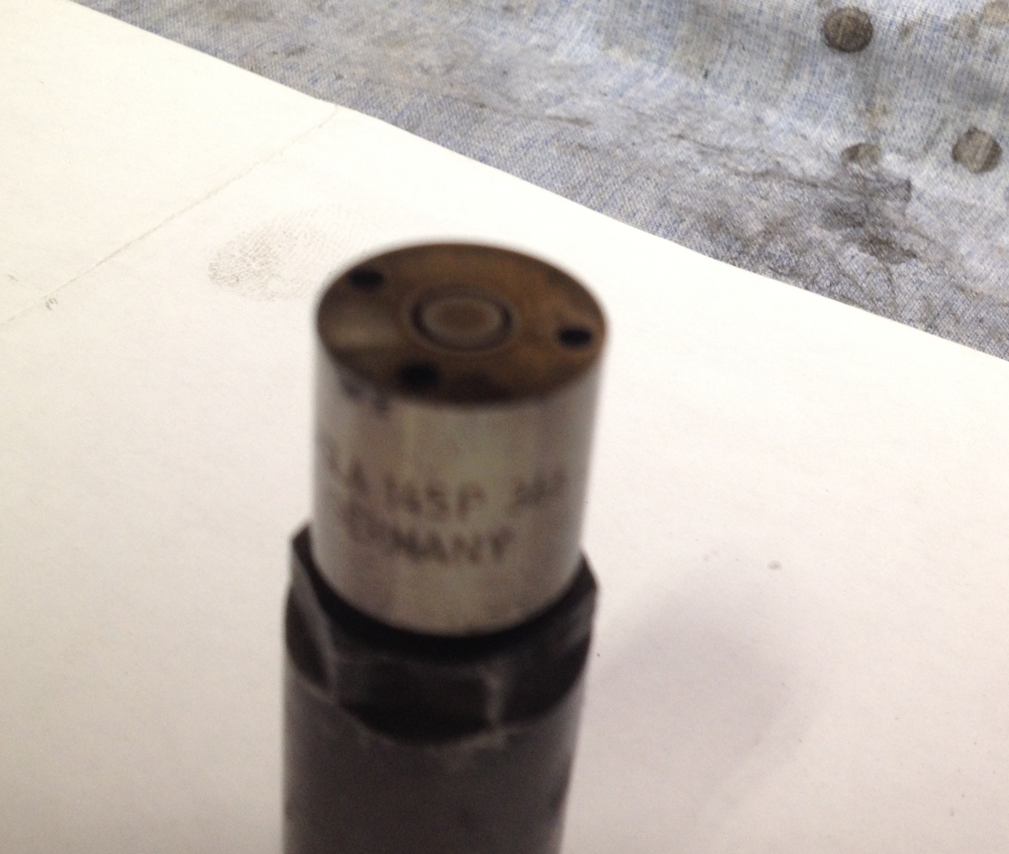

We want to inject over 300cc of fuel so we need bigger nozzles, for that we choose DLLA144P144 which are used on Scania and MAN trucks, the main issue when choosing nozzles are the spraying angle (144 means 144 degree, original are 135 I believe so not to much difference) and the injector angle (the holes in the nozzle should reflect the correct injector angle else we will spray holes in the head or pistons the same way a water cutter does and believe me that will happen) unfortunately that angle is nowhere to be seen in the docs so that is trial and error...
Another thing according to nozzles is how to rotate them when mounting, these nozzles have 5 holes in it and since the injector is mounted under an angle you have to watch the position of the holes and rotate the injector when mounting to match it all up.
There are 2 ways to get a working injector, we can choose to either make a one-shot injector set at say 320bar that makes a hell of a bang but has some troubles running idle or we can follow the 300tdi injectors 2-stage injection setup:
p.s. if you want a single shot setup you can use the bushing from a DW10 Siemens piezo injector instead of the LaRo one, needs some mods to the rod use for the first spring so both the first and second spring are used at the same time but I won't describe that so you have some room for your own skills... ;-)

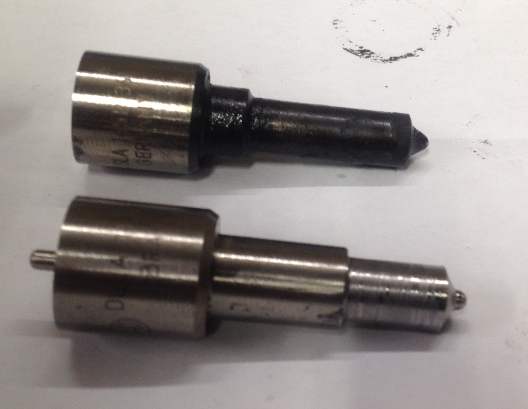

Over here a 300tdi injector in pieces:
Over here we see the 300tdi nozzle, the needle in the nozzle is the same hight as the nozzle so the bushing is limiting the needle movement.
The chamber in the inner part part of the bushing is 0,03mm and the part itself can move 0,27mm in the bushing so we have 0,03mm lift@200bar and a total of 0,3mm@300bar.
Over here our Scania nozzle which is single shot and a different design, the needle has a little rod on top which normally sits against the spring and the needle top itself is 0,3mm lower then the nozzle so the total needle movement is limited to that 0,3mm which is the same as with the LaRo injectors.

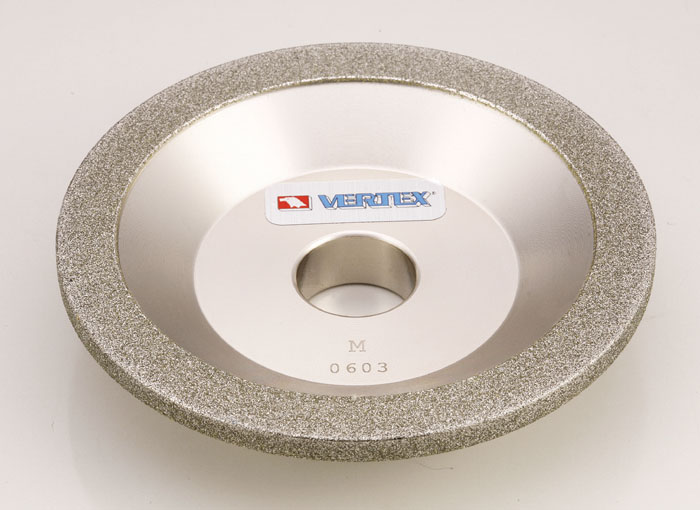

Since I want to copy the LaRo setup I have to remove the little bar on top of the needle and cut away 0.3mm of the top of the nozzle so needle and nozzle are lined up.
My first attempt was in the lathe but since all parts are machined at micron level (there are no gaskets between they are pressure tight steel on steel) that didn't work out very well I used a fine diamond cutting disc used to sharpen drills and machine tools.
I attached it in my mill running high speed with the nozzle on the table and only turning the X axis with a successful outcome.
Also the Scania nozzles are thicker then the originals, 9.07 v.s. 7.07mm so we need to cut them back in the lathe or we have to drill bigger holes in our cylinder head.
Drilling bigger holes is more convenient and safer (cutting back the nozzle can ruin them) but when making over 400BPH and temperatures over 1000 degree Celsius the head will start getting soft and the valve seats will drift away in the direction of the injector so when making the hole bigger that will happen a bit sooner.
What I do is only cutting back the first 10mm of the nozzle so I don't have to drill away material around my valve seats but even in this way there is a 50% chance the nozzle is ruined. (when cutting back the nozzle you go trough the hardened surface and internal tensions can bend it so the needle won't move so good or doesn't close anymore)
