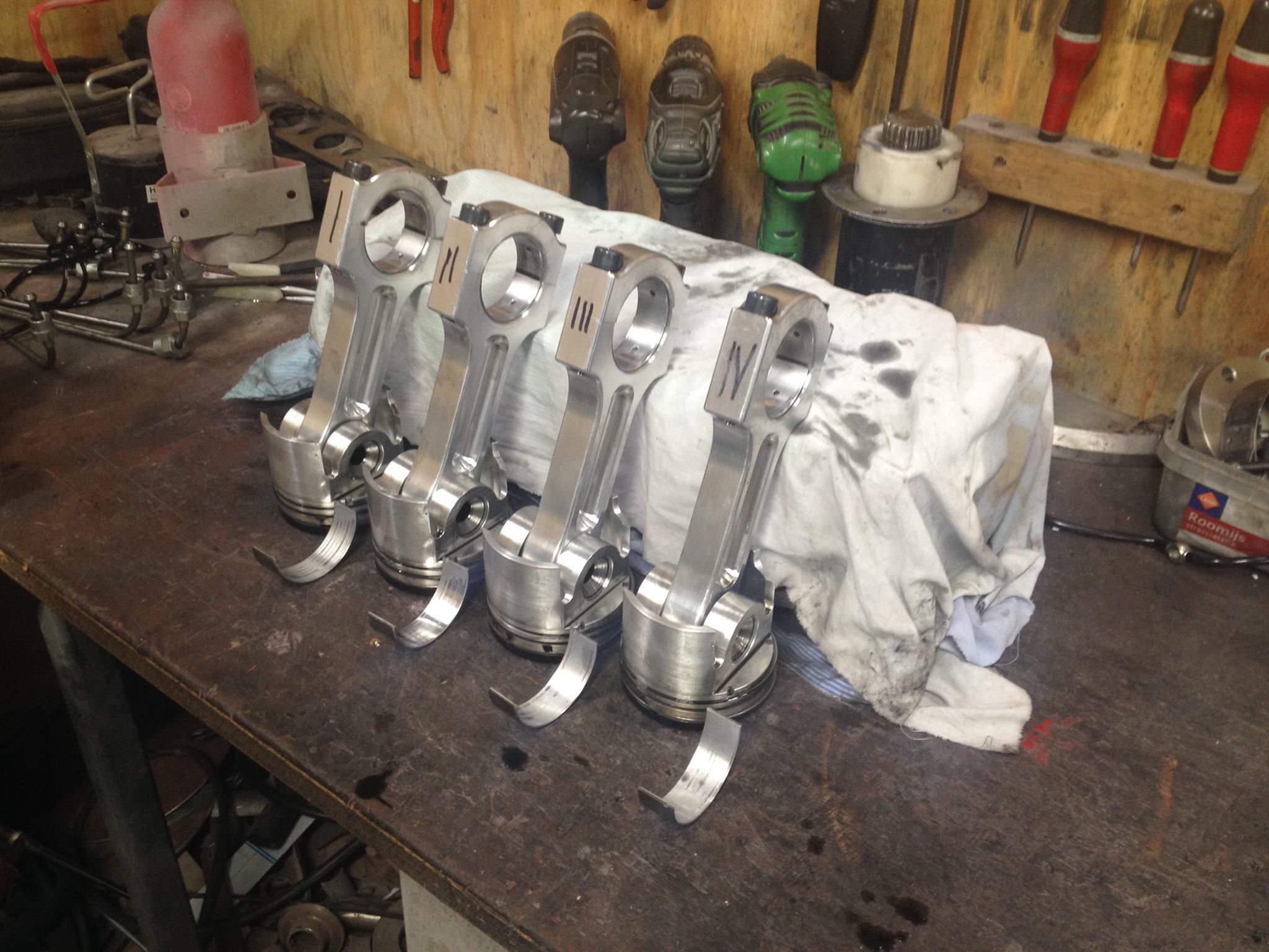

Here the wanted pics, first the modified bearings the idea is a BMW F1 rip-off:
These are the rods and pistons as they came out after last year, big end bearings are OK but the experiment with more bearing clearance on the crank wasn't a good idea so back to the original...

I used my own 2.0 rods but had to make some extra room in the block for it (you see it on the pic) the other machine is using a 2.2 block now and that one has new longer rods.

Check out those rods! Wow!
#42
Yeah, wow, they are rather beefy.
#43
not really, they have to look like that because of the material used

Puney rods.
#46
The first set of those rods where developed and made by us, for the 2nd and 3th engine we asked a friendly machinery to make some sets so we have over 30 at stock for other teams:
