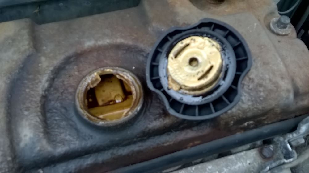

Any idea what was wrong yet LOL

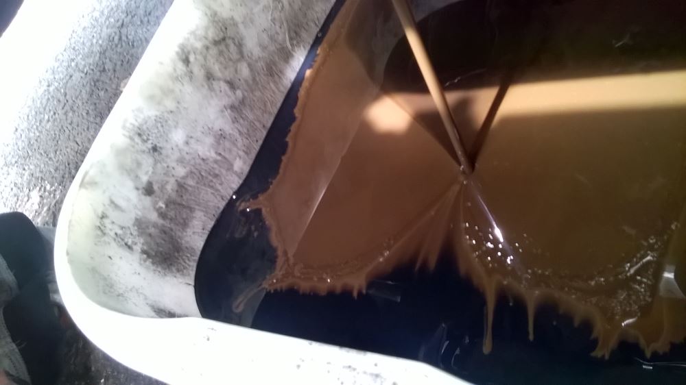

This was the oil (with about 3l of coolant in it.)

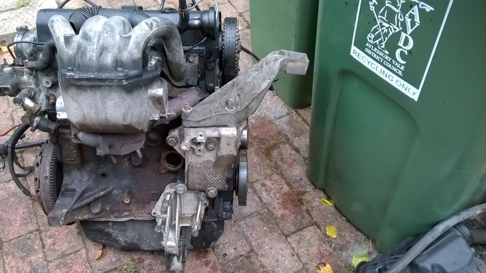

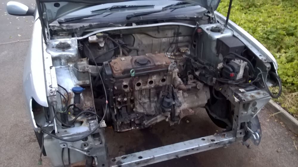

So after liberating the TUD5 from the 106 and getting rid of the shell I stripped the 1.4 ready to drop out.

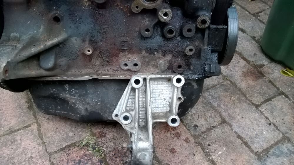

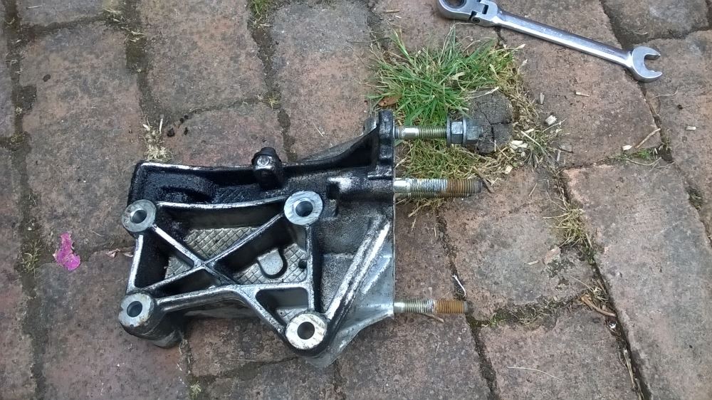

Then spent some time head scratching about the mount that I had guessed would be a straight fit but wasn't. Just needed 1 stud removing and one moving to a different hole thankfully so double nutted them and out they came.
Bottom mount was a straight fit with different length bolts after tapping the holes to clean nearly 2 decades worth of shit out of them.

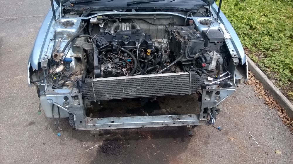

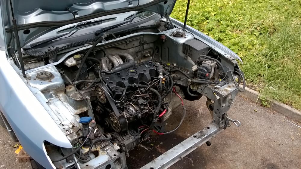

Ready to go in, the water pipe at the back needs a little adjusting with a blow torch to clear the new engine mount but it needs less than 10mm so it'll be fine.

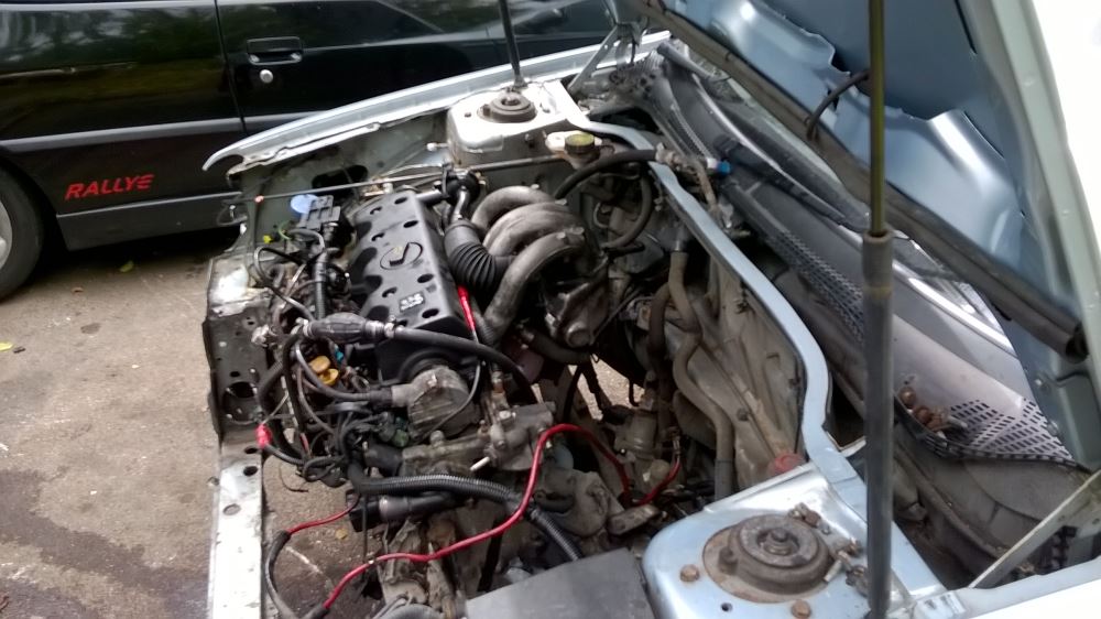

And Look it's in. Plenty of room for 'activities'.
All done in a day on my own and without an engine crane or any sort of hoist, just brute force, ignorance, many hammers and dropping the car down to the engine level.
Engine looks like it's leaning over the front axle a little bit?

(06-07-2015, 04:11 PM)Midnightclub Wrote: Engine looks like it's leaning over the front axle a little bit?
Interesting project for sure, will be interesting how to see how long it'll last before it pops.. with the addition of the blower and hauling a few hundred kilos more than usual!
Yeah the TU lumps do lean forwards a little in the 306, it's accentuated in this cos of the pump and alternator being at the front. It's not as big a weight difference as you might think. Last time I had the 106 weighed it was 860kg and partially stripped and running on fumes so easily 900kg full. The 306 1.4 only books at 1050kg so only 150kg difference potentially or a large passenger.

Little bit more done now, got linkages on and battery tray back in. I've cut away the ECU tray to mount a smaller screenwash bottle so I can put the PAS pump up on the inner wing. The battery is in and the wiring is done bar having the wrong plug on the loom for the reverse gear sensor and I can now lock the car again. Not tried to run it as the starter is still in the garage and needs to stay off while I finish water pipes. Hopefully get some shafts in and finish the water pipes and I'll have a go at starting her.
Oh and the intercooler is here, Mondeo mk4, like most it's just a tad wide but it looks like it's gonna be spot on otherwise and for only £30. Still waiting on alot of fuel piping to turn up.
