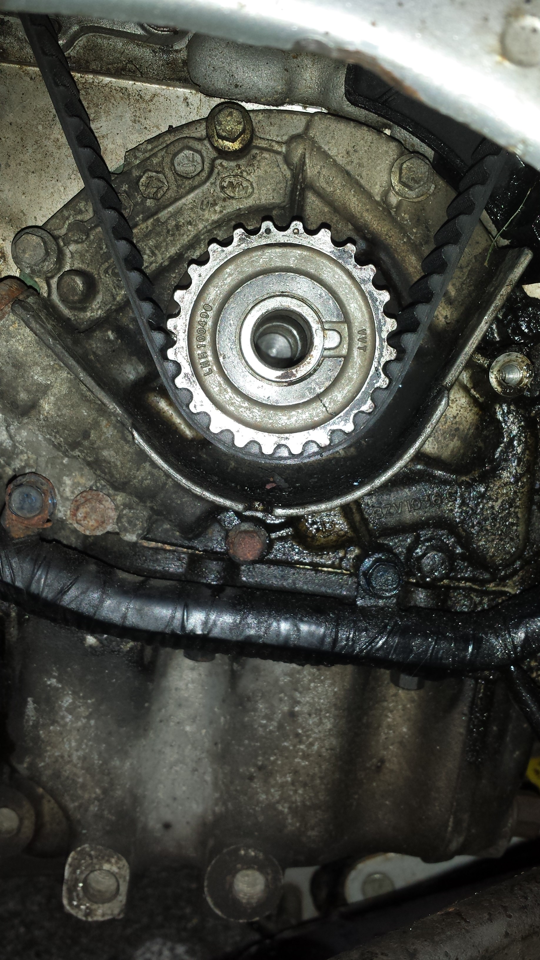

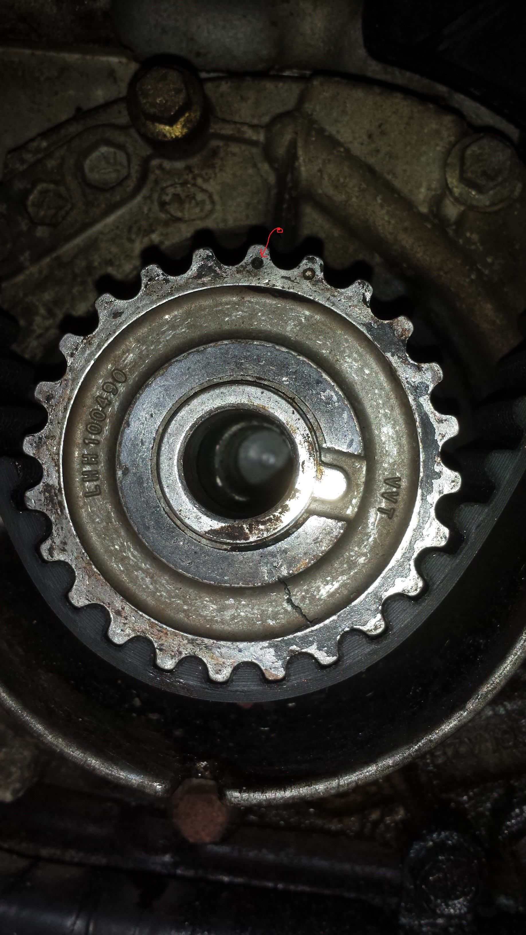

Is there a crack in your bottom timing cog? Or is that dirt?
But even he lines it up and then has to nudge it forward to get the cams right.
You had me worried then but no it's just dirt, one of the previous photos doesnt have it
