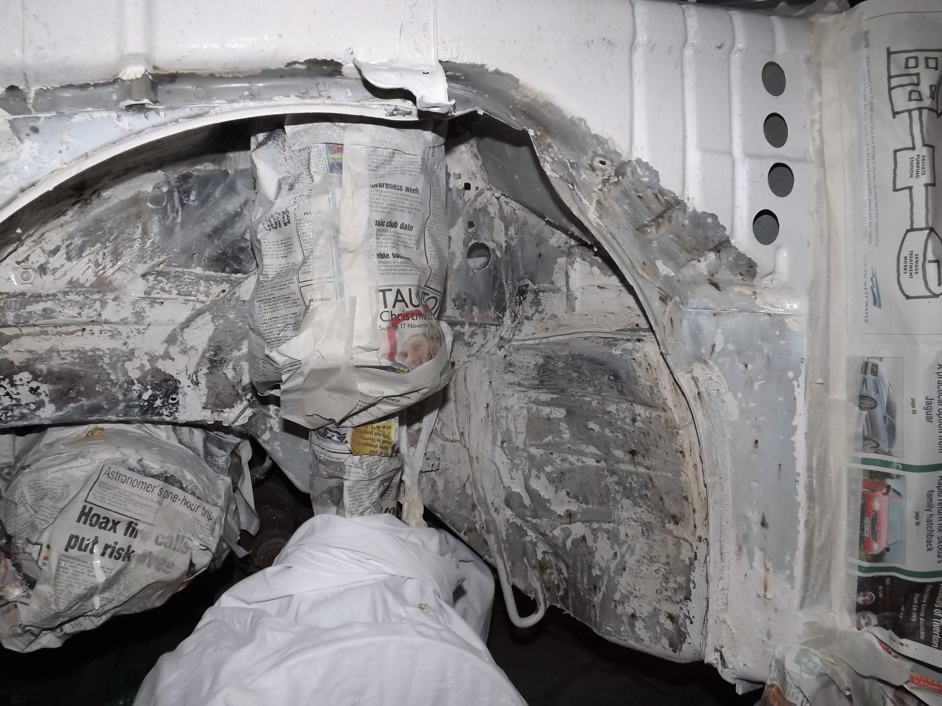

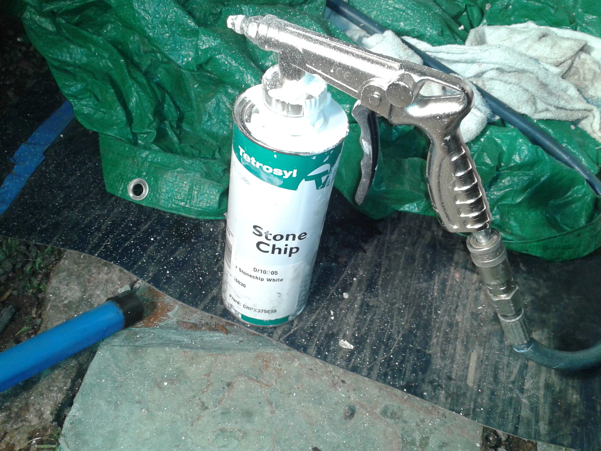

im so F*****G annoyed right now ive had to walk away from the car!!
remember the nice white painted arches! one coat of stonechip later All the feckin paint peals off back to bare metal dont know whats in that stuff but its better than any paintstripper i know so now ive got a big mess to clean up and start again! dont put stone chip onto Halfords spray paints of Hammerite

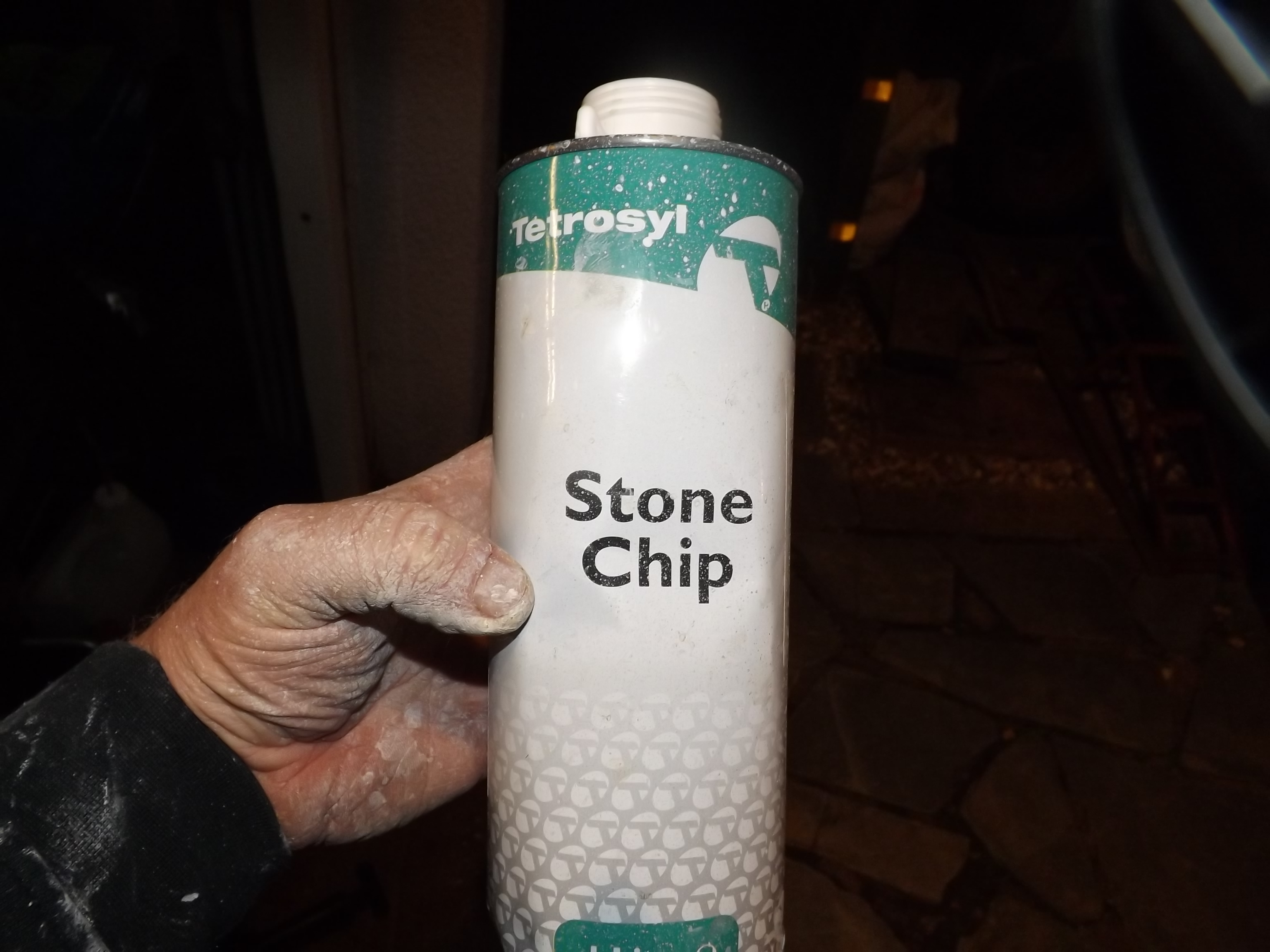

that was white stone chip and it went on so nice
will be spraying it on again in a bit onto the bare metal funny thing is it didnt react with the kurust thats still good

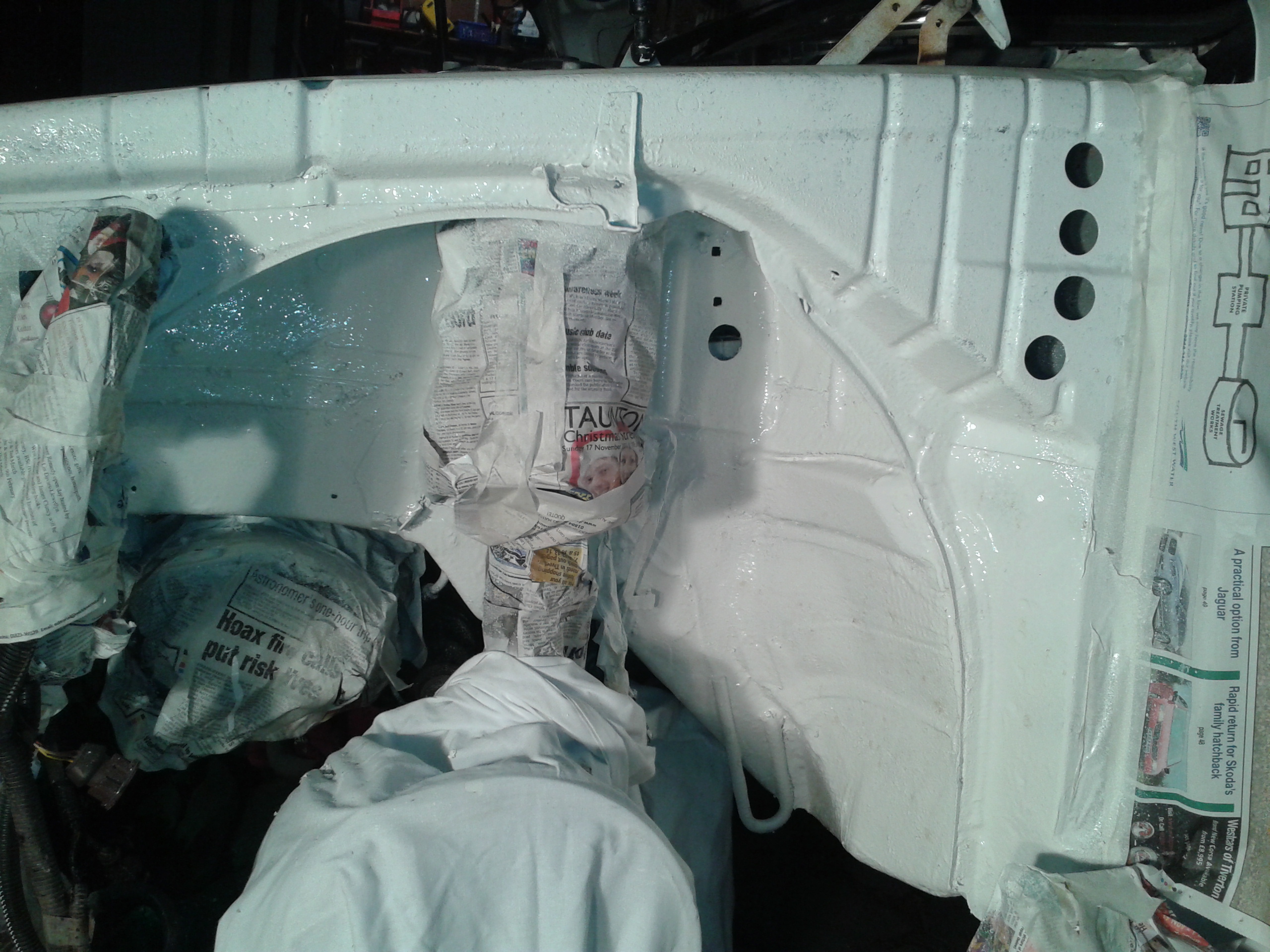

Take two!
thats it for tonight Beer Time

Looks smart dude, get some pics up with all the paper off etc. Will look pretty epic under there!
