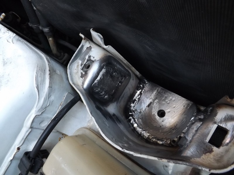

removed paint to get a good weld
ive welded this in with an arc stick welder as the original plate was quite thick,
offered up and tacked the plate then reasembled the top mount to make sure it was in the right place.
be warned the rubber mount is quite big so dont weld the plate to far back into the cup or the mount wont screww in properly
cleaned off the paint so i could weld some side filler plates to limit the forwards back movement too

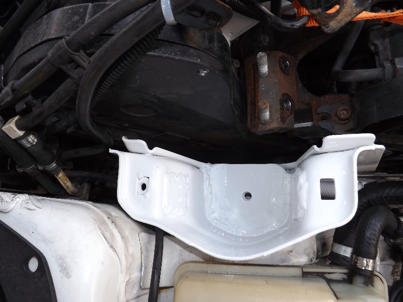

filler plates welded
cleaned up before paint
all masked up
Nice Coat of primer before the topcoat

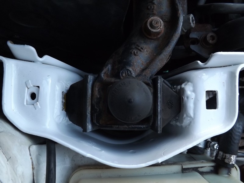

Finnished painted mount waiting for paint to harden then to reasemble the top mount
paint may still be a little soft but who would know whistle
Thats another job ticked off the list Smile
