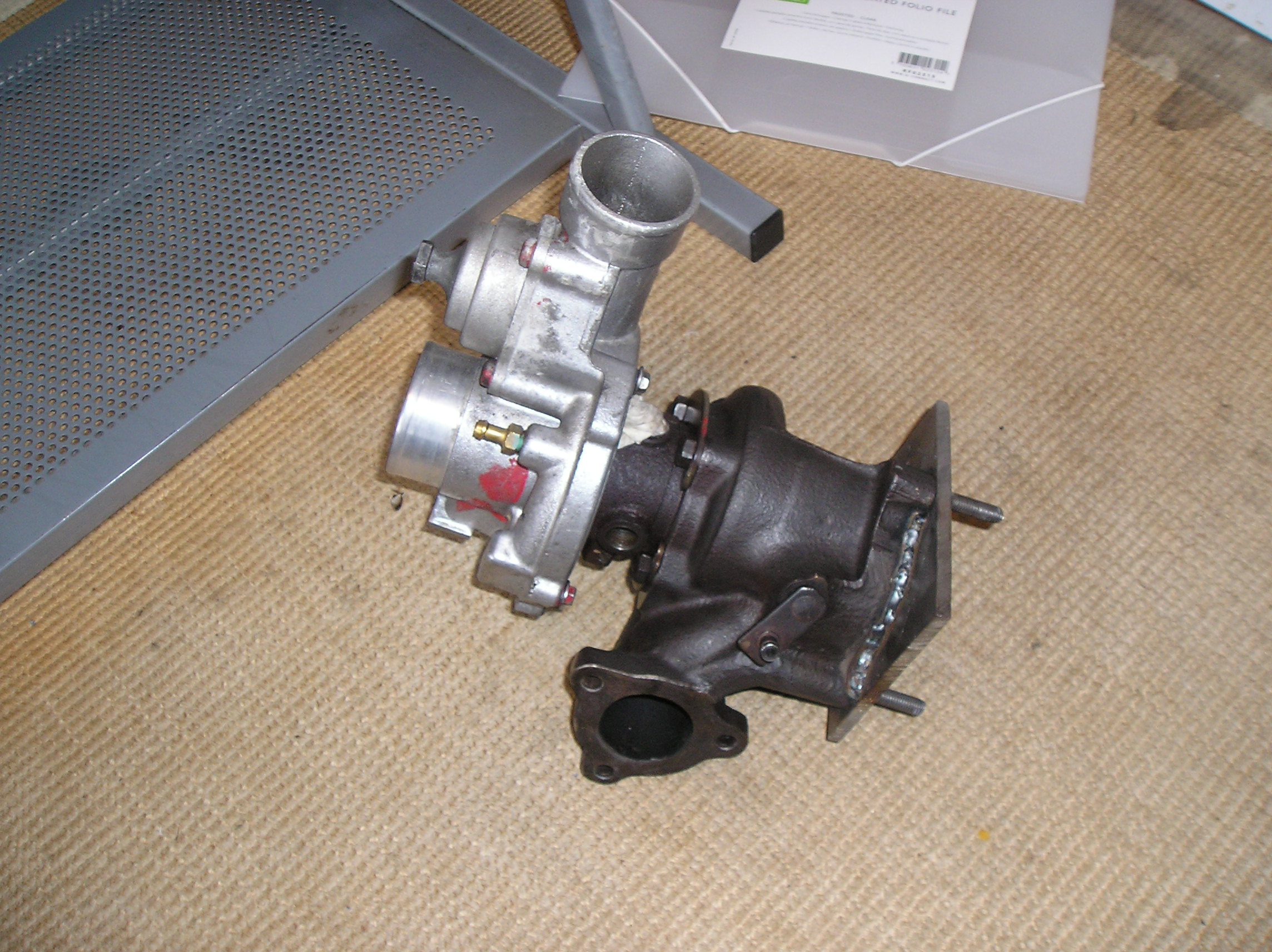

Five minutes later I had the turbo back together

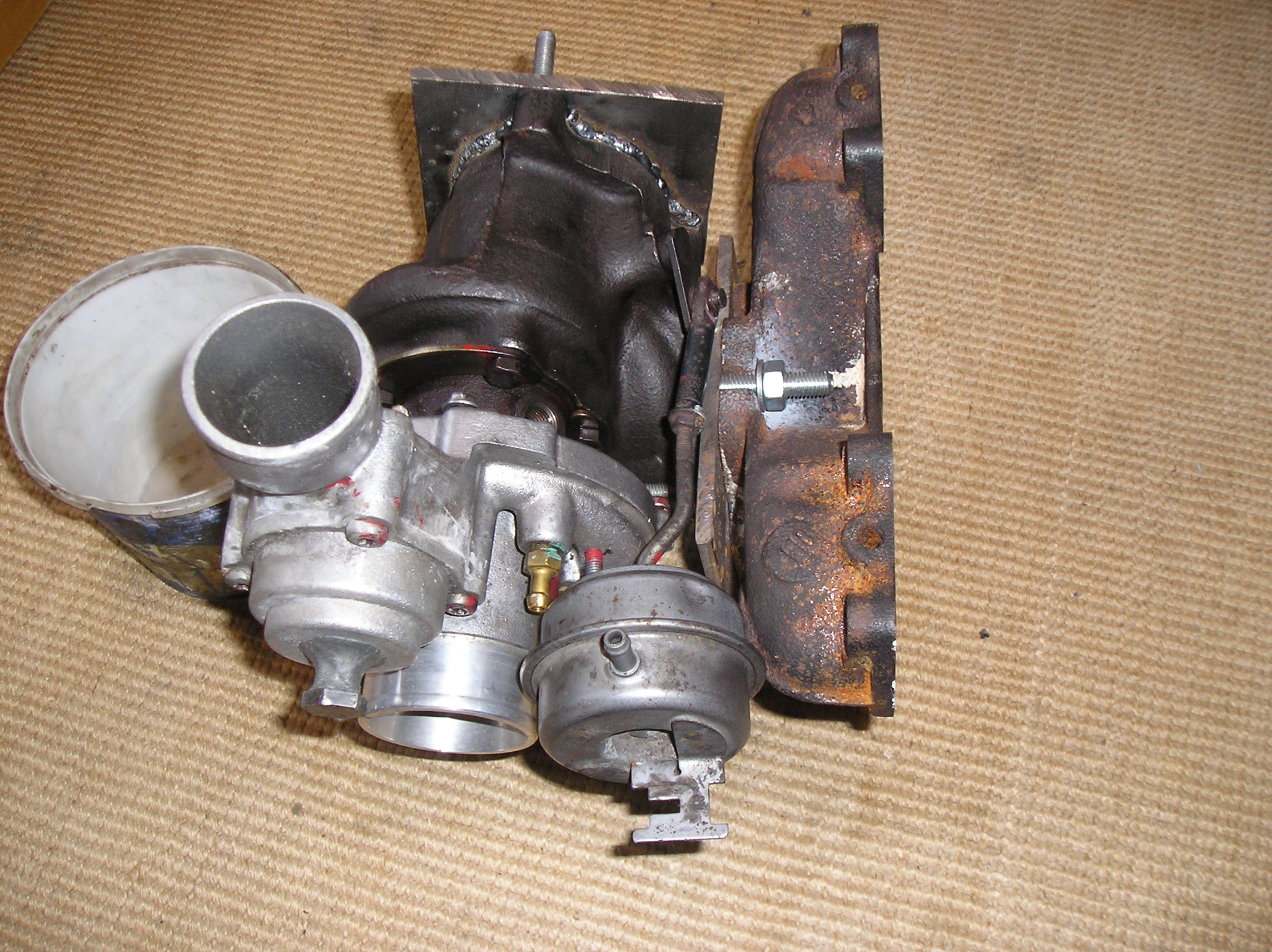

Then I mounted it up to the exhaust manifold

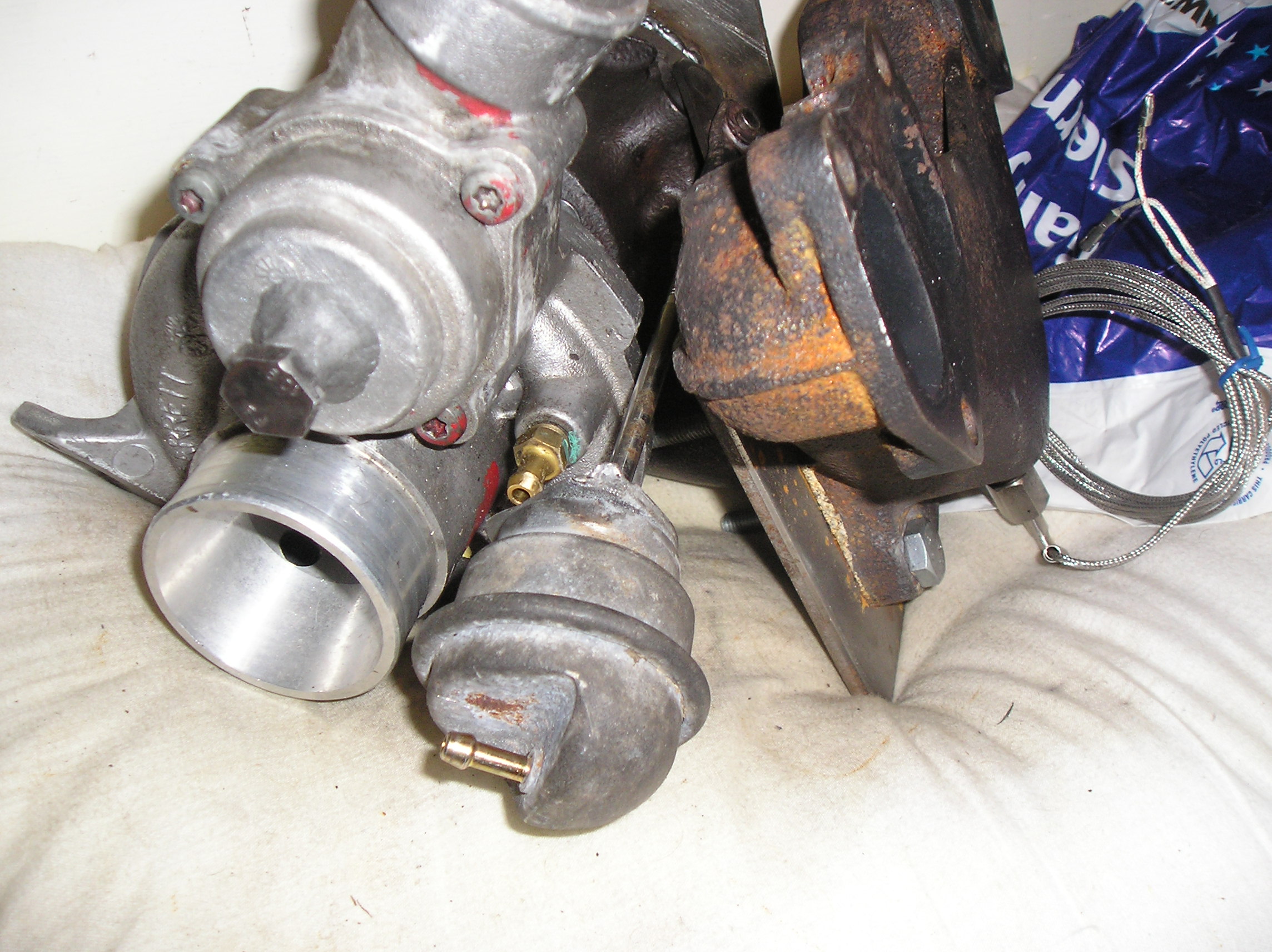

Then I had a look at how I would mount the wastegate actuator
I have no clue, any ideas? Presumably it's got to be able to open the wastegate fully from where it is, not sure how I can even test it (maybe adapt a bicycle pump?) but yeah, no idea at the mo'.
So if anyone has an idea please say...I really want to get this finished. NOW!
Oh yeah and another thing...there is a time limit on this project now, as my mother is having the driveway resurfaced and once that has been done there will be no working on the car anymore Sad
So I need to get this fitted on and tested before then.
Might just be me but that doesn't look right to me i would have thought the wastegate would have been to the rear of the turbo. Also the cold side will need clocking more as you have to remember the angle of the engine, as it is now the outlet will be pointing at the bulk head.
Im probably wrong about the wastegate but sure some one else will be along to confirm
Almost looks like you've got it mounted upside down tbh, or do xuds actually sit like that..? Turbo needs some clocking, should really be thinking about things like wastegate actuation, comp outlet position, etc long before you start cutting and welding stuff. Trimming the excess off that plate should help.
As already mentioned, its going to be a pain in the arse to fit an actuator with the wastegate where it is, especially when you've clocked the cold more, the outlet is going to be right in the way - what a bummer Sad
Really liking where your EGT probe is sitting now mate.
For the waste gate actuator id be looking to move it round so it sits above the CHRA or even further, you may find you need a new actuator and maybe use a slightly bent VNT actuator bracket to mount it in the right place.
As for testing it I used a bike pump as I've tested the gauge against a known good boost gauge and its spot on. Have a look at my project thread.

The clocking hasn't been done yet, I've just adjusted things roughly so that it is recognisable that it is a turbo. As for the wastegate location that is something specific to this turbo, it would have made sense on the engine it was originally intended for lol
(05-10-2013, 07:44 AM)Poodle Wrote: Almost looks like you've got it mounted upside down tbh, or do xuds actually sit like that..? Turbo needs some clocking, should really be thinking about things like wastegate actuation, comp outlet position, etc long before you start cutting and welding stuff. Trimming the excess off that plate should help.
If the turbo was mounted the other way around the exhaust side would be where the compressor side is and the compressor side would be where the exhaust side is Big Grin And it would be really low.
As for planning ahead well that is not really my strong point, I find it hard to visualise stuff that way. And would the excess on the adapter plate get in the way? I have already had to do a fair bit of hacksawing and would rather not have to if it is not necessary!
And as I have mentioned, I have not clocked it yet, I'll have to do that when it is on the engine! Should be one of the easy bits!
Thanks Dum-Dum. I believe that Dave mentioned something about the wastegate but he didn't elaborate, I'll see if I can get his attention.
Fake edit: Just realised I can get a bit of metal welded to the turbo to mani adapter plate to act as a bracket for the wastegate, so that's the problem of what the bracket will attach to sorted Big Grin
As for the actuator, can I use any actuator? As I have an actuator on the scrap turbo that I bought by mistake, it is a lot smaller than the one on this turbo!

(05-10-2013, 02:06 PM)306Puggy Wrote: As for the actuator, can I use any actuator? As I have an actuator on the scrap turbo that I bought by mistake, it is a lot smaller than the one on this turbo!
Pretty much any actuator (as long as its a boost one). Test it with a bike pump, the one I'm using starts moving at about 4 psi but doesn't reach full extension till 40psi, obviously by adjusting the arm you can alter when it opens the gate.

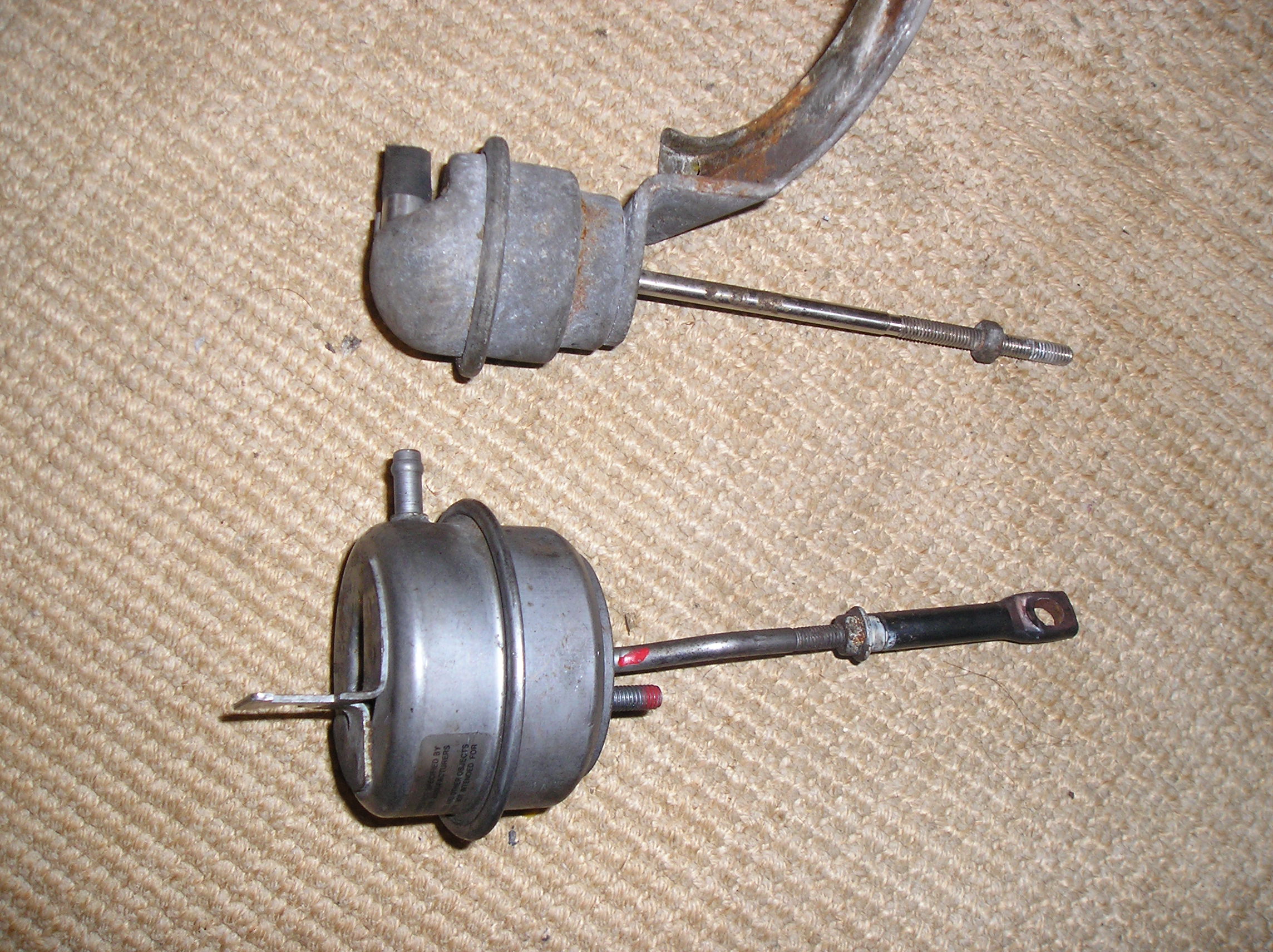

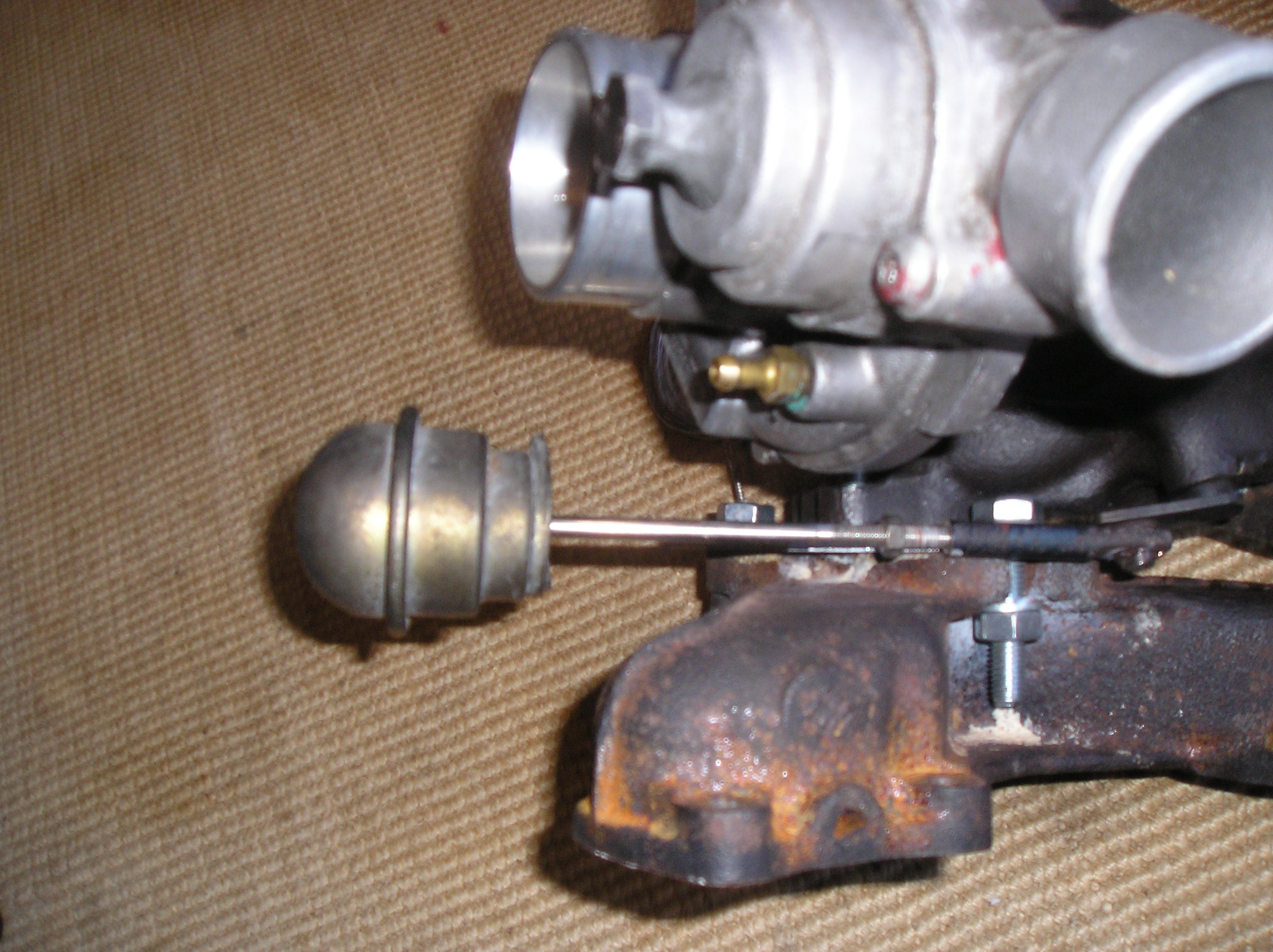

Right, recovered the actuator from the scrap turbo. Is the only concern then the actuator stopping me from clocking the turbo to intercooler outlet? It won't catch on anything in the engine bay? Oh and the rod on this actuator is straight, I don't know if it will be able to push the wastegate arm all the way from the angle it will be mounted at?
This is the actuator off my scrap turbo (the one that I mistakenly bought for eighty quid) compared to the actuator for the GT2052S
And this is how I propose to mount it onto the turbo
Can anyone see any problems with me getting it tack welded to the mani to hold it in place?
Well.. It's a cast mani, so there's a risk of shit welds fatiguing and the actuator falling off.
But my concern would be trying to fit that over the inlet mani. Don't know if it's the angle of the photo but it looks to be sitting right where the runner for cylinder 1 will be on the inlet mani..

Having looked at another xud thread i can see that is the way the turbo is meant to sit, so i'll shush lol. What Pellowe said, that's what i meant about it looking upside-down (ie it sticks too far "up), I just did a bloody awful job of explaining it.
(05-10-2013, 09:05 PM)cwspellowe Wrote: Well.. It's a cast mani, so there's a risk of shit welds fatiguing and the actuator falling off.
Ah, yes! See what I mean about not thinking of things until someone points it out! I totally forgot all about the inlet mani when I was visualising how this would fitConfused Well, for the moment I will crack on with the other bits like testing the actuator and the inlet piping. Does anyone know if I can use the existing inlet piping that goes onto the standard turbo? Would save time and money if I could.

(06-10-2013, 05:44 AM)Poodle Wrote: Having looked at another xud thread i can see that is the way the turbo is meant to sit, so i'll shush lol. What Pellowe said, that's what i meant about it looking upside-down (ie it sticks too far "up), I just did a bloody awful job of explaining it.
Heh, okay. Yeah, the XUDs do look weird because of the angle they sit at.

Edit: What do we think about having the actuator down here?
Why dont you lift it up and use the 2 screws on the valve thingy (what ever it is) on the out let to hold it? if you make a bracket of course but that seems the easiest way to me as were you have it now i struggle to see how you can keep it in place?
Hi Chris_90. The issue with having it at that height is that it would be in the way of the inlet manifold. Keeping it in place isn't too much of a problem because I have off cuts of metal I can use to weld to the adapter plate and then get the actuator welded to the other end.
At the moment we are just trying to find a location for the actuator that won't be in the way of anything round the back of the engine. Obviously I don't have an engine to mock it up on or it would be way easier to do, hence why I have to show a picture to the forum and then get the forum to say whether it is okay or not Big Grin
Ahhhh been a while since i looked down back of a d turbo, are you not gonna struggle with clearance of the valve thing you have sealed off?
Think welding a bracket to the adapter plate is best idea if its gotta be down there out of the way.

I don't know about the recirc valve yet Chris_90, but I can hacksaw the head of the bolt off if need be, if I have to go any further then I will need to make up a flat blank off plate for it.
I just need to wait for a Dturbo person to confirm whether the actuator being down there is "out of the way" or not, before I get a bracket welded for itUndecided
Anyway, another minor update (already, I hear you cry?)

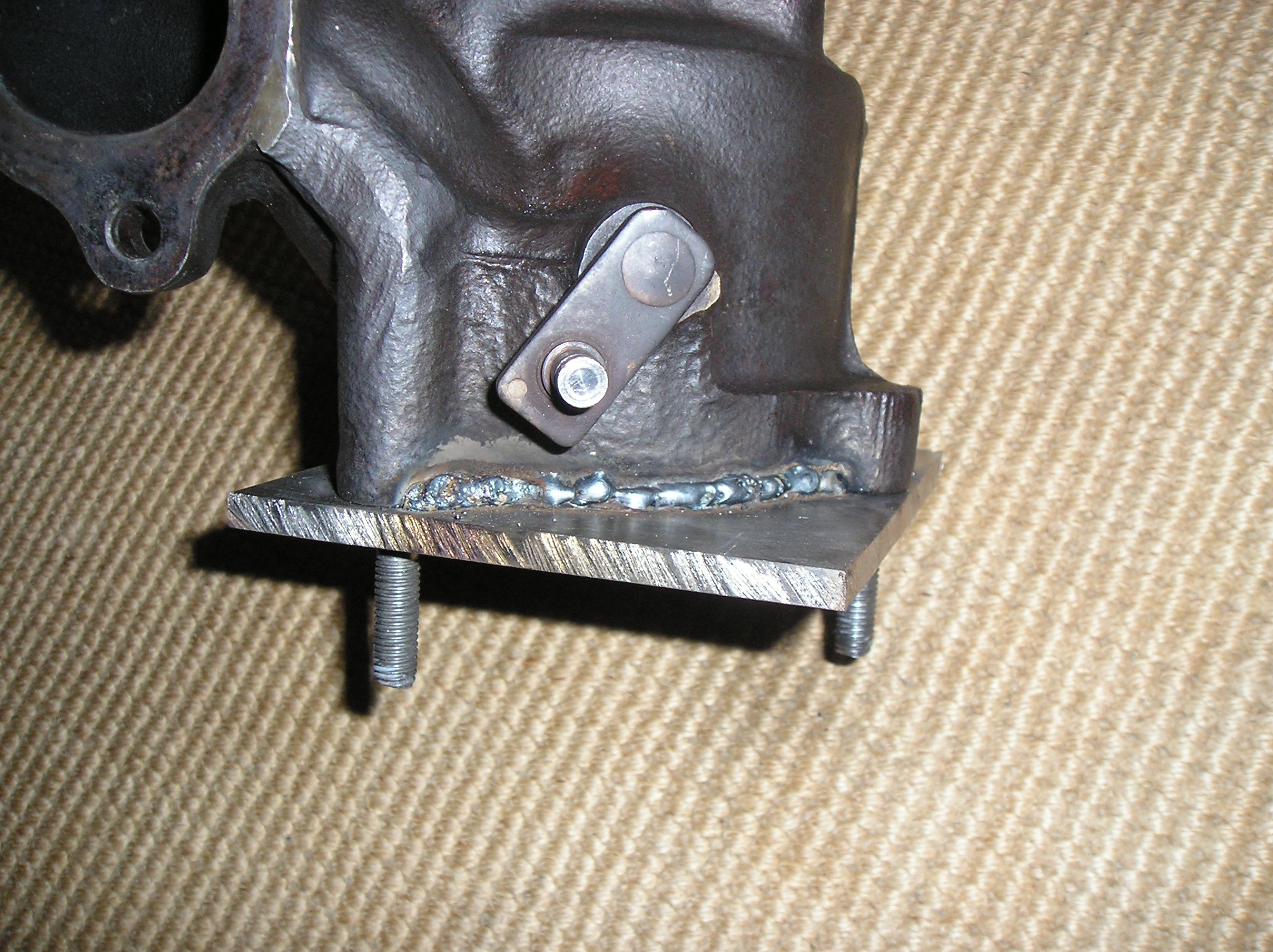

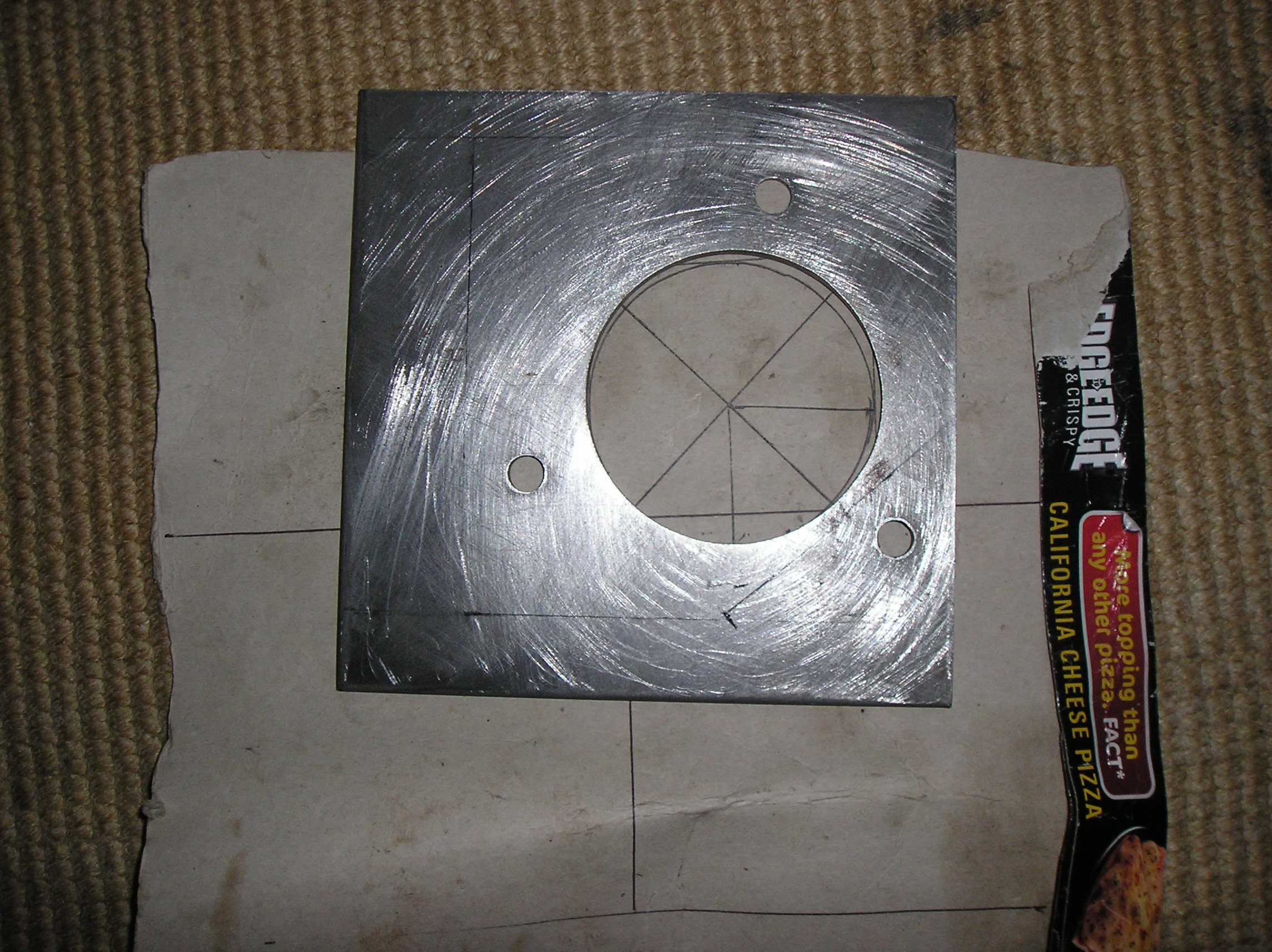

Trimmed the adapter plate right down so that it doesn't obstruct the wastegate arm and removed some other unnecessary bits, reckoned I saved a few hundred grams on it
Then I realised that the actuator can be extended even further out if need be

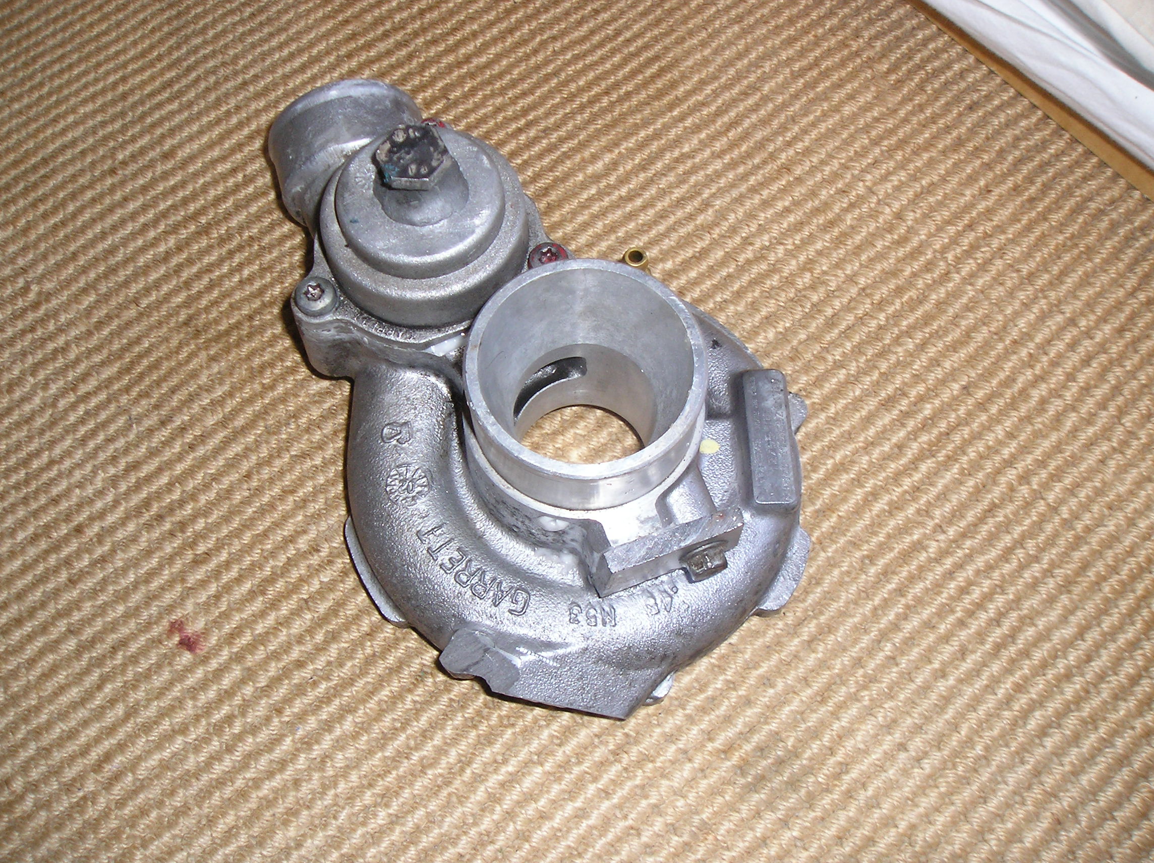

Then I removed the comp housing and hacksawed off the old actuator bracket, it's already gonna be a tight fit down the back of the lump without that huge bracket sticking out!
So yeah, at the moment the main thing I am waiting on is advice on this actuator! Tongue Welding is annoyingly permanent when it's in the wrong spot.

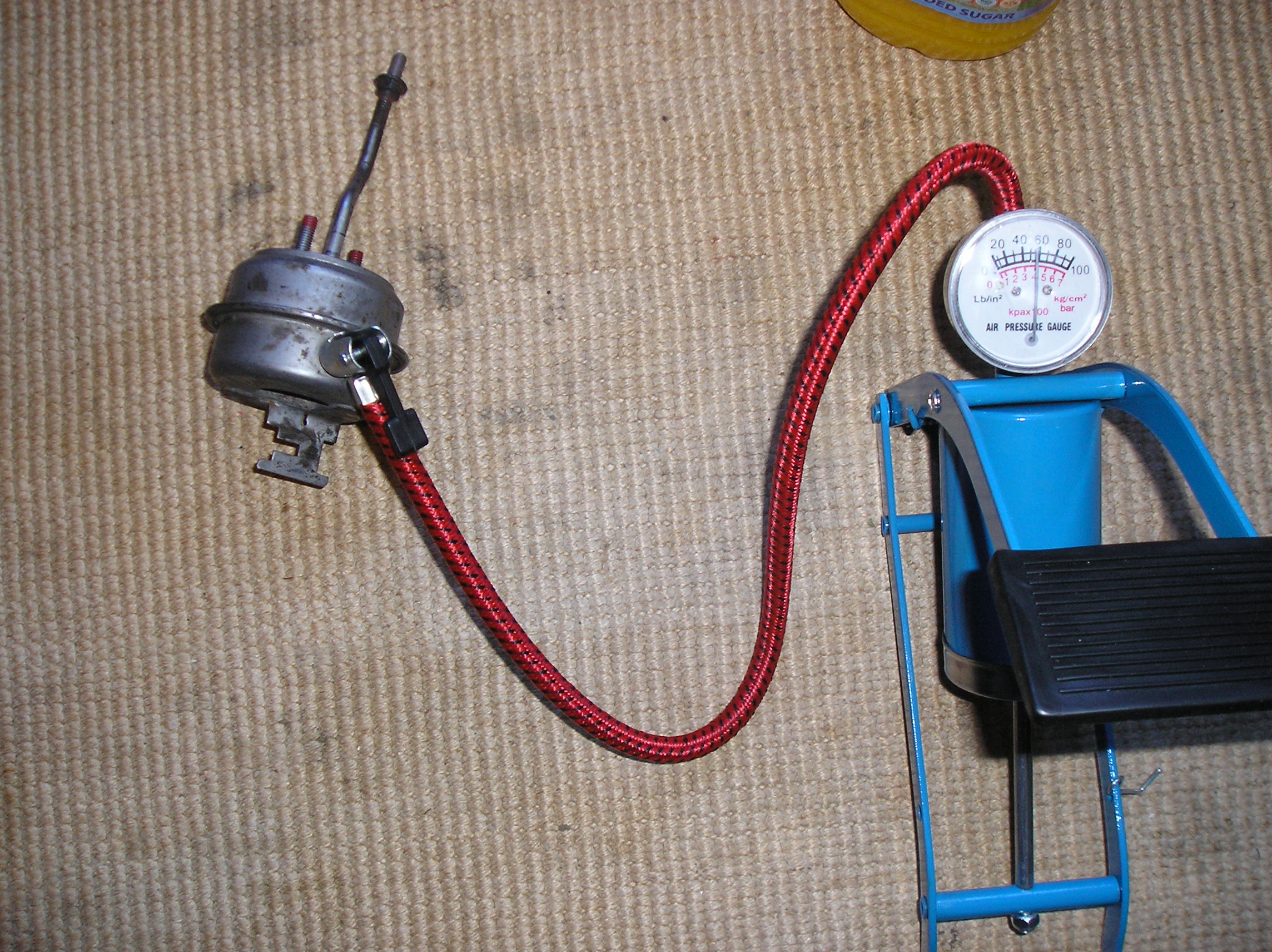

Plenty of room eh? I like the sound of that Smile Well, just ordered a bicycle foot pump off eGay this morning, so assuming that arrives by Wednesday I should be able to test the actuators and compare them and then get the actuator bracket welded! Also I just remembered obviously using a 6mm adapter plate there is gonna be 6mm more room at the front anyway! So hopefully that will leave loads of space for the actuator. But I am referring to the original position that I showed you, not the one where it is fully wound out on the control arm, just to clarify.
Right, another update. Pump arrived in the post today. Tested both actuators and me being me didn't think about the fact that the pump I bought being a cheapo one didn't have much resolution on the pressure gauge at all. Basically it starts at about 20 psi so all I know is that both actuators work and they are all fully extended by 20 psi by about 1.5 cm each.
So they are both pretty much comparable and as I am going to be running an MBC so I guess the pressure doesn't matter at all, it would only be if they didn't move until 30 psi or something that I would be in the shit because I will be running 25 psi max on this setup.
However, I have tested the wastegate arm and it appears to have about 4 centimetres of travel from fully shut to fully open? Or is most of that just redundant travel? Because as said the actuator arms only seem to move about 1.5cm each.
Right, pictures of testing below:

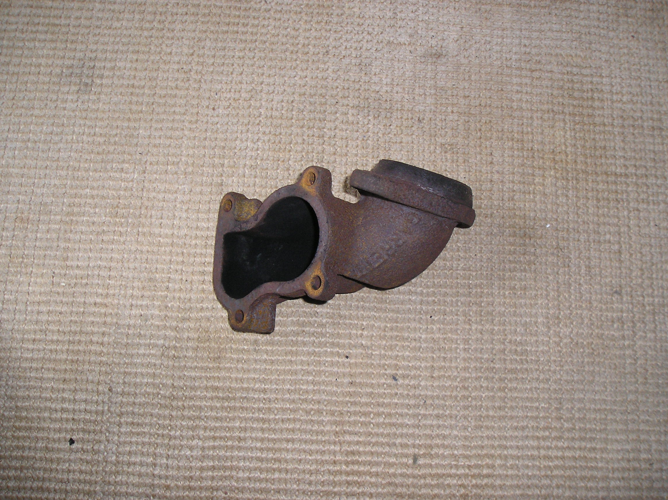

Right, quick update, got an elbow for a bargain. It was up on eGay for 25 quid but knocked him down to 20 for it, bargain!
Here's the beauty in question:
It is a T2 elbow, and it's really restrictive, a lot more so than the K14 one! Good thing I am only using the flange off it really then isn't it?
Next stage is to get a mandrel bent 3" pipe like the cheaper one of the two I showed you all in this thread:

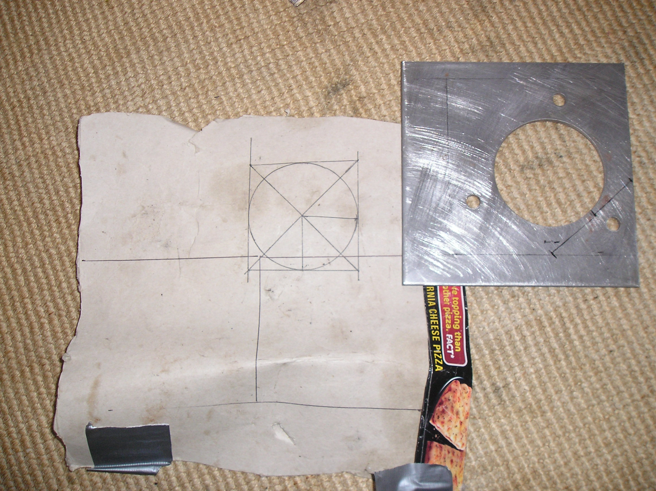

Oh and I did some working out of the angle for the elbow last week as well, but didn't post it as it was a bit off topic from actuator testing:
And that, my friends, is how you work out a 45 degree angle on a circle! Saves a fortune on V band clamps. If anyone needs this described in detail just PM me Smile
Please tell me you haven't spent £20 on a T2 elbow - just so you can cut the flange off it and weld that to a reducer and then to a 3inch 90?
You spent 20quid on that piece of crap? Could of bought a tight radius 90, flexi and maybe a reducer aswell for that!
(14-10-2013, 02:56 PM)Tom Wrote: You spent 20quid on that piece of crap? Could of bought a tight radius 90, flexi and maybe a reducer aswell for that!
You couldn't, not in 3" at least.
