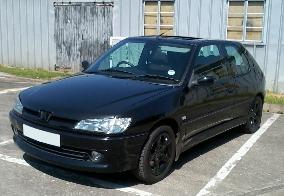

Hi all.  This is my beast, its a 1999 XS 1.8 16v, when i bought it, the car was on its last legs and looked very sorry for itself.
So far i have:-
Removed all S**t stickers and racing stripes from it. G3,G10 the bodywork.
Removed the luminous green hand painted muck off the alloys.
Replaced the gearbox and clutch
Complete timing belt kit and water pump
New rear discs and pads plus handbrake cables
new lower suspension arms
Reconditioned the drivers door window regulator
Replaced drivers door check strap
Full service
New rear headrests
2nd hand race exhaust, replacing the botched on 106 exhaust ???
Race air Filter
Alloys now sprayed black
Waiting for xenon headlamp bulbs to arrive Inlove
Currently saving up more wedge Censored ( a good lottery win would be nice)

Looks nice and a good save! Wish my 1.8 was a 3 door D:
looking sweeeeeet
bodywork looks reeaaaally tidy...is that just a good pic?!
tidy!!!!
looks tidy ThumbsUp
Nice!
I had a black XS as my first 306 and loved it to bits. I wanted another one 6 months ago but couldn't find one in decent enough condition Sad
Mine was on a V too!
[Image: Sig500x130.png]

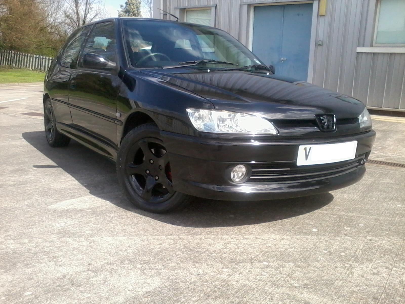

After masses of elbow grease the bodywork is in very good condition for its year, i was surprised how well it came up, it has a few knocks and scrapes on it but then it is a 14 year old car.
It has had a lot of money spent on it at some point, it has been professionally de locked and came with a huge wadge of previous bills mots, including the original sale invoice.
I want to keep the outside stock as i love the shape of the 306, but want to do a crazy engine conversion with somthing around the 200bhp mark, but not sure yet which route to take, i will post more pics as i go.

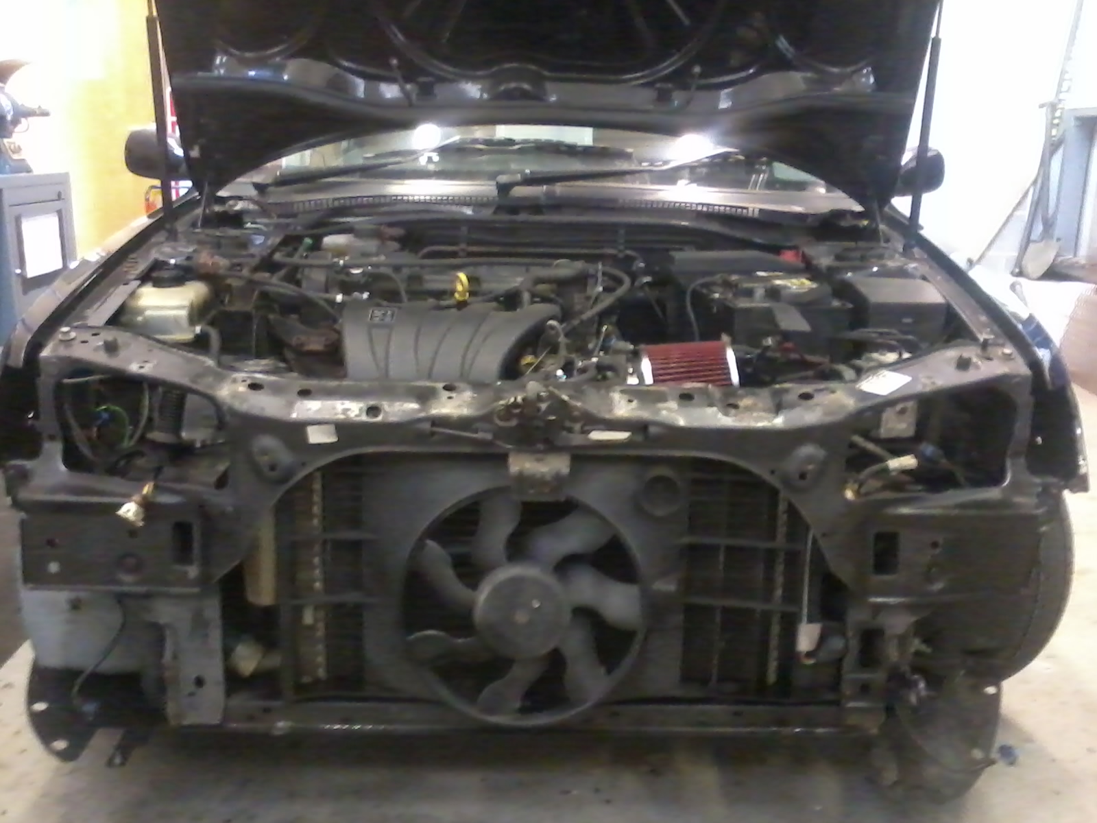

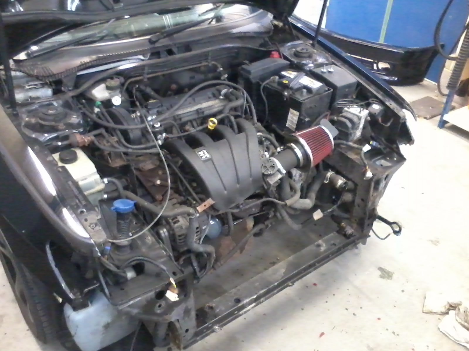

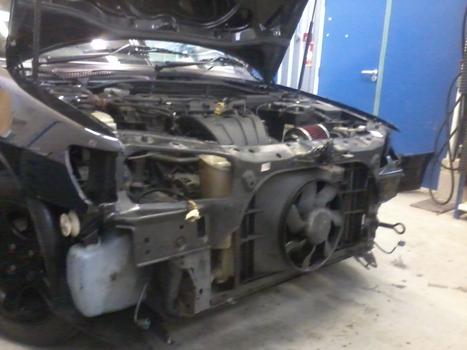

Couple of pics from today, got the front stripped, need new headlamps now as the clips at the edge snapped despite my best efforts. Good excuse for a twin headlamp conversion Inlove

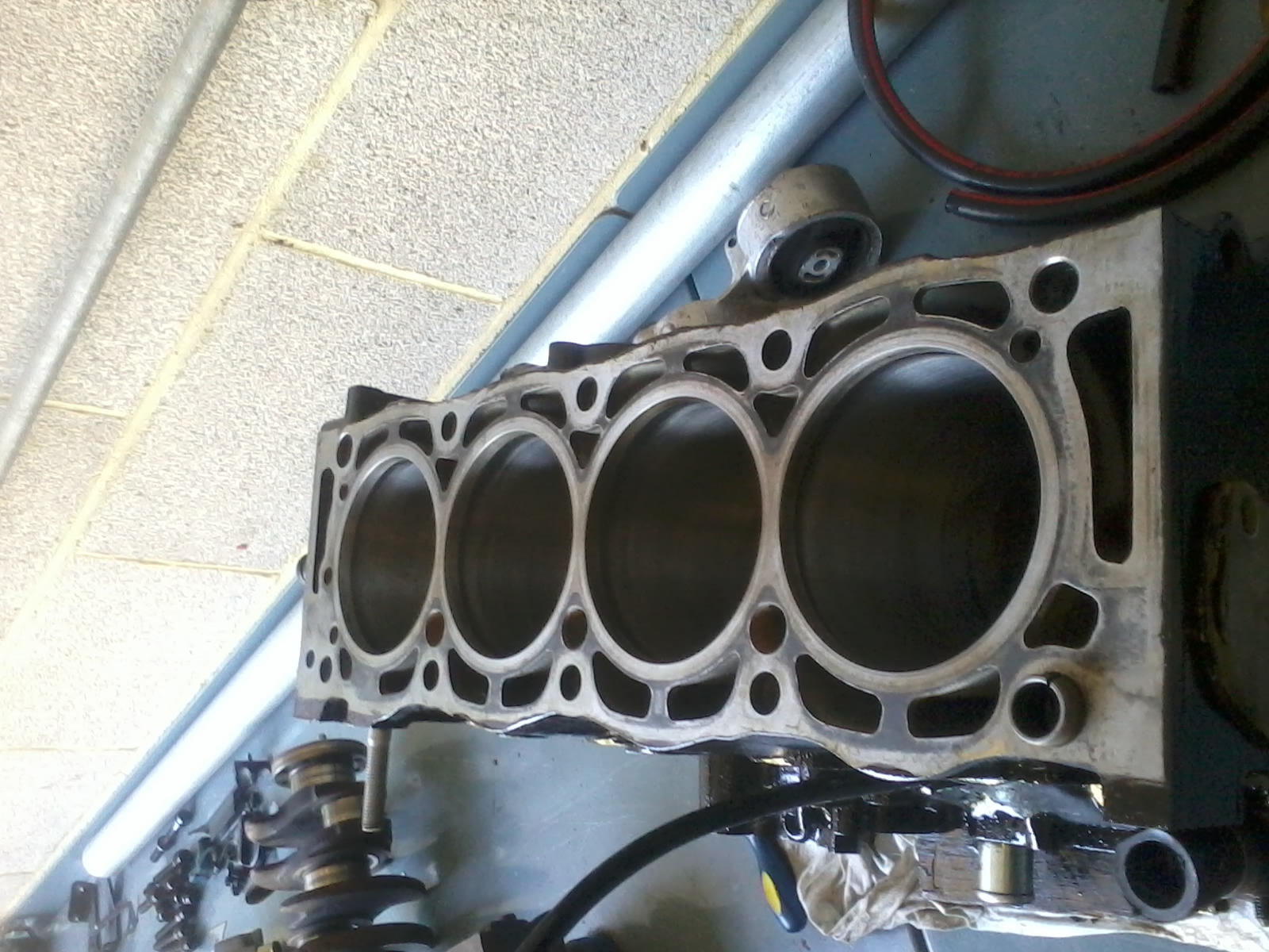

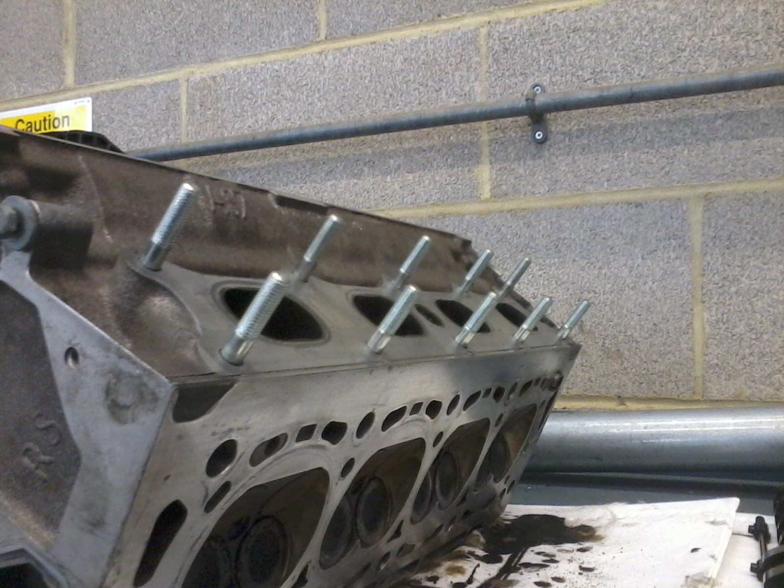

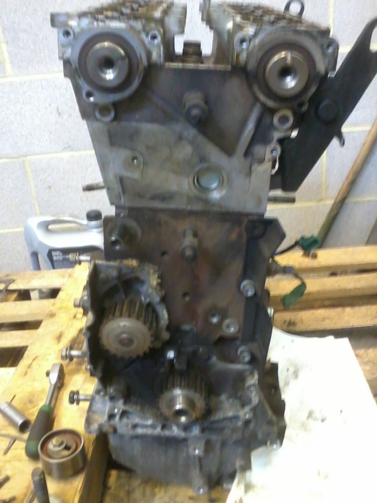

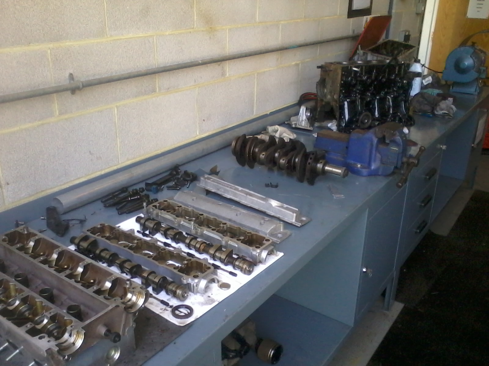

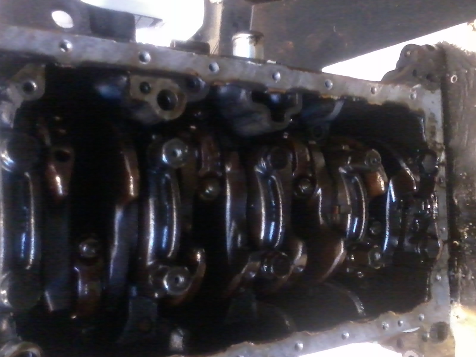

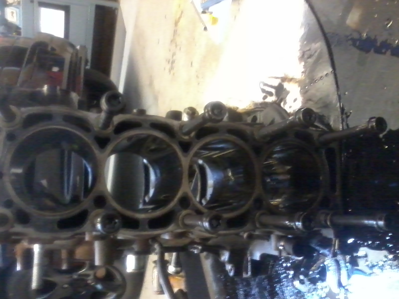

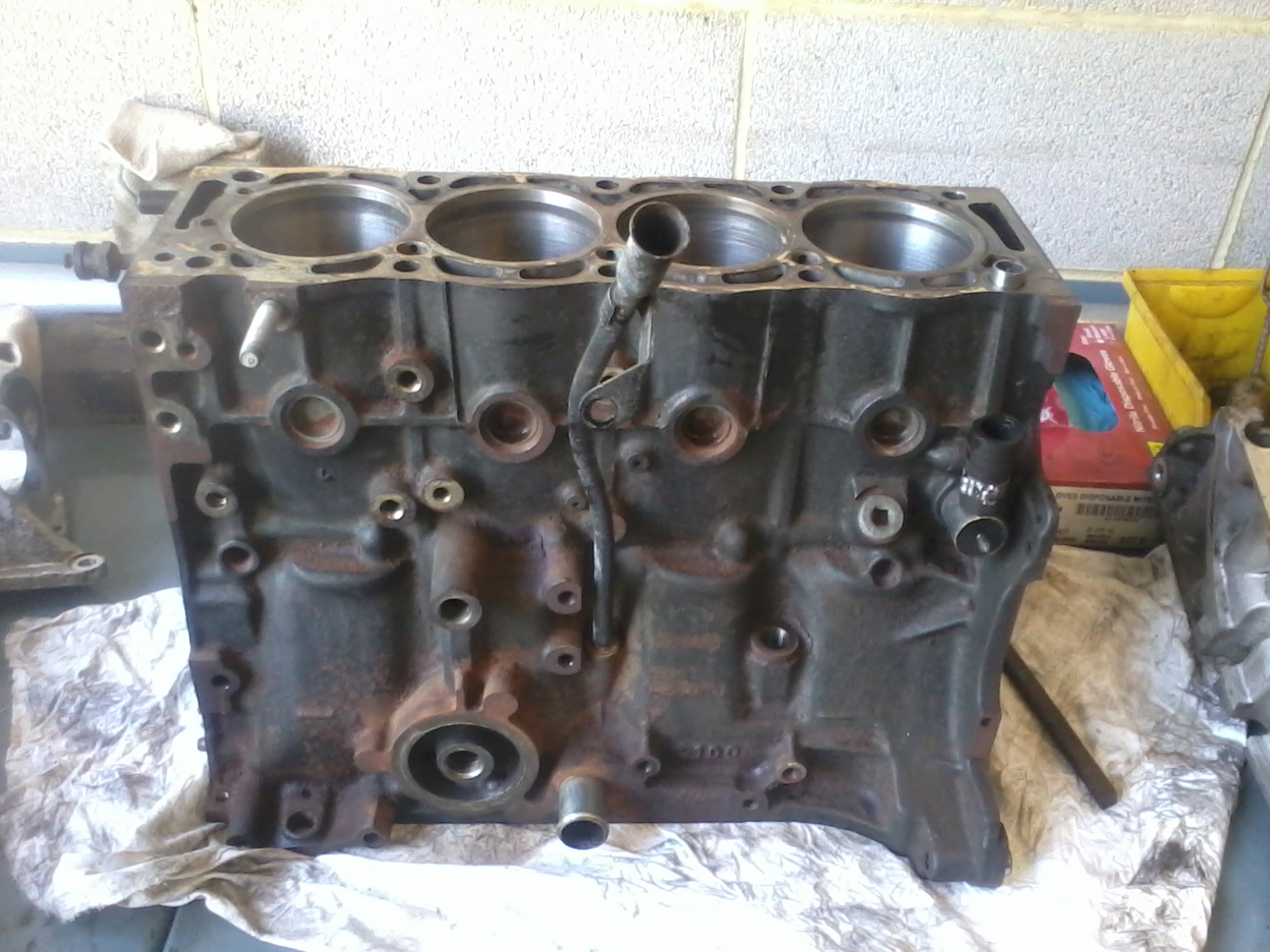

Some more of the engine strip down. Tolerances are looking good.

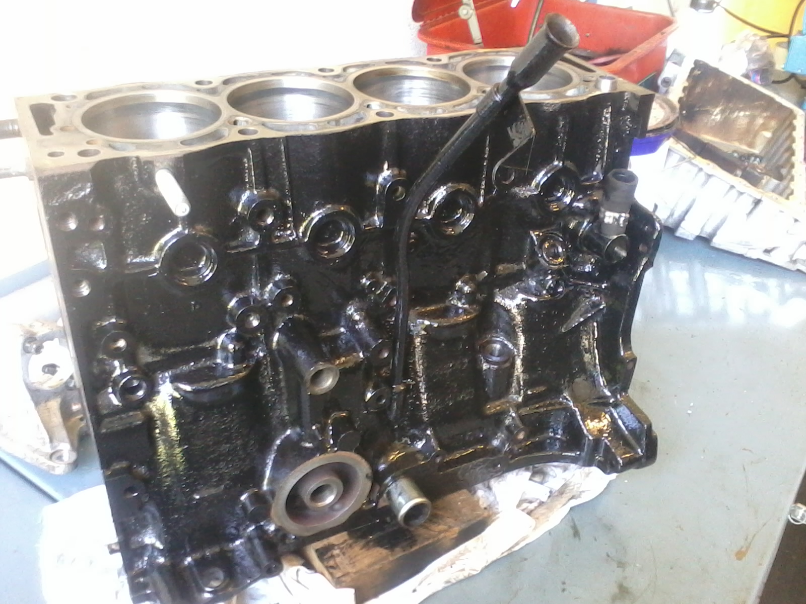

The block is now painted.

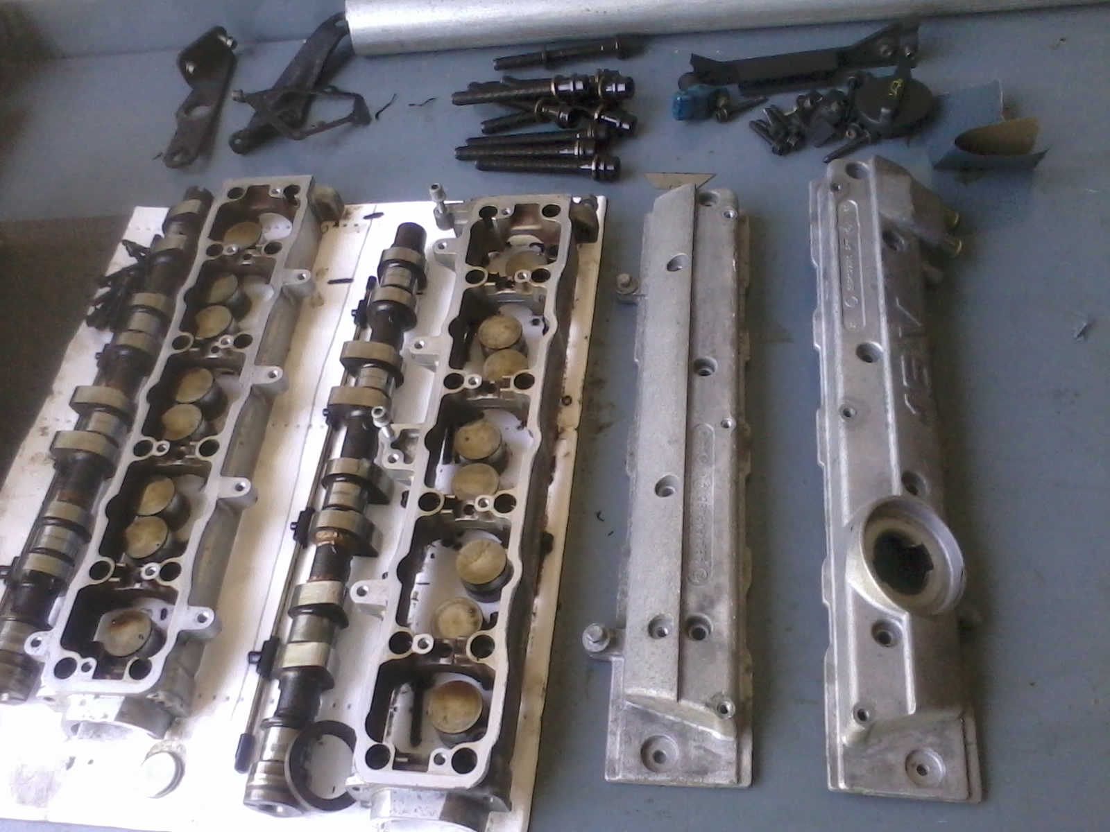

Some of the head.

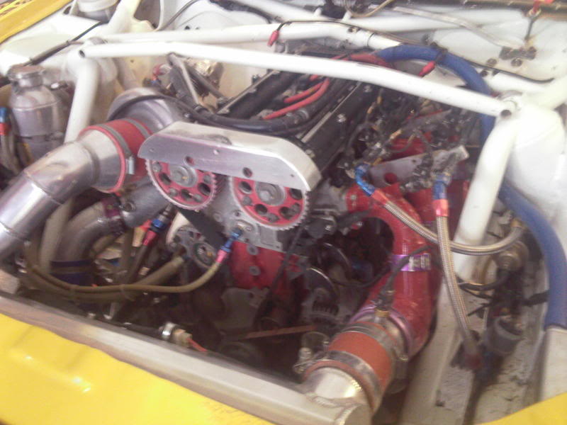

Personally i want a turbo 306, when i was a apprentice i use to work next door to G Tech Motorsport, most of my Saturdays after work were spent just watching and learning from the chief technician there. Their rallycross 306 is the ultimate 306. 500 BHP and 4WD total monster of a car. Would love to have that as a road car.

Got the rest of the front end off today, discovered the bottom hose connection had sprung a leak at the join due to corrosion, so new bottom hose needed now.
