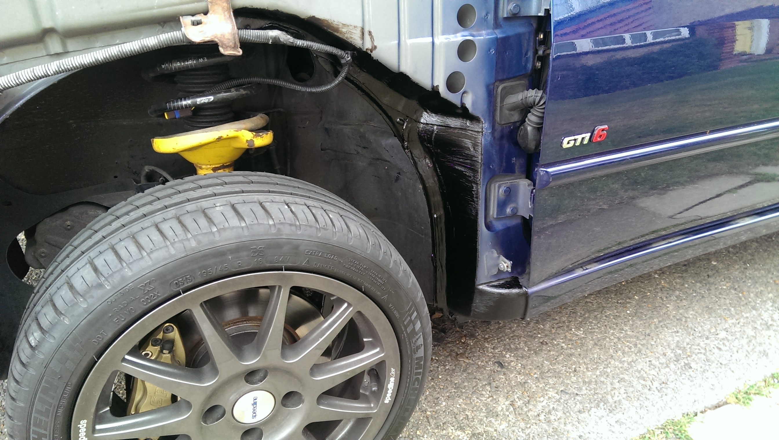

Got the week off this week with nothing to do so thought i would spend a week doing all them annoying shitty jobs that you never get round to. First was to replace my wing which i dented at pugfest. Thats already turned into a big job! When under the car, i realised i had cracked the sill trim when i hit the line pin so that had to come off to be repaired so it doesnt let water in. Once i got the wing and trim off, i found a few bits of surface rust so thought now would be a better time than ever to get rid of it.
Half hour of attacking it with a wire brush and wire attachment for the drill and 2 coats of underseal later and im left with.

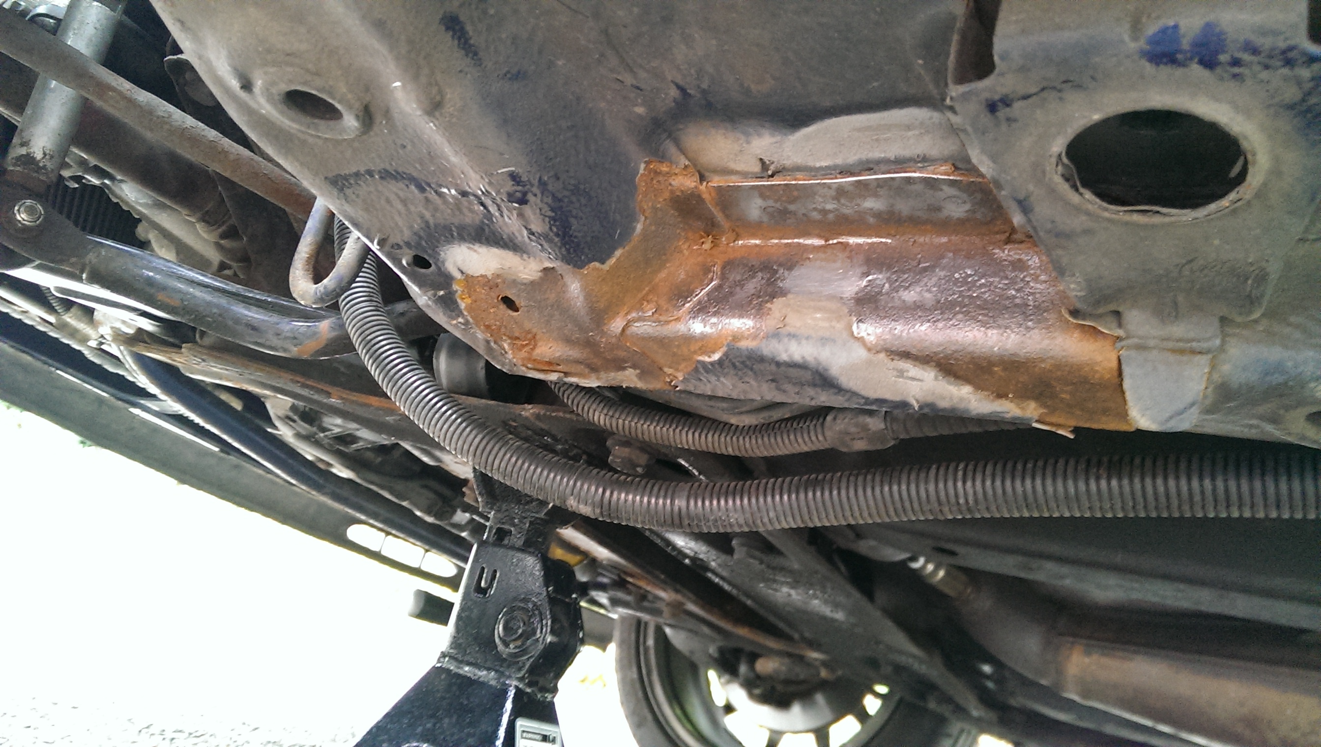

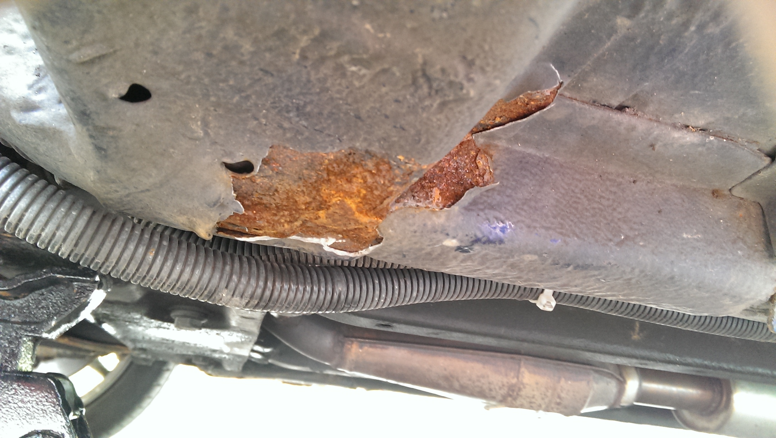

Whilst under the car, i decided to check out the rear subframe mountings. The rust here is what killed my old car and i know this is a common place for the 306 to rust so i was quite nervous about doing so!
Looks bad but thankfully its just surface rust. There is loads of solid metal underneath.
Made a start on cleaning it all up but the drill ran out of battery so calling it a day there. Tomorrow ill continue attacking that, clean up the wheel arches on that side and underseal the whole lot then Thursday, get the car turned around and make a start on the other side!

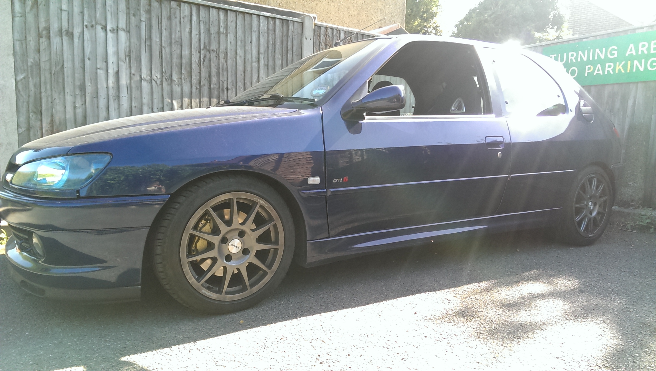

Well car is back on the ground, dentless and rustless Smile
Started yesterday morning in the proper fashion
Then out to the car for some dirty work. Got the first coat of underseal on underneath that car after stripping all the old stuff back (what a bastard of a job that is!)
Also got my sills stripped back and undersealed as they were starting to go a bit on the jacking points.
Next job was to fix the sill trim. I wasnt worried how it looked as it was under the car. Just didnt want water and dirt getting in
All back together, new wing back on (colour match isnt perfect but ill have this blended in hopefully next month) and back on the ground.

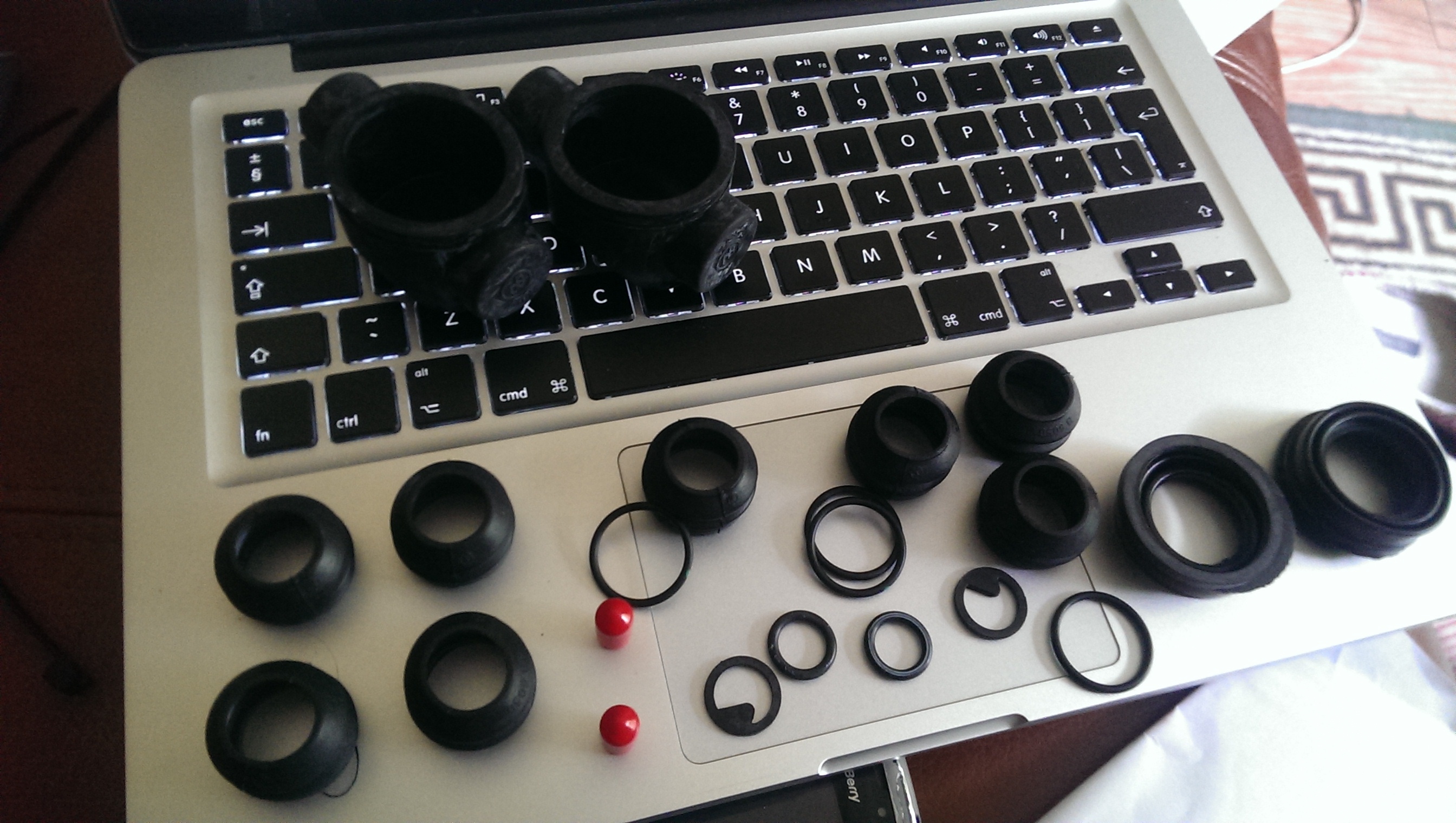

Next job was to rebuild my spare rear callipers as mine are seized on currently. Ordered a rebuild kit from Big red and it was here next day. brilliant service!
They look much better rebuilt, they must be so much easier to work with too.
The are much better. One of the pistons i had seized completely and i just couldnt get it to budge! With some force i finally did. Move nice and free now though Smile

How was the piston seal to fit? When I done the fronts the piston seals were a fecking ballache lol
[Image: SDC10442-1.jpg]
(15-08-2013, 07:34 PM)Jonny b Wrote: How was the piston seal to fit? When I done the fronts the piston seals were a fecking ballache lol
Really easy actually. I spent more time getting the old ones out as i lost my picks Sad.
I rebuilt them all wet with brake fluid which i think helped a lot. The old seals were bone dry and because of this, had started to perish and leave bits of rubber on the piston. Bit of emery cloth and some brake fluid soon sorted that out.

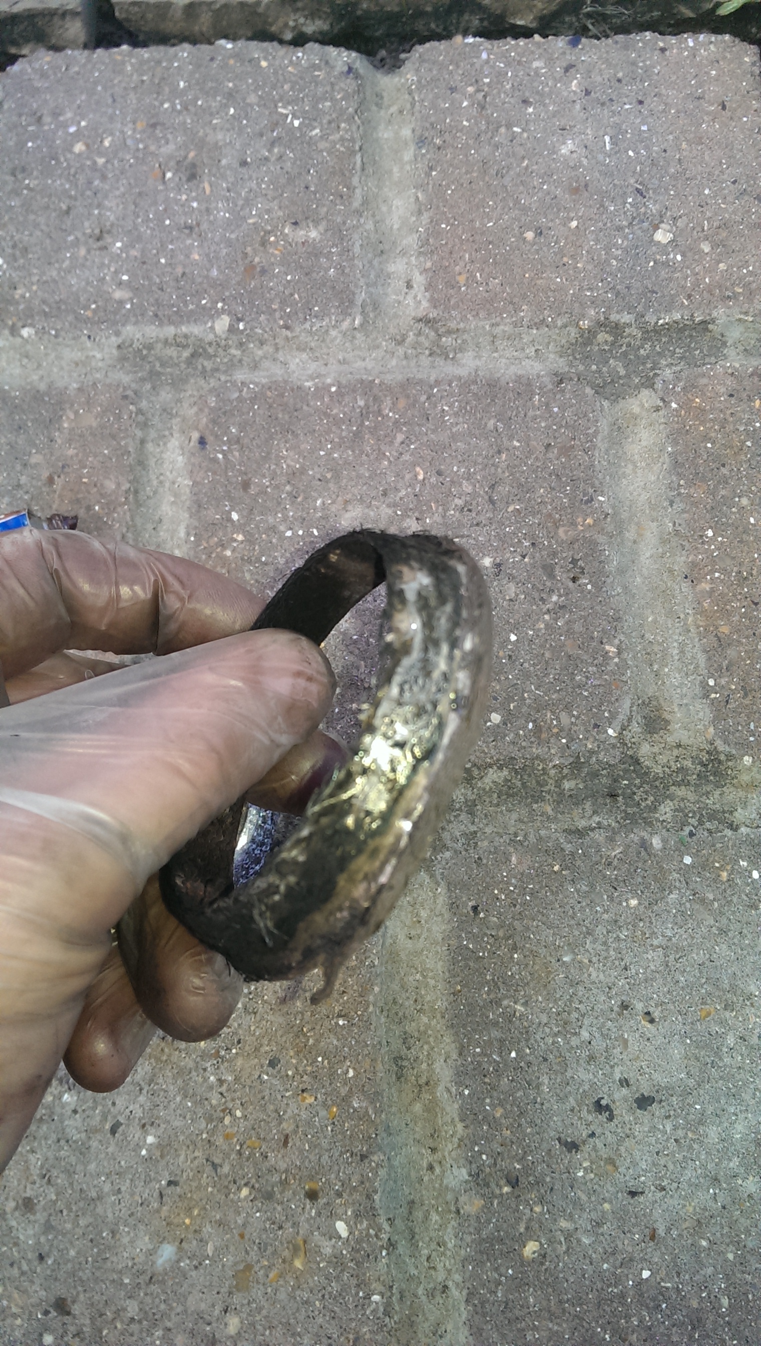

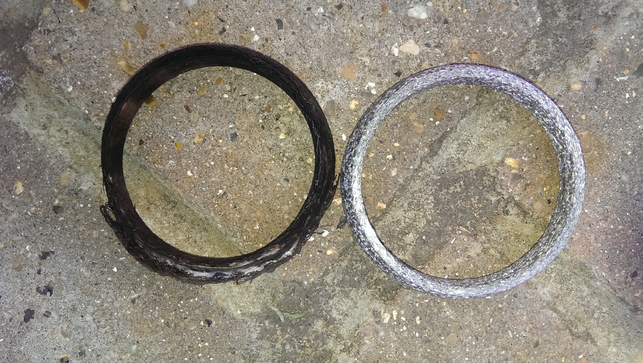

Fitted a new exhaust at the weekend (with thanks to Fooby for being helpful!). It blew like an absolute bitch from the manifold. Considering it was on its original fire seal, i was sure it was that so today i set to replacing it.
Knew it was bad but not that bad Confused. New one was a lady garden to fit on my own. Got the first bolt done up half way, not even any pressure on the spring and the bastard bolt snapped! Got it all together in the end and it now sounds amazing.

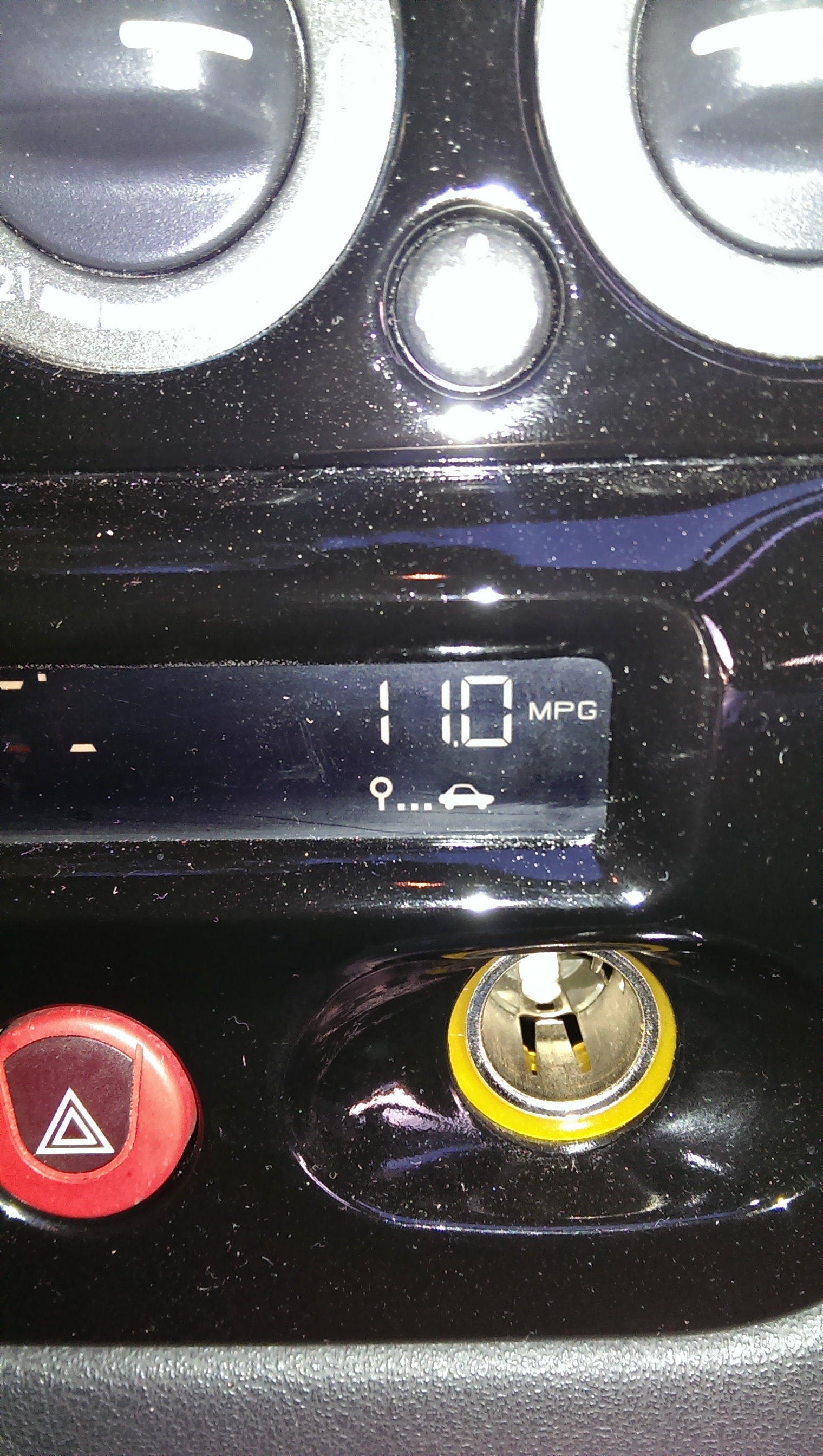

Took it for a bit of a hoon to see how it sounded and to make sure there was no major blows (giggidy). Sign of a good hoon!
It's always satisfying replacing a worn out ring. Presume it's a genuine one? My gsf one was f*cked again in two weeks. Good for pops and bang tho lol
