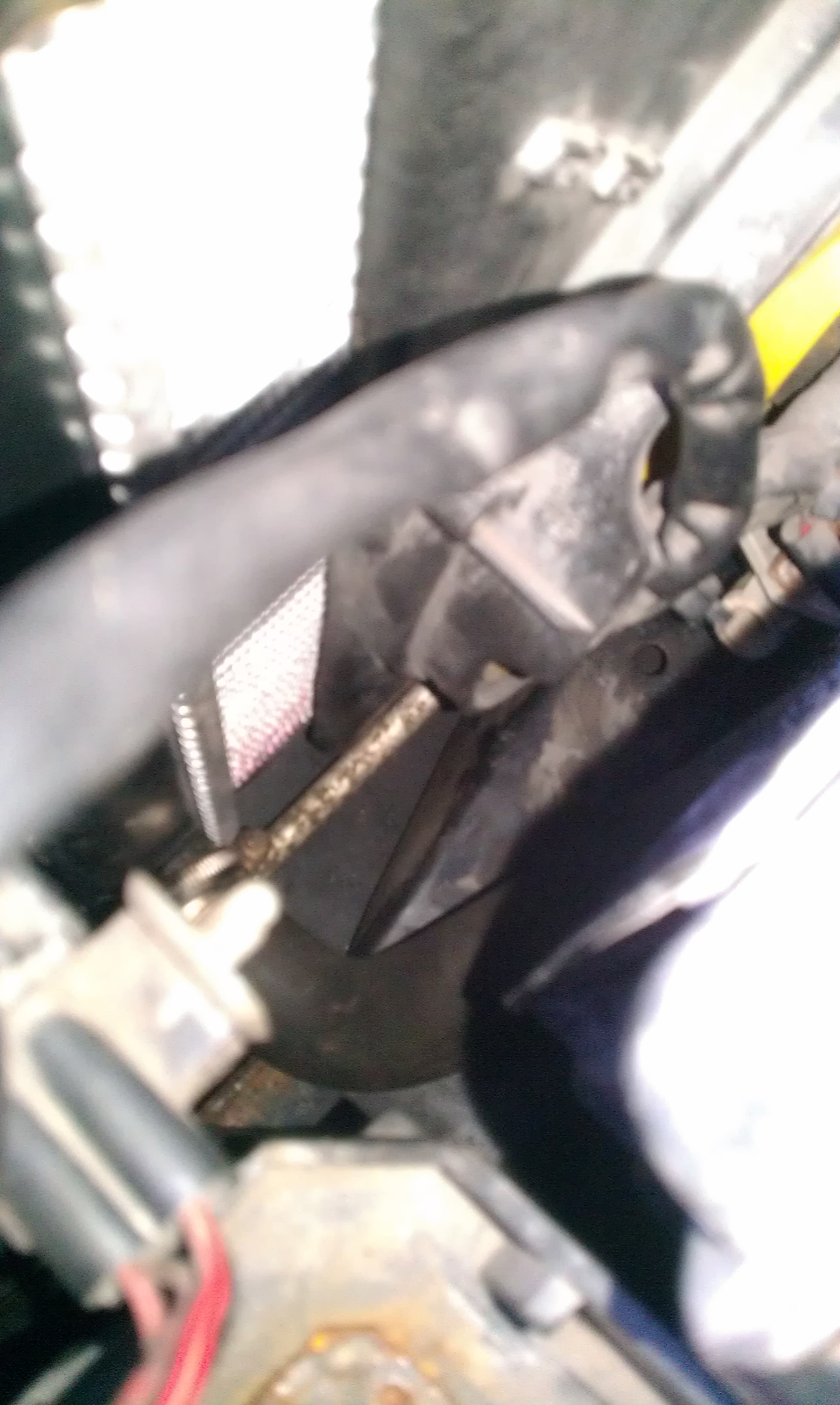

Pics of the old and new "leaking" radiator
I am somewhat confused right now though since the current new one has stopped dripping.
I've checked twice today with the engine going from cold to hot along with rev'ing it to see if that pressured the system but there doesn't seem to be any more coming out. Dad has suggested that the metal may have expanded after the first heating/cooling phase and filled the leaking space up. you can see on the photos the red residue left behind but had a flash light down there to look closer and it just seems all dry now?
[Image: mcetg0.png]
Very odd fella, I would say a new one should never leak- never had in all the new ones I've replaced lol
[Image: siggy1.jpg]
Mmm it has a 2 year warranty so will be keeping my eye on it and the coolant level, just don't want to be sending it back and having the car off the road if it's fixed itself.
