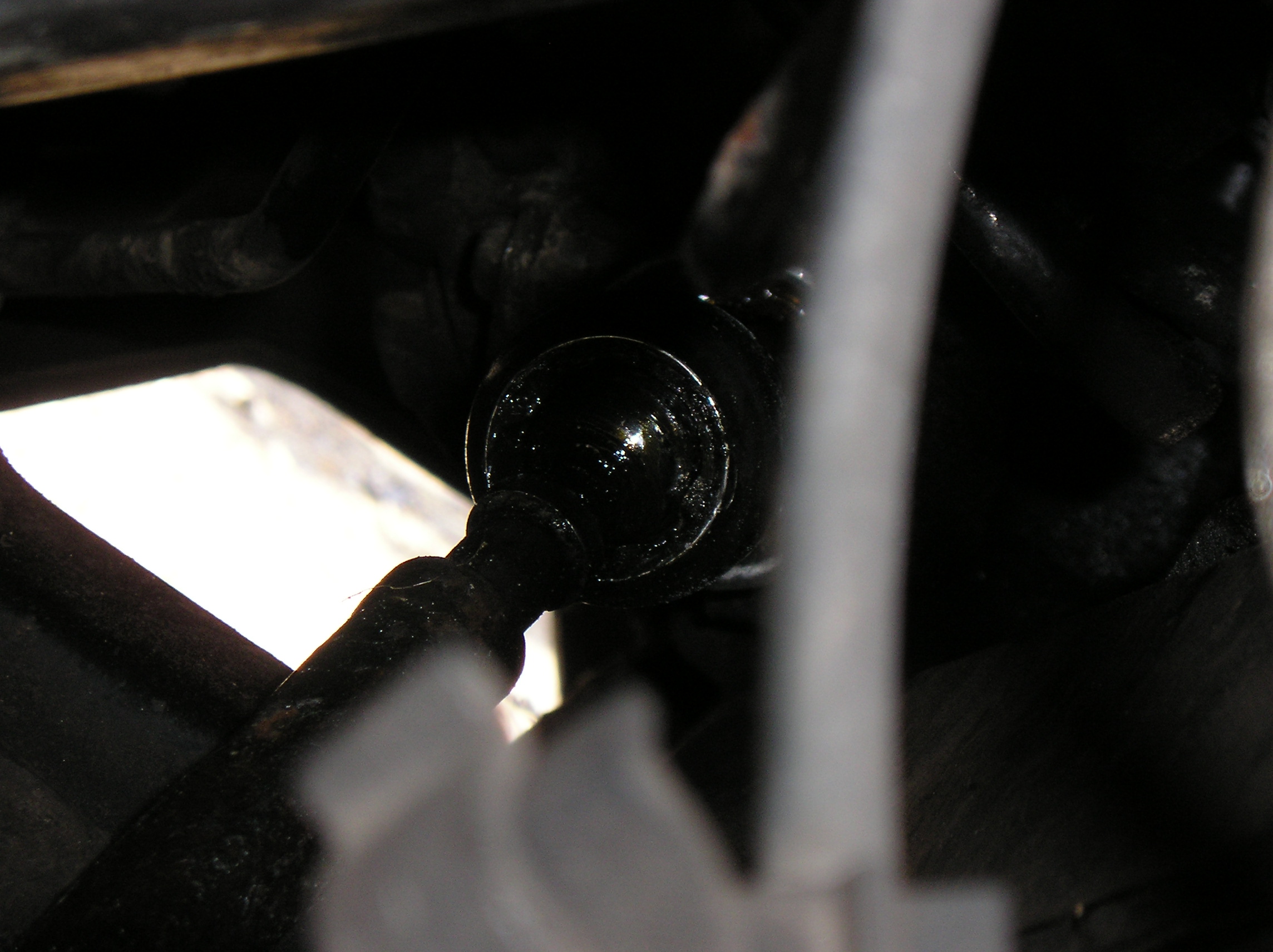

Right, managed to tap it from the side and it has come loose but I can't get it off. It also appears that the boot sits in grooves on the track rod which makes it even harder because I will have to slit the inside side of the boot and I can't even get in there. The gaps in the subframe are too small to move my hands around in. I was thinking of giving up.
have you tried turning the steering full lock to the right??

Right, been outside again to have a look, still can't see anyway of removing the track rod, not sure how to proceed?
its the big round thing that you have to undo, its threaded onto the rack itself. sometimes you can get in with visegrips or even a small pair of stilsons........otherwise there is a special tool that costs upwards of about £40----its like a long tube that slips over the track rod and grips the circular collar to undo it.

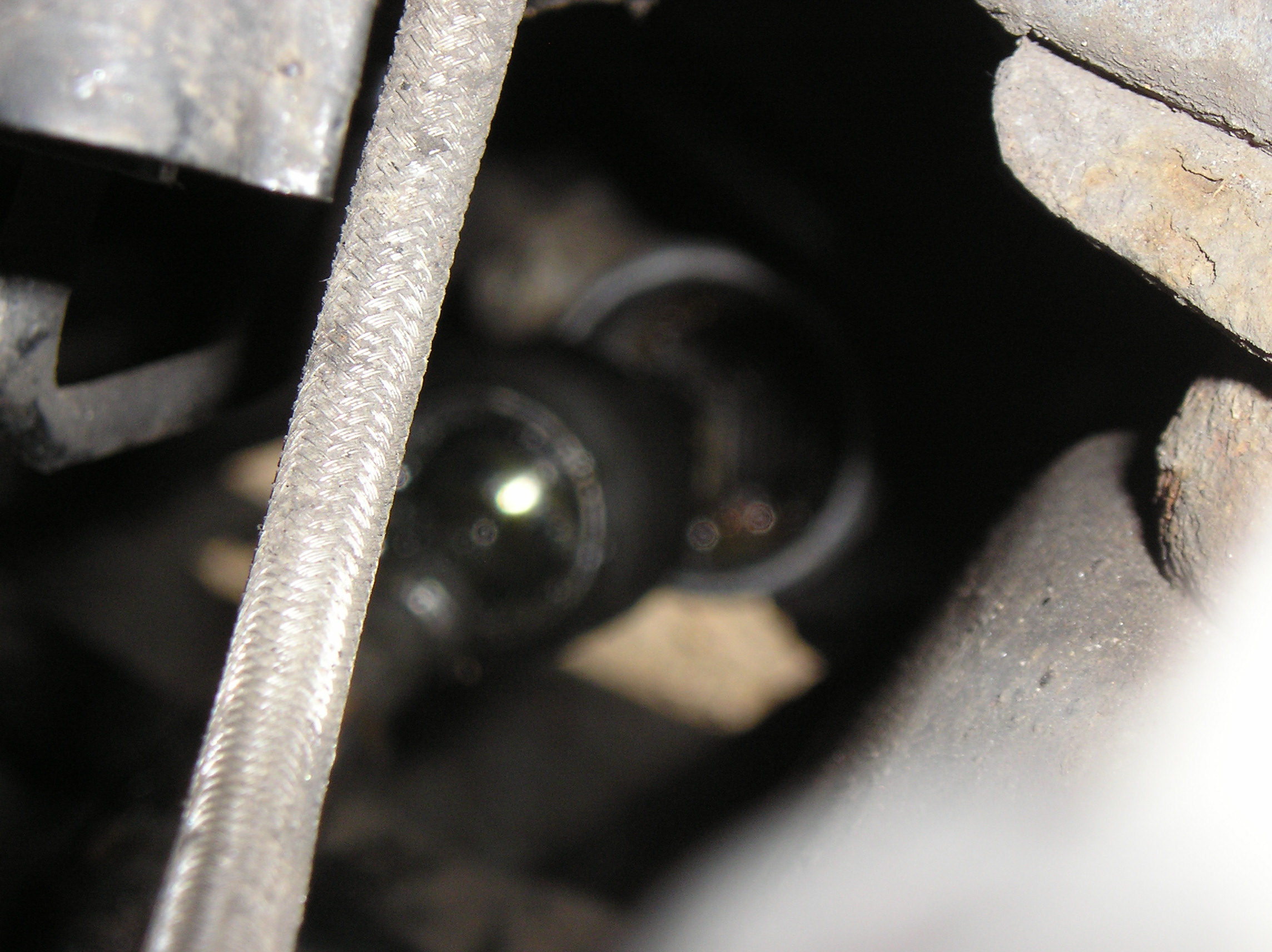

Right, just gone back out, there feels like there is some sort of circlip directly behind the inner ball joint which is rotating freely. Although I can barely get my fingers on it so hell knows how I will be able to get it off/back on again! I'm not sure how to get the screwdriver on there.
if its rotating freely then its free!
now get ya man bags out and get it undone!
But there is no flat surface on the ball joint housing which was what I was referring to the special tool for. Also, my molegrips aren't large enough to go round it. MOT retest is booked for the 23rd but also gotta get on with cleaning up the brakes and rebedding them in and doing the droplink, not to mention the fact that I would prefer not to have to walk to work when work already involves a lot of walking as it is!
you need to get a chisel, as said, on the edge of it, and give it a wack to start it off...you not got some huge water pump like plumbers grips??...be cheaper and more useful to buy too than that expensive tool you will only use once

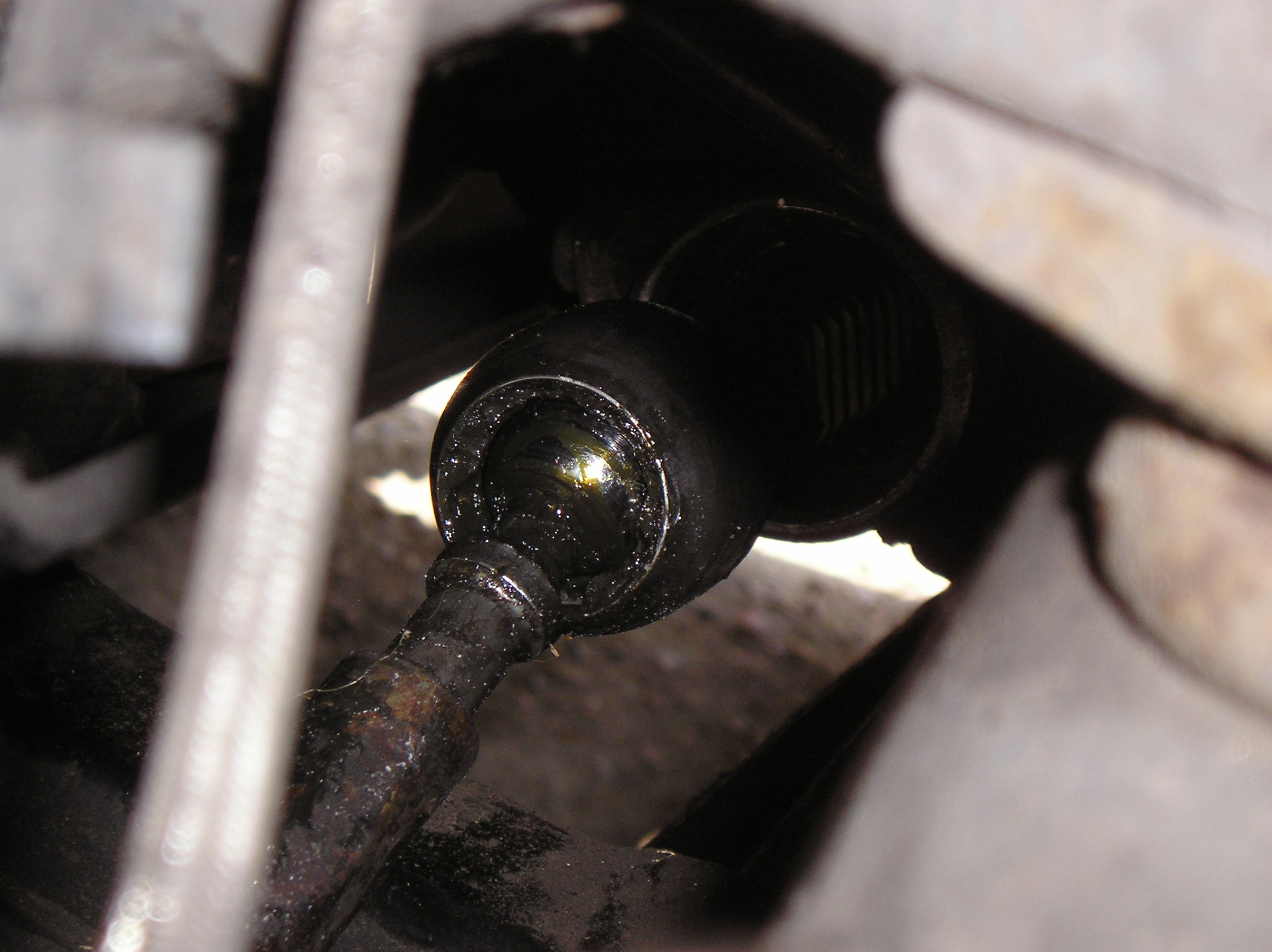

Which edge should I chisel?
This edge?

any edge. inner is better.
those grips with strong forearms will do it...mine are 300mm and have done dozens with ease.
not sure if you have tried it, but have you tried either full lock to see if access is better?

Can't see how I will get to the inner edge with the chisel piggy. My forearms are good from my deadlifting years lol. I have the steering on full lock now, not when that picture was taken. I'll get the grips bought, thanks.

Just one more thing for now, how do I torque it up when I put it back? Or should I just do it "bastard tight" using the pliers with lashings of threadlock?
threadlock isnt needed due to the locking ring!
just make sure you flick/bend the teeth on the locking ring back into shape
then tighten till you cant no more!
