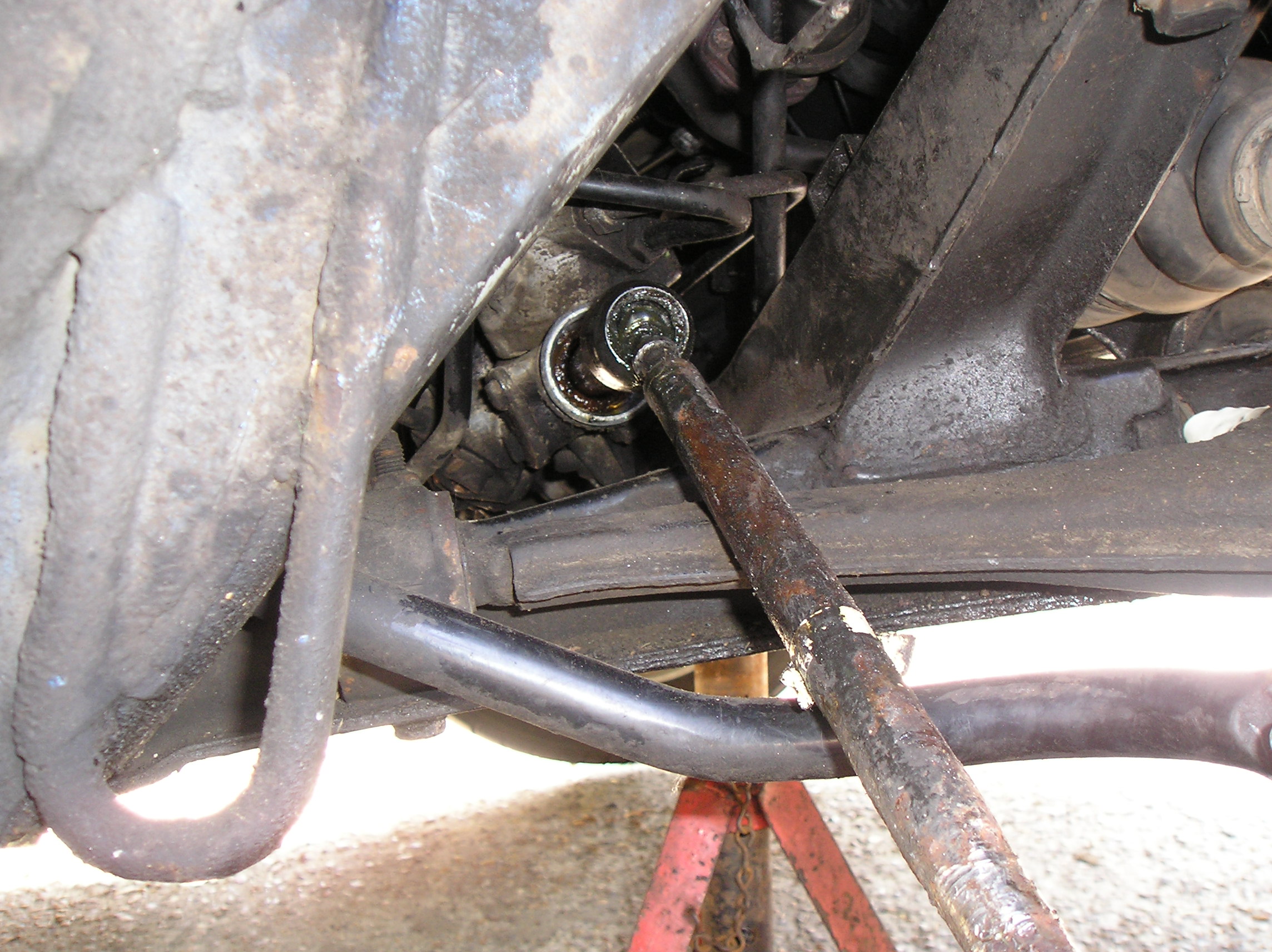

Just a quick question, I'm in a bit of a predicament with my car at the moment. Long story short, went to remove the track rod end but found the nut seized which I was able to loosen and remove, but now the track rod end is seized solid in the track rod. I have tried the following:
Plusgas (well diesel but close enough) overnight, loads
Heat with blowtorch for 5 minutes then try to undo
Heat with blowtorch for 10 minutes then try to undo
Heat with blowtorch for 5 minutes then rapidly cool with water
Held the track rod with molegrips and relentlessly pounded on the track rod end's thread/shank to try to knock it free
Normally I would get on with replacing the whole track rod but for some reason the Haynes gives it a 4 spanner rating? If it is gonna take a whole day then I might wait until I can buy a map gas torch tomorrow which is said to be hotter than propane torches and give that a try but if it's only a couple of hours then I will do it. But I am seriously wondering if it has been welded in for some reason? But there are no signs of that.

RE: Removing whole track rod? - Piggy - 14-07-2013
shouldnt really use heat on steering components thus probably want to renew it anyway.
its not difficult...just tricking and difficult with space.
remove the boot.
use a screwdriver to try and flick out the 'teeth' on the securing ring and then either some hefty grips to undo it or use a good chisel to get it moving then grips after that.

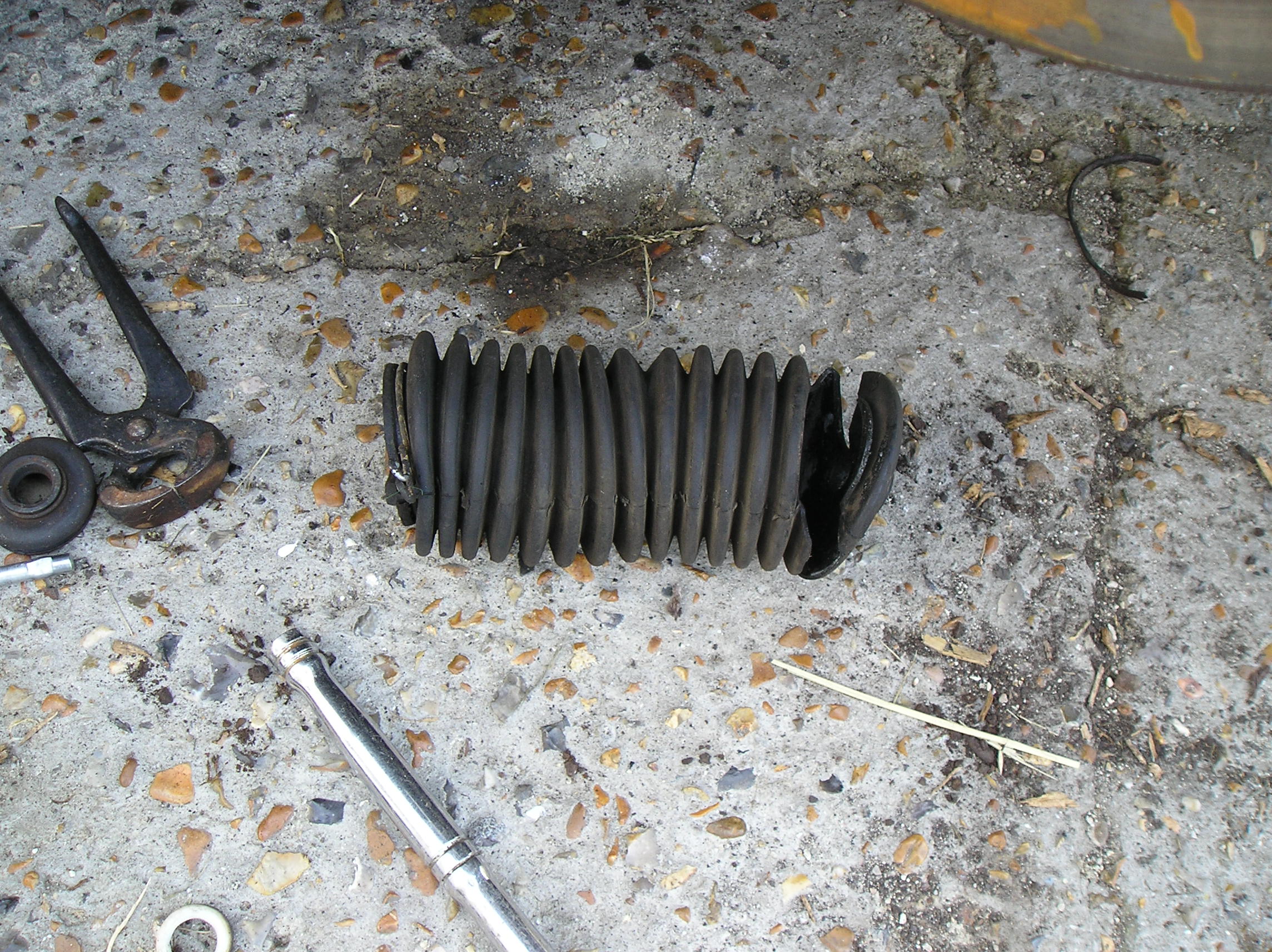

Right got the clip off, boot still won't come off? The Haynes is as much use as a chocolate teapot.
yup it is.
if you are replacing the boot, just cut it off!!!
re:clip...I was referring to clip which locks the inner joint onto rack!
RE: Removing whole track rod? - 306Puggy - 14-07-2013
Just been out, got pliers on the boot and it's still not moving. I think I can feel a metal clip on the other side of it? How the actual f*ck am I meant to access it? There is literally no space? Please don't say going underneath the car. I was NOT planning to go underneath the car this weekend! And I can't anyway because the axle stand is in the way.
slide under from front...two clips hold it, one either end or it would just pop off!
or slide from side...easy enough
Right, managed to tap it from the side and it has come loose but I can't get it off. It also appears that the boot sits in grooves on the track rod which makes it even harder because I will have to slit the inside side of the boot and I can't even get in there. The gaps in the subframe are too small to move my hands around in. I was thinking of giving up.
have you tried turning the steering full lock to the right??
Right, I pulled hard on the dust cover with both hands and it came off. But there doesn't seem to be a nut on the inner ball joint?

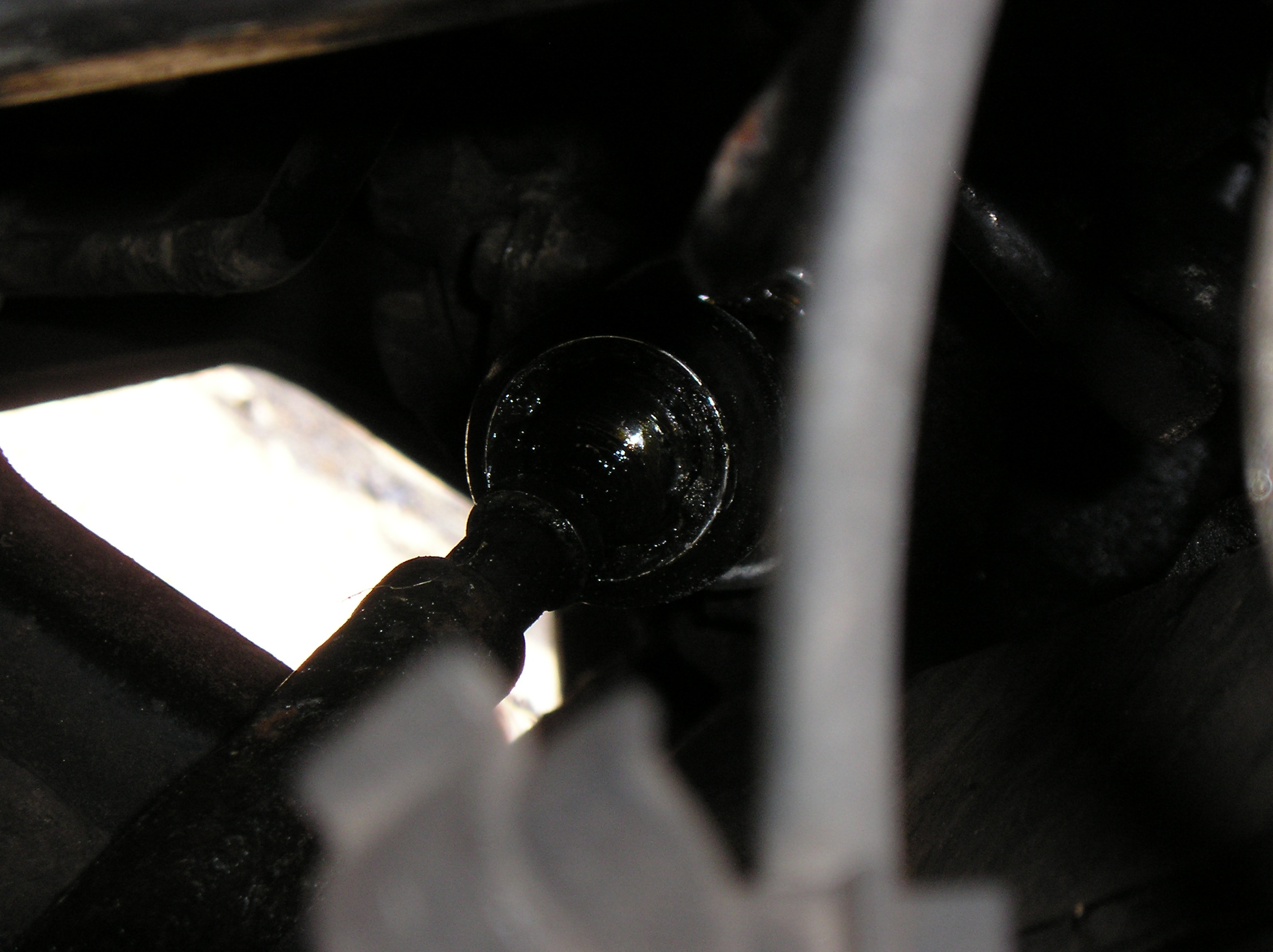

Right, just gone back out, there feels like there is some sort of circlip directly behind the inner ball joint which is rotating freely. Although I can barely get my fingers on it so hell knows how I will be able to get it off/back on again! I'm not sure how to get the screwdriver on there.
if its rotating freely then its free!
now get ya man bags out and get it undone!
But there is no flat surface on the ball joint housing which was what I was referring to the special tool for. Also, my molegrips aren't large enough to go round it. MOT retest is booked for the 23rd but also gotta get on with cleaning up the brakes and rebedding them in and doing the droplink, not to mention the fact that I would prefer not to have to walk to work when work already involves a lot of walking as it is!

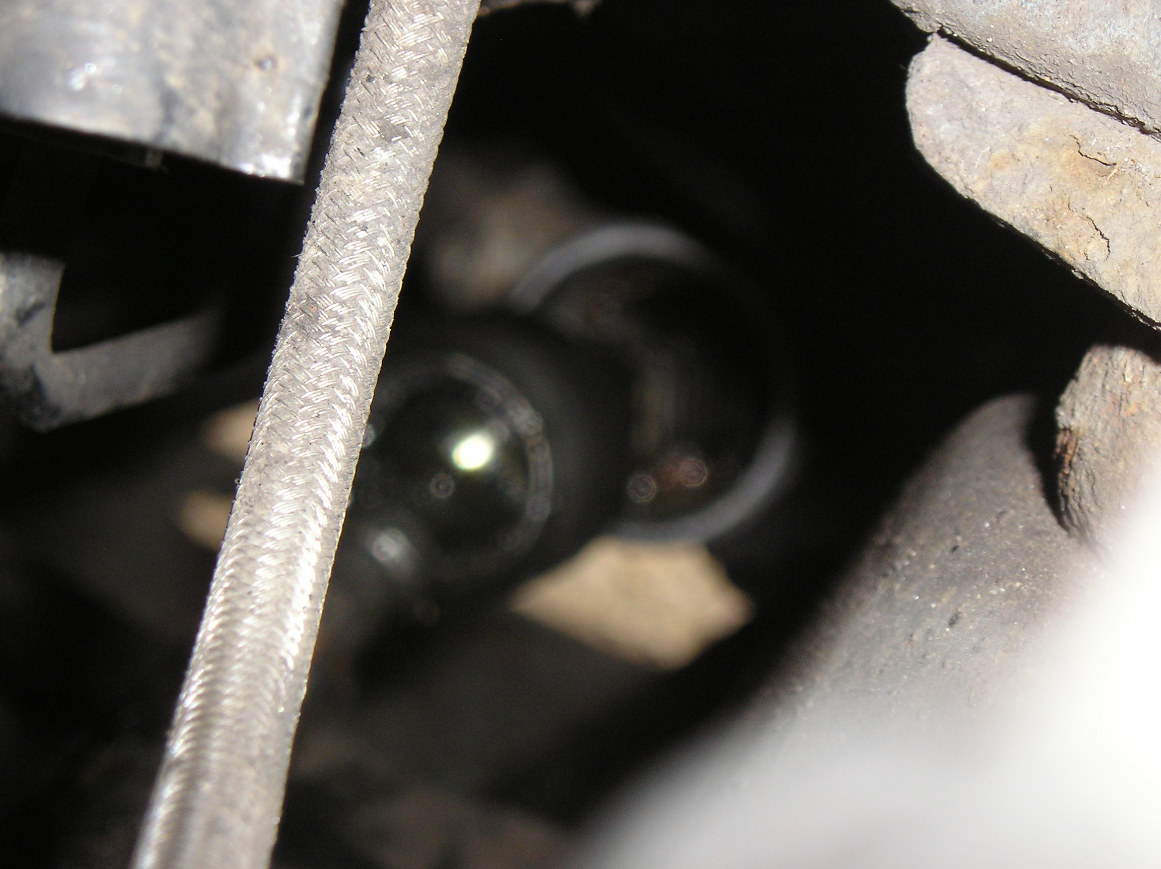

you need to get a chisel, as said, on the edge of it, and give it a wack to start it off...you not got some huge water pump like plumbers grips??...be cheaper and more useful to buy too than that expensive tool you will only use once
These yeah:
http://www.ebay.co.uk/itm/250mm-10-Plumbers-Slim-Jaw-WATERPUMP-Pipe-Wrench-PLIERS-Grips-Water-Pump-NEW-/380567166942?pt=UK_Hand_Tools_Equipment&hash=item589b921fde
Gonna be awkward to get in there but for a £5er it's worth a try.
Which edge should I chisel?
This edge?
[Image: attachment.php?aid=8623]
RE: Removing whole track rod? - Puggie - 14-07-2013
Right mate i had the same problems
could i f*ck get near it to loosen in the end i took the control arm off and it gave me enough space to get some stilsons in there were talking a few mm extra that's all
Very little effort to loosen it if i am honest once you get the right angle wich you can with the arm off. bit of a f*ck on but it took less time than i had already wasted pissing about Censored
any edge. inner is better.
those grips with strong forearms will do it...mine are 300mm and have done dozens with ease.
not sure if you have tried it, but have you tried either full lock to see if access is better?
