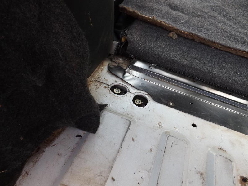

some quick pointers for changing the beam mounts
jack up car support car on the propper jack points to avoid damage
use penetrating oil on all bolts your going to slacken/remove
undo bolts while axle is mounted firm but dont remove bolts
slacken but dont remove
slacken but dont remove oposite side
remove top fixing bolts slowly lower side on jack caution watch brake lines!!
part remove lower bolt, fully remove top bolt
mount should wiggle out by tipping to the rear of the car
remove mount note offset
admire the used mounts
refit in the oposite manner
near side needs bottom damper bolt removing to let the arm swing lower to let bottom mouunt bolt out
only part remove lower bolt same as other side remove top bolt lower beam on jack caution watch brake lines!
refit new mount
admire your handy work
