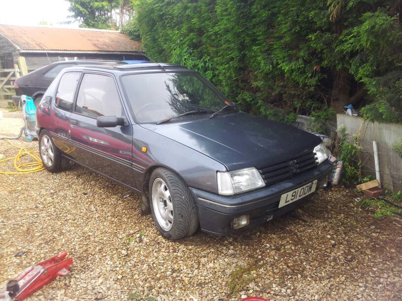

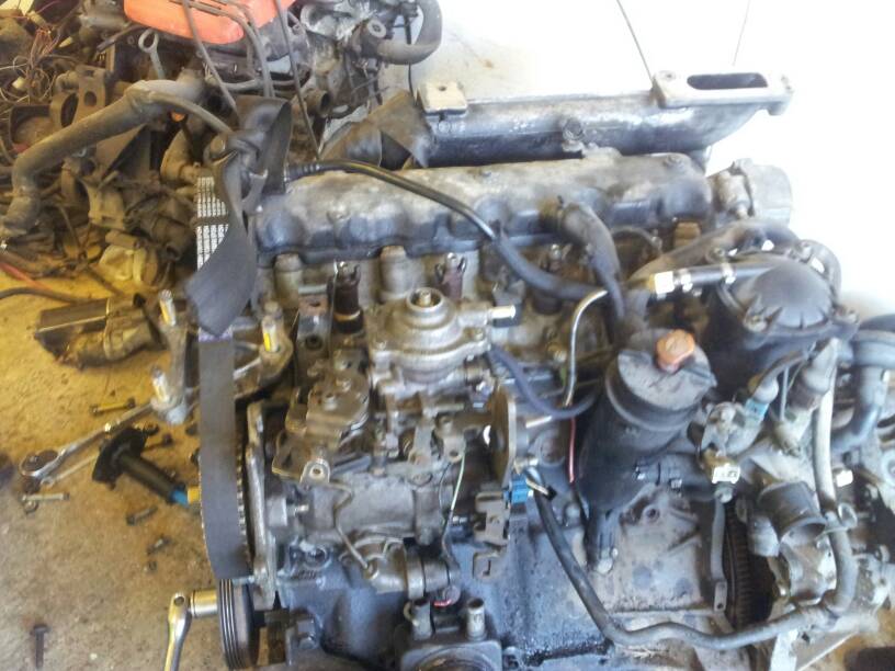

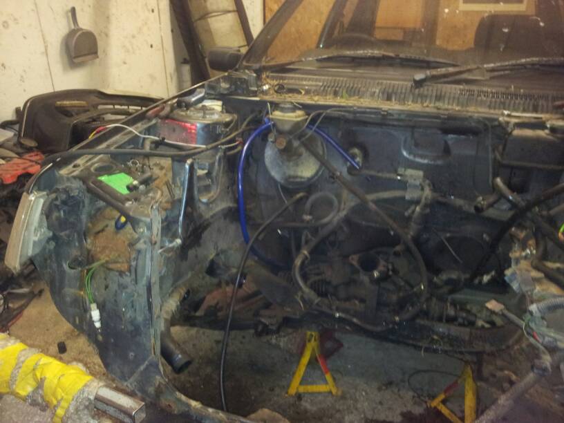

Right bit of a big update I have now got the engine out of the 205 heres a pic of how we started this morning
A few hours later the engine bay looked like this

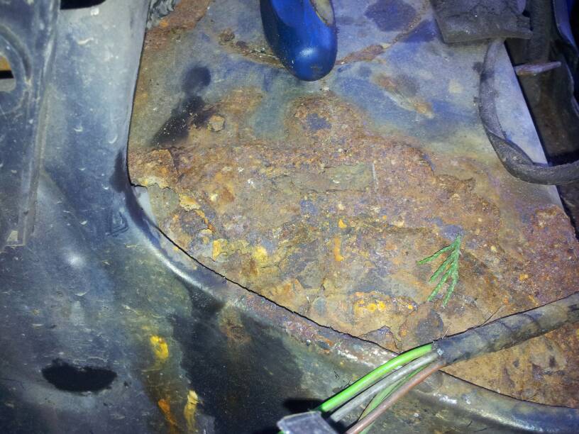

The car needs a bit of welding behind the drivers headlight just a little bit crispy.
So then I took the bosch pump off the 1.8 and then put it on the 1.9 with a new cambelt kit
Look how high it is sitting atm need to get the coilys on.
I also have put a new valeo clutch in and the engine is now in the car for a trial fit with the td04 the actuator does hit the steering UJ as someone has mentioned so will have to come back out and look at that but all in all not a bad day would of got more pics but my phone died

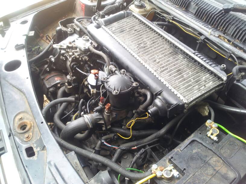

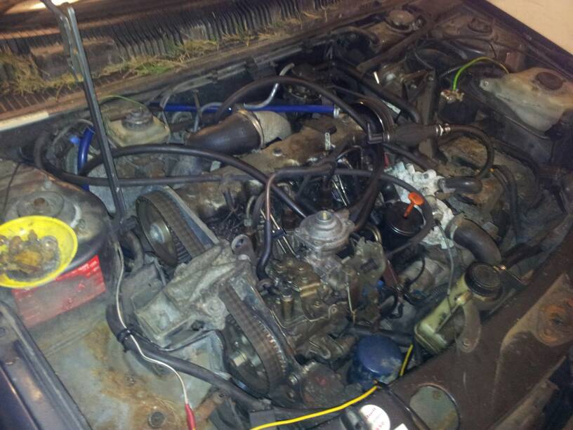

Bit of an update on this I have now got the engine in
I have fired it up started pretty much first time with no issues realy I have also sorted the clutch cable as I am running a 1.9 box I have got my coilovers, droplinks and track rod ends on aswell
I have had a quick spin in it and it dosent seem to have any go when it should be coming on boost it was like that with the 1.8 with the bosch pump so I am certain it is the pump thats causing this can anyone give me any ideas what this could be?

what clutch cable did you use,having problems with my friends one,not sure which cable to use

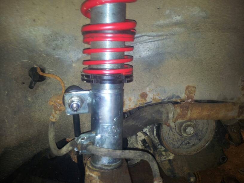

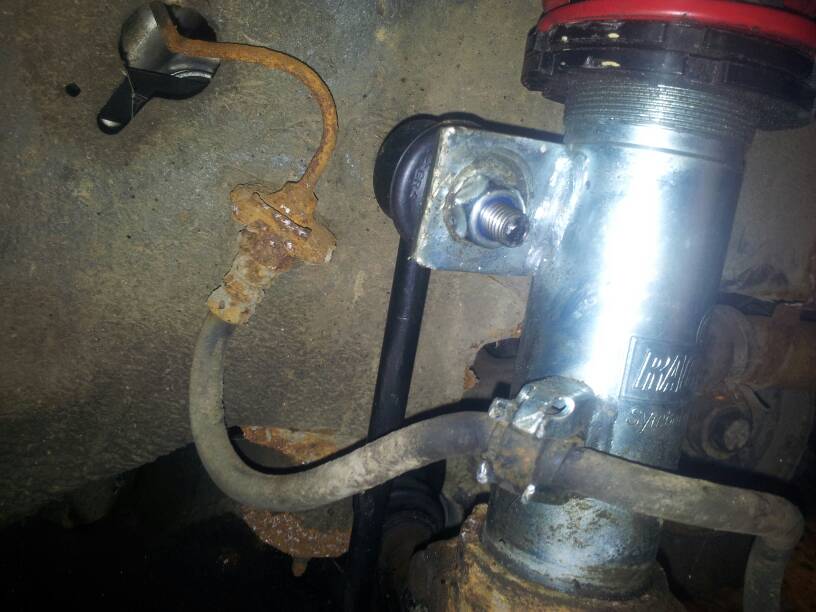

i'm right in thinking the coilies for the 205 are the same fitment as the 306 coilies (except the brak line holder ofcourse)

(24-04-2013, 10:47 AM)pugtk Wrote: what clutch cable did you use,having problems with my friends one,not sure which cable to use
I used parts off of a 306 cable and modified to fit it ill see if I csn get a pic fir ya if you want
(24-04-2013, 11:04 AM)ginge191 Wrote: i'm right in thinking the coilies for the 205 are the same fitment as the 306 coilies (except the brak line holder ofcourse)
Im not to sure tbh they do look the same though and my brake lines fit in the holder aswell

The clutch cable from a 205 Gti is what I used. I did have a 306 one fitted for a while but it was too long

I'm using a 306DT cable - is slightly long, but cable tied along the sub frame as it likes to dangle - and use the clutch mount from the 205 for the pull resistance.

Does anyone have any idea why the car just lags when it should come on boost? It was like it on the 1.8 engine and I had the bosch pump on that aswell.

boost leak,have you a gauge on?

What pump you running?
What LDA / pump mods you running?
What boost aer you getting, if any?

I have got a Bosch pump gov modded an a lda pin grind done by dan!
Its definitely not a boost leak lol
Not sure what boost its running as i haven't connected it yet but it doesn't even rev enough to even start boosting (it kinda feels like a rev limiter) I have a feeling its a LDA issue because it seems like its not getting fuel when it should come on boost, it doesn't help not having a rev counter either lol

I have had a play today and I connected my boost gauge up and is only boosting 8-10 psi on the boost gauge. I have played around with the fueling and I habent realy achieved anything just more smoke lol. I have checked for boost leaks and I cant find one so im pretty sure its not that. Would advancing the timming make any difference?

2/3rds to 3/4s advanced is ideal. Sounds like you do have a have boost leak if your only boosting like that :/ Otherwise somethings f*cked.

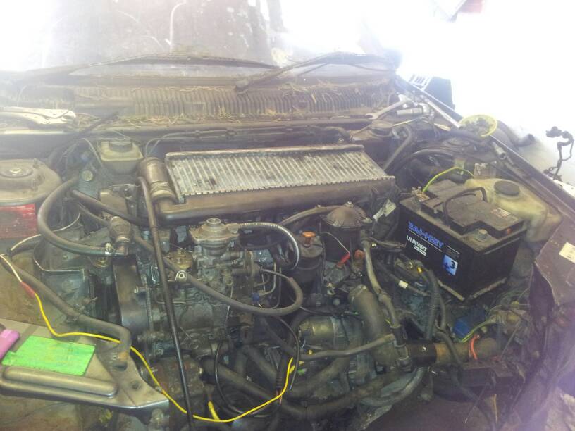

Right spent a few days on this and have got a little bit more done. I got hold of a new pump and put that on and has solved all the boost issues I was having so boosts well now  . Have put the loweres axle on from the 205 cti I had all new axle bushes, brake lines and hoses all the way through and also some 306 247mm calipers and discs I had kicking about atleast there vented lol.
Also I was having issues with gear linkages I kept the 306 selecter on the gearbox when I put the engine in what a bastard it is to get out in the bay lol.

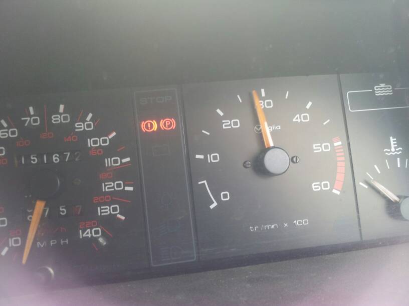

I tested the rev counter sensor today and found out that didnt work so I got a replacement and wired that up and now I have a working rev counter
Gonna put the front end on tomorrow and start to tidy things up in the engine bay and put the cam belt cover on then all I have to do is make up a new exhaust and I think its nearly there for an mot once I get some new tures or wheels lol

Jealous of the rev counter! Also with my TD04 had to "modify" the arm that links to the gear linkages as it hit the downpipe.
They're different with the drop links too iirc
