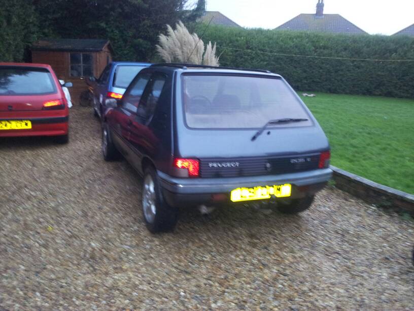

Its about time i put up a project thread of my 205 bought it for £250 no tax or mot.
here she is
its not in bad condition no major rust or laquer peel looks like a good base start although it does need a patch welding in in the boot.

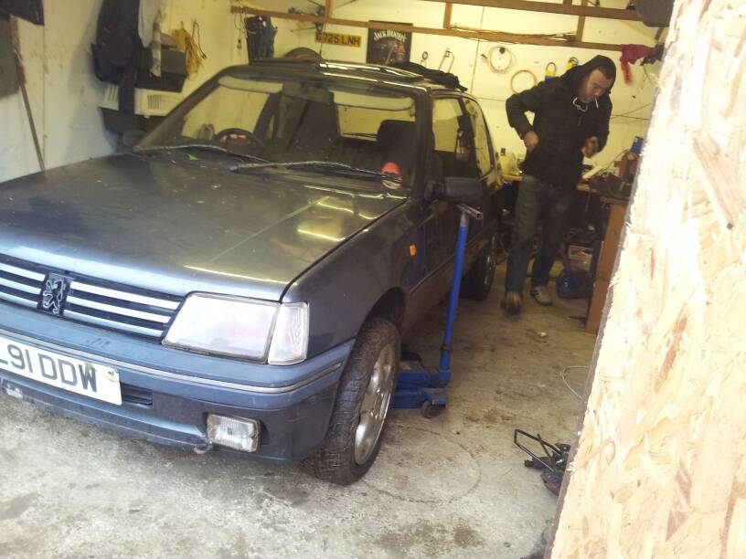

I bought this little beauty the other day

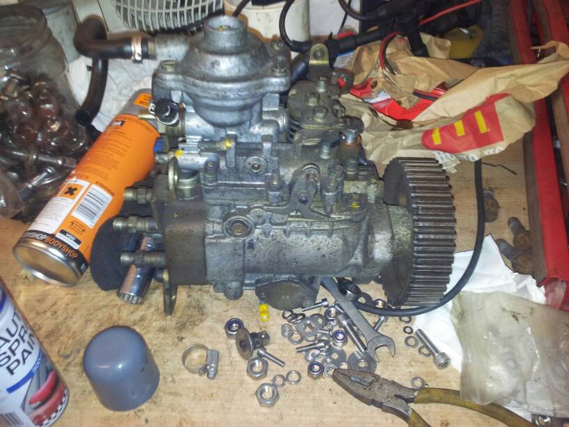

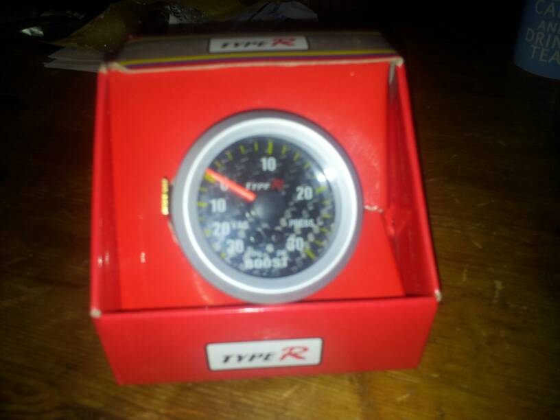

Then i took a little trip down o see dan and get the gov mod and lda grind on the pump. Then i thought that if i am going to tune this it would be a good idea to buy a boost guage

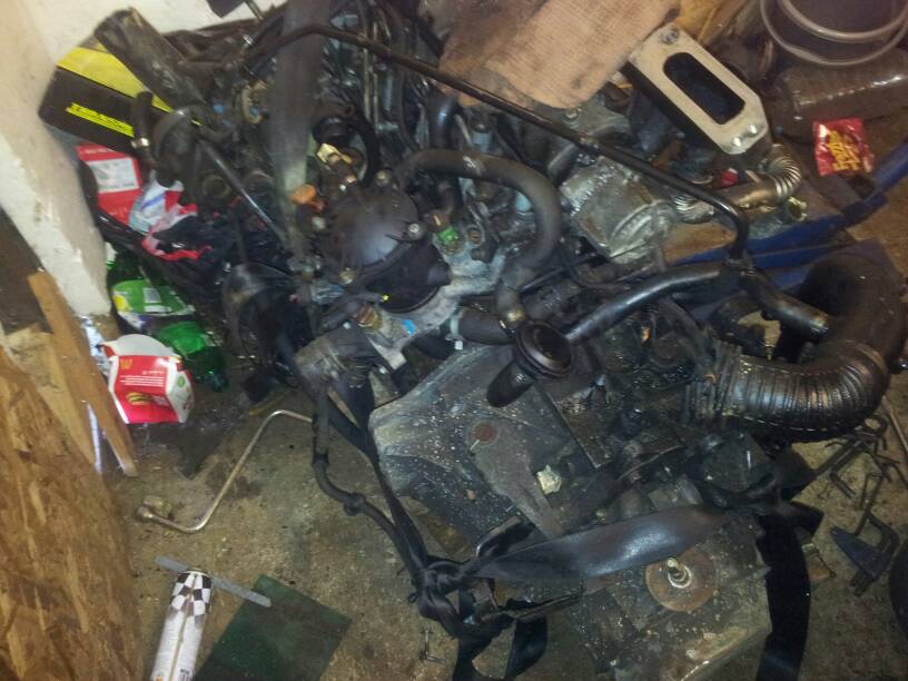

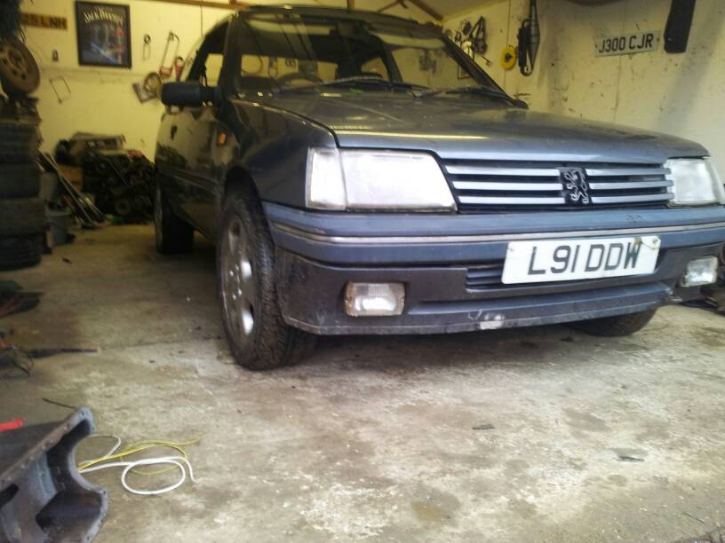

I have bought a 1.9 engine and gearbox and that should be here in the next few days will get some pics when it gets here i also have some coilovers,droplinks and track rod ends to go on when i put the 1.9 in.

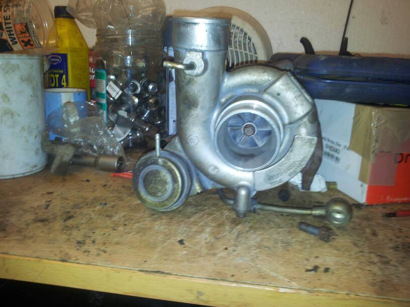

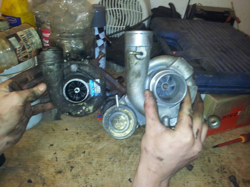

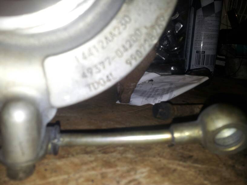

Recieved the td04 today £41 posted from ebay Big Grin aparently only done 33k aswell has no play atall.
pic of the engine aswell

does anyone know if i can use the turbo maniold off of the 1.8 because i have 2 other manifolds but they both have egr valves on and it looks rather difficult to mount the td04 onto.
RE: 205 D-turbo soon to be 1.9 - ginge191 - 05-02-2013
You're going to need to adapt the turbo to fit, no matter what; you won't be able to bolt the turbo straight on to any manifold; either manifold would suffice but i'd continue with the 1.9 manifold as it's already a fit to the block.

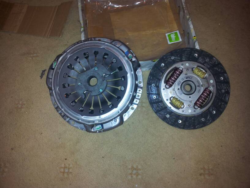

i got a new clutch through the post the other day

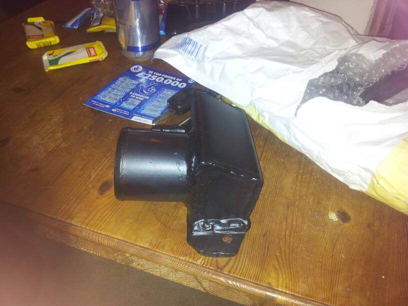

also recieved a adaptor for a fmic

I bought the adapter off a member on here paid £35 posted. I got the engine from eBay has 85k looks real tidy engine got it for £125 posted, I have a intercooler in the shed just need to get the pipes.
