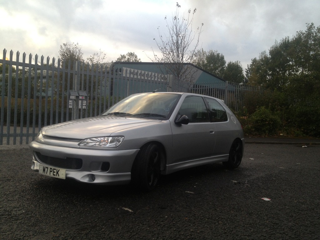

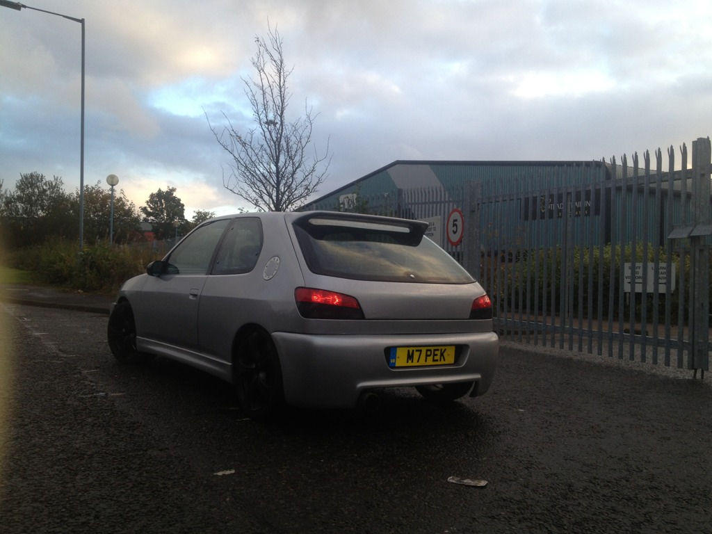

And here it is, my pug reborn

Looks very clean, and I like it without the side strips. Not keen on the front bumper at all but I quite like the back one. Good restoration anyway!

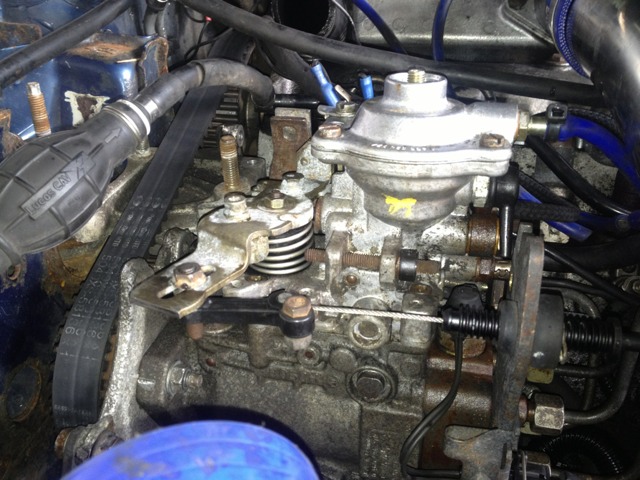

well got around to removing the pump again today, and it looks like it was my fault too, must of over tightened the throttle arm and its eaten through the washer on the bottom and eat halfway through gov cradle, and all the little bits of metal gone into the pump and damaged the cam plate and blocked the filter in the 12mm head, i will add a pic later,
so ive cleaned it all up, rebuilt it back up with all the levers, gov cradle and the top housing of the pump also left the standard lda pin in as its alot more agressive from the 12mm pump, now it seems to run fine but i havent drove it yet as i may as well do the brake master cylinder while the engine mount is off tomorrow.

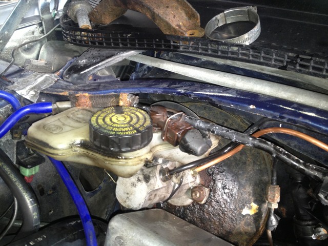

Today got the gti 6 master cylinder fitted

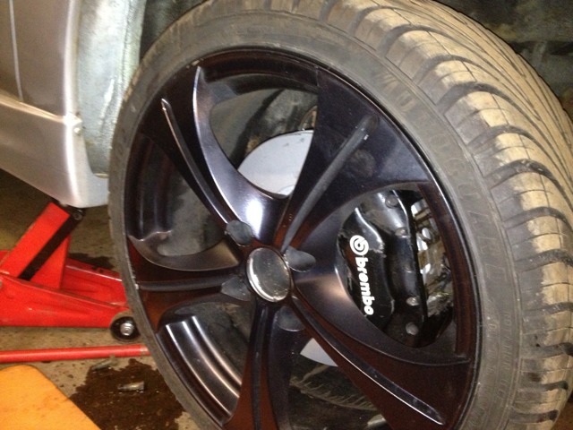

Started to fit 406 brembos,
The discs are massive compared to the standard dturbo discs.

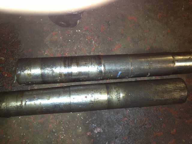

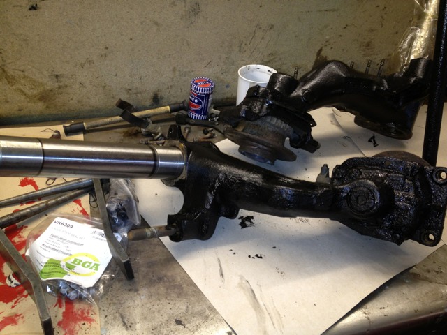

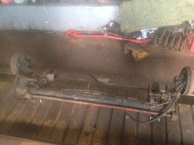

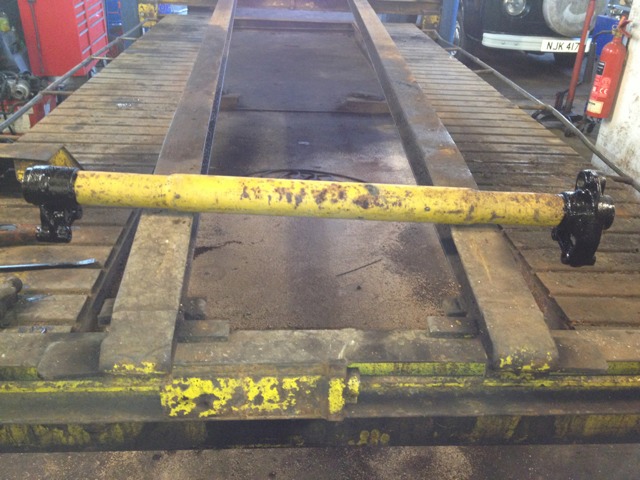

Well got hold of an Hdi rear axle cheap but it did have worn bearings, so it's getting a full refurb:
Old axle stubs
New axle subs fitted and painted arms
Started to paint beam
New bearings bed seals fitted
Will build axle on the car as I find it easier, also have to set height,

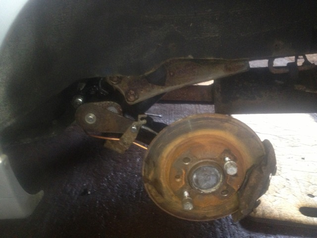

Well today's job was to remove old axle, and start to build new one on the car
Old axle removed
Axle less
Doing my maths trying to do the job perfect
Axle complete,
Well turns out my os caliper is sized, so I've order 2 new calipers with the 32mm piston,
