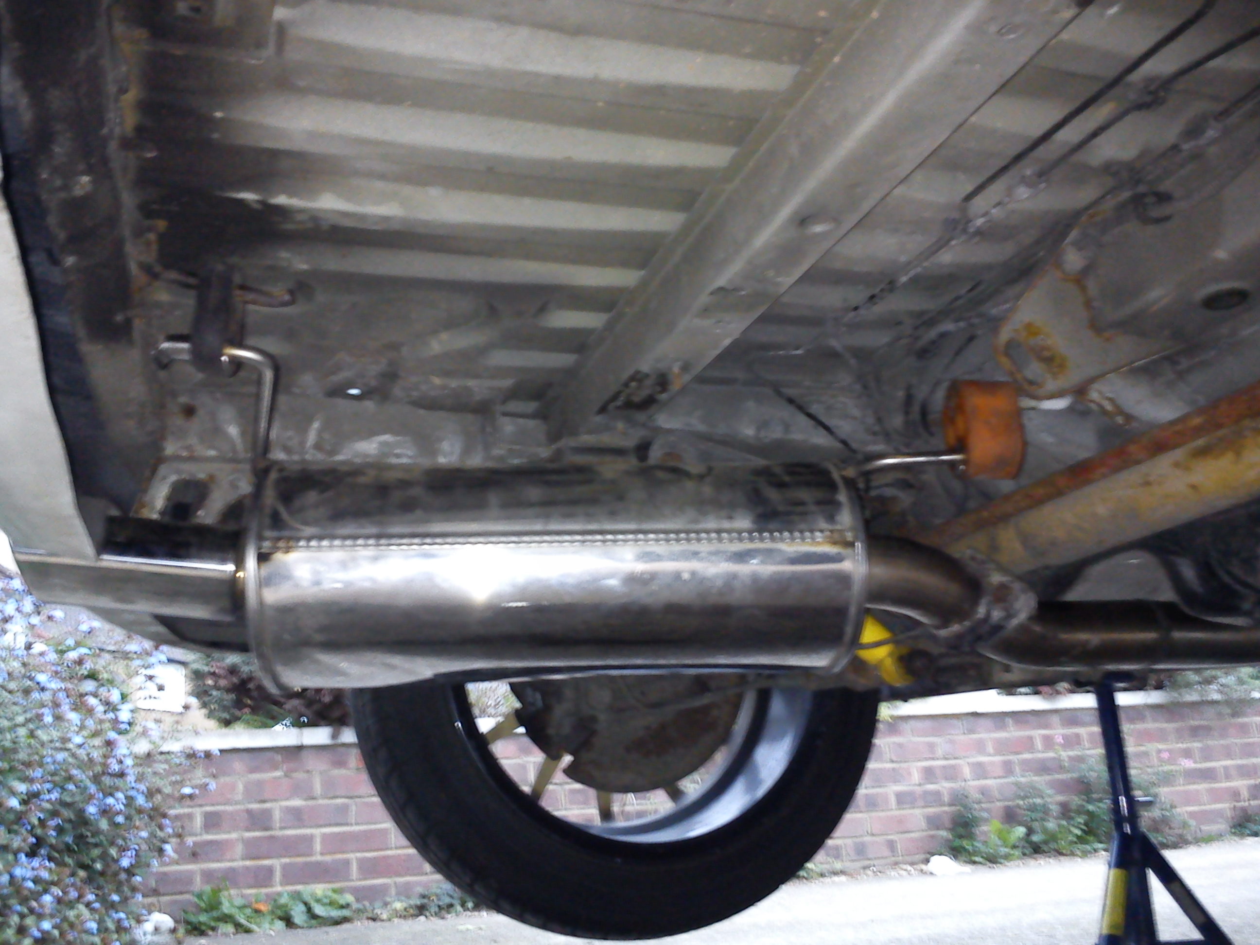

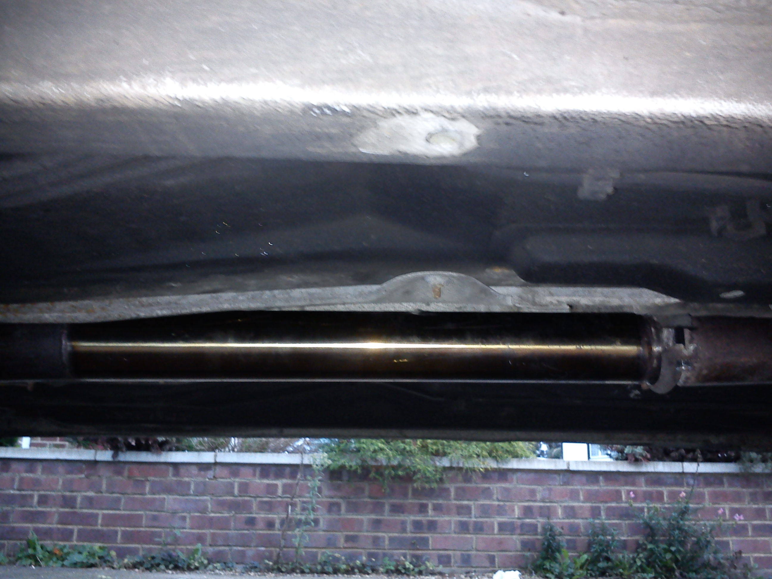

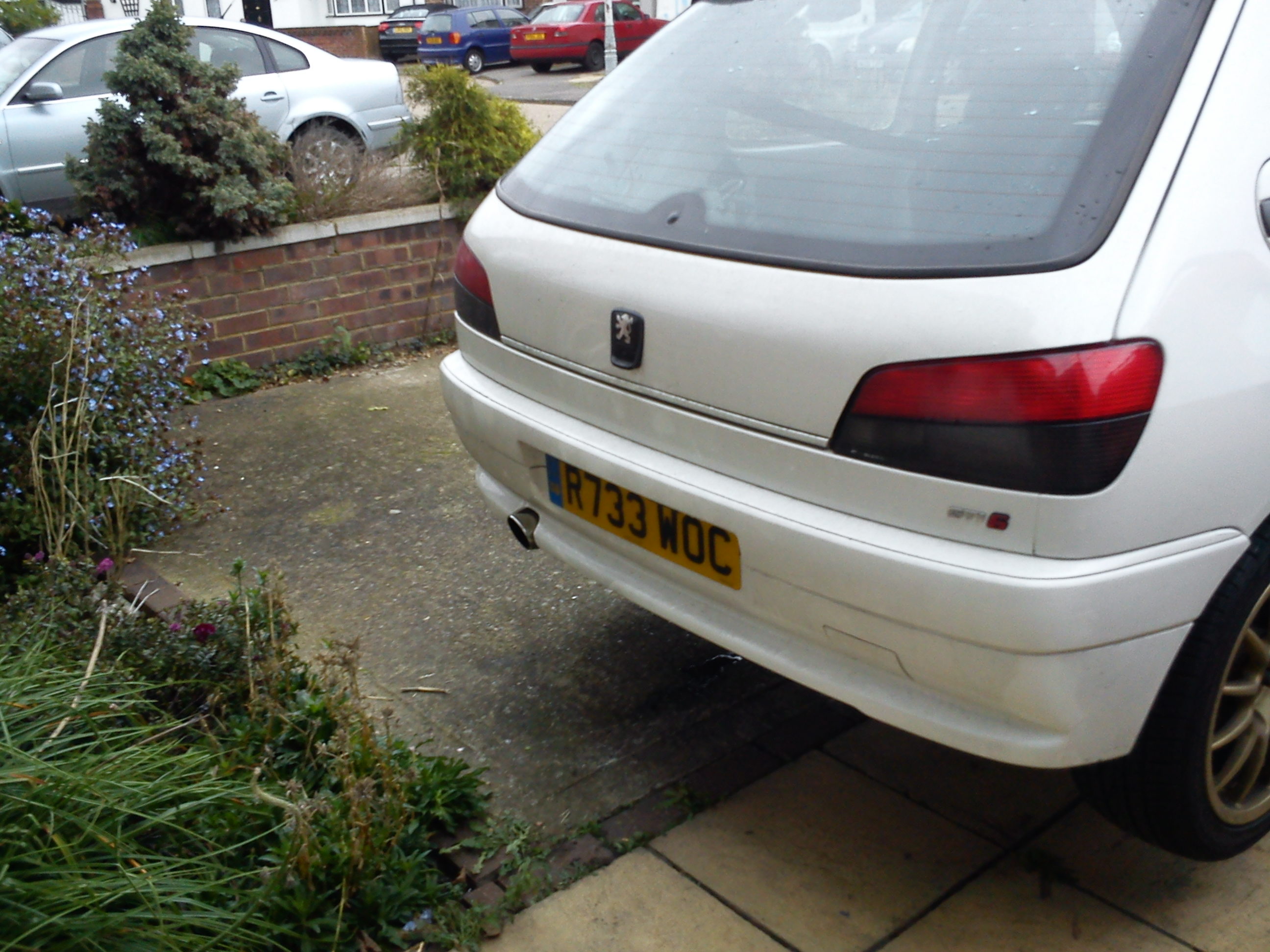

Got my new Bosch Lamdba fitted and my Blue Flame exhaust which was a right pain in the arse to fit however I now have no cat and no mid box, proper straight through till the back box.

Bet she's loud now! Smile
That exhaust looks mint, almost OEM...! Pricey??

(26-10-2012, 05:09 PM)Alee83 Wrote: Bet she's loud now! Smile
Not driven it yet, im hoping not terrible as my old mid box was ruined, Id blown several large cracks in the old mid box and this is why it sounded like it was blowing. Also the new single box is the same size as the old mid and back box put together.
I really like the look. It was £60 2nd hand off Scott.
From me via Vaughan via Curt Wink
Have you found Blue Flame stamped on it anywhere then? Or just going off Ed's theory? As I couldn't find any plates/stamps anywhere... For the record I cut the centre section out and had the straight bit welded in. Also I don't understand how people are having issues fitting it... It was the best fitting exhaust I've ever had...

(26-10-2012, 06:16 PM)Curt Wrote: Have you found Blue Flame stamped on it anywhere then? Or just going off Ed's theory? As I couldn't find any plates/stamps anywhere... For the record I cut the centre section out and had the straight bit welded in. Also I don't understand how people are having issues fitting it... It was the best fitting exhaust I've ever had...
It's pretty offensive though Smile
Going off Eds theory. I actually dont think its that loud, its annoyingly raspy and almost moped like which is f*cking annoying but on balance its a cleaner sound not having 4 inch cracks in the mid section. Below 3k on light throttle its definitely quieter especially reversing onto my driveway which will hopefully stop me annoying the neighbors, well, till the bodies go on anyway
