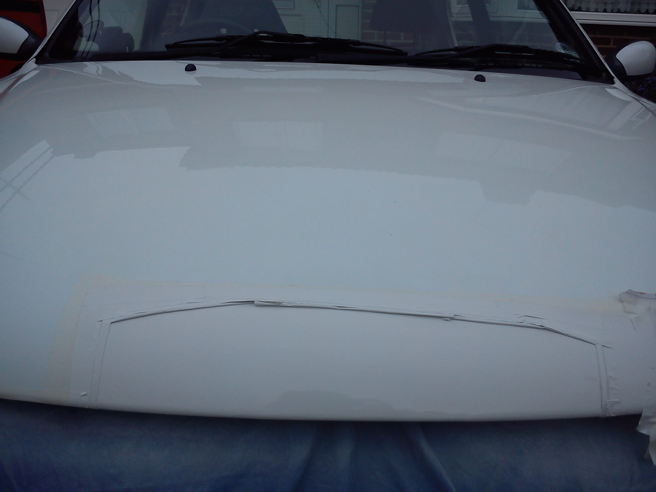

So washed the car today, decided after playing with some black tape (that wouldnt stick very well) that im gonna paint a 1" strip pf the rear window edges to make them look more OEM.
Also over the last few days smoothed and painted my bonnet.
I cut the backing to the badge off then epoxyed in some bits of ally strip and box section so that I didnt need too much fiberglass. I then filled with fiberglass till just below the level of the bodywork and packed it in front and back so I only need a thin skim of filler
Then fillered, sanded, fillered, sanded, fillered, sanded, fillered, sanded and wet and dryed it to shape.
Then about 8 coats of primer and it was wet and dryed back and re masked then about 6 or 7 layers of top coat and thats how we stand.
The paint match is terrible, the paint i have is ph2 bianca and was a great match on my door handles but its miles out on the bonnet that is lighter and whiter being a ph3 item.
This picture dosent show how bad it is.
Anyway heres how she stands, need to finish repairing my fiberglass grille and paint it.
Oh and note the GTi badges have fallen off the sides cos i didnt like them without the 6s
Just need to wait for it to harden and its a week till im next off so then i'll go over it with the rubbing compound and try my best to blend it in. (dosent look too bad from a distance though)

Looks good, will look so much better with black around the windows.
Gunna be nose heavy....
Although you can actually see te difference in paint from the whole bonnet compared to the wing. But only of you look hard lol
White seems to be a hard colour to match, 205's use different shades of white under the same name which is a pain.

Yeah it is a little but buying a new badge when im eventually gonna have a smoothed lightweight fiberglass bonnet when ive got the money to go with the fiberglass grille thats in my garage. So its a temporary measure.
Cheers for the compliment though mate.
(09-10-2012, 06:02 PM)Matt Wrote: Gunna be nose heavy....
Yeah the bonnet is a terrible match cos its ph3 bianca not ph2. and yes nose heavy mate, esp when i get the saxo pump on.

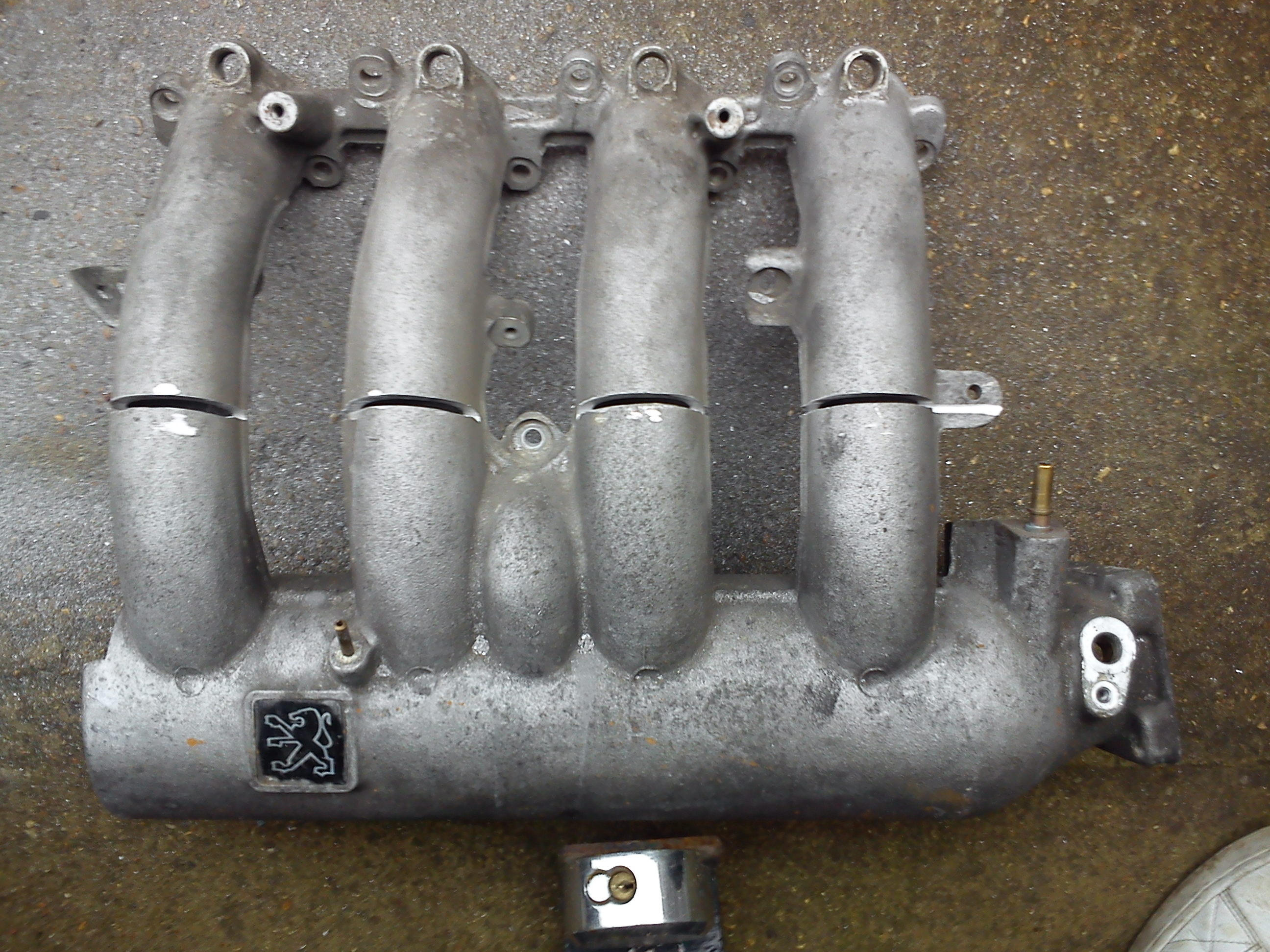

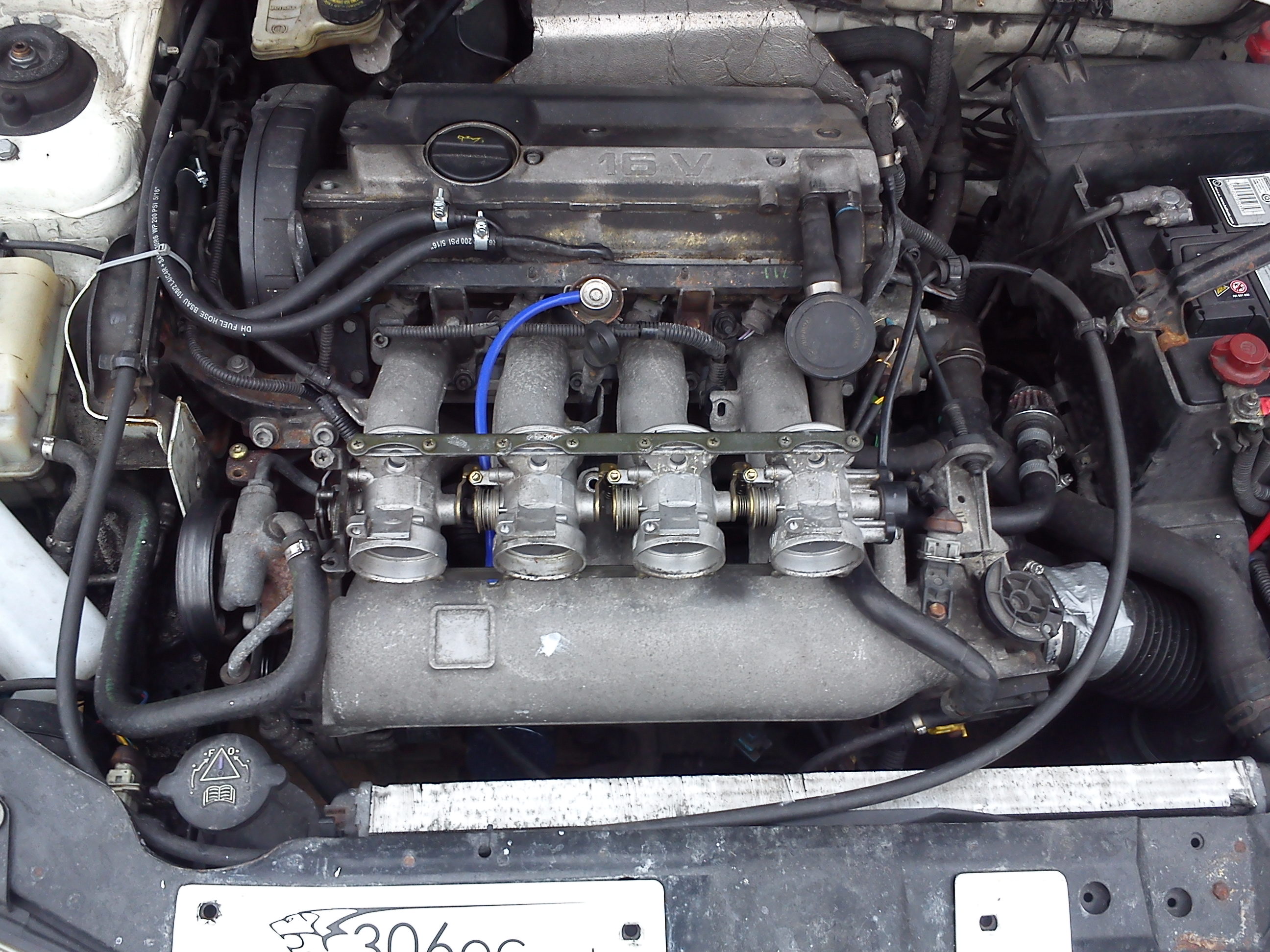

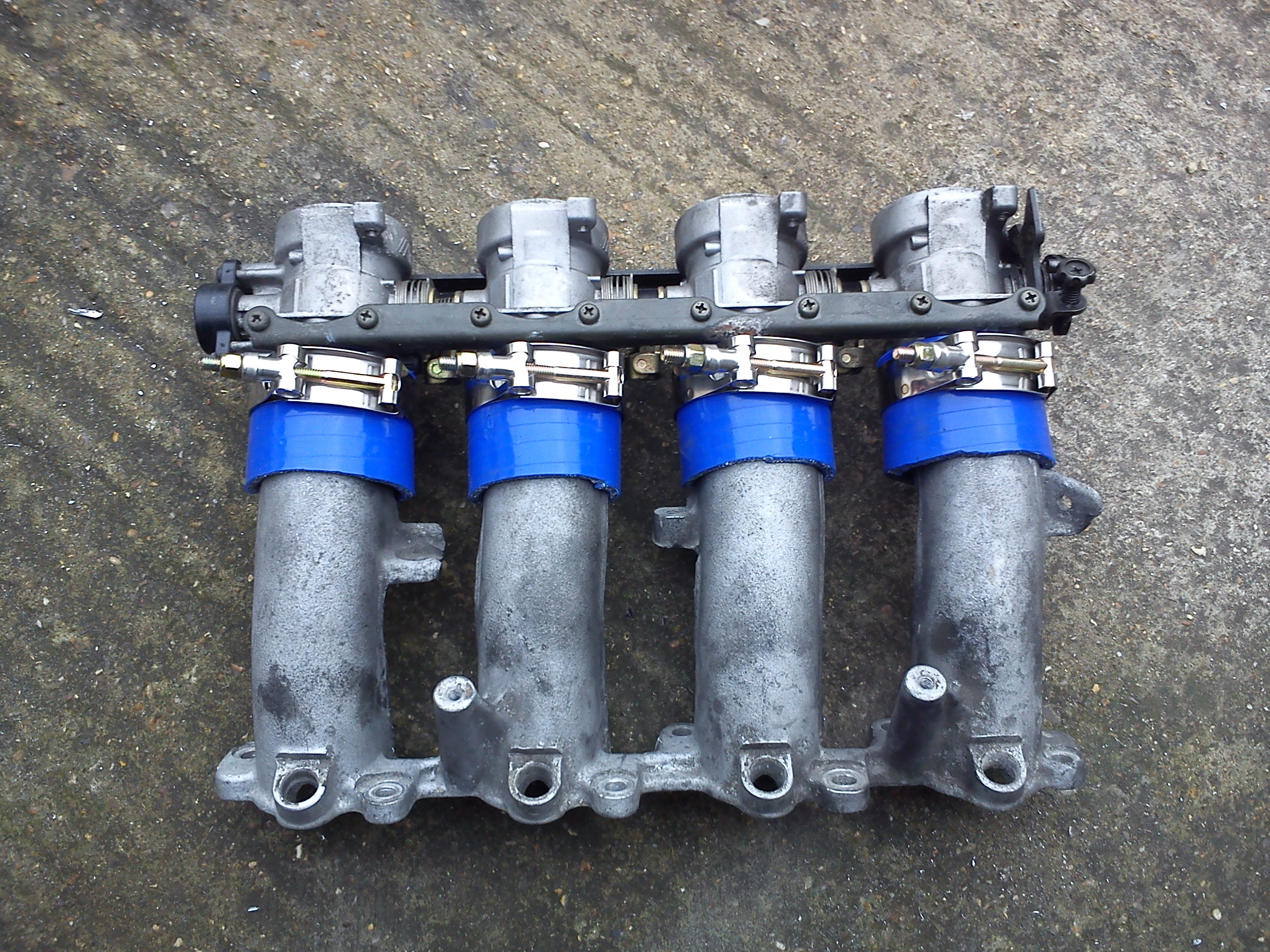

you using stock ecu? with all the original sensors like yani on the 6 forum?
If you want more info Maz who was asking about 106 rallye manifold for his 1.6 306 did the yani conversion on his old gti, it sounded epic but it didnt make much difference.

(24-10-2012, 03:24 PM)Niall Wrote: Bodgetacula!
(24-10-2012, 03:32 PM)Fozzy Wrote: you using stock ecu? with all the original sensors like yani on the 6 forum?
These^^
It will sound porno though!
That was a smart work-around the guy on the 6 forum did with his Xsara VTS (?) I think it was.
Going to sound incredible
[Image: Sig500x130.png]
TBH i cant see many power gains without getting it mapped. Once again, this will fail and i have no faith in your abilities to make this work.
