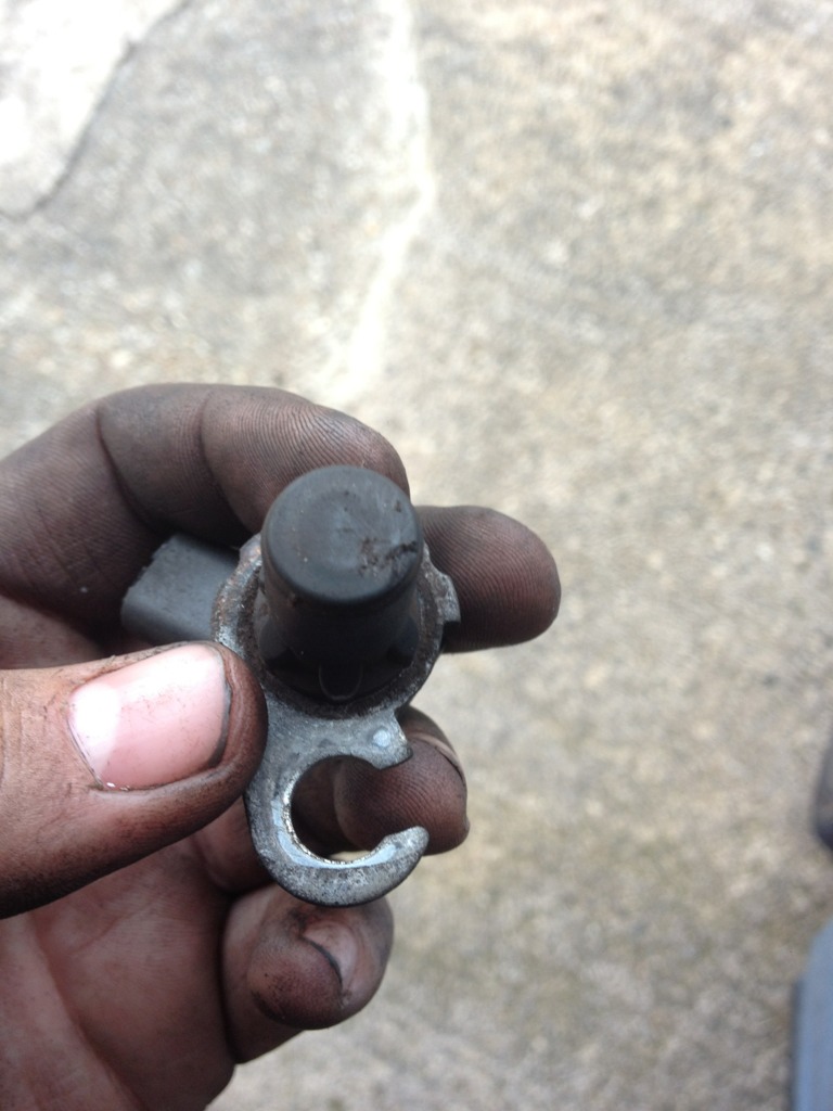

Put back together today but she won't start. We know the cam shaft sensor got damaged a little bit when the thrust bearing when. Could the sensor be stopping it from starting. Here's pic of the damage.
#92
Thats the crank position sensor btw, not the cam. And its possible that could stop it starting, but iirc its only like an electromagnet type of sensor so I'm not sure if that small amount of damage would do anything or not.

Ok dude cheers. Going to actually try and replace the sensor with a new one instead of second hand.
If the sensor was off would it stop the car from starting? Even bump starting?
The engine only gets two signals to tell it what to do and when to do it, this is cam and crank sensor. Ordinarily most engines will function with one faulty, but if both are gone it won't normally do anything as although you're cranking - it hasn't got a clue what's going on as it can't determine engine position.
I would have expected a fault code related to cam or crank sensor though. Any codes?
