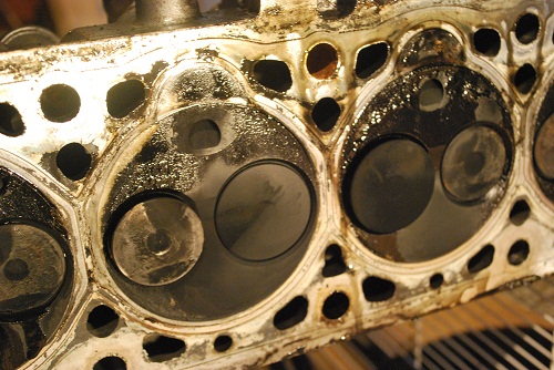

(01-07-2012, 07:47 PM)Jonny81191 Wrote: The rad was swapped Mark, found a nissens in the scrappy, it wasn't pressurising, but the HG is blown between cylinders.
Bear in mind this has ran for maybe 5 minutes since the sudden loss of power, so it is recent!
Strange how its not pressurizing though if its blown Sad bit of a shite!
And I will have my spare rad back if you haven't used it then Big Grin
Have you taken the rocker cover off to see what state the cam and bucket are in on that valve?

The gasket wasn't in good condition at all, think jonny described it as complettely de-laminated. Haha, I'll set up a photography booth next time, maybe do some light paintings if that's what you're after? Big Grin

Yeah, the rocker cover is off the cam seems fine.
Just to clarify, ALL the pistons have a valve shaped mark on them.

(01-07-2012, 08:01 PM)c.gerrard Wrote: The gasket wasn't in good condition at all, think jonny described it as complettely de-laminated. Haha, I'll set up a photography booth next time, maybe do some light paintings if that's what you're after? Big Grin
Cheers for the radiator btw
Jonny would describe it as that but they aren't laminated in the first place, all the layers are seperate and only held by the rivets Wink

Told you I was running out of experience! I thought they were supposed to be laminated together Blush

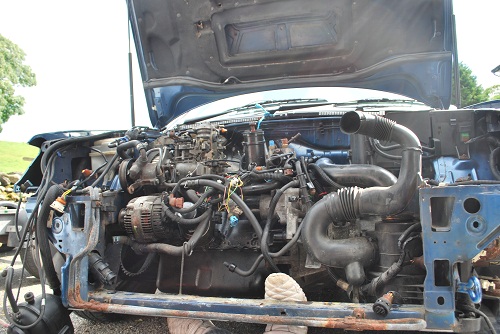

Not sure if these are of any assistance...

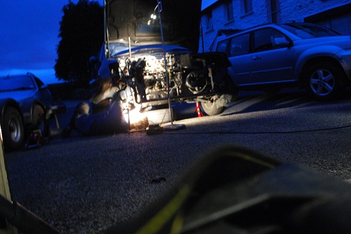

#42
at the meet would be cool if your free Smile
I will be with the family during the day so I will be grumbled at if I end up carrying a rad, she will moan enough about me buying tools Big Grin
Team Orange Engine Bay
#43
Sure, it can live in the car for the day lol
#44
Another little update on what's been going on lately.
Had a decision about what to do with my side skirts, try and hunt down Sigma paint (which doesn't actually exist!!!) or do them gloss black. In the end, took the easy/cheap option and went for gloss black. They've come out a lot better than I thought.
With Jonny's 'proffessional' welding skills, the back box has gone, there's still the mid box and cat though. Bit of a leak though, so hopefully i'll stay alive till it gets fixed!
Also, got some 60mm springs, 40mm just doesn't quite look good enough to me. Once those are on, will be needing to get the back lowered. I got so excited i decided to wear them......
#45
That looks awesome!!!
#46
(09-06-2012, 08:20 PM)puglove Wrote: Tidy project mate, think it needs a ph1 front end conversion ! ph1 sigma = most epic 306 ever made
Edit: looks good though mate :thumbup:
Cast your eyes to my sig...
Got I miss that car Confused
#47

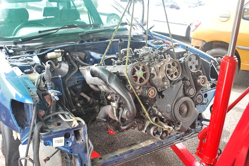

Out with the old
And in with the even older!!
Hopefully this engine won't dick me about.
#48
why did you let smallest member of oc be on the end of a big crane with a big engine dangling off the other end of it? just asking for trouble if you ask me....
#49
(09-09-2012, 07:52 PM)samass Wrote: why did you let smallest member of oc be on the end of a big crane with a big engine dangling off the other end of it? just asking for trouble if you ask me....
Same reason we let the stupidest member of OC tie the knots in the rope holding the aforementioned engine, shortly before it ended up back on the garage floor. Luckily it wasn't that high off the ground!
