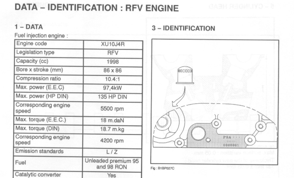

I can confirm without any doubt that the stock XU10j4R / RFV engine has a compression ratio of 10.4:1. The info on peugeotclub.eu is wrong.
Here's a screenshot from the Citroen engine workshop manual (same for all PSA vehicles fitted with RFV tho).

Given the higher compression ratio to start with, I'd be looking at the .140" (3.5mm) gasket then as a minimum to bring it down to about 8.5:1 but looking at the cost (when I factor in shipping it'd be a £270+ gasket) think the more sensible option is going to be C20LET pistons or having the originals machined if there's enough in the crown of them to do that.
