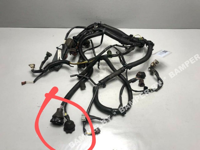

I have a -97 ph1 cabriolet that used to have a 2.0 8v engine. I've swapped a 2.0 16V engine (XU10J4R) from a Xantia in. Engine wiring loom is from a crashed 1998 Peugeot 306 that also had the same 16V engine. The engine swap is otherwise finished, but I'm currently waiting for an ECU to be mailed to me. Before testing whether the car starts, I need to know if the pin order of the engine wiring looms are different in a ph1 2.0 8V engine and the ph2 2.0 16V engine. What I mean is the pin order of the two round connectors that attach to the body. Hopefully someone has info that would help me.

if you have both wiring looms then you have all the information you need right in front of you.
I do have both wiring looms but I don't know how that helps me. The old engine has a Magneti Marelli ECU, and the new one has a Bosch MP 5.2, so I can't just measure if the pins on the loom connectors go to same pins on both ECUs.
Welcome to the club.  You could maybe try
 mapping connectors on both looms using a multimeter on continuity setting. Bit laborious I know but it might be the only way your question gets answered. (I don't have any access any more to a resource where I can look up the pin data I'm afraid).
(25-05-2020, 04:58 PM)Mighty306 Wrote: You could maybe try mapping connectors on both looms using a multimeter on continuity setting. Bit laborious I know but it might be the only way your question gets answered.
It is a bit laborous like you said and it won't give me a definitive answer. I would be able to map the sensors etc., but I assume some pins go directly to ECU. Without the pinouts of both of my ECUs and/or the loom connectors, I guess I'll just have to test and hope for the best Confused
I can provide you with pin data for the XU10J4R (bosch MP5.2) but not for the XU10J2 (8v engine). Will that be any help?
very easy, the ecu will have very little connections to the 2 round plugs, I think tacho out, vehicle speed sensor, obd if it has anything, and immobiliser if it has anything.
compare the pin layout and wire number for each pin, ignore the ecu plug.
all you need is a multimeter and some way to label all the wires you have, and a notebook.
if you have an unlocked ecu, you can make it run with only 3 wires connected in those round plugs, switched live to power the double relay, fuel pump and starter motor.
double relay live comes from the alternator, engine loom has its own earth.
