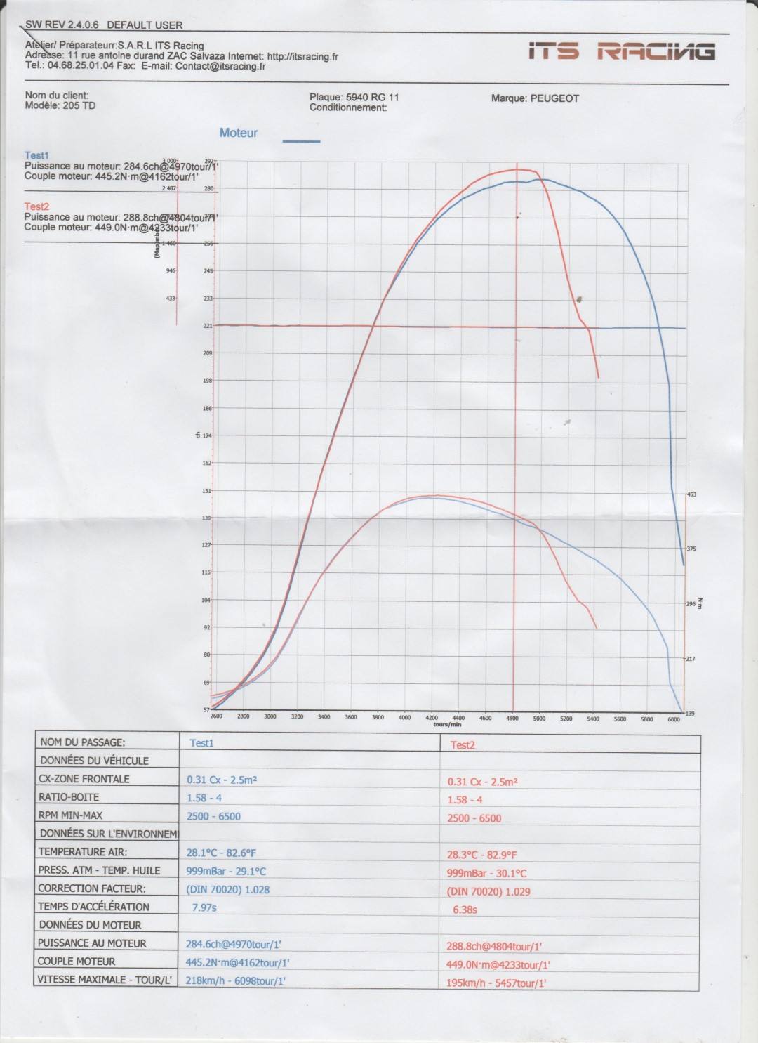

I present you my 205 2.1 td12
here is the description of the work done
- crankshaft + connecting rod + piston + balanced axle
- 4 forged connecting rod in H
- 4 pistons new planed CR 18.3 / 1
+ ceramic treatment
12s slotted pipe planed +12
new valves + 4 prechamber new + mechanical pusher and camshaft re-cut.
-injection pump in 12 mm specially prepared in Hungary
-turbo gtb2565vk (upgradturbo romania)
electric water pump craig ewp 130l / min
-quick of cooling evans 180
the car will soon go to the dyno
power I would like to have 300 cv ++
missing custom exhaust manifold

Attached Files Thumbnail(s)
goodness me that shifts when it gets on blow!!
