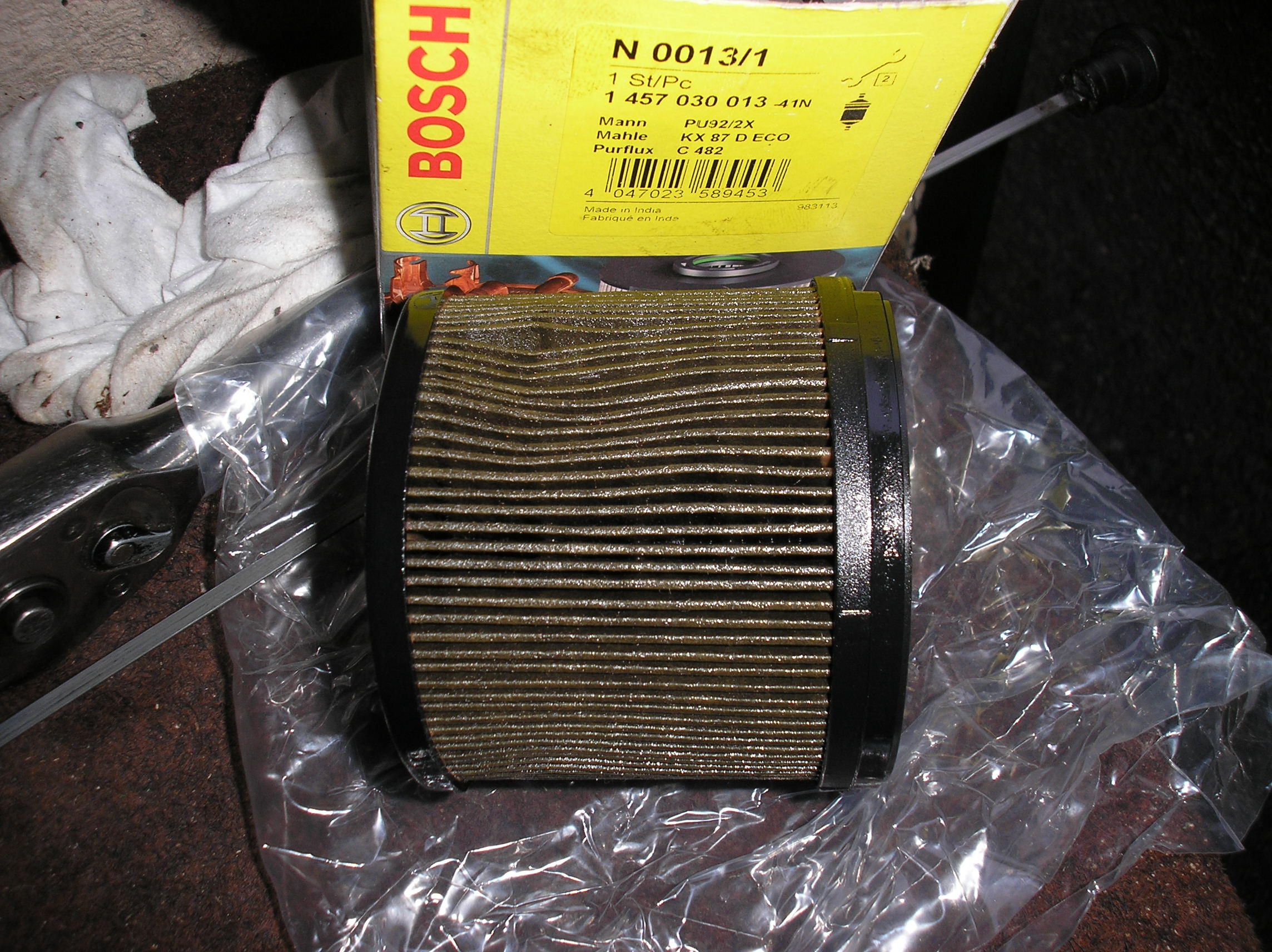

Last time some "glitter" was seen on the filter body floor, but not much this time, but, quite a bit of rust colour looking stuff was there !
The filter looks cleaner in the pic but was defo off white, a little blackish actually.

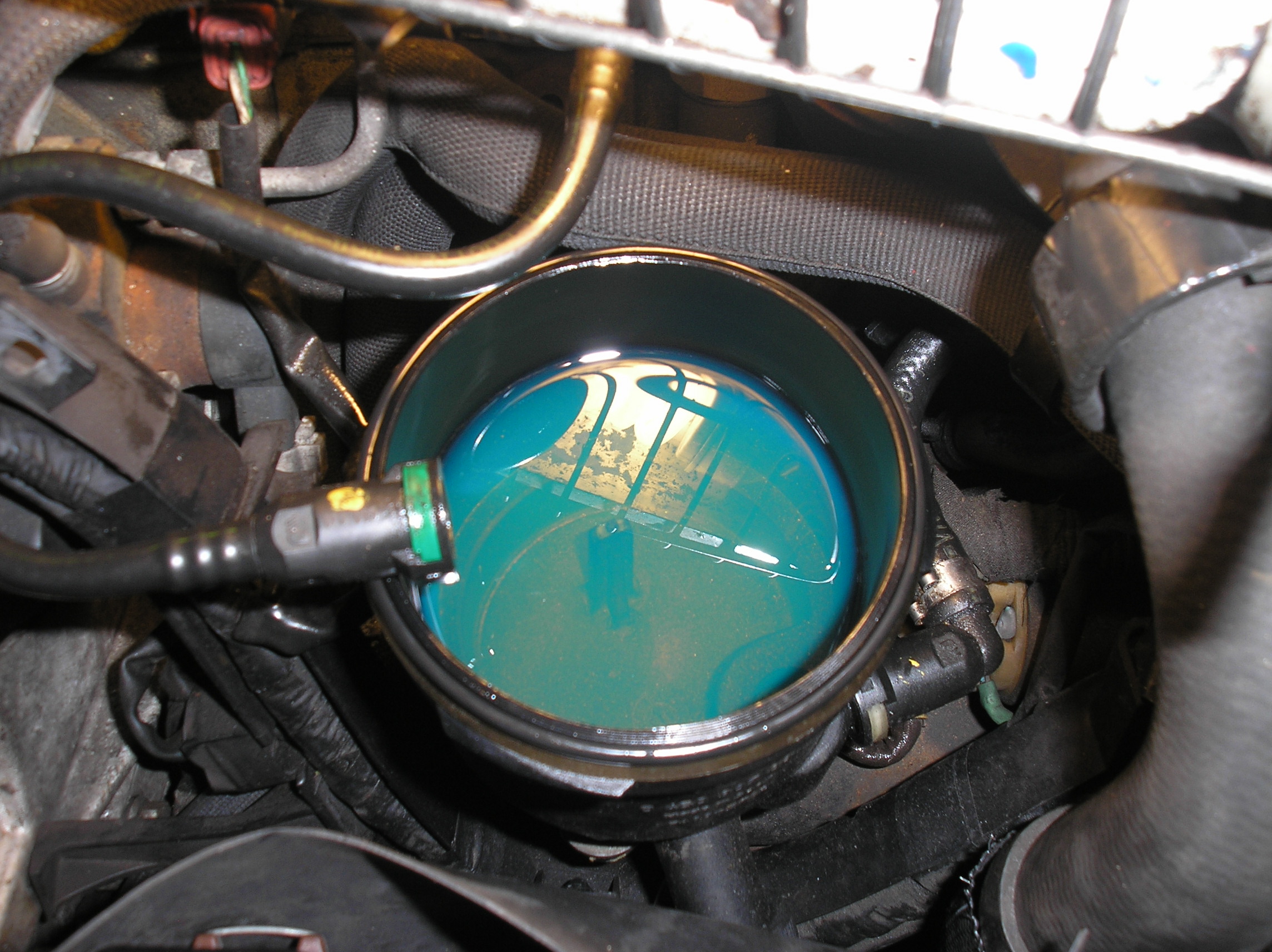

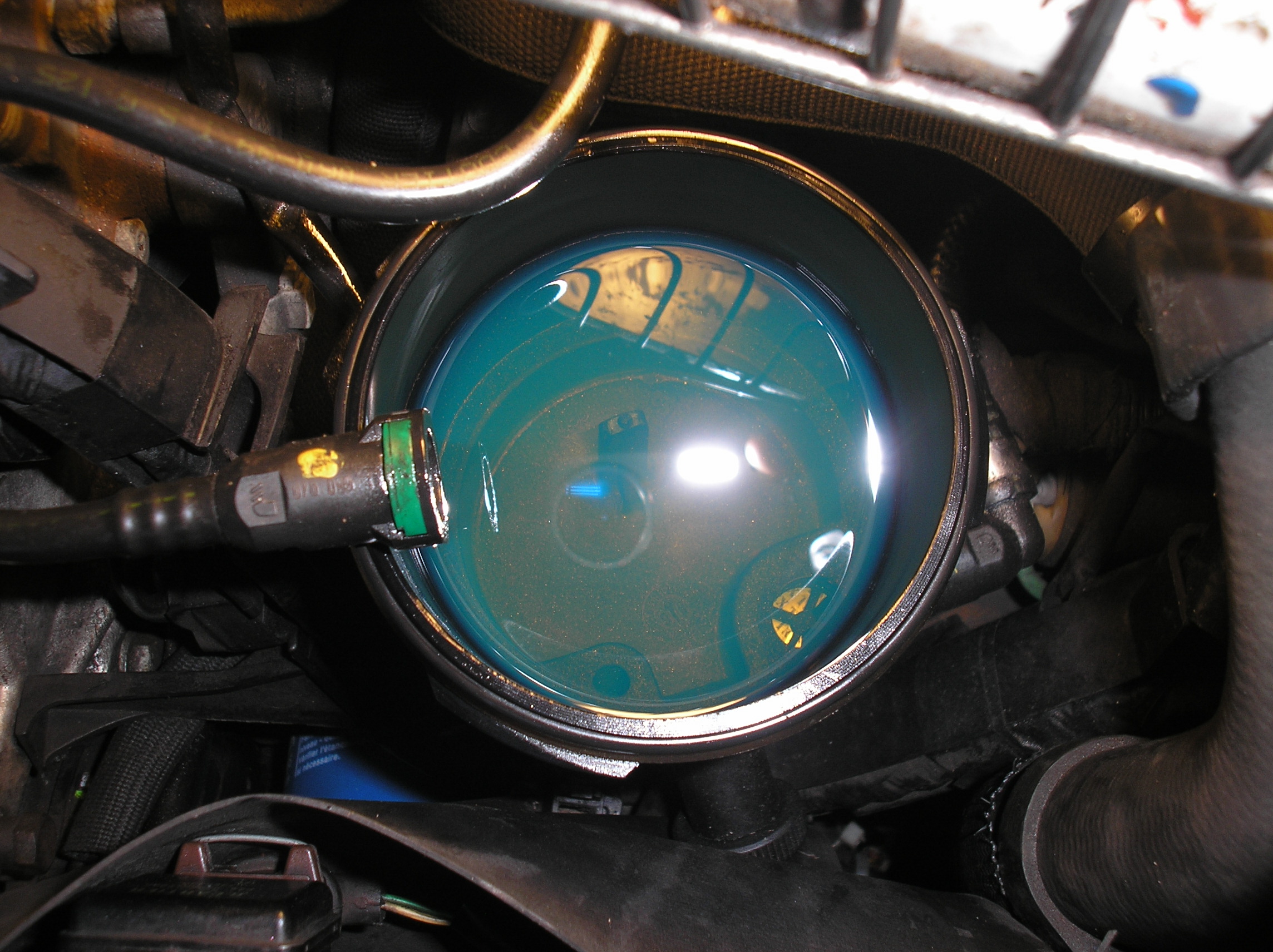

The filter chamber was sucked out and a small paint brush used to agitate the crap. The system was purged by turning on the ign and listening to the tank pump. The chamber was sucked again and re purged and sucked. One more last time purge and sucking to make sure all the crap was out of there.

When you say you were purging it, did you have no filter in when you did this? That sounds risky to me if so as turning the pump on with no filter in could force all those little bits down the pipes towards your high pressure pump and injectors :O
I think he did it as like the pic, just dribbling the fuel into the filter housing.

The feed pipe to the high pressure pump is in the filter top, the larger bore one on the right from memory, with the filter "leak off" being the smaller diameter one on the left, as viewed from the front of the car looking rearward. Fuel from the pump is the one down near the bottom on the right, the other two being to and from the fuel warmer in the/near the cooling system thermostat. Then the fuel is filtered with leak off back to the tank filtered also, but yes, point taken.
Since the "purged fuel" was gunna be sucked out I considered the purge to be ok to do, to make sure as best as possible under the time available that all/most of the crap sitting in the fuel lines from the tank ( cos thats where this stuff has come from ) was flushed thru and removed from the system.
