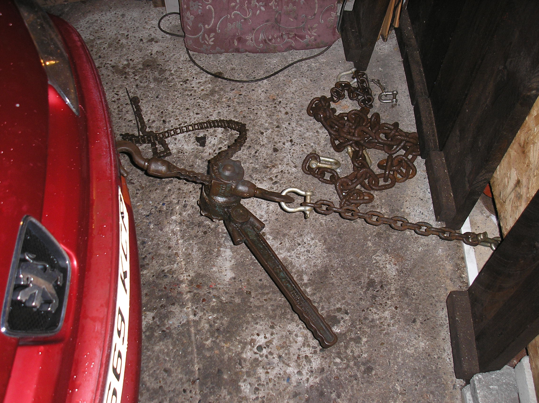

With the wife's help ( i have trained her well and do exactly as she says ) we managed to  manouver the car into place with the aid of a winch, in the pouring rain, so the front of the car at least is under cover. What the picture doesn't show is the "river" flowing down the garden path and under the car port, the river being behind me.

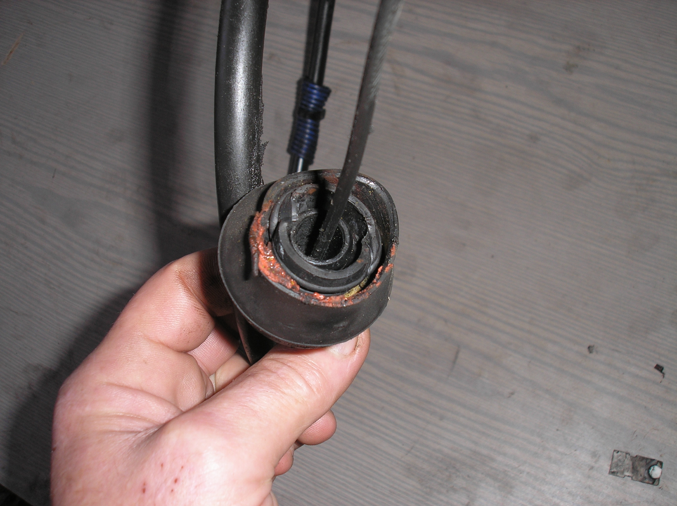

All good. The old cable inner was a little bit stiff/draggy but the clevis end looked much weaker than the first line one. A "Dura" make  cable. Perhaps a clip was missing from the clevis as the remains seems to suggest a clip was meant to be there keeping the clevis sides from splaying, will post a pic tomorrow.
This suggests that the old cable was not fitted correctly with the inner showing some wear of the plastic coating to the inner cable.
lost the picture of the clevis, will re take and post wednesday.
One thing to bear in mind and I think the communication you had wasn't the clearest on this, that white plastic shroud around the adjuster is there to ease fitting, it's supposed to be removed once the cable is fitted.
    Yep, made clear by first line, and kept for the future.
See picture of the broken clevis above ,on the Dura cable.
The centre of the clevis has 2 cut outs, for a clip to stop the clevis sides from splaying ?? Anyways, no trace of a clip found and its buggered so that's the end of that cable, for now. Its a bit stiff anyway and the inner cable plastic covering is worn thru in the area of the clevis, maybe that's why it was a bit stiff.
There's no clip for them. The plastic is designed to be a weak point and break before anything else.
