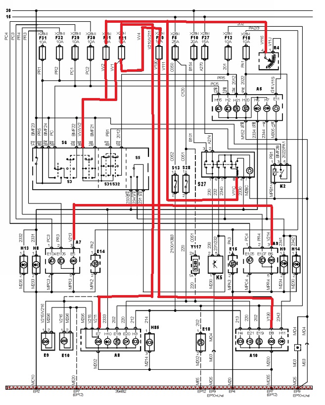

Lights always on.
Lights always on.
Had this issue for some years now but I've just put up with it as I've not been able to figure it out.
Sidelights, rear lights and dash lights are always on with the ignition on as if the stalk is turned onto the first position but it's definitely in the off position.
If you turn the stalk onto sidelights it makes all of the lights slightly brighter.
I've tried another indicator stalk and checked all of the dash fuses but can't find any fault.
Just wondering if anyone would have any ideas?
Sticking relay?

yeh check the relay. Maybe the stalk is also a bit sticky?
no relay for the side light circuit
un plug the column switch and try a replacement Wink

(22-12-2017, 01:26 PM)cully Wrote: no relay for the side light circuit
So you think it can only be the stalk?

stalk is the only feed to the side lights and dash lights unless you have a wiring fault

If I unplug the stalk completely it still lights up with the ignition on.
So a wiring fault somewhere it seems?
un plug the panel light dimmer switch by your right knee check no one has teed ito the cables for gauge lights and are back feeding a supply
