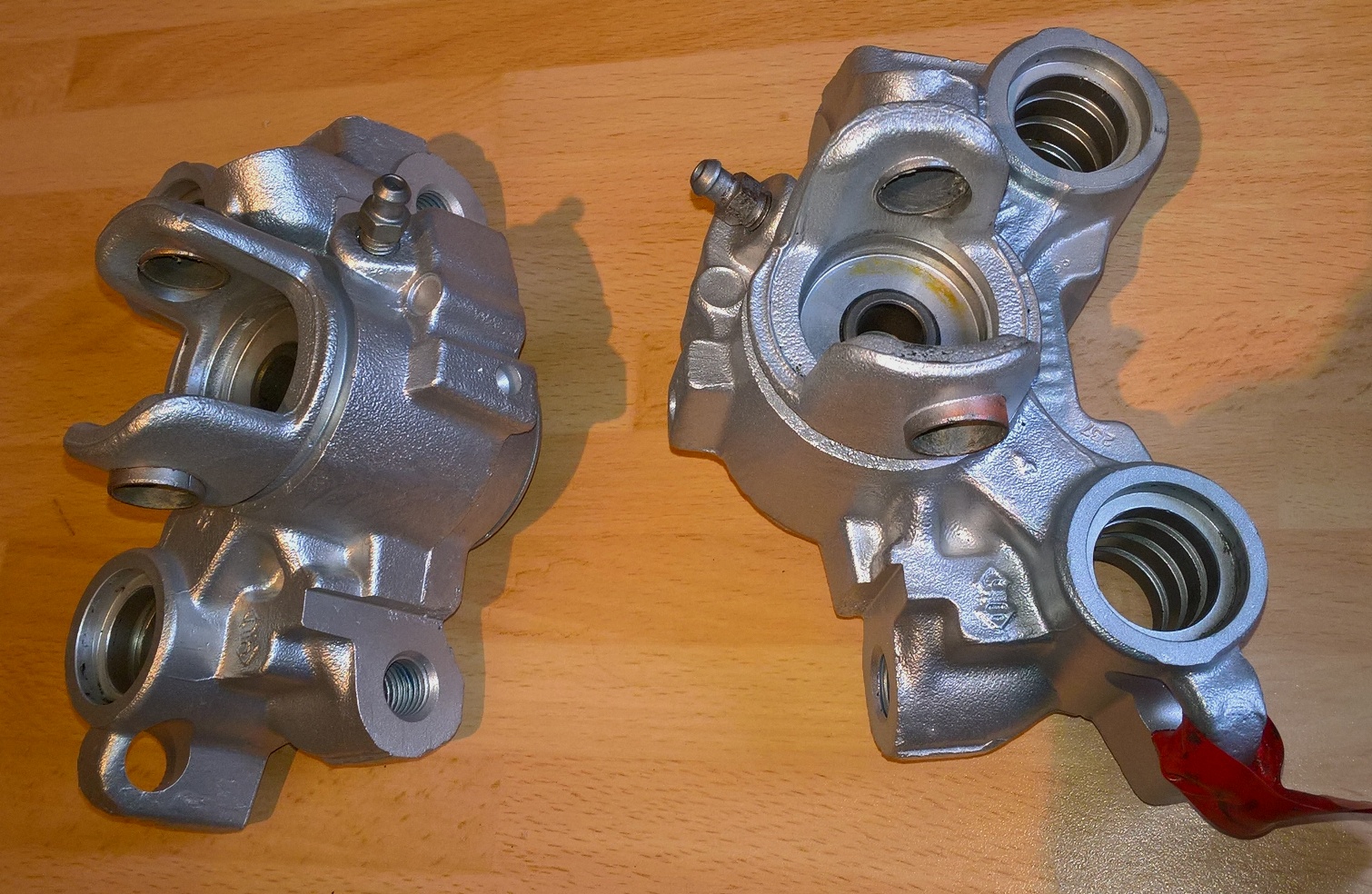

It's been a while, but these have come back from the blasters.  Very happy with the way they look.  Shouldn't take long to rebuild them.  Have new pistons, sliders & all the seals.

They look brilliant! I'm going to get my self a rear left caliper now and get both my spares refurbished Big Grin
It isn't too expensive either. £20 per caliper for blasting n another £20 each for new pistons, seals n sliders. You will need to make a tool to compress the sprung washers that are part of the handbrake mechanism tho.
If you compare the cost of buying a refurbished calliper (£80 upwards) it's worth having a go yourself.

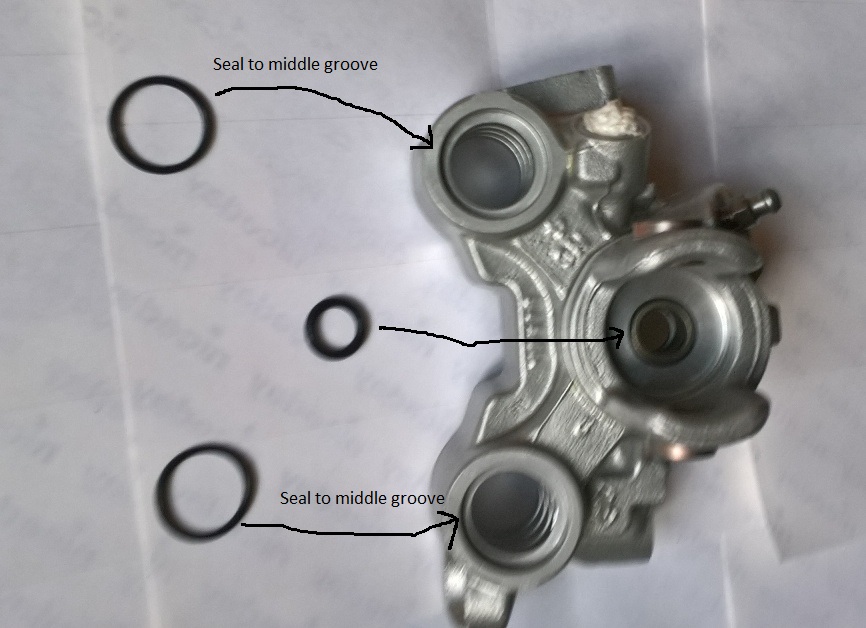

I've taken some pics tho and will try to clarify a few things.  This is the order that all of the parts of the handbrake mechanism fit together .....

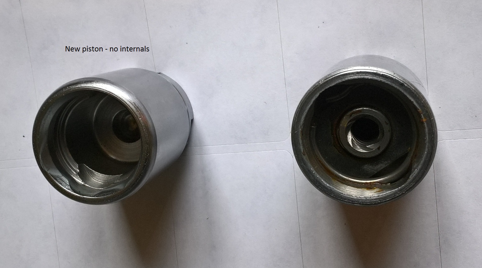

If you get new pistons they won't have any internals, which attach the piston to the rest of the handbrake mechanism.  I don't yet have any advice on the best way to get the spring back to hold the piston internals in place.
Before assembly, fit new o-ring seals from kit.

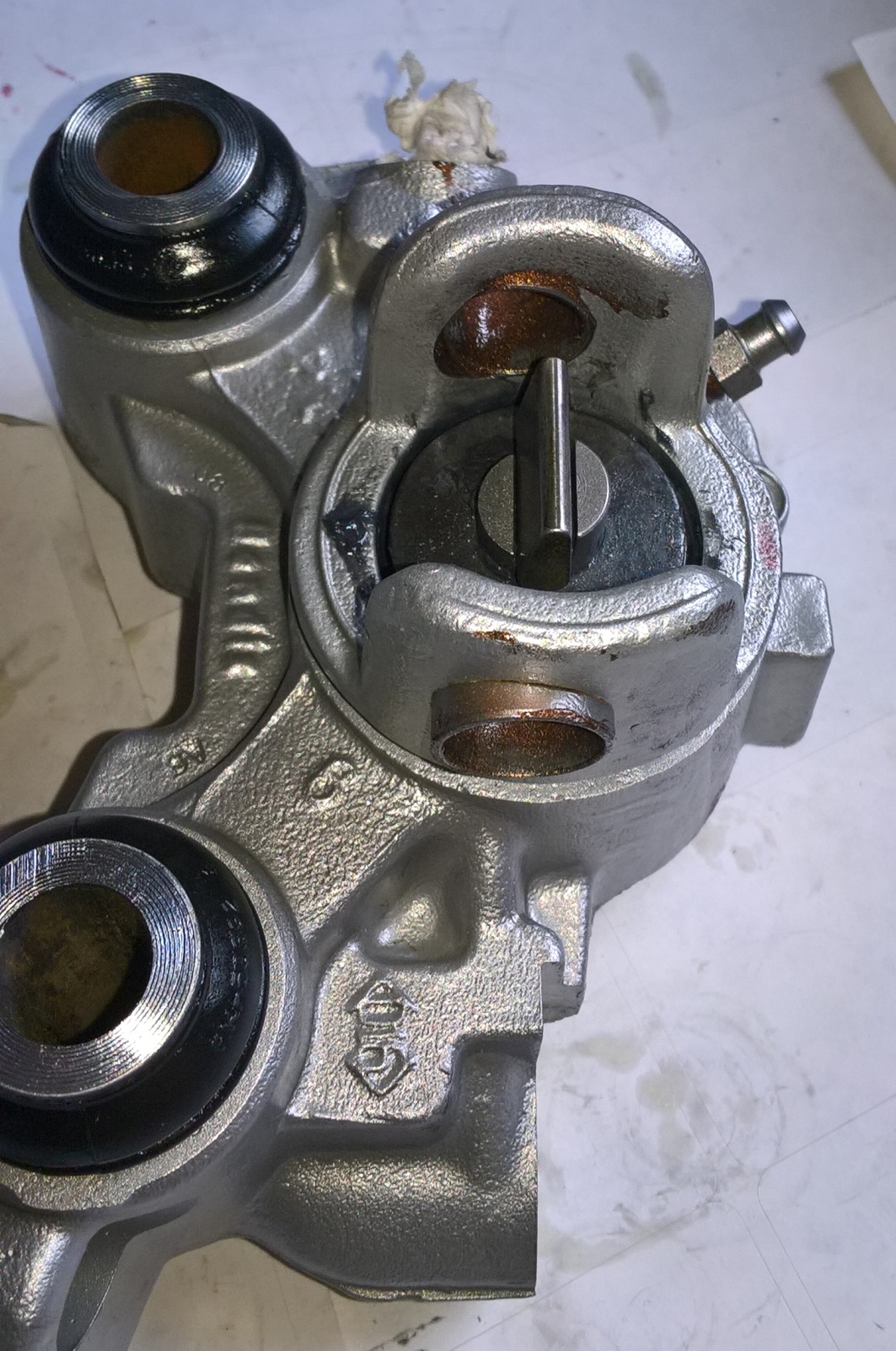

When putting the shaft with the threaded end back in to the caliper body, make sure the side that doesn't stick up so far faces towards the sliders.  The fatter side of the key sits on the end of the shaft.  The lever arm has a groove/slot machined in to it that mates with the top of the key.

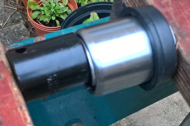

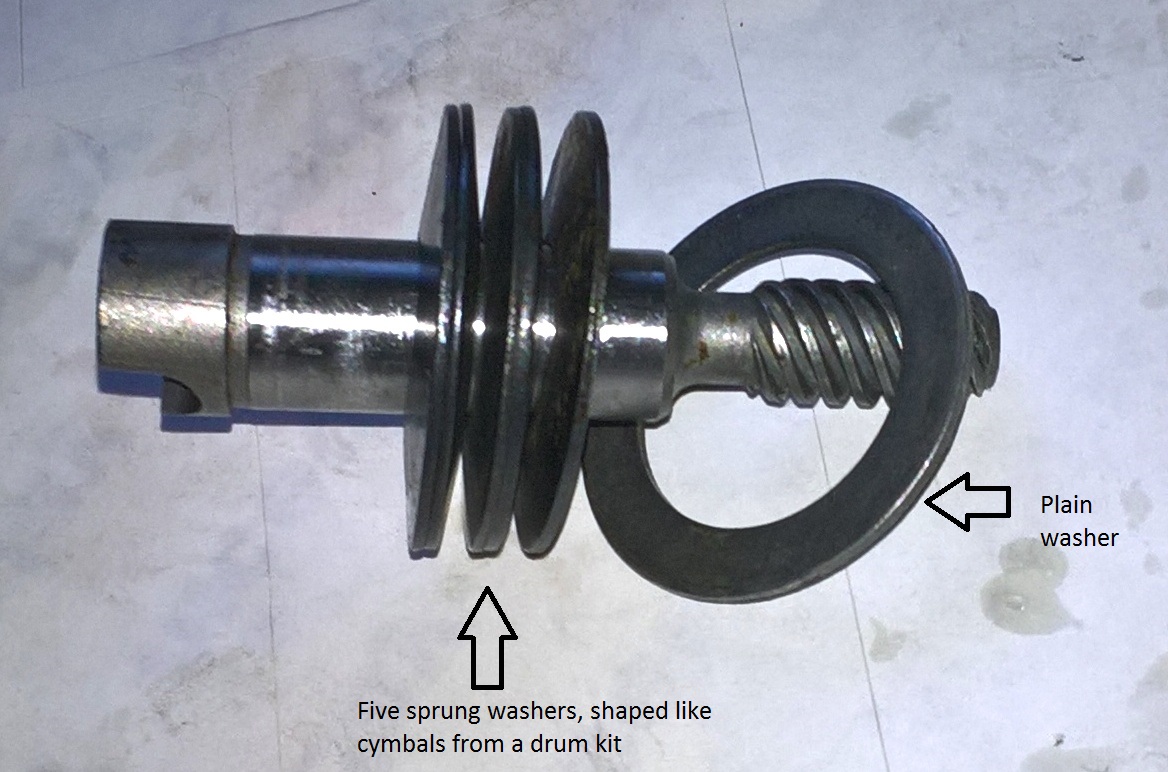

A closer look at the sprung washers that will need to be compressed to get the lever arm back through and on to its bushes.  IMPORTANT - You need to insert the lever arm in to the rubber boot and turn the boot inside out before sliding it through the bushes.  (The boot can't be put on after the mechanism has been put together).
The tool you will have made to compress the washers will obscure your view of the key when you insert the lever arm.  That's the really tricky bit.  Make sure the key is centred before releasing compression on the sprung washers.

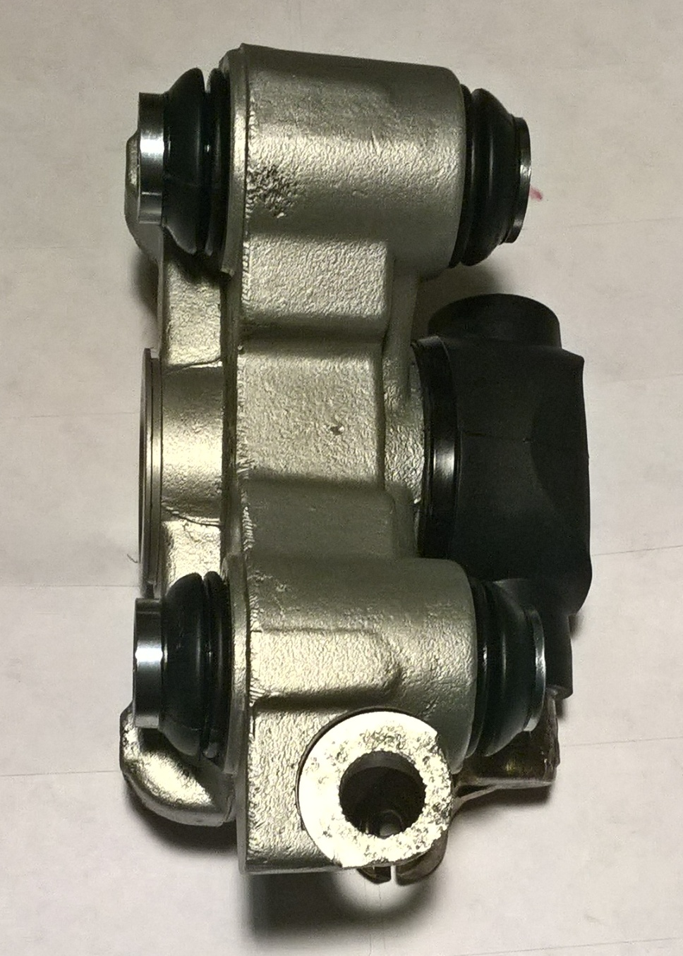

When putting the sliders back in pay attention to orientate them correctly (the ends aren't symmetrical)
Pack the handbrake mechanism with grease (I used lithium grease) before pulling the protective rubber boot over and securing with a zip tie.

Had a busy few weeks so first chance yesterday to have a crack at getting the springs back in the caliper pistons.  In short, using a socket to force the spring back in does work.  I used a socket of the perfect size to fit inside the piston, but this isn't quite wide enough to get the spring started on its journey.  I had to get everything lined up just right with slight pressure on the spring and then gently press the ends of the spring in, hoping they'd stay there while getting a bit more compression on the socket.  An extra pair of hands would have been a big help.  Either that or it has since occurred to me a jubilee clip of the right size could be used to squash the spring sideways while compressing it in to the piston (a bit like a piston ring compression tool)
The first couple of times the spring didn't go in square.  When only one half of it locks in to the groove inside the piston it throws the washer out that sits on top of the internal mechanism.  You can't then get the rest of the spring to clip in to place and have to take it out and start again.  So, ....another job requiring plenty of patience.
