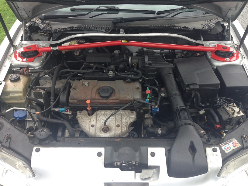

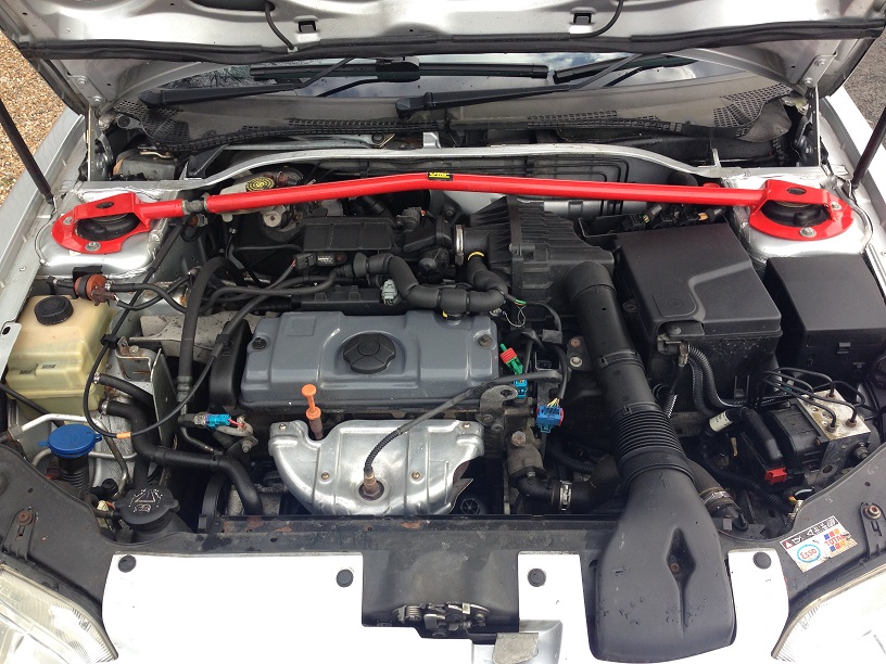

Minor modifications started mainly when looking into strut braces, I wanted to sharpen up the steering without being intrusive and of course, keeping it cheap.
With some new bolts and washers, this pretty much fitted straight on and I was quite surprised with the improvement it gave. Turn ins were more precise and the front no longer felt like a boat swaying all over the place. Of course, now I'm looking at the engine bay thinking how crap it looks! I dont like rusty parts! Something needs to be done. The habit has begun. Speechless

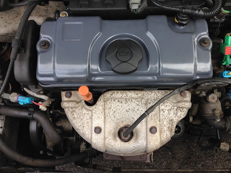

Brand new rocker cover ordered in from the main dealer, plus a new gasket. This was dropped in to a local industrial park to be powder coated - I'm not spending money on a brand new one only to find it tarnished or rusty after six months. Protection was needed, and looks good too. Shortly after this was fitted, the exhaust manifold  heat shield followed suit. Standard hex button screws were used to replace the old worn ones as seen below.
I somehow managed to snap the oil breather hose while trying to squeeze the new rocker cover in to place, my own fault as I was being lazy for not removing the whole thing and the breather hose plastic seems to be very cheap/brittle. Queue ordering genuine part and a hefty hole in my pocket. At least the new one came covered in a protective bit of foam. The difference should be easily noticeable in this pic and the previous ones.
Here's the finished product. Now I'm eyeing up that rusty looking radiator. Sad Not yet though, I'll do that later.

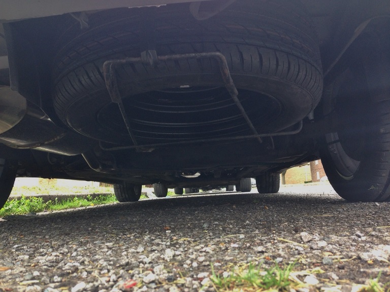

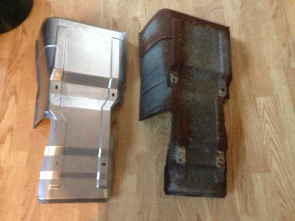

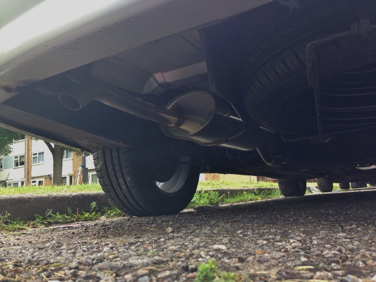

Another thing on the list was tidying up the underside, I've already been through a couple of cheap/nasty exhausts so decided to get something stainless. The spare wheel carrier and spare wheel itself was in pretty poor condition - Still got the original spare tyre, a 14yr old Continental. Took one look at the thing and decided it had to go.

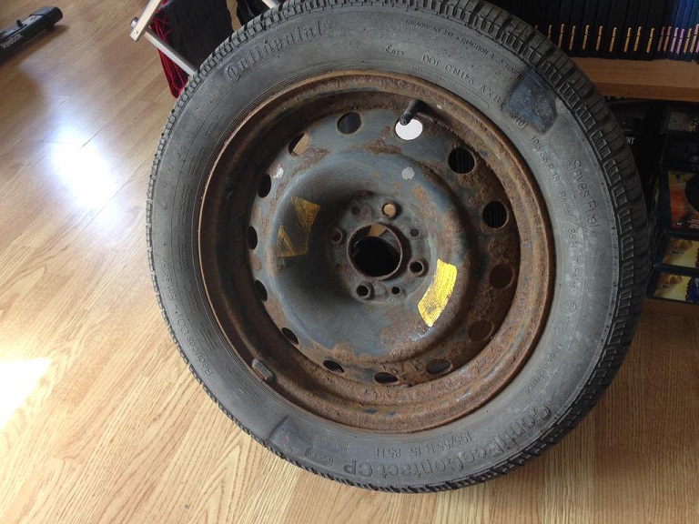

The spare wheel carrier was cleaned up with a wire brush and coated with Hammerite (Probably due another coat tbh) and bought a new hook as the old was rusty and seized. Brand new steel wheel and a half decent budget Nankang ordered in. When the stainless steel Cat-Back was fitted, I decided to source a new genuine heat shield which really does look awesome fitted alongside the new stainless backbox.
Old Vs. New heat shield:
New spare, painted carrier and heatshield + Backbox.
And looking back, from the front. Nice and clean. Smile

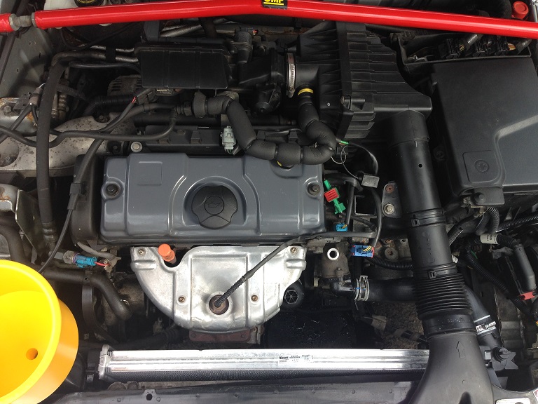

So I said I was going to change the radiator at some point - I managed to get a hold of a genuine Nissens Aluminium radiator at a stupidly low price. This is a Nissens 61317A radiator which is an absolute perfect fit for a phase 3 TU5JP engined 1.6 Automatic.
This has a 'newer style' bottom hose fitting with a thin metal cir-clip No screwing of threads, literally just push fit and secured with clip. IMPORTANT: After changing the radiator I found I had a leak from the bottom hose when refitting, this was remedied by replacing the bottom hose O-Ring which is a genuine item from Peugeot under part number 1343Z4. Unfortunately they have a minimum order of a pack of ten although they do only cost £0.96p each. You could possibly find these online elsewhere, for around £2 each individually. If you find yourself in need of a replacement bottom hose I believe the part number for a newer style hose (cir-clip style) is 1351Z4 which at the time of writing this is still available through Peugeot at £87+Vat. You can however find aftermarket hoses online for around £30+PP.
Also to add that you can get a genuine new top hose for roughly £9.00 from Peugeot - Part number 1343Y7. A new plastic thermostat housing/seal with a fixed thermostat was also fitted for £6.00 from most local auto factors.
I did notice that this particular radiator had an additional feed on the inlet side of the radiator, this was basically blanked off using a Peugeot 206/307 bottom hose blanking sleeve and a jubilee clip. I don't have a part number for it but a simple search via a well known search engine should get you something compatible.
I know there is a guides sections elsewhere on the forum although information is pretty scarce online so I'm hoping any of this information will help other people out there. If you need any info on where I got my parts or advice on how to fit anything yourself just ask and I'll let you know of my experiences / tools required etc.

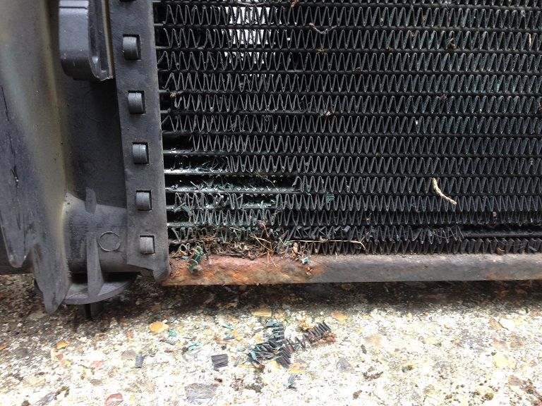

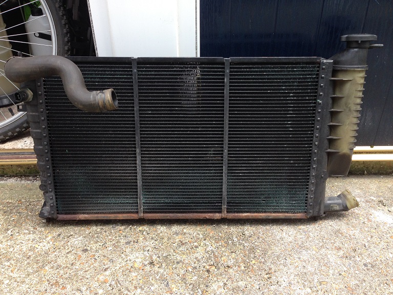

Here my old radiator for comparison:
Pretty wrecked! The cooling fins were literally disintegrating upon my fingertips when touched.

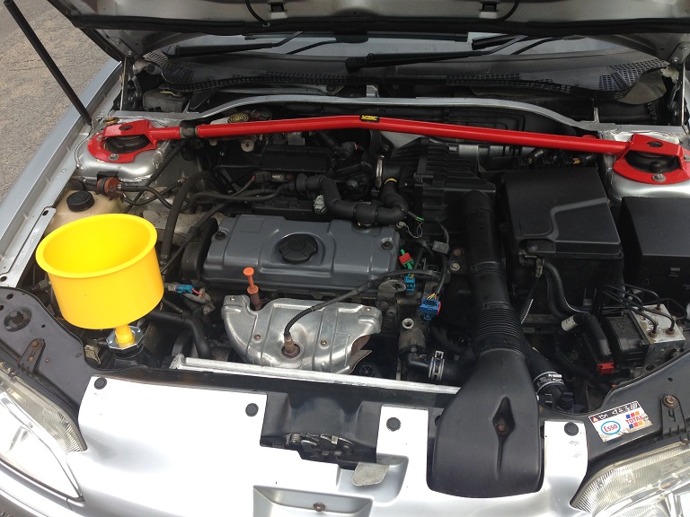

No leaks from the radiator, been doing some town driving with literally just fresh water in the system before committing to proper coolant. I -did- have a go at doing the old Coke bottle header tank but frankly, trying to tape the bottle to the radiator and it resulting in a good seal was a disaster. More water over the floor than in the rad.
I decided to buy one of those Spill Free funnels. Plenty of different adapter's and a nice tight seal, in this instance also doubling as a header tank. It was a bit of the expensive side but I'm already glad I bought it,  especially if you plan to do several car. Drained the system of water and went ahead with putting in proper red coolant and following the correct bleeding procedure. I'm yet to take it out for a proper drive before rechecking and topping up if necessary.
And a top down view of the new radiator - Those with a keen eye might notice that the left hand radiator clip isn't aligned properly. Although unsightly, this is just the way it is and always has been - Even with a brand new clip and rad fitted.

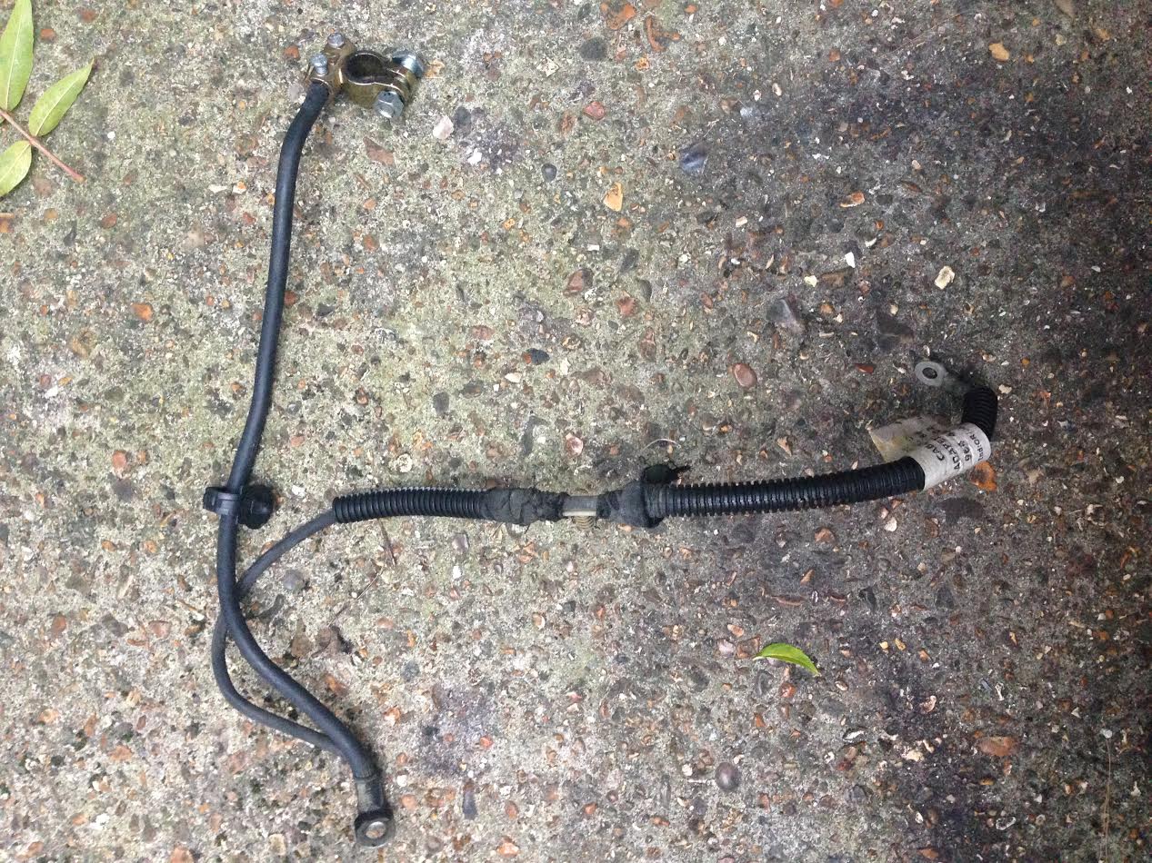

I've had a problem on cold mornings with the engine suddenly hunting and idling at 2k. There could be plenty of reasons though a little digging I recall I've got a bodged negative lead on the battery. New one for £12 and fitted in 15 minutes seems to have cured it and no more idle problems.
Old one:
New one fitted, and bolt locations:
Gearbox location is below and just in front of the air filter box. Ideally you should remove the air filter housing to access it properly. I couldn't remove the housing due to my strut brace however with some wiggling I managed to push it aside enough to get down underneath with a spanner.

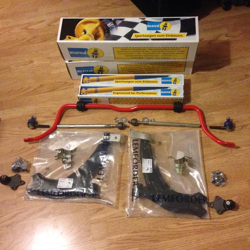

Thanks, I'm currently looking to get the suspension overhauled with Bilstein B4 all round as well as: Lemforder Wishbones, Ball joints, Track Rods + Ends, Arb bushes. Already put on Lemforder Drop Links about 100 miles back.
I bought a 21mm ARB however I read that the estate is quite possibly already 20-21mm? Regardless I'm looking to get it powder coated so if I don't need it it might end up on here.
So I eventually got round to taking the second-hand anti roll bar to the finishers, here it is fresh in its old form with peeling paint and looking dirty:
And now refurbished, shot blasted and powder coated in Traffic Red with new Lemforder bushes. I also got a set of clamps which I cleaned up by leaving to soak in white vinegar overnight. This cleaned off the tarnished rusty exterior leaving a nice original silver shine. Shouldn't really need painting.
Pretty impressed with the final finish, really nice shine. Next on the list is wishbones and balljoints - Basically I'm collecting all the parts I need to refurbish my suspension and I've also decided to go with Bilstein B6's and Eibachs. I have also bought new Lemforder track rods and track rod ends.

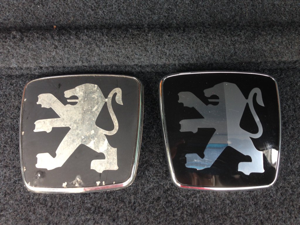

Old and new Estate Tailgate badge.

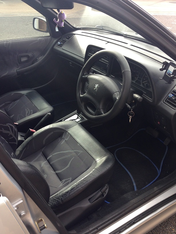

Have you thought about the phase 1&2 meridian half leather interior? I think it you be a smashing upgrade for this and work really well with the neat and tidy theme you've got going on Smile
Love the meticulous attention to detail! Keep up the good work Big Grin
Team Cyril
(12-12-2016, 10:23 PM)Matt-Rallye Wrote: Have you thought about the phase 1&2 meridian half leather interior? I think it you be a smashing upgrade for this and work really well with the neat and tidy theme you've got going on Smile
Thanks! Ok so apart from the tinted windows and glossy cyclones, I'm -trying- to keep everything in a fairly original state. My ethos is preventative maintenance, if something looks tatty or rusty I'll replace it before its completely seized or failed. For a fifteen year old car, things are getting tired so may as well refresh all the steering and suspension components. Tomorrow I'm arranging to get it in for a transmission fluid change, its on 97,000 miles and more than likely due a full flush (Been having low fluid symptoms lately and dash warning).
I've got the half leather interior already but the drivers chair is a little.. lets say saggy! I'd be interested in getting a new drivers seat with less bum miles on it.

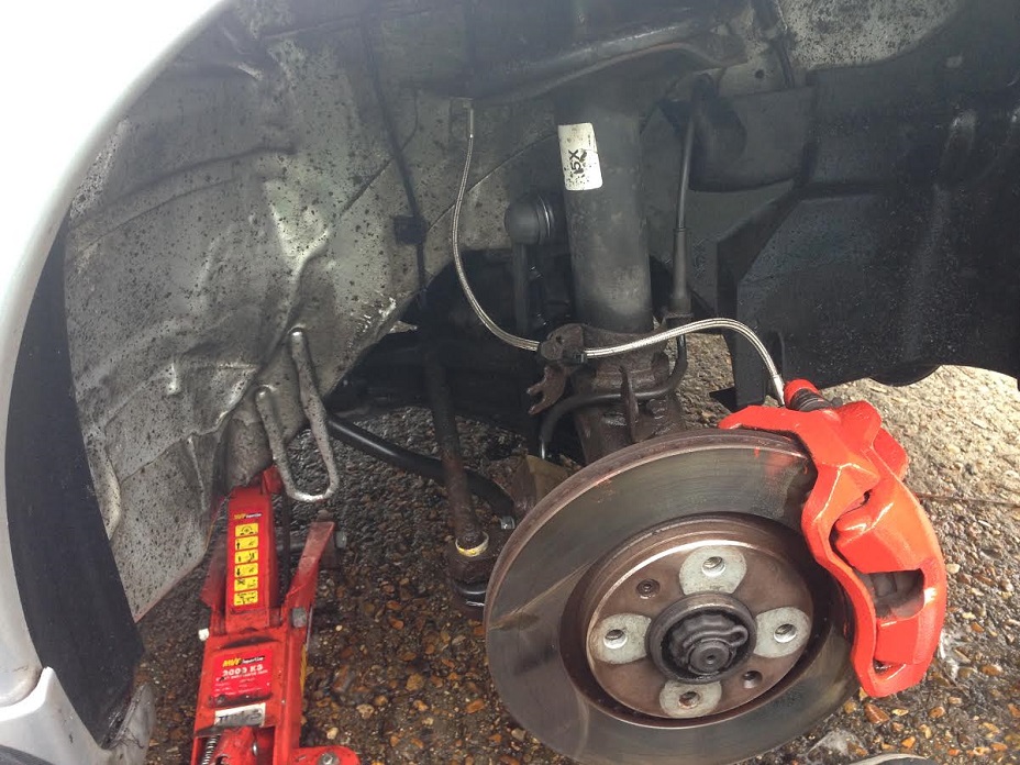

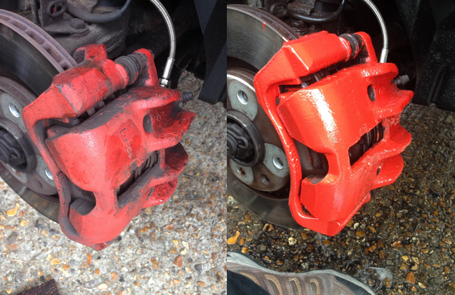

Fresh lick of paint, originally painted two years back. E-tech caliper paint.
Gave the arch a bit of a clean with some all purpose cleaner but there's still a lot of caked in grime. Track rod and end is a bit crusty, glad to be renewing them.

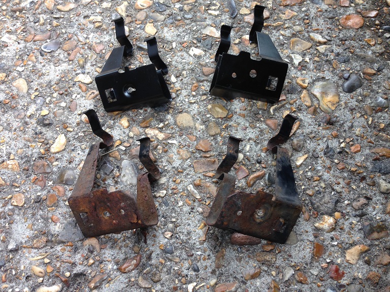

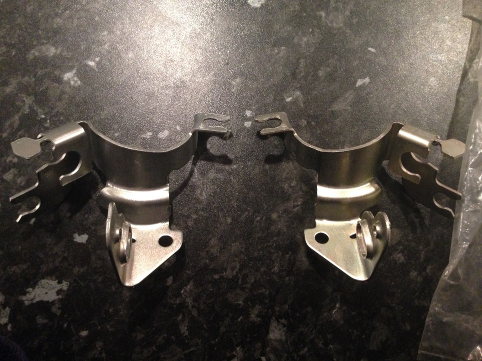

Bought a pair of brake line/abs line supports for the front hubs. Genuine pug item still in original bag. These should definitely compliment quite nicely the yellow B6 Shocks on the way plus the braided lines once fitted. You'll see on my previous post the old cruddy looking ones.
(21-12-2016, 09:32 PM)Nexus Wrote: Bought a pair of brake line/abs line supports for the front hubs. Genuine pug item still in original bag. These should definitely compliment quite nicely the yellow B6 Shocks on the way plus the braided lines once fitted. You'll see on my previous post the old cruddy looking ones.
Where did you get those? i have been looking for a set for powdercoating!

Spoox Motorsport, £7.43 each side. Smile Use their search function for product codes BR444 & BR443. I'll edit this post later with the Peugeot/Citroen numbers as well. Its crossing my mind to get them powdered too! Hehe.

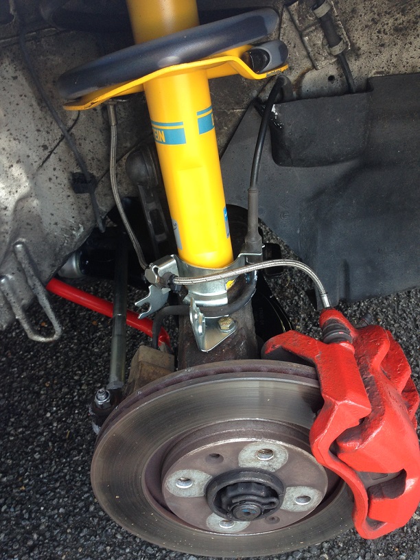

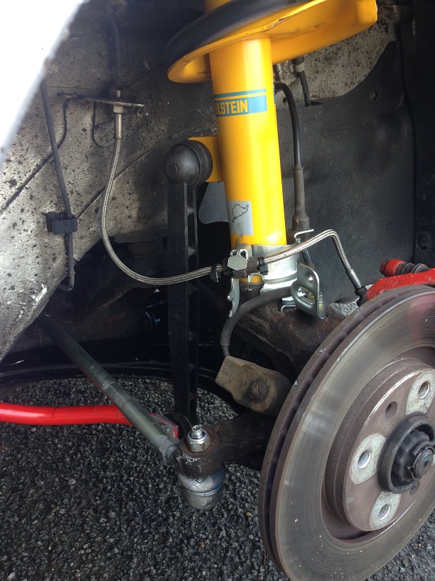

Almost ready, just waiting for the Eibach springs to arrive.  Big Grin Will likely have the top mounts/bearings done too, when the old bits are taken off.

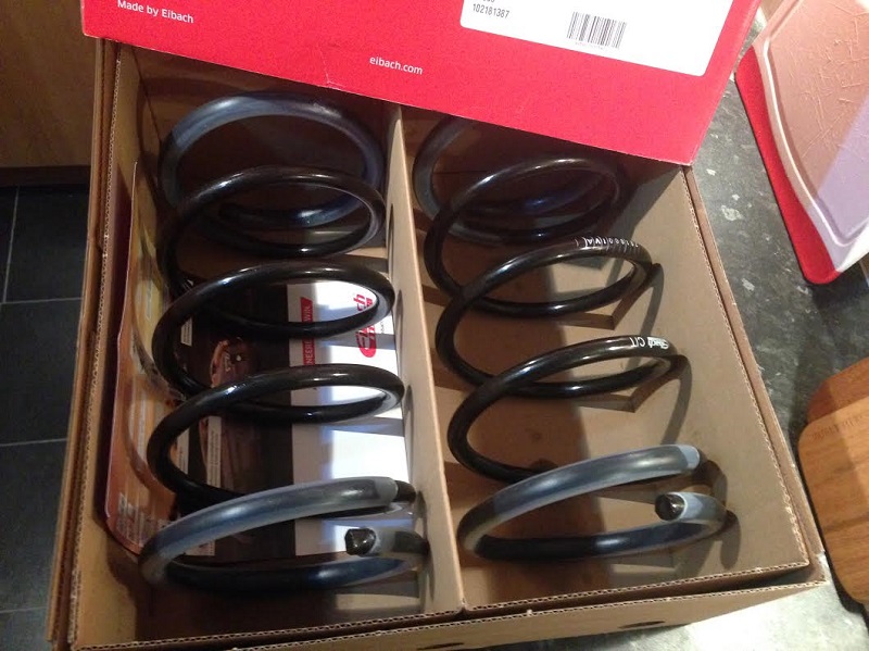

Eibach Pro's are finally here - 4 week wait but got them for £95.00. Also got a genuine 5031-60 Top Mount Kit for £5.. Yes, £5.00 and sealed. Unfortunately I still had to order a second one for the other side, which was bloody expensive. Might as well keep both sides the same quality and not mix brands right?
So next Tuesday is the big day, getting it all done at a Peugeot place I've been to before. looking forward to taking it on some nice drives to bed it in a bit. Yeah, I really honestly would like to get it done myself however its not possible where I live at the moment - Doing work out on the open street.
Peugeot 306 1.6 Petrol Auto Estate 2002
Front B6 Shock Left 22-247612
Front B6 Shock Right 22-247629
2x Rear B6 Shock 24-020749
Eibach Pro Kit EIBE7010-120
1x genuine Peugeot 21mm Anti Roll Bar (powder coated)
2x genuine Peugeot Top Mount Kit 5031-60 (not pictured)
2x genuine Peugeot Brake Line/Abs Line Bracket
Eurocarparts:
Lemforder Wishbone Left 645545045
Lemforder Wishbone Right 645545055
2x Lemforder 18mm Balljoint with bolts 617735065
2x Lemforder Track Rods 606735045
2x Lemforder T/R Ends 606545025
2x Lemforder Anti Roll Bar Bushes 614735135
(Drop links replaced within 2-2.5k miles ago)

So everything is done now. Results were pretty much instantly noticeable - Less body roll, less lift, firmer braking, feels glued down. As expected however, it feels great on a nice piece of road yet also picks up a lot of road imperfections being slightly firmer. Living in Surrey I'll have to deal with the narly potholes, sunk manhole covers and bumps from bodged repairs. C'est la vie.
